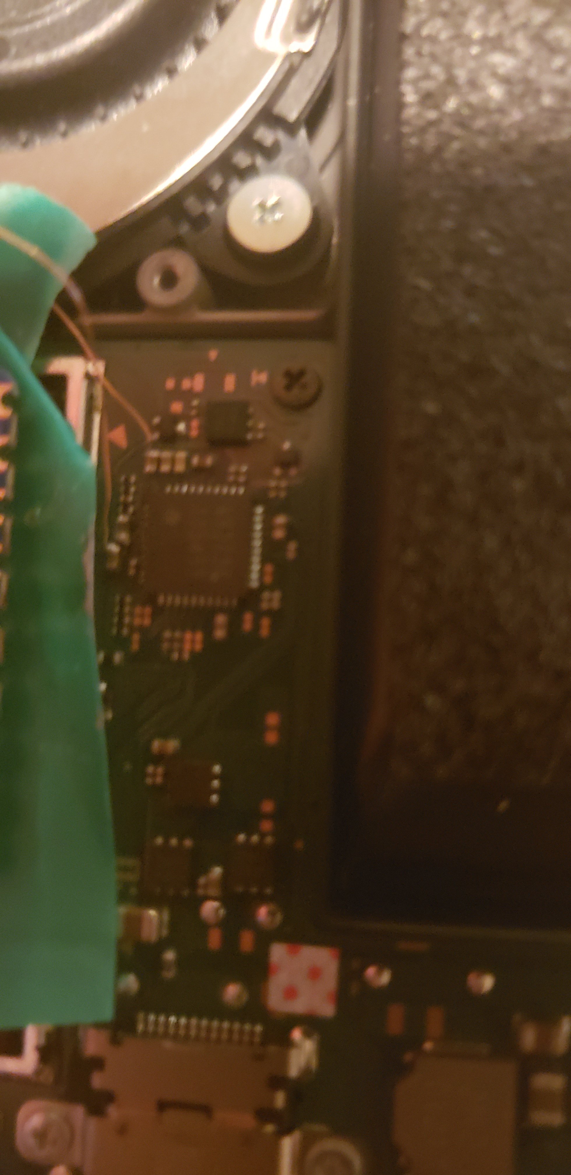

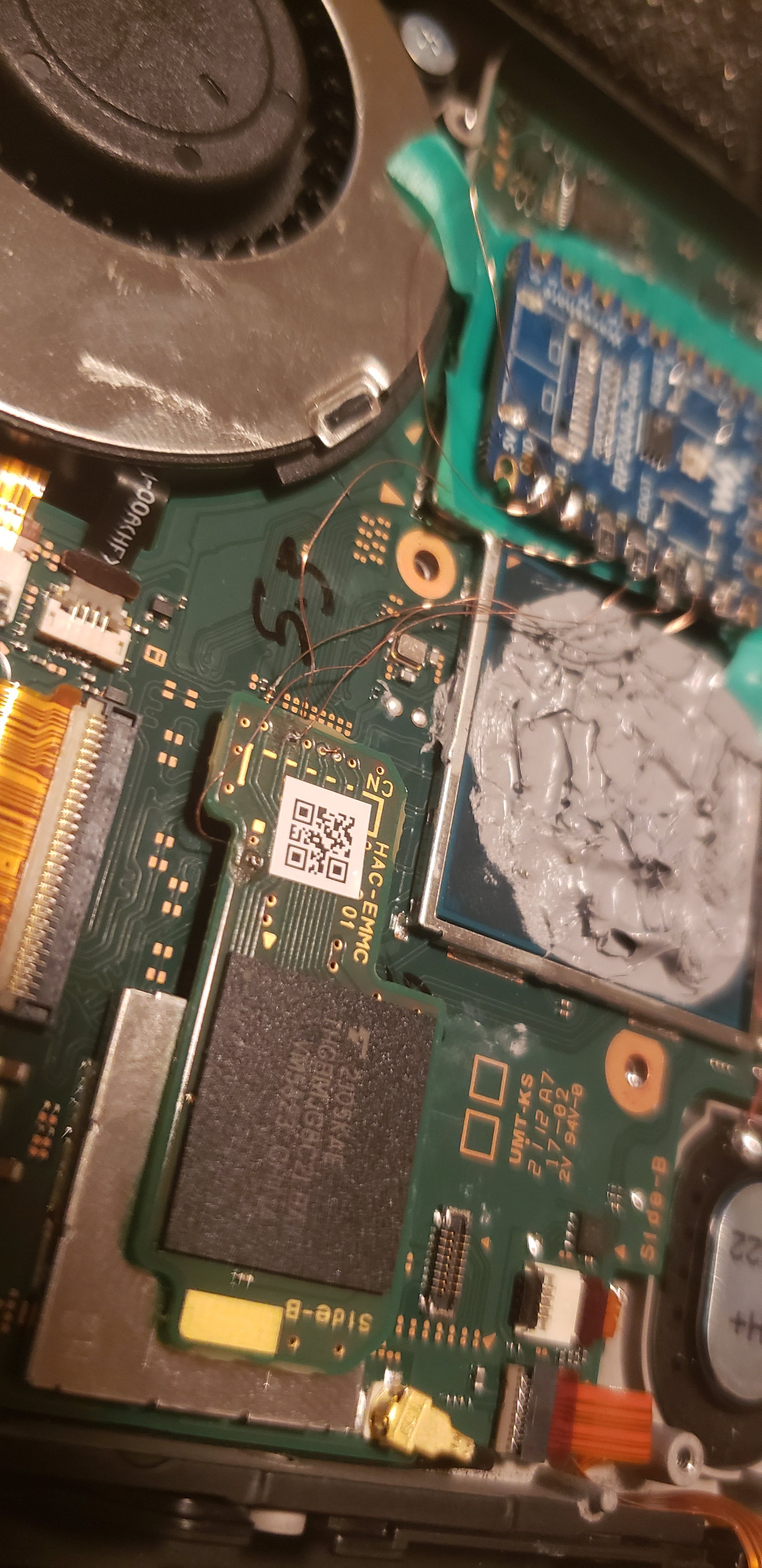

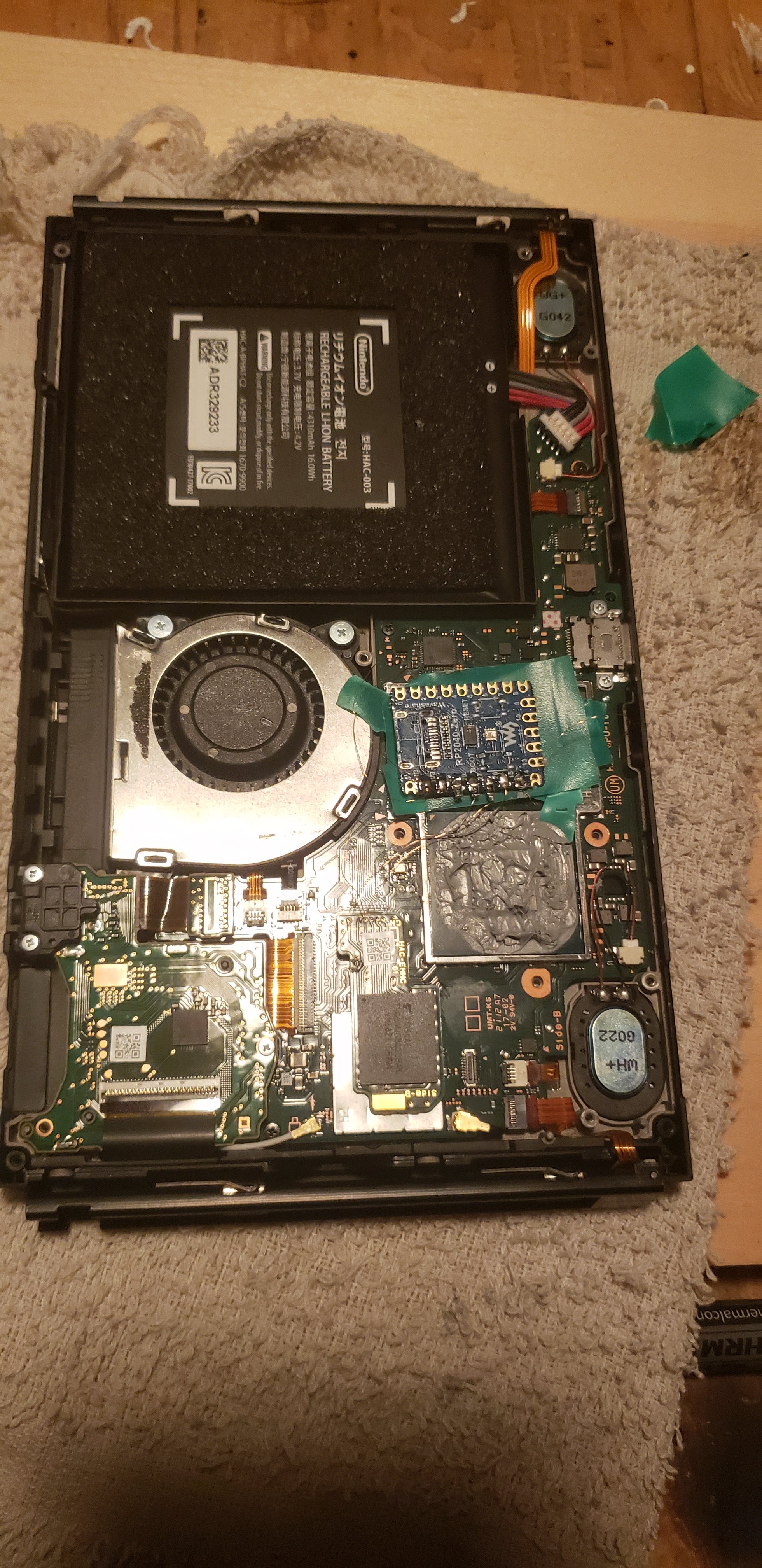

I did everything but when I try booting it the led:
Blue/pink then nothing and then stay on blue, there isn't any sign of life from the switch so what did i do wrong?
Btw the 3.3v resistor got off and i put it back so that's maybe an issue?
Shot a photo, only this we can help you.
I couldn't really get any clear pic
It's blue for 3 seconds, then pink for 0.2 seconds.
Then usually stays on blue
Btw I used a mosfet and the wires are under the thermal paste and tape
I connected everything on the emmc board and connected 3v and gnd to the resistors on the second picture
I don't have an idea why it's written 5•3 on the switch..
This time it got blue for 3 seconds, then cyan for 0.5 seconds.
Before it was pink in place of cyan.
Do that means that i have a bad cpu / clock ?
Add more thermal paste
if u get cyan that means u need to check ur cpu pi u might have to install a second mosfet
