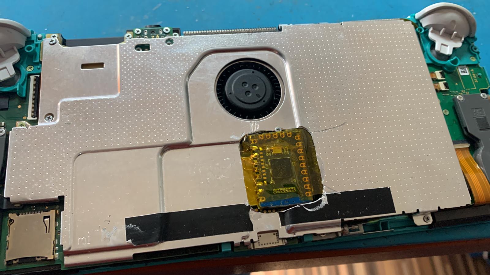

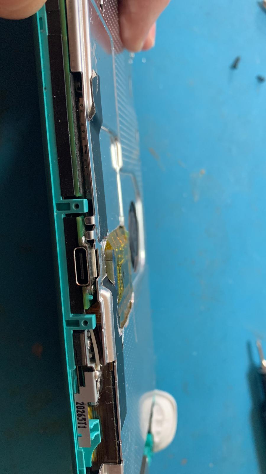

good afternoon colleagues I have the rp2040-one but when I pass the 2.6 or any files thegood afternoon colleagues I have the rp2040-one but when I pass the 2.6 or any files the led does not turn on
Those are 47 000 Ohm. Use this and choose 47 Ohm: https://a.aliexpress.com/_mPVFw1q
You could even use 1/4W resistors, but you'll struggle to fit them. The 0805 fit quite well on the Pico pins, I imagine that you could get 1206 working as well. Show us some pics when you get it installed.
Finally I used the 1206 ones.

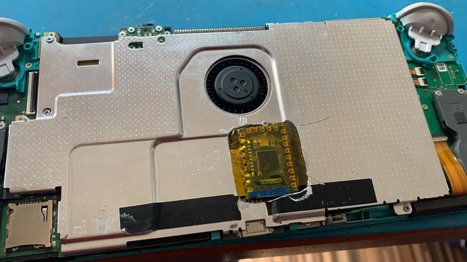

Yes it works
rp2040-one working since 2.6 alpha FW.
I have cut off USB connector after flashing via USB.
Later updated via Picofly toolbox to 2.61. No problems so far...
