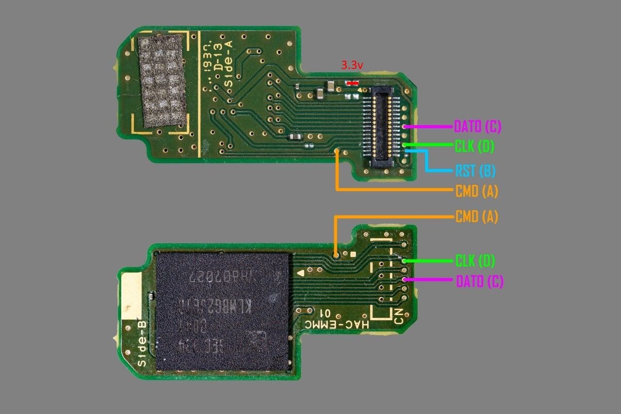

I accidentally ripped the dat0 pads off my v2 switch is there another point I can solder to to fix it?

Take it from the EMMC, the rear side.
See First post.
https://gbatemp.net/attachments/pinout_emmc-jpeg.360378/
You will have to see if they are not interrupted encouraged, in this case you will have to carry out a jumper to restore the correct functioning.

u dont have to u can use one wire i used 2 its not more u can just bridge them thats good enough .
i just put 2 in the picture so everybody knows/understands it better
Here
clean it very good make sure u see copper and see if i can get solder on it or bridge it other wise u will have to use
the point on the emmc u might even have to set a jumper wire to the point if u have issues with the emmc.
u need to use lots of flux and dont use to much heat with ur soldering iron and one u solder the cables put some uv mask on the wire so it gives it a bit strentgh and its a "tiny Bit " harder to rip those cabels of
