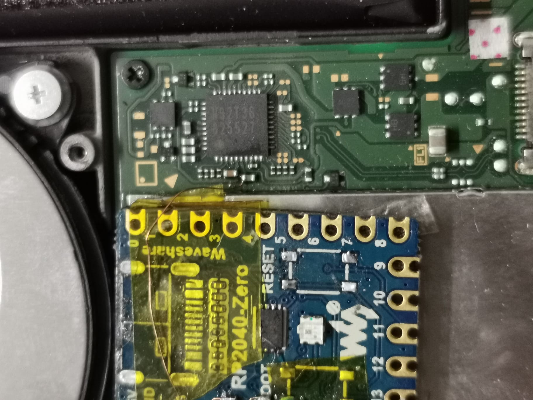

Hi, I have do a install of a rp2040 zero on a switch light, I'm not at my first I have done a lot of sx/hwfly install.
I have 2 rp, one that I have flash wit 2.5 with the unlock include, and the second one with the 2.6a on this one I need to strap the 2 point on the back.
with the 2.5 I have my green light but nothing on screen just a black screen and with the 2.6 I got my red light but again blackscreen. If I remove everything the switch start normally. My emmc is a samsung.
What I should try to got a boot ? Thank you for your answer
Edit: I have found my problem, I was taking the ground from a coil and this is why it,s doesn't boot, now that I take ground from a cap everything fine !

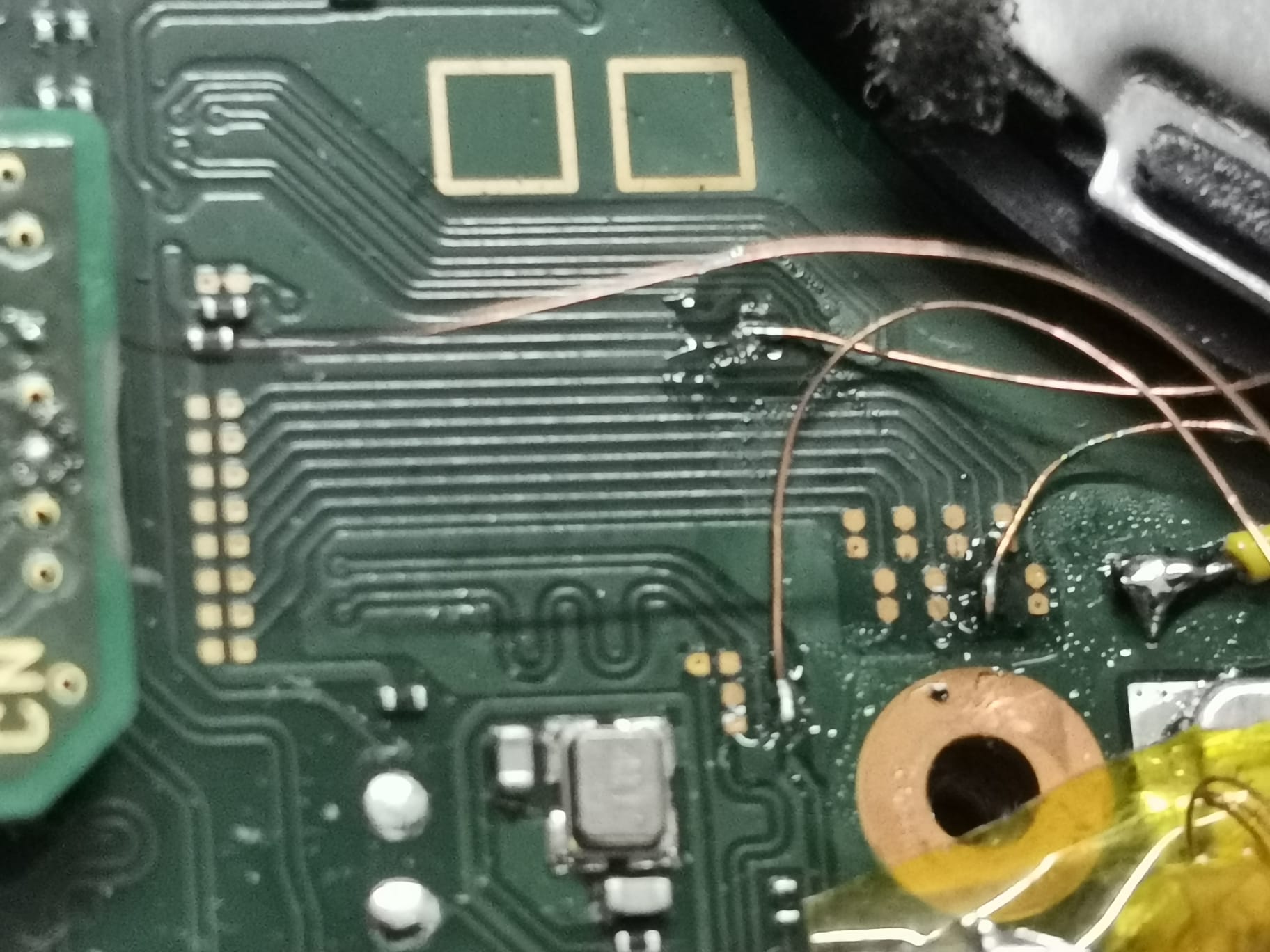

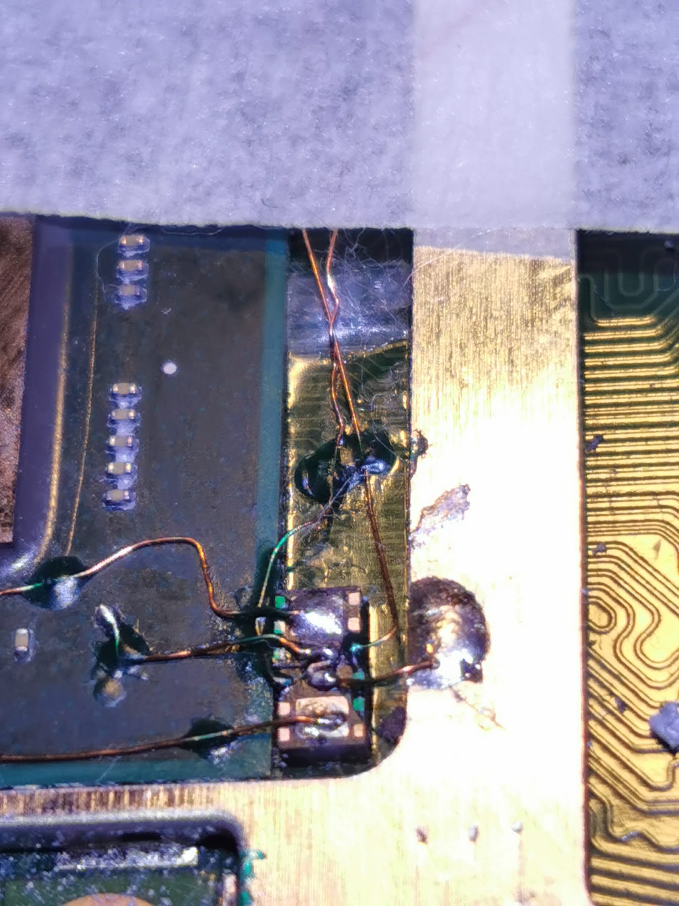

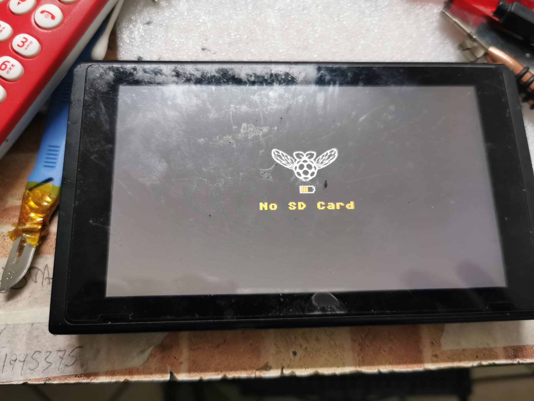

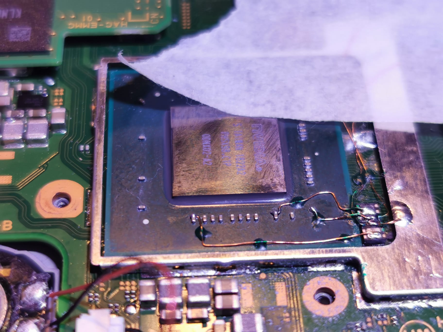

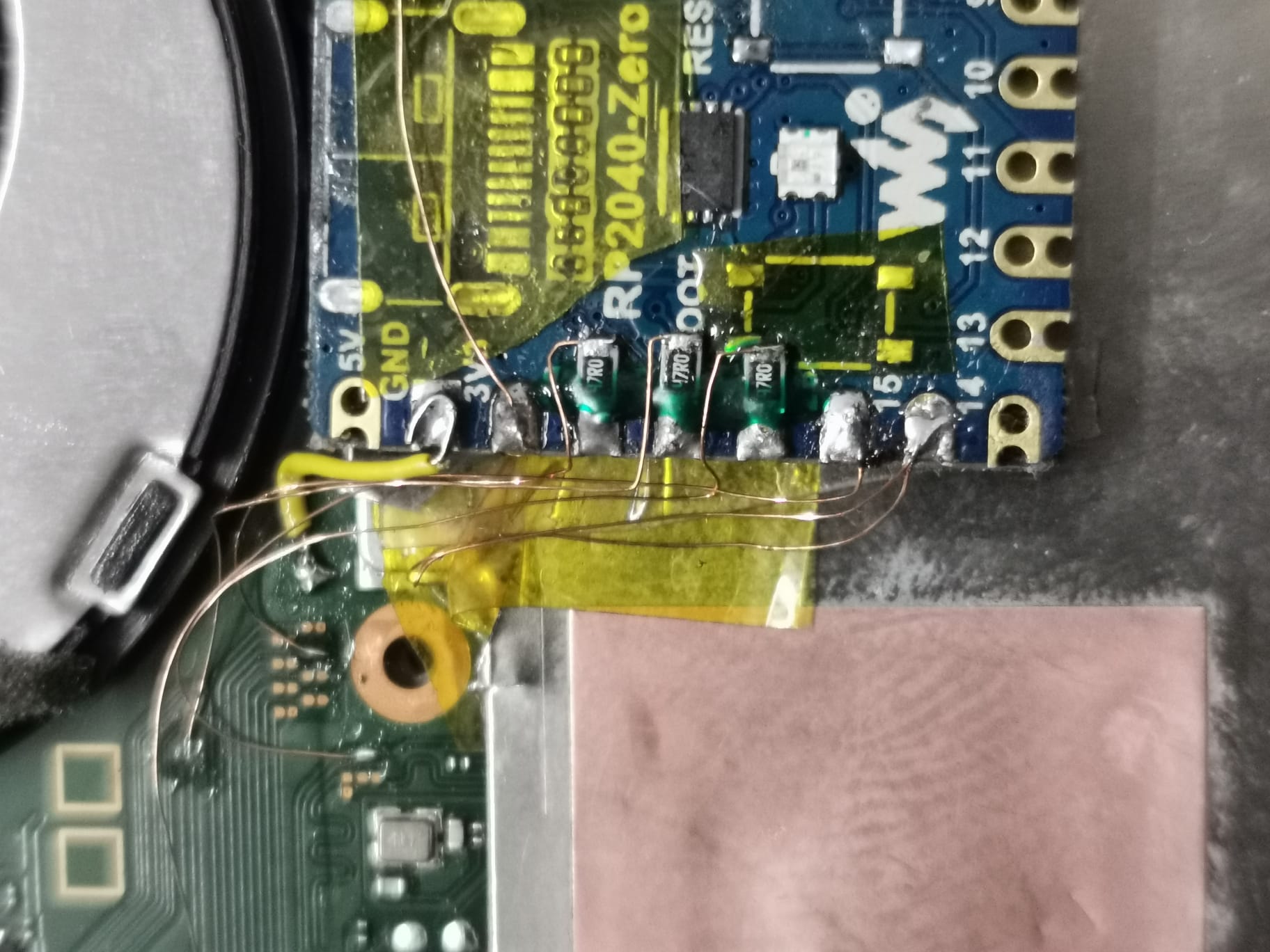

Guys, I installed the rp2040 chip (fw 2.61).
I attach photos.
I can't find the guide to finalize in the first post but edit and prepare the sd and all the rest.
I'm stuck on the screen below. (see attachments).
Also posting the work I've done, I'd accept suggestions for improvement. Thank you
