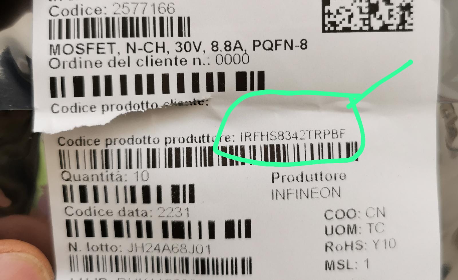

Guys I already asked this before:
I would appreciate some help.
1) Is it currently convenient to install FW 2.5 and 2.6a?
2) Before carrying out all the operations (chip installation) do I need to format the console?
3) Once the chip is soldered, how do I prepare the sd card for the whole procedure?
I would appreciate the links to the guides. Thank you.
4)The mosfets that I ordered (see attachments) are the right ones (the last abbreviations change)
