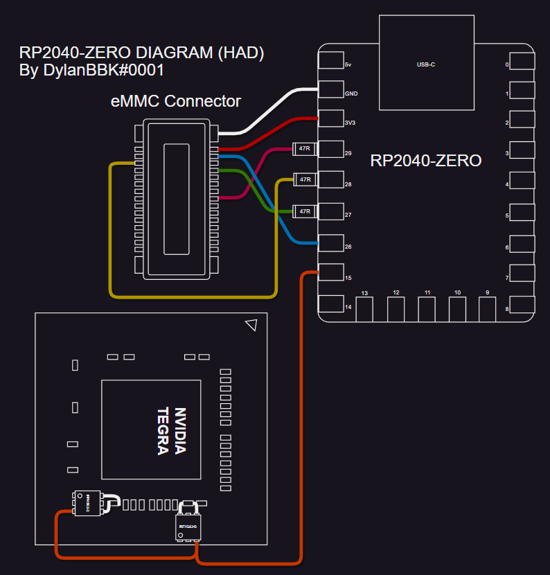

Hi, gonna get my local guy to install the picofly on my v2 switch this Saturday. He told me that he ran out of v2 flex cables but it was still possible for a v1 flex cable to be used with an RP2040 zero. Is there anyone who can confirm it, can he legitimately install it with a v1 hwfly flex cable?
CAN be done, but won't be a standard install with the cable. He's likely to solder wires to the pins on the flex cable and run them to the caps on the APU.
Exactly, I tried that way but it make no easier than just solder the mosfet on to cap instead of using incompatible flex

how to set "RGB mode" jumper? which pin points should i connect? i get green led when i paste the uf2
Well, you were quite close to finding that info, it's nearby the phrase that you quoted, under the Images --> solder points. Short the two pins on the back and you should be good. Happened the same with my Waveshare Pico.

Do you mean 0805 smd resistors because I can’t find 8050 resistors anywhere ?
Also how does one set RGB mode jumper?

yes he means 0805 resistors
ceck the first page of the thread there are images from the rpzero wher u set a bridge for the rgb mode .-)

Can I still use 2512 SMD resistors ?
Also to set the jumper do I just have to solder a wire between the two points?
