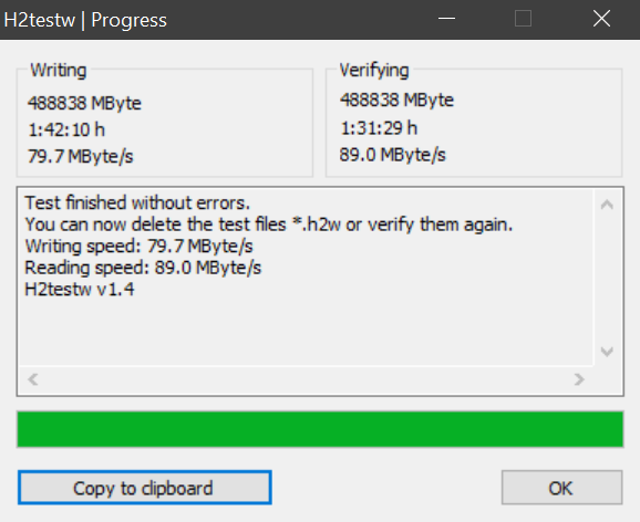

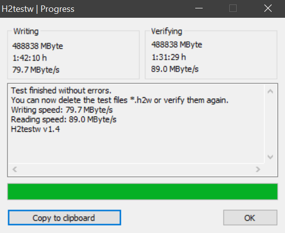

I would test it with H2TestW to see if you maybe have a fake one.
It seem original when I bought it, original package and not opened or smth like that. The test:
Test finished without errors.​
You can now delete the test files *.h2w or verify them again.​
Writing speed: 79.7 MByte/s​
Reading speed: 89.0 MByte/s​
H2testw v1.4​

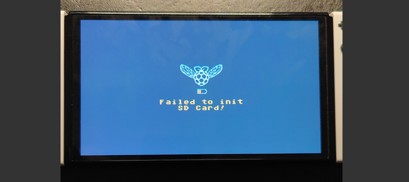

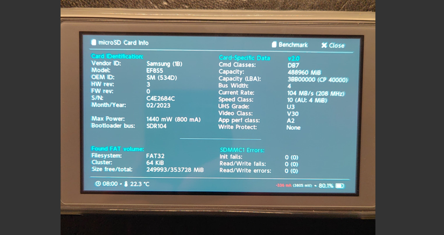

"Failed to init sd card!"; Apparently a problem with SD card 512gb Samsung Evo Plus
I dont really know if this is the place to ask issues but in case anyone has a clue of what is happening Im copying-pasting the post I put in this github about this (github/CTCaer/hekate/issues/899), apparently more people is having the same problem:
Having the same problem on a friends switch OLED with the picofly,​
Ive tried installing the HATS pack in the card in case some corrupted file but it always show the error "failed to init sd card"​
Also, trying that same pack on another SD card (a sandisk one) works perfectly.​
I dont know what could it be but it happened from one day to another without an apparent reason, and what is more curious, I personally have a switch lite with the same chip and the exact same card bought on the same place, and it still works for me.​
I dont know if it could be a manufacturing error but makes no sense because the PC can read the card and its files perfectly.​
I would appreciate any ideas in case someone has some clue about what can be happening​
(Attached photos, one from my lite with the card info and the other from the oled displaying the error)​

You said you've used the standard hekate + atmosphere, and the problem exist.
My cheap guess is about the power supplied to the microsd reader.
Maybe those 'faulty' microsd need a higher power than the 'ok' microsd.
The power ic might degrade, which is common issue on digital device.
On smartphone its common for the power ic degrade and fault eventually.

Hold on, what points are your chips using? Could it be they're drawing power from the SD card slot? That might explain the issues with SD cards with higher power requirements.
