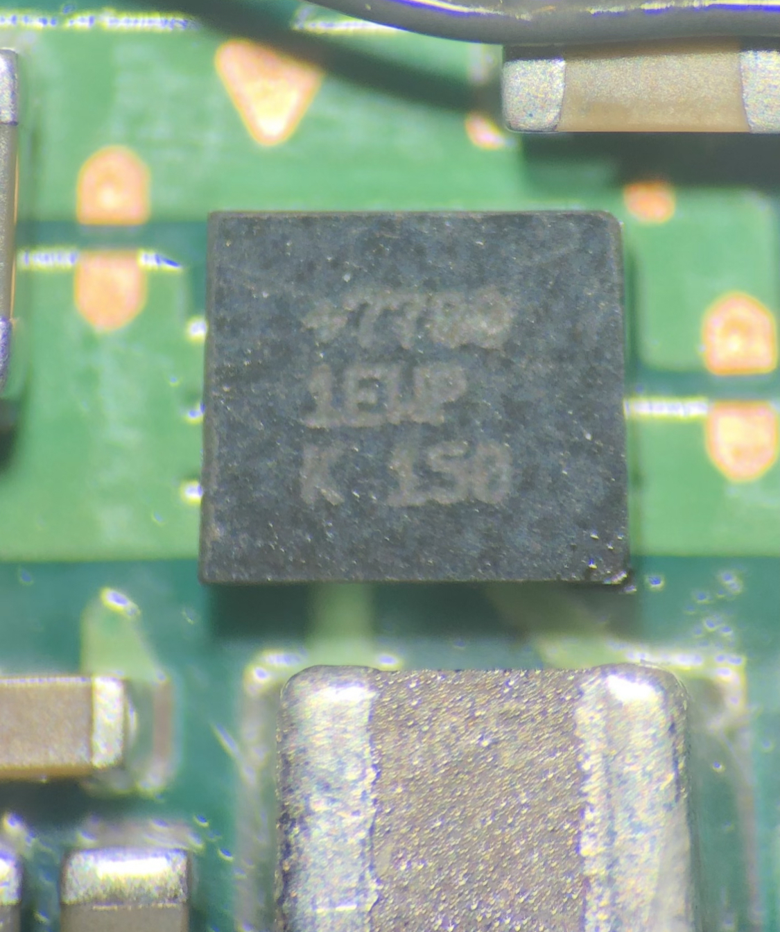

Do the console boot without the chip? If not check the 3.3v rail if it is shorted or not. If it is not shorted check the voltage when you plug the power cable in to see if the 3.3v rail give you 3.3v or not. If it is not then check your 3.3v regulator.
The console is at black screen, even with chip removed.

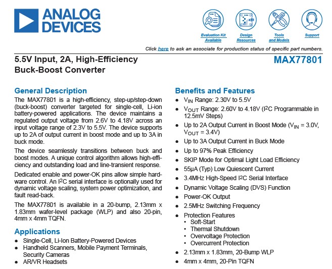

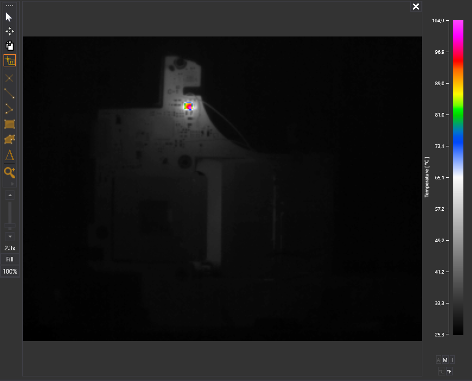

I followed your suggestion and got an "overview" with the thermal camera, you were right! It looks like it's +7780 1EWP IC, which seems to be a buck converter for the +3.3V rail I imagine. Thank you for your help!
I attached few photos, it started to overheat as hell with only battery connected.
Does anyone know where I can source this IC's easily (withou Ali waiting time)?
https://www.digikey.it/it/products/detail/analog-devices-inc-maxim-integrated/MAX77801EWP-T/5232976

Could anyone confirm if this is an inductor and not a capacitor (under +7780 1EWP) voltage regulator? It results shorted in my case.

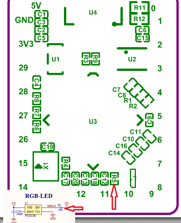

Hi guys, I'm new here, I would like to make the picofly joycon led mod on my switch Oled, but I only see a diagram for the switch lite, does anyone know what points I should solder and what is needed?

I'm sure you created a short circuit during the trial and error process of your installation. There are more than 30 installations in Oled versions that I only use single-sided installation and always with kamikaze mod. This way you reduce the chance of damaging something on the console by half. Not having to risk damaging the screen connector is a big advantage.Me and several Moders who appear on YouTube have already been victims of this failure as it is very easy to damage a connector pin and the console stops showing image.Replacing it its very triky and take many time. The Kamikaze method is 100% safe. All you need to do is carry out the process very calmly and with several interruptions to evaluate the layer of the motherboard that you have already drilled. All you need is a good mini drill and a 0.2mm tip. Desoldering the Nand and reballing increases the thermal stress on the component and drastically increases the risk of something being poorly welded. Your problem is probably due to a short circuit caused by the Nand welding that interferes with a voltage line on the +7780.
