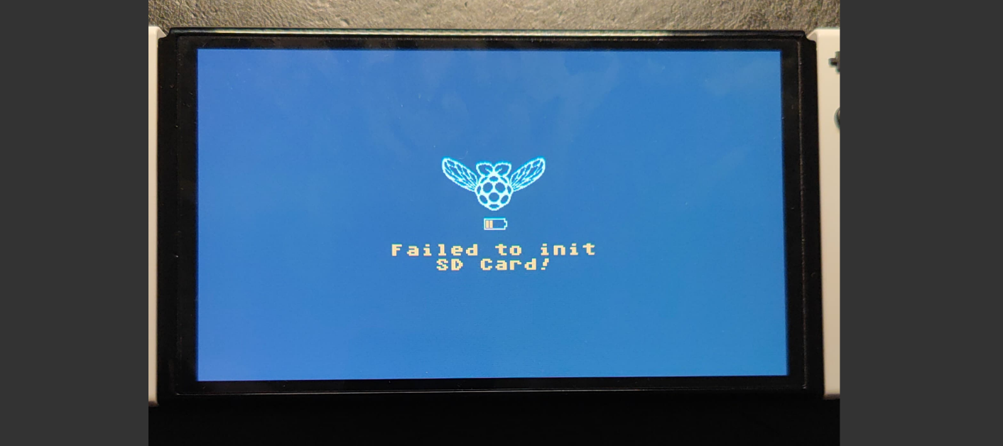

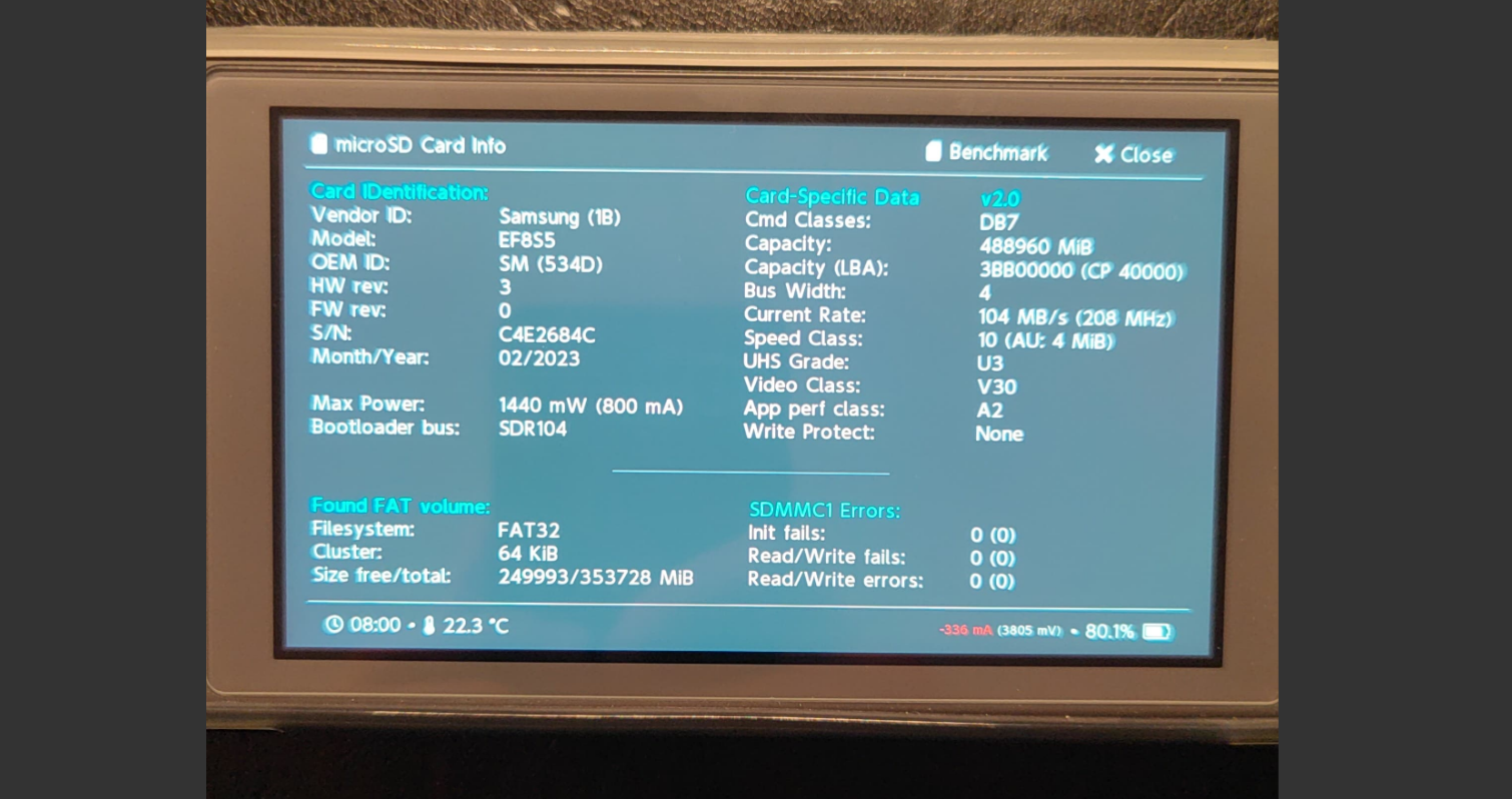

"Failed to init sd card!"; Apparently a problem with SD card 512gb Samsung Evo Plus
I dont really know if this is the place to ask issues but in case anyone has a clue of what is happening Im copying-pasting the post I put in this github about this (github/CTCaer/hekate/issues/899), apparently more people is having the same problem:
Having the same problem on a friends switch OLED with the picofly,
Ive tried installing the HATS pack in the card in case some corrupted file but it always show the error "failed to init sd card"
Also, trying that same pack on another SD card (a sandisk one) works perfectly.
I dont know what could it be but it happened from one day to another without an apparent reason, and what is more curious, I personally have a switch lite with the same chip and the exact same card bought on the same place, and it still works for me.
I dont know if it could be a manufacturing error but makes no sense because the PC can read the card and its files perfectly.
I would appreciate any ideas in case someone has some clue about what can be happening
(Attached photos, one from my lite with the card info and the other from the oled displaying the error)
Did formatting the card on a PC help? Also, which firmware version does that PicoFly have?
I formatted it in exFAT and FAT32, neither worked.
The chip had 2.74 and I reinstalled 2.73 to see if that would change anything, it didn't work either (I dont think updating to 2.75 would change smth)
I even copy another card that actually works into the samsung evo one, with a programm i believe it literally clone the sd (HDDRawCopy), guess what, nothing, the same error.
