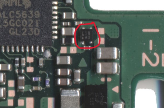

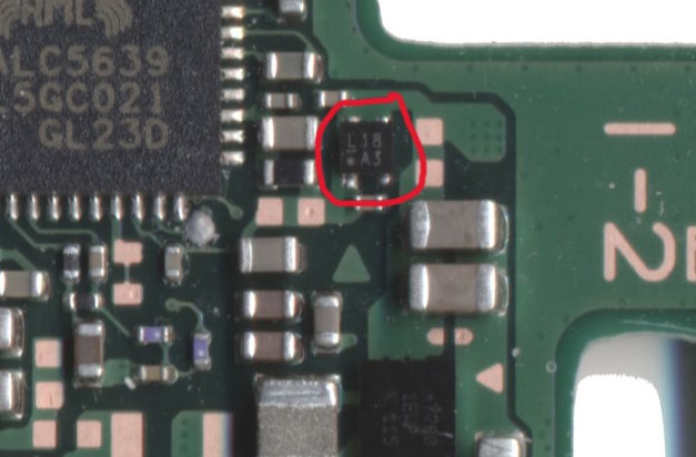

Guys, I shorted the 3.3V line with this component that I marked in the photo and it swelled and burned, resulting in uninitialized NAND. I'm not finding what this component would be... In the photo it says L(underlined)18 A3 but I don't think so.....can you help me?
I would start by checking the dat0/cmd resistors (on the chip pcb). if they are 47 ohm they should be replaced with 100 ohm. if this doesn't help i'd try reseating and cleaning around the dat0 adapter. if still no go, get an rp2040-zero or tiny and ditch the hwfly garbage
I think that is just a small voltage regulator (1.8v 3A) for the ACL5639 as it needs both 3.3v and 1.8v
