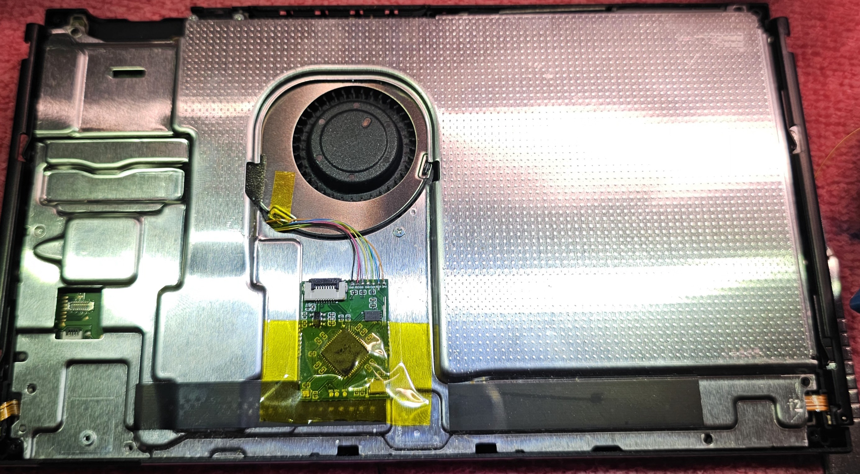

Another success story!
Picofly, kamikaze and a fet. I forgot to take a pic of the Picofly though(RP2040-Zero). Picofly has what i always use, 100/100/68R resistors. Almost instant boot.
No pic with soldermask, but it's there just like in Sthetix kamikaze video.
This is the second kamikaze i made. The first one was also successful with the drilling part, but i have some problem of temp and voltage not showing on Hekate, hence not booting to HOS. If i cannot find the cause, maybe i'll just make it an emulator machine, since maybe it can boot into Lakka.

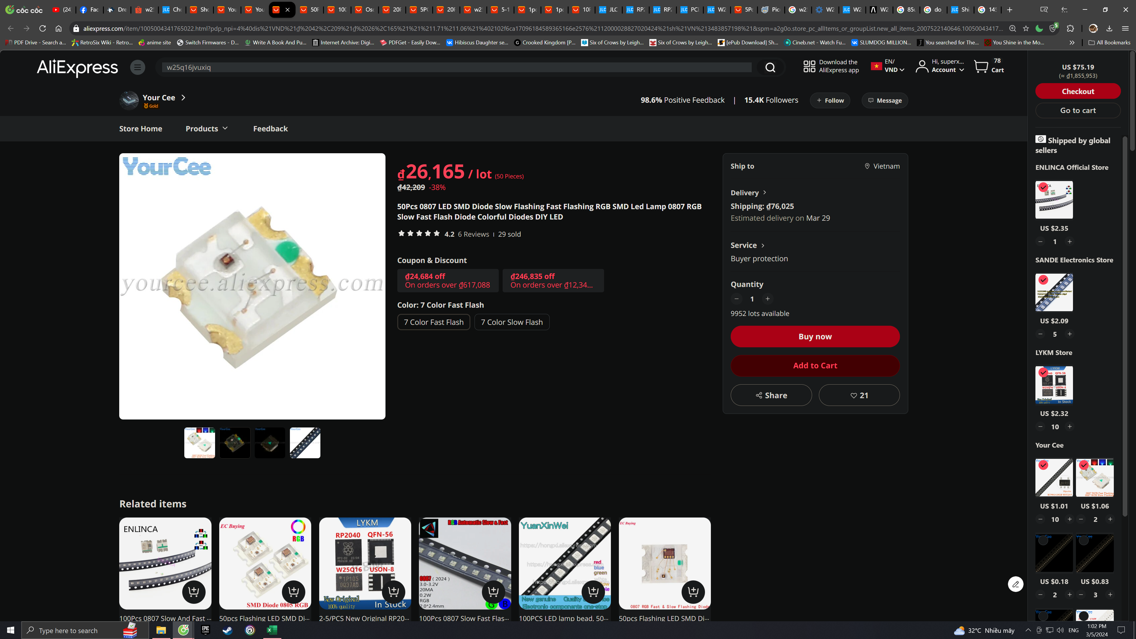

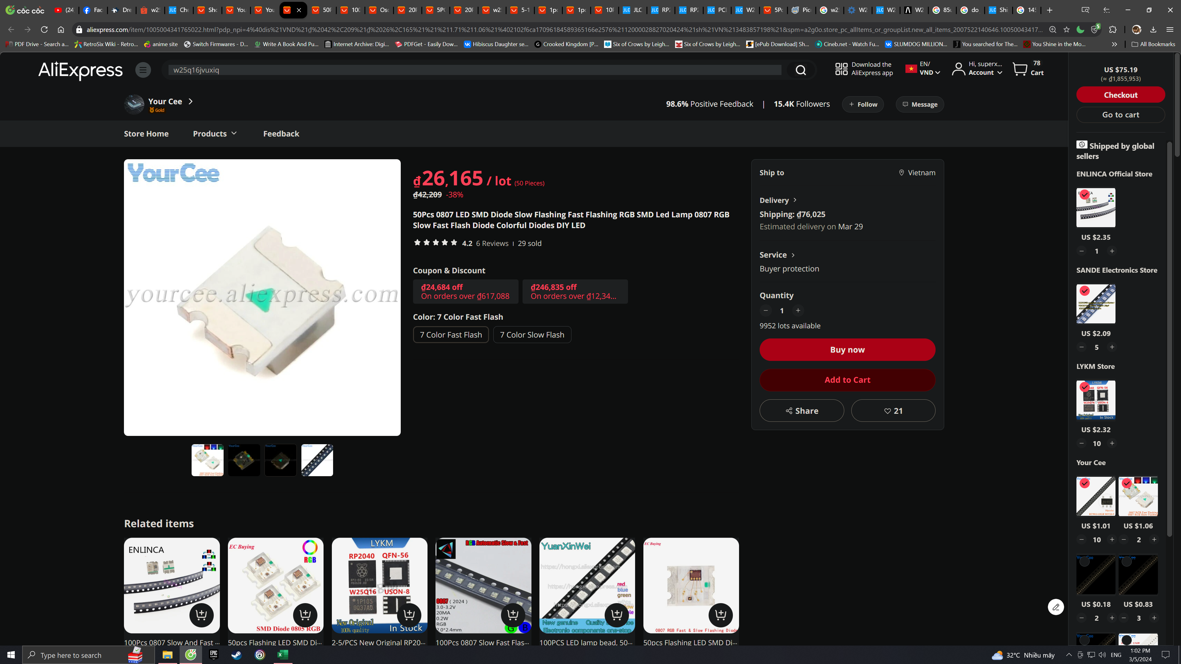

the only one i concern about now is the led one because i don't know if it is the right one can you tell me if this is the right one. thank in advance

The led size is okay, 0807 but make sure it is ws2812b rgb. Double check the datasheet
