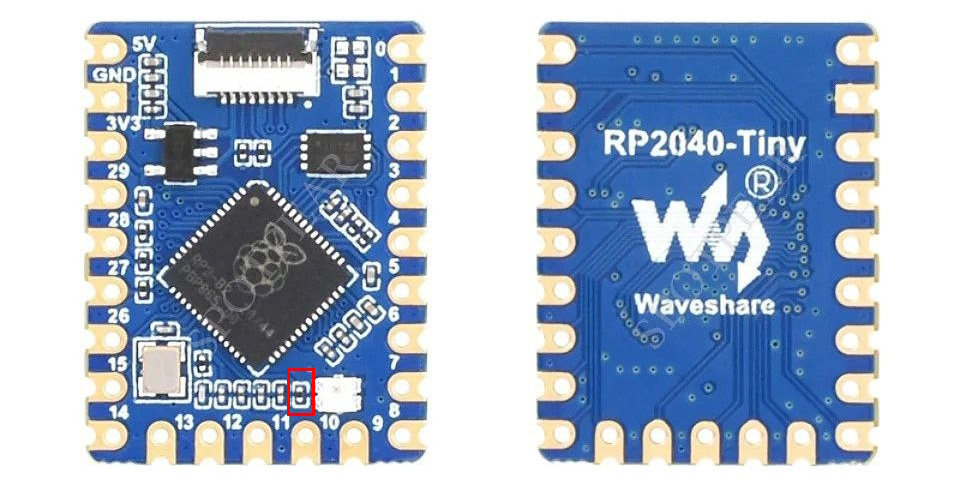

Wish I knew before making all these mistakes. The RP2040-Tiny seems to work and I'm now able to write to the nand without errors. Tried to rebuild the nand after watching the video and I'm still stuck at the Switch logo. This happens with and without launching Atmos. After a number of tries I get 2164-0501.

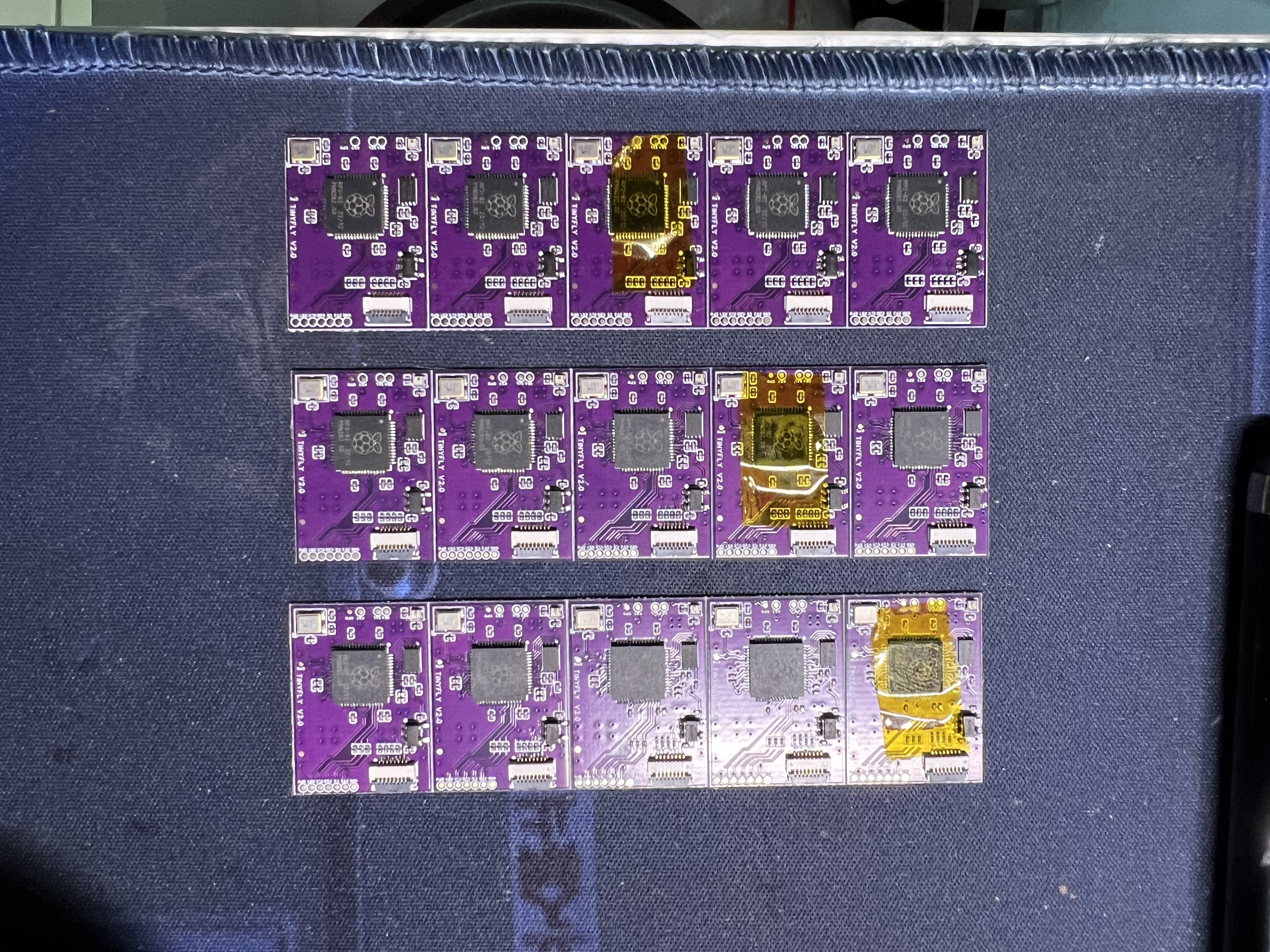

Tinyfly v2.0 - the layout is based on the well known rp2040-tiny from waveshare but made for switch.
1. All necessary pads are exposed and the LED DIN as well.
2. Resistors and capacitors are 0402 size for easier soldering
3. Default D0,CMD,CLK resistors are 100,100,47ohm respectively
I've attached here the gerber file and bom/pick and place files.
Updates:
Tinyfly v2.0.zip
- Initial Release
Tinyfly v2.0b.zip - Added extra pads for GND and 3V3 line on the right side. Swapped CPU and RST at the bottom part. Some components are changed to basic parts if planning to fabricate using JLCPCB.

They work great. 😄 If you wanna order with the components make sure to order more quantities to get the best discount. 100pcs will be 2usd ea including shipping.

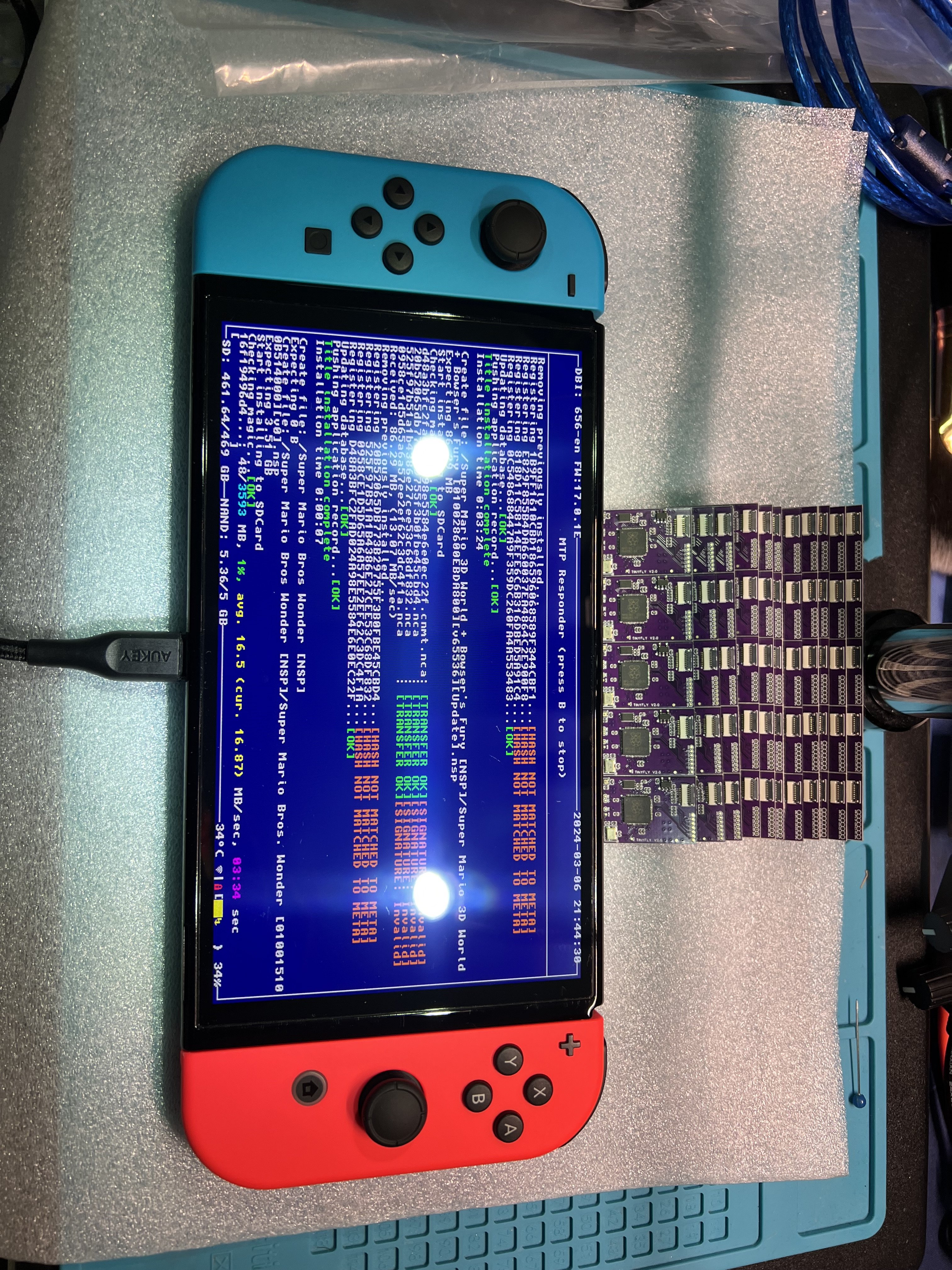

Got an OLED SKHynix, single mosfet on the back. Still trying to get through some of these bad chips, so I flashed FW 2.67 for the error code. I believe this is showing cyan, so is that just telling me to check the mosfet? Just boots to ofw.
Nvm. Got it. The wire from mosfet came off while putting it back together. No SD 😁

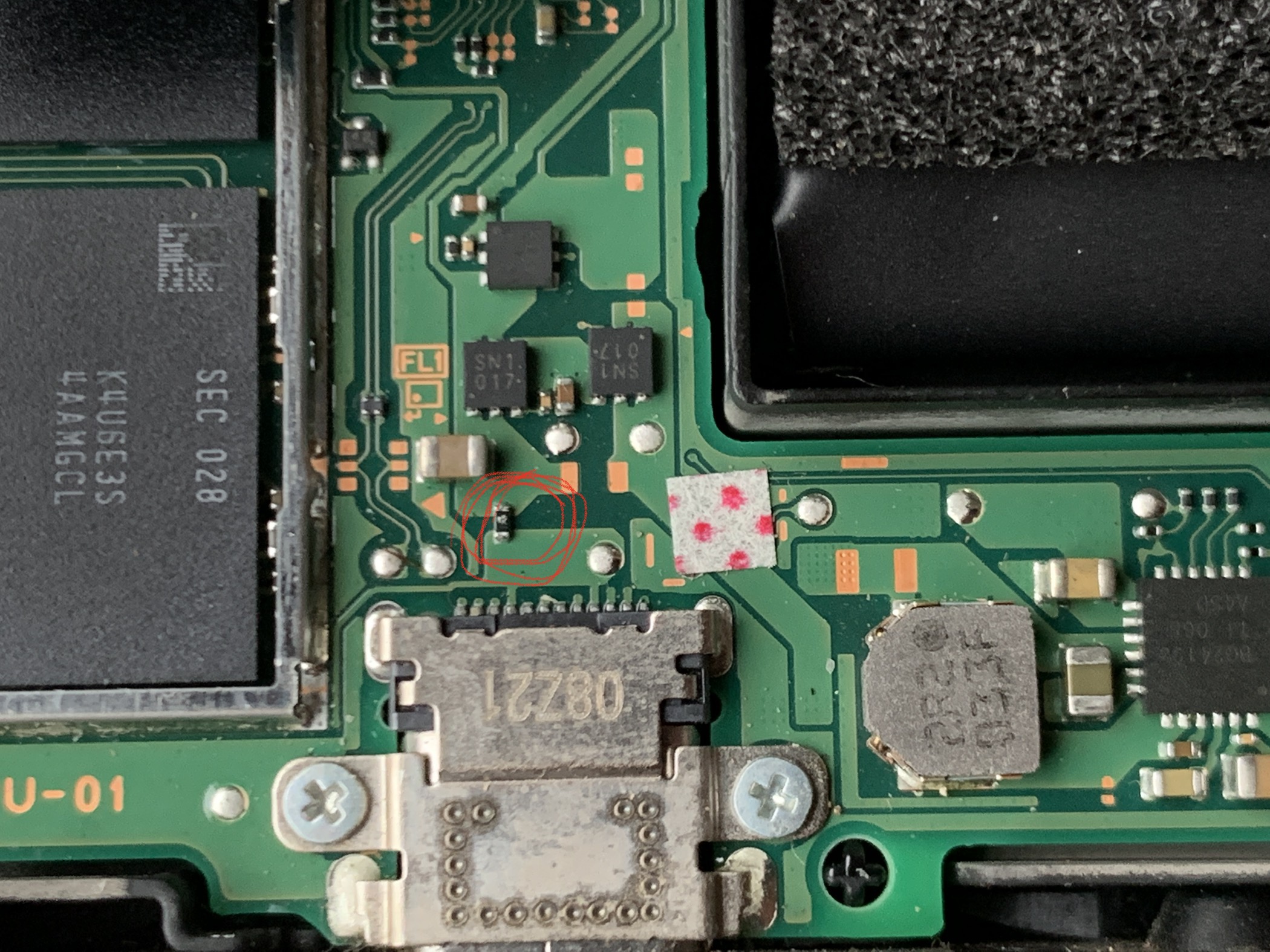

I accidentally short-circuited, and the resistance at the position of the red circle on the picture burned. Who knows how big it is?
