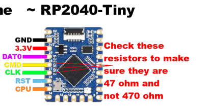

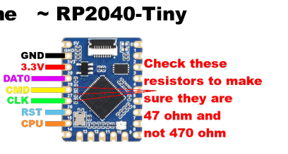

I'm gonna try to install the RP2040-Tiny instead of the Aliexpress one. Does the RP2040 Tiny not need resistors installed? No 47 Ohm resistors?
well, as you can see in the picture you posted, the dat0 clk and cmd points do have 47ohm resistors. It's a good idea to either replace them with 100ohm ones for dat0 and cmd, OR add additional 47 ohm ones on these two points.

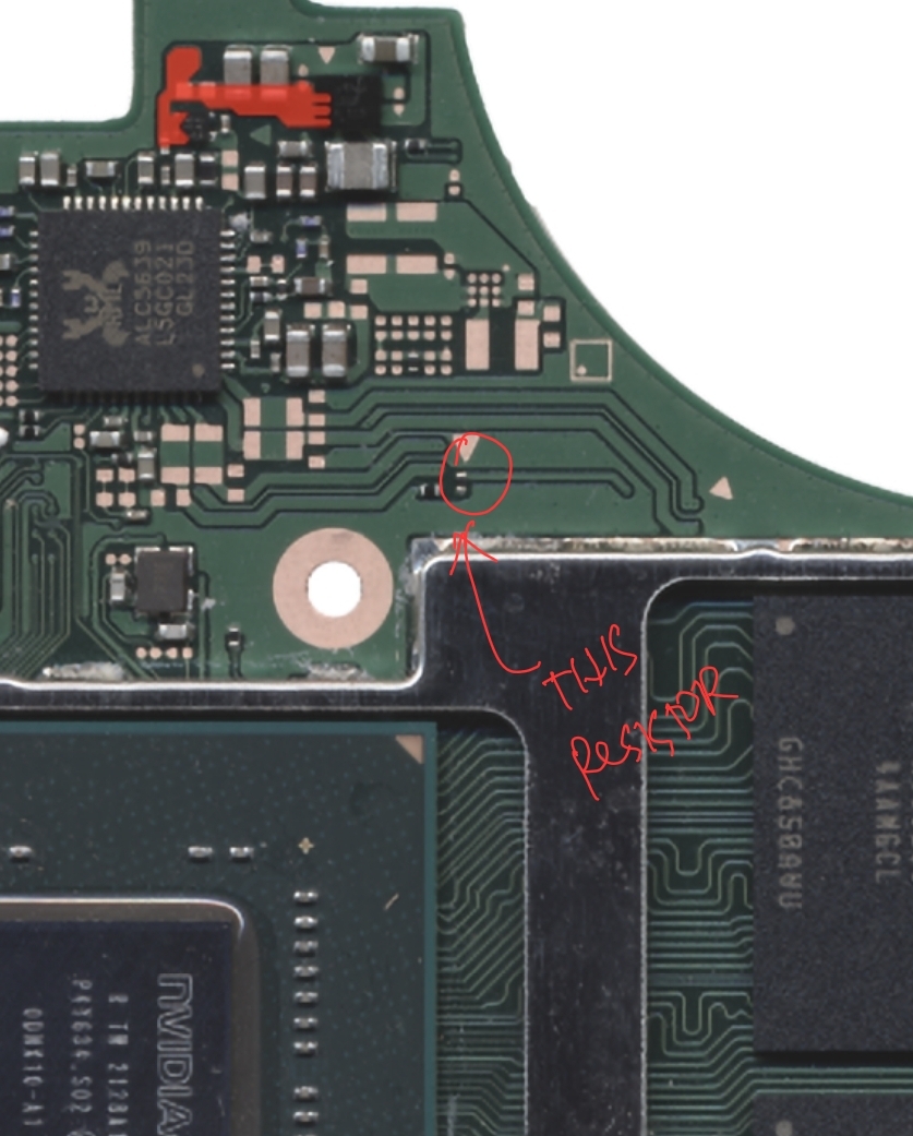

As I expected. The value is 4.7k ohm just for your info, not 47ohm resistor. Do not be confused about the resistor at the chip.
What you have to replace is the resistor on the switch board itself. Point A resistor.

May I ask the reason why it needs to be replaced?
What is the supposed stock value? I meassured it inline and get 1.1M Ohm
Because it is busted or you burnt it when you are connecting the point A and thus giving you purple screen error. That's the real reason for the purple screen and not the chip. If you have a hot air gun, you can try and reflow it, most of the time the solder connecting the resistor gets disconnected when you solder the wire.
If you will not fix it, then your switch wont work unfortunately even without the mod chip.
You can use 0402 or 0603 and wire it manually if you have difficulty with 0201.

tried reflowing the resistor with hot air but still 1.1M ohm.
WIll have to find some 0201 4.7k ohm resistors somewhere.
I guess 0201 is not so bad but this one sits in an awkward spot.
EDIT: removed resistor from board and meassured I guess it's burnt. No reading from it.

The cause is not known, but I assure you that (it has happened to me 2 times in my career) it is not due to damage to the resistor, at least in my case. In an emergency I even used a laboratory resistor, just remove the old resistor.
MM I actually soldered one side of the resistor to a lab board to be able to measure it better, if I measured it on the underside I got a 4.8k reading sometimes but not when putting probes on the sides or top. So my guess is that I perhaps burnt the metal.
