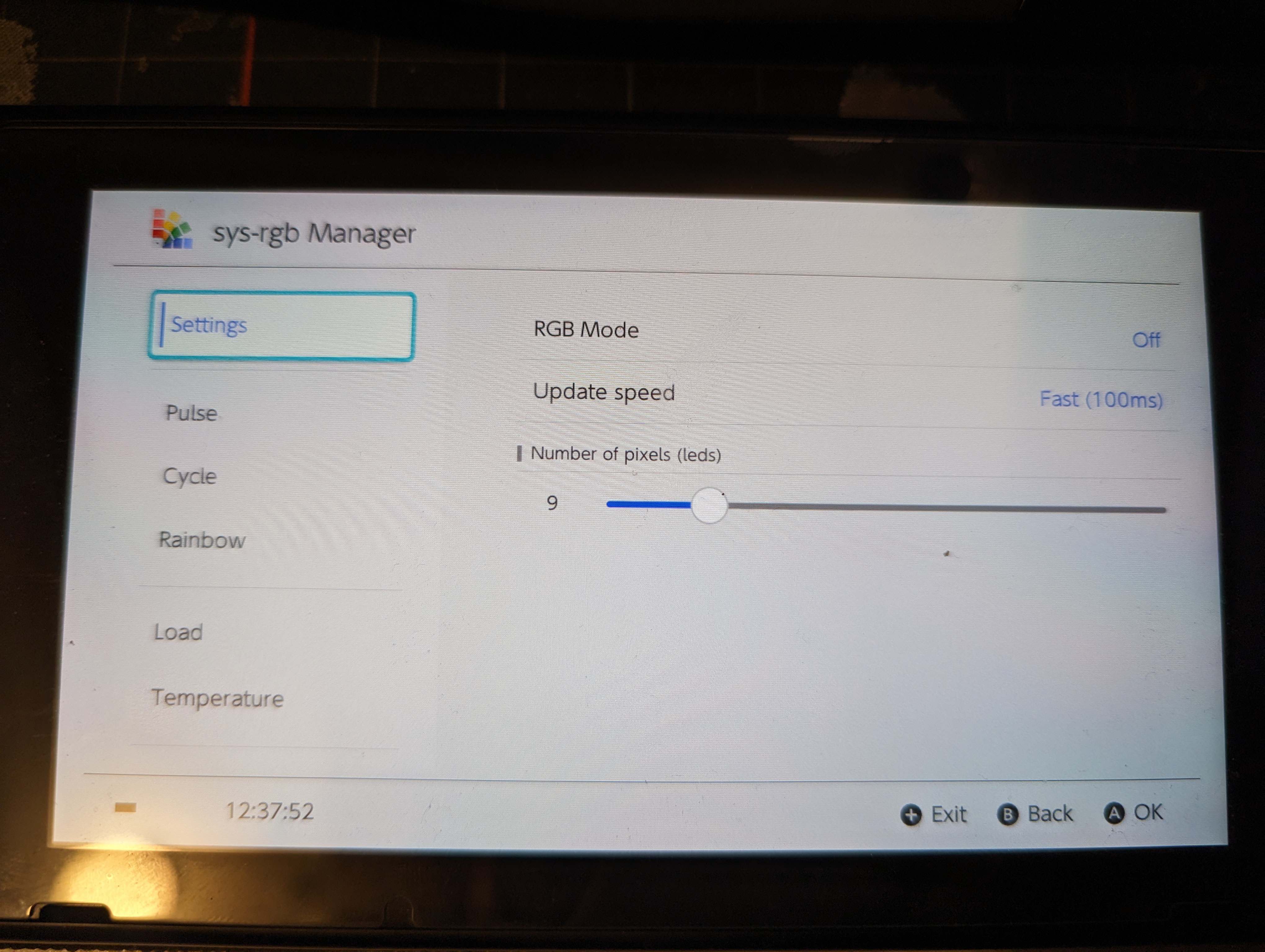

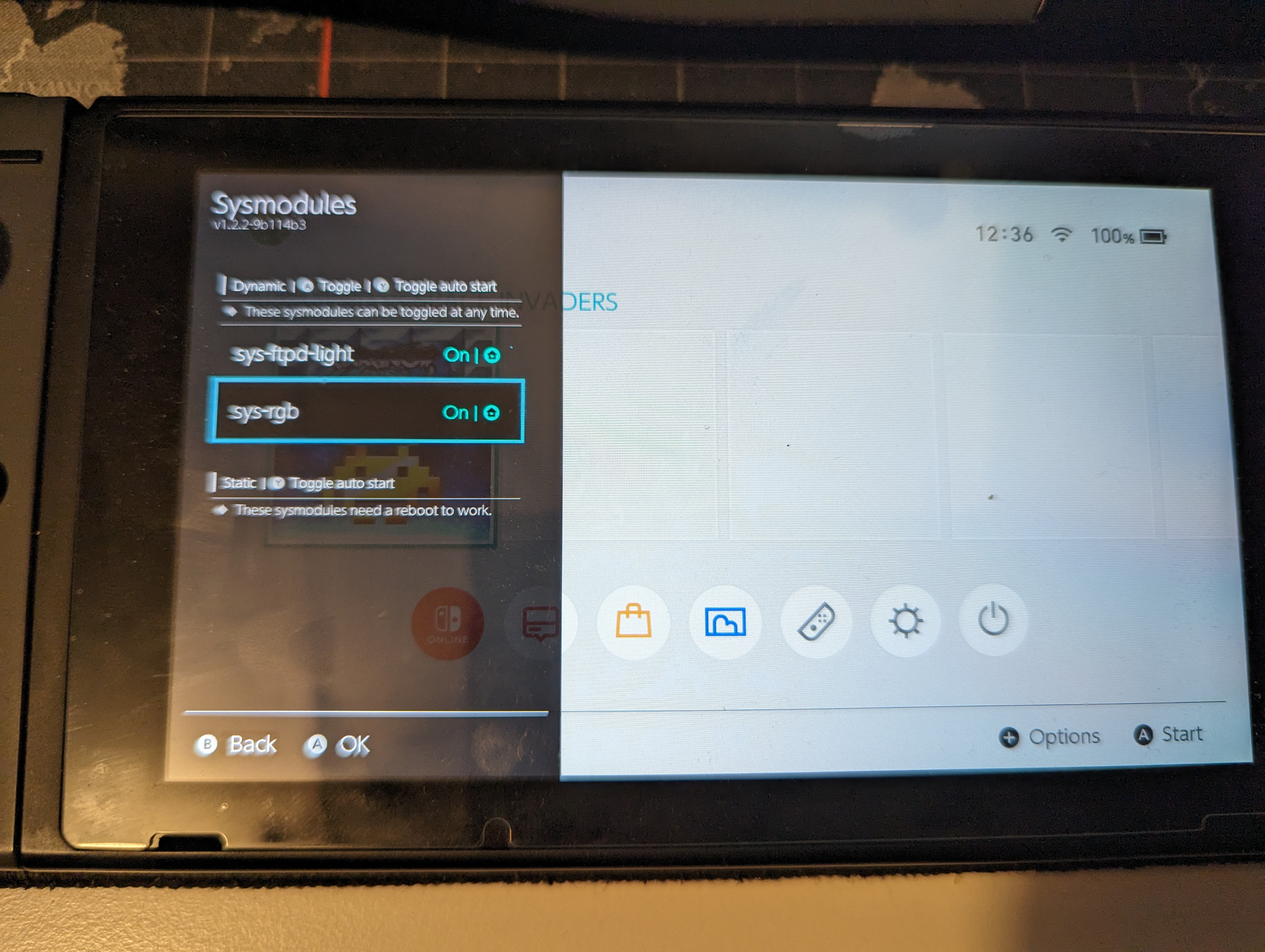

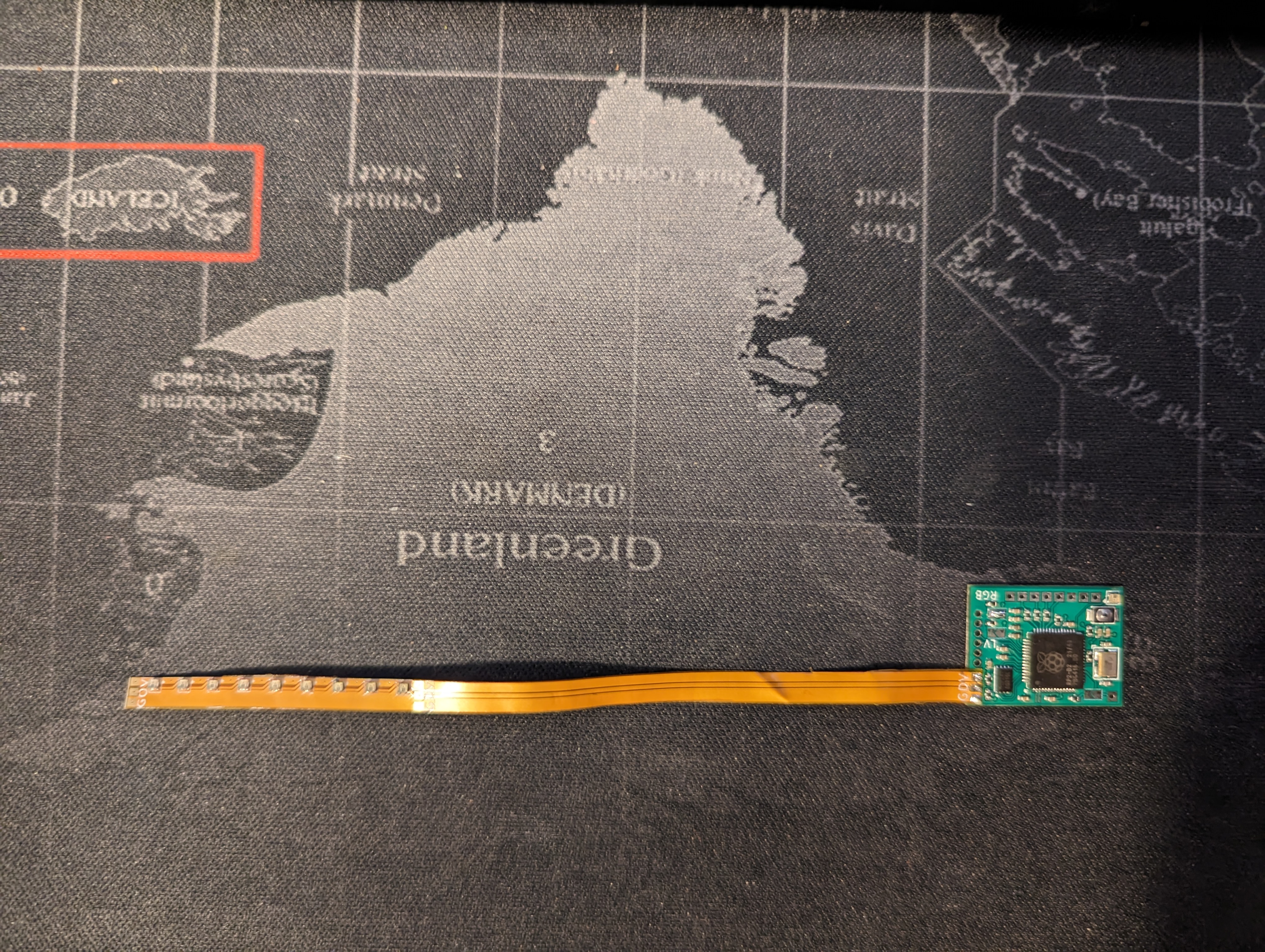

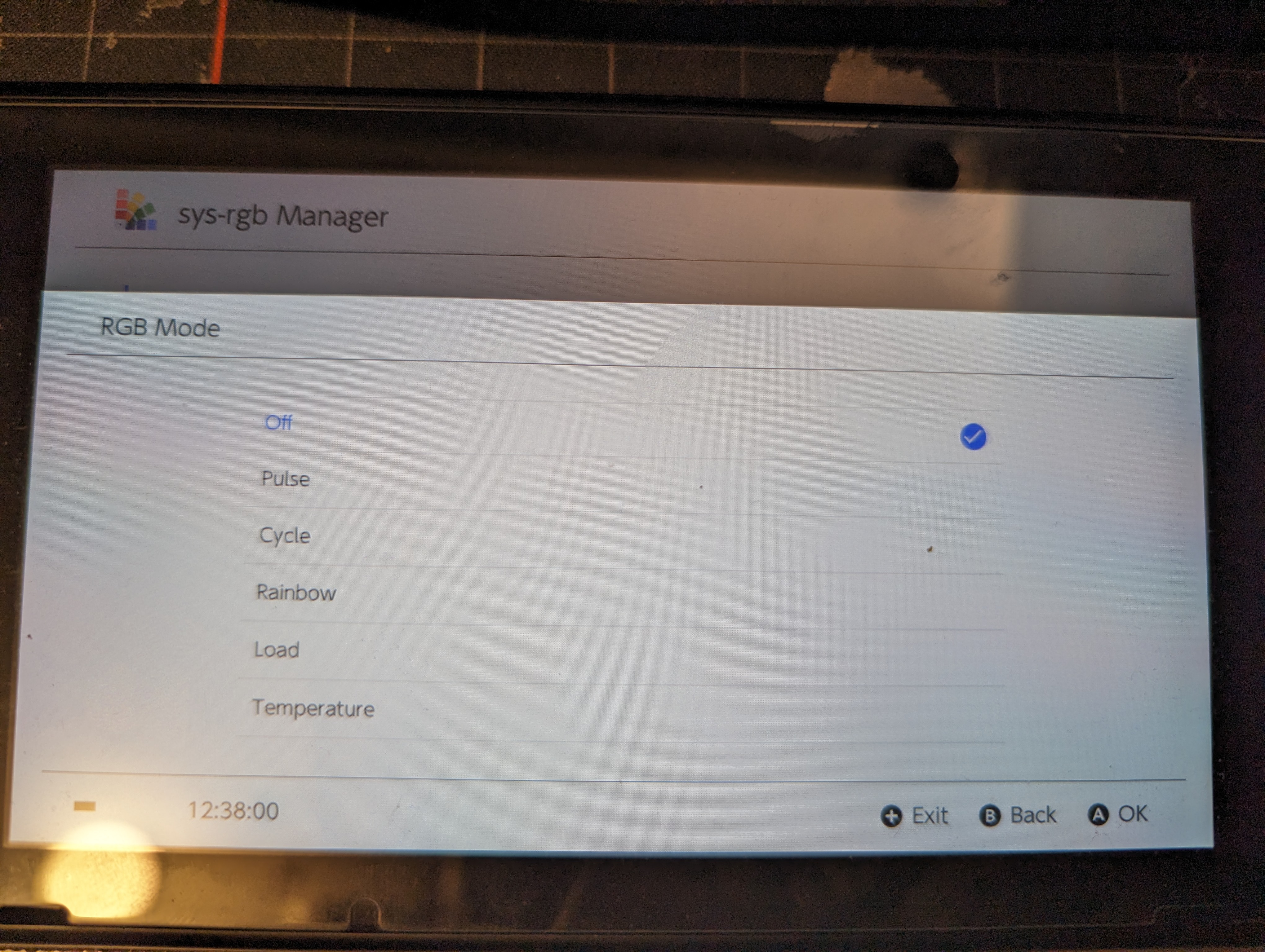

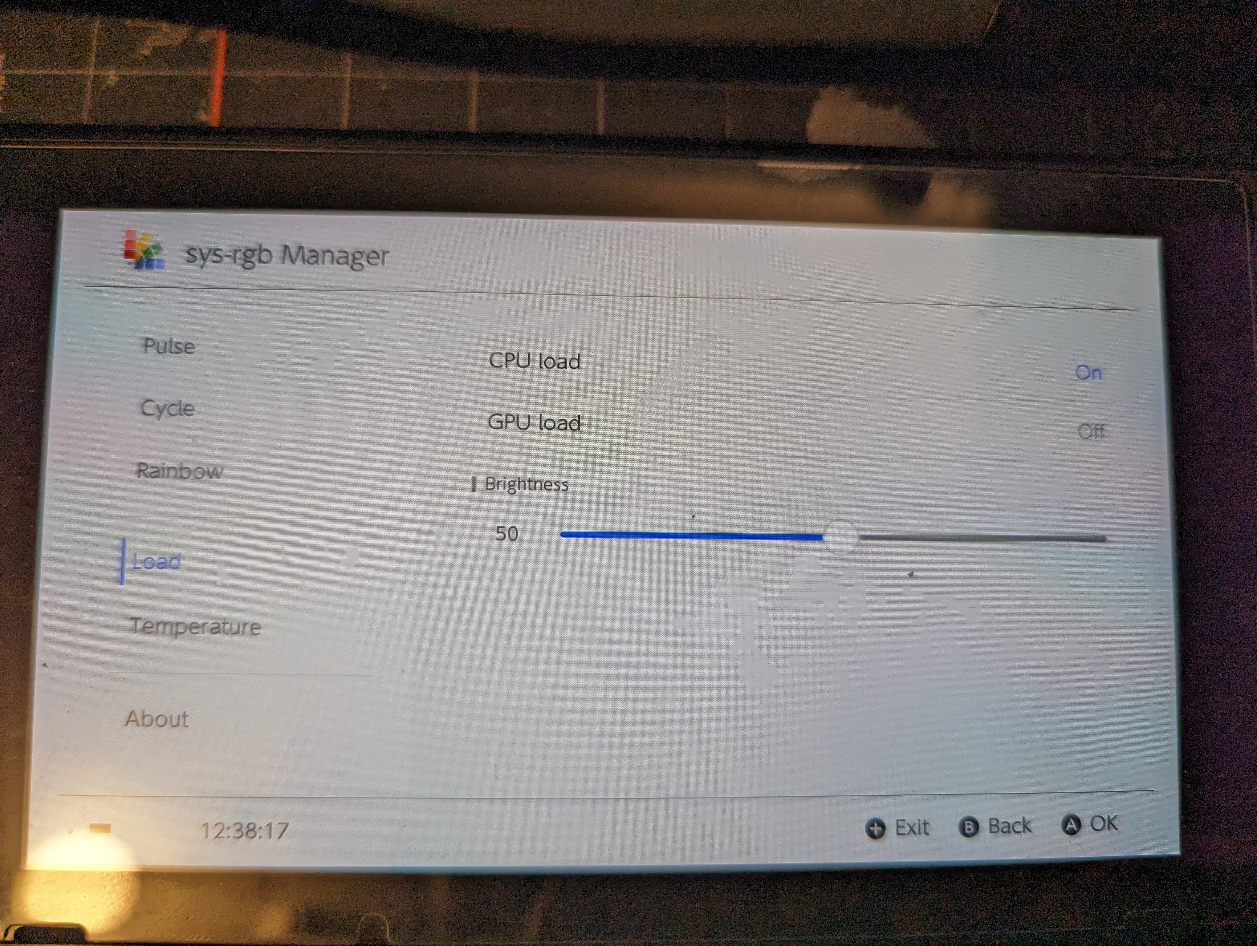

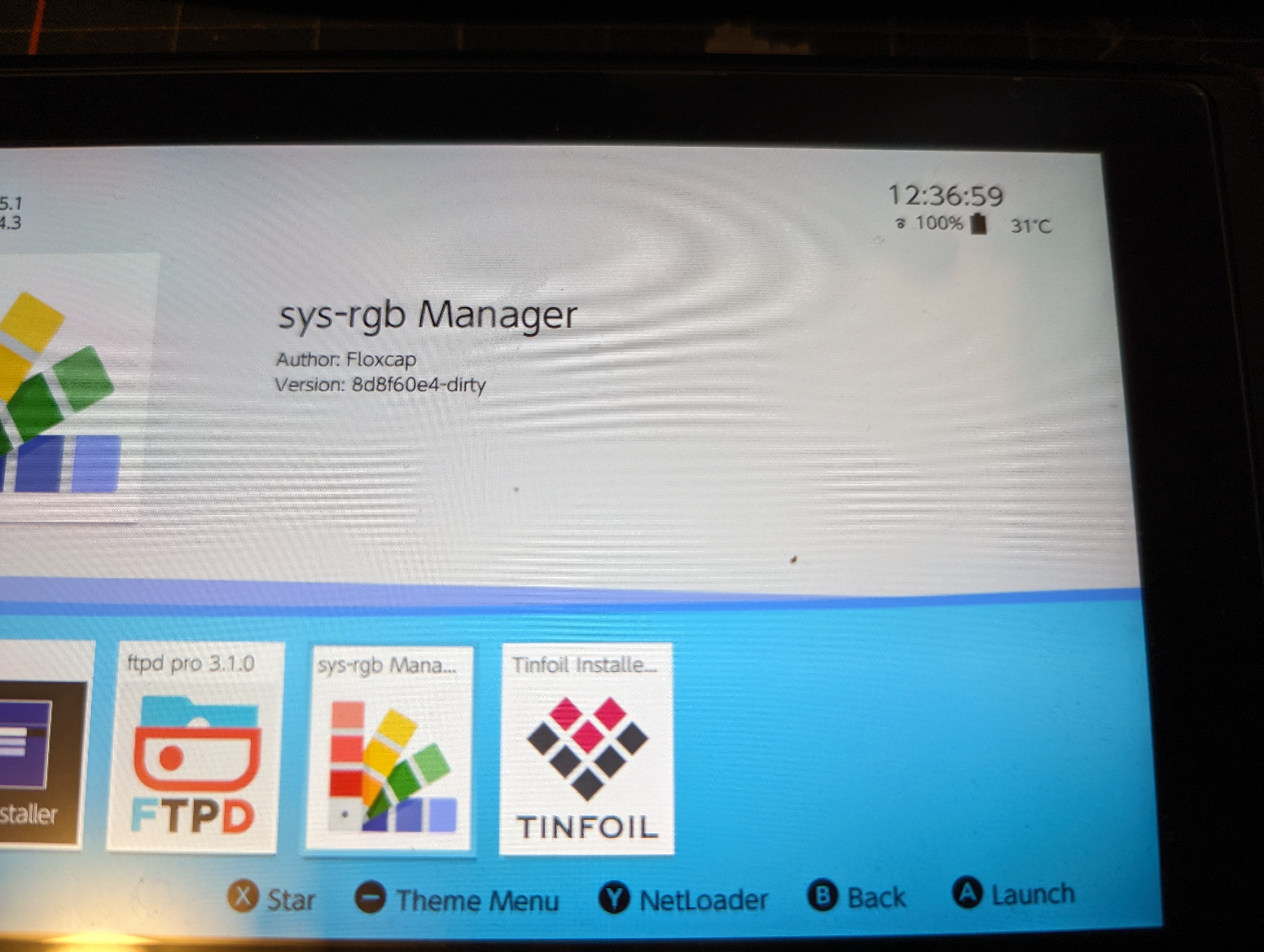

Sharing some progress on my WIP for picofly RGB bling... I'm planning to do a test install this weekend and will share some videos of the installed version once done.
Once fully tested I'll be putting everything up on git.
  • kicad RP2040 board + flex led strip (1010 RGBs - 1mm square).
  • sysmodule - monitor CPU load, temp etc & send data to RP2040 through I2C connection.
  • sysmodule also monitors stand-by / sleep of switch and turns leds off/on.
    (e.g. LEDs colour can be set show CPU load (VIBGYOR) - violet = low load -> red = high load)
  • App - configure mode for sysmodule.
  • Support for multiple led strips (maybe up-to 50 leds)
  • Updated firmware to support the above (mainly i2c mode after glitch).
