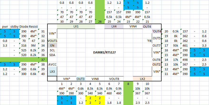

The UART error 8087xxxx are SSD related. I would check SSD pmic for correct readings.
Thank you for the suggestion. I have thoroughly cross-referenced all the readings from the DA9081/RT5127 map you provided.
My Test Results:
• Standby & Power-On Voltages: All rails (\bm{0.8V, 1.1V, 1.2V, 1.8V, 2.5V, 3.3V}) are present and match the diagram 100%.
• Diode Mode & Resistance: All readings on the pins match the reference values perfectly.

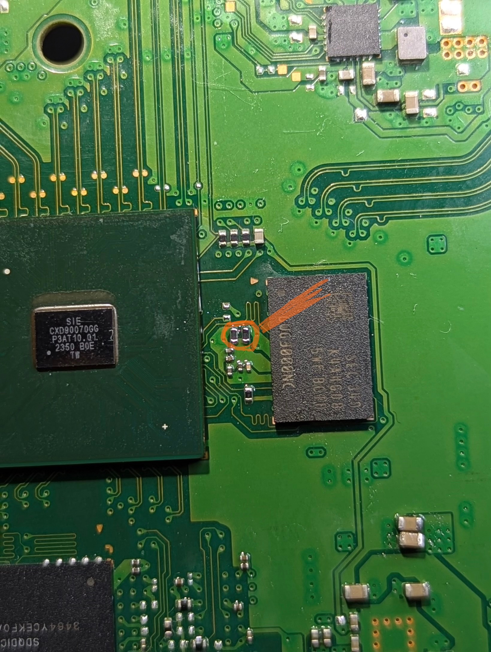

I found something very interesting regarding the resistance on the SSD data line capacitors:
• On a Working PS5 Fat Board: The resistance is 0.960 kΩ.
• On my Faulty Board: The same line reads 0.650 kΩ.
• Component Isolation: When I remove the capacitor and measure it out-of-circuit, it reads a perfect 1 kΩ. However, once soldered back onto the board, the circuit resistance drops to 0.650 kΩ.
• Deep Isolation: I have even removed all surrounding resistors and capacitors on that line, and the board still reads 0.650 kΩ.
The Question:
Is this 650 Ohm reading (a 30% drop from the working board) considered a "partial short" or internal leakage inside the CXD90070GG controller?
Since the voltage rails are correct but the controller overheats rapidly, does this resistance drop confirm an internal silicon failure in the SSD controller? Or could it be a leak toward the APU?
The board traces looks connected to the chip on the right side, i think it's ram for ssd.
I would try to remove both and do measure.
Reactions: BASHEER
The both marked components are 1 kOhm resistors. They are part of the voltage divider for the reference voltage VREFCA input at the DDR4 RAM chip. On your image the down side of the both resistors. My reading on that line is also 0.650 kOhm.
Heat is influencing the resistance measurement.
So I think that should be ok.
I understand. Since the 0.650 kOhm reading is confirmed as normal for the EDM-044 board, that path is now cleared.

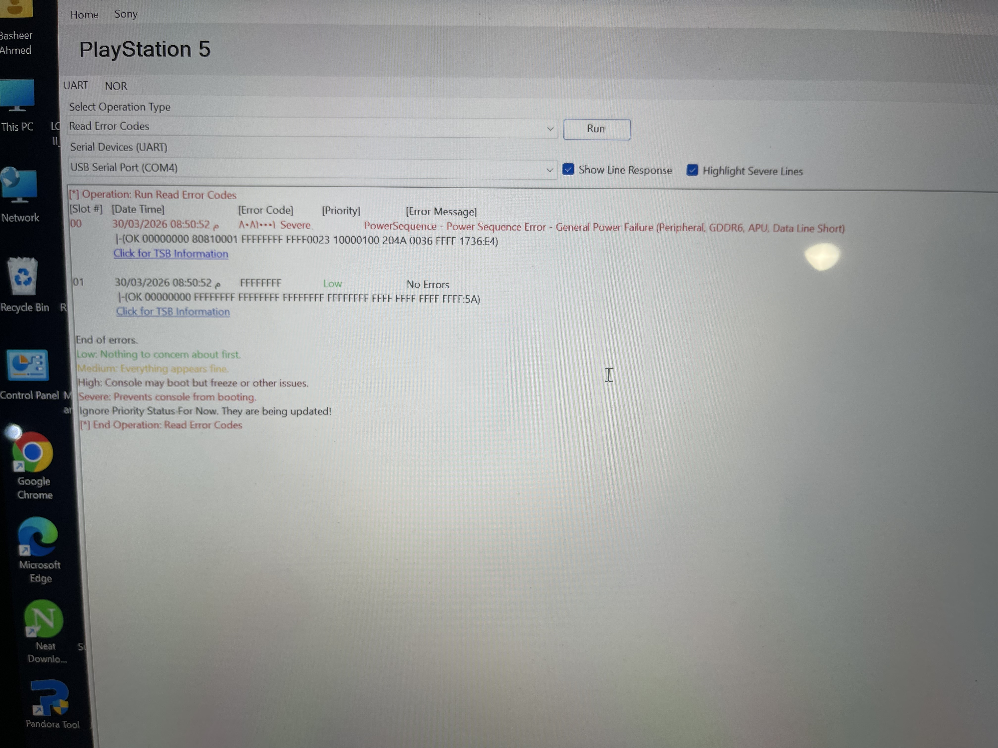

00000000 80810001 FFFFFFFF FFFF0023 10000100 204A 0036 FFFF 1736
204A = Sequence number: SoC is not responding
FFFF = SoC temperatur: SoC is not getting warm --> not powered
I guess you solved the SSD issue and now the southbridge gets past the previous SSD error and now stucks at the next issue. :(
Now the hard part is to find the issue why SoC isn't turning on. If you try to power the PS5, there should be voltages measureable at the SoC power rails. If not powered, the low impedance lines will show up as shorted. So it is a bit tricky to find the missing SoC voltage, if it is a case of missing a power line.
Reactions: BASHEER

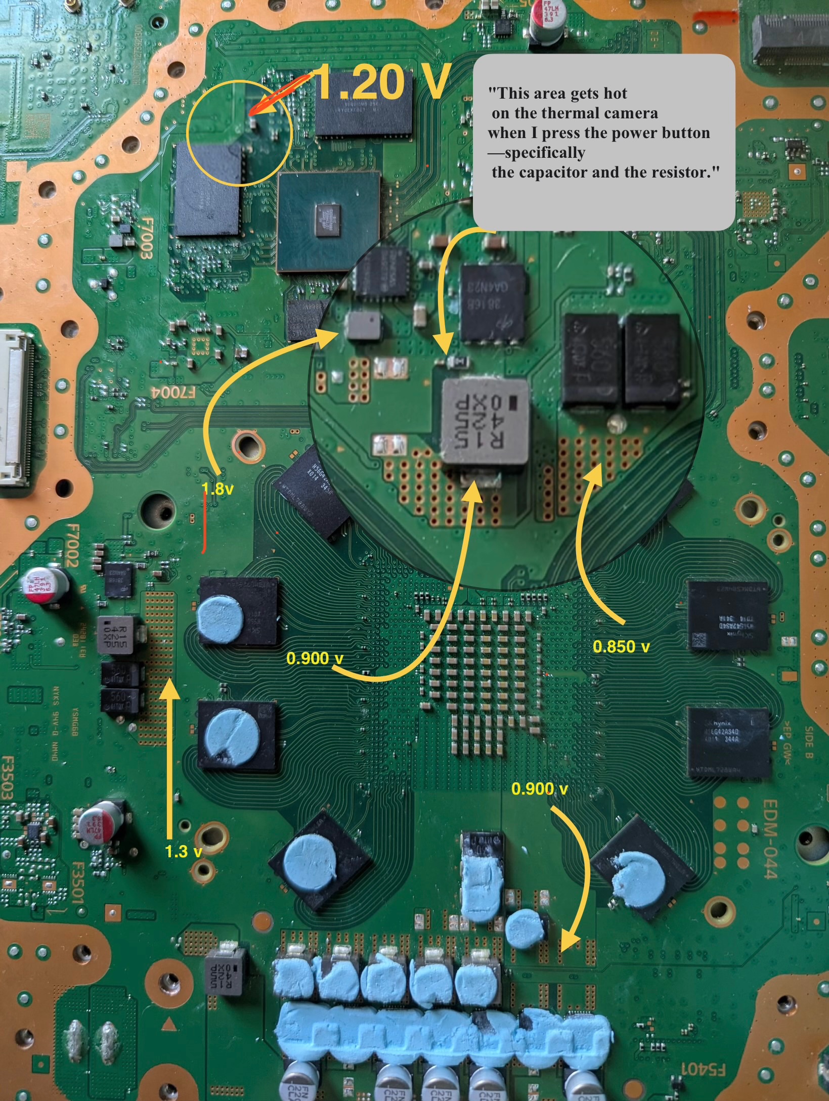

"Upon power-up, thermal imaging shows high heat on the RAM and CPU. The system trips after 2 seconds, returning to a standby current of 0.010 Am
MOSFET 38168 GA4N23
The IC gets extremely hot immediately upon power-up.
That resistor (1 ohm) and capacitor (470p) seems to be a snubber circuit.
Those 2 should not get hot unless something is damaged.
In the picture you mention a 0.9v on the output of the coil.
The service manual for and EDM020 mentions a 0.85v output (0.85V_SOC_VMEMP) or 1.0v output (1.0V_SOC_VSOC) on such coils.
I can't determine from your picture which coil it is.
But it is either too low or too high.
Maybe the capacitor of the snubber circuit is blown and shorting the 1ohm resistor directly to ground, lowering the voltage.
The output from that 8 pin dual mosfet chip has some sort of feedback to the IC on the left.
Maybe some minor damage has an effect on the output voltage.
My redneck approach would be to replace that 470p capacitor first.
Probably anything in the same order will do.
