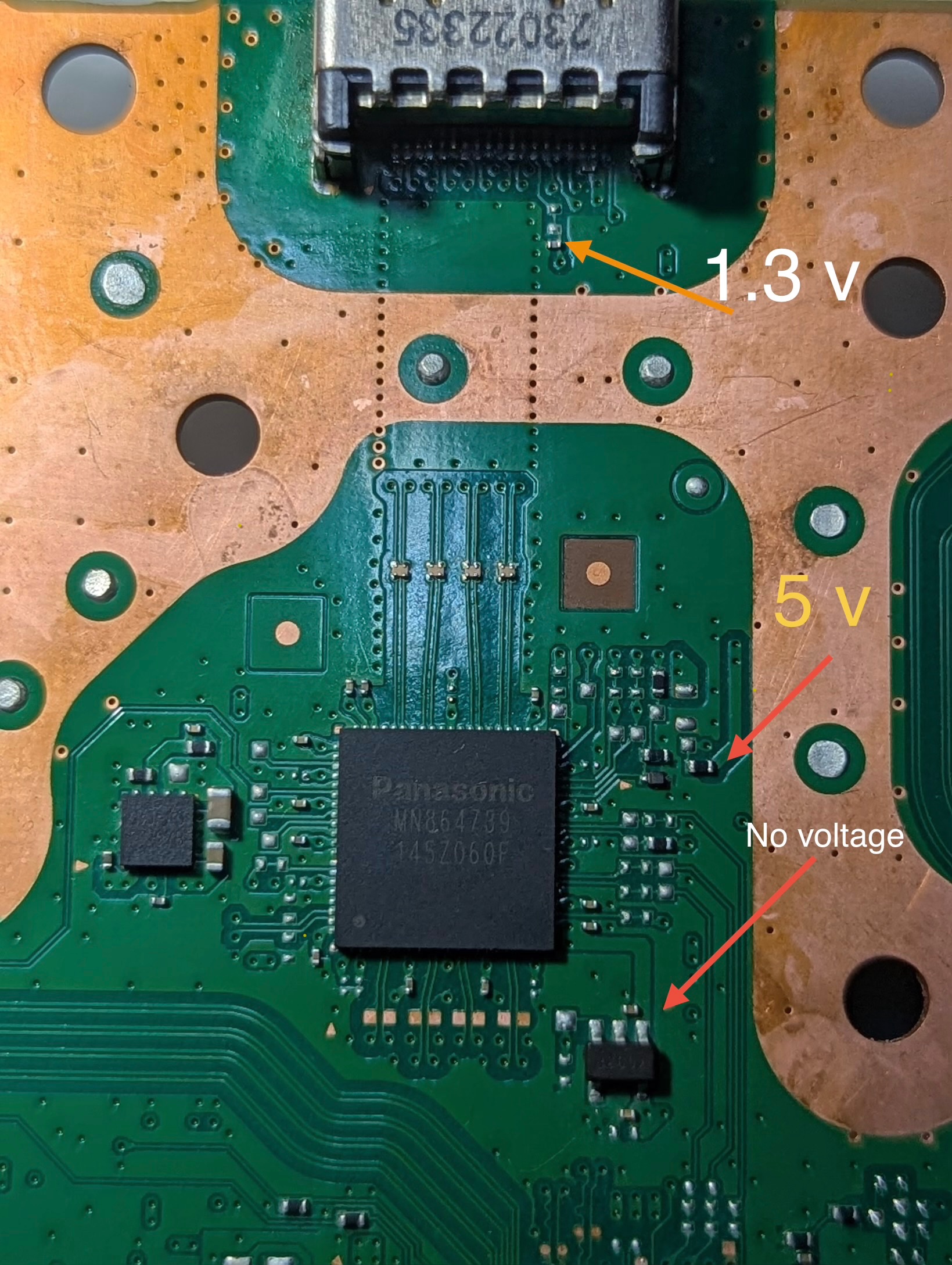

Hi,
The console originally had a minor issue, but unfortunately a technician caused multiple short circuits in different areas of the board.
At this point, I believe the problem has been mostly narrowed down.

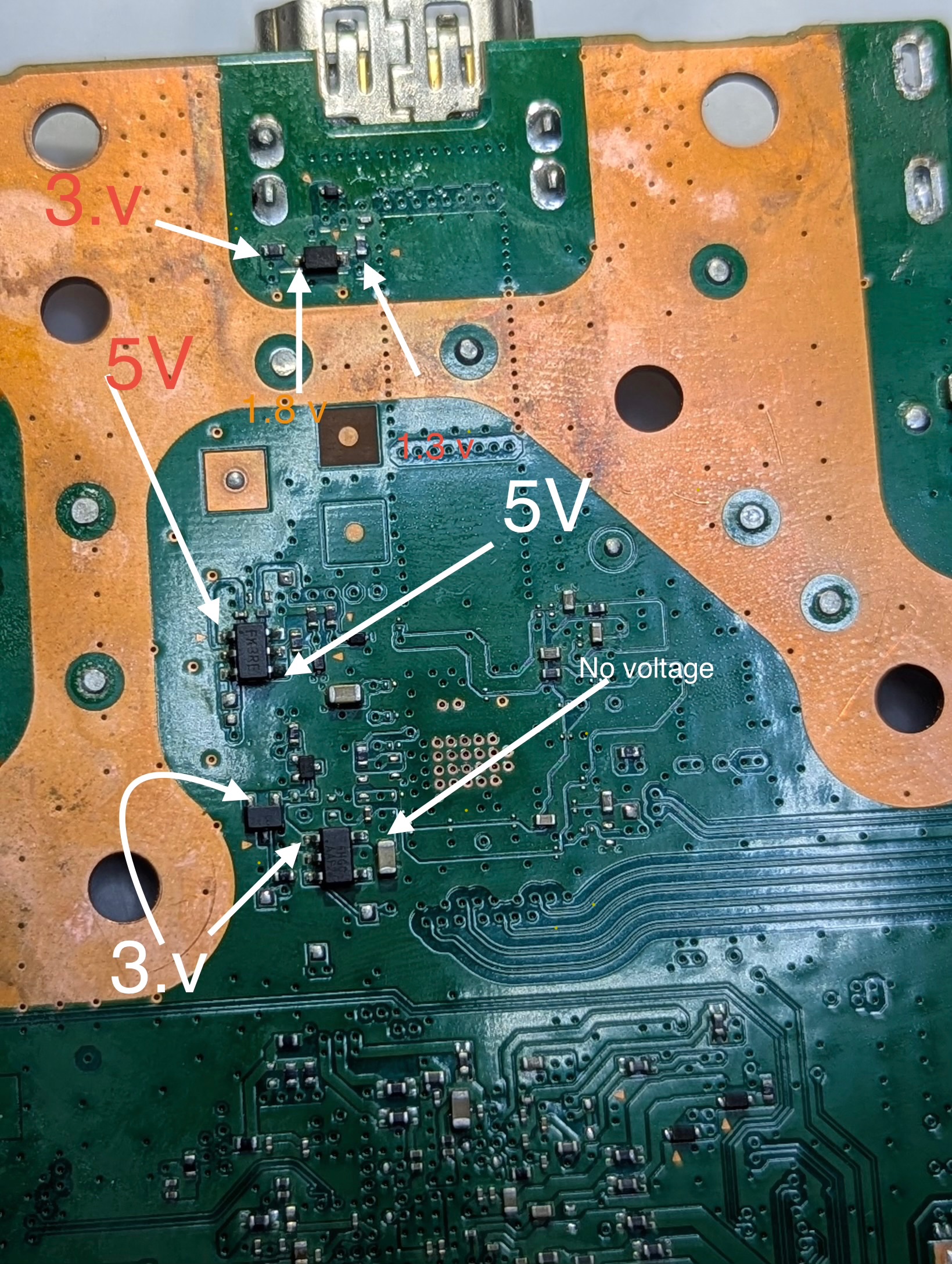

Based on the image you provided, all resistance readings appear normal and healthy. However, there is no voltage present on the HDMI pins, both in standby mode and Power on.
I’ve attached two additional images showing the current voltage readings on the board — they might help in identifying the exact fault location.

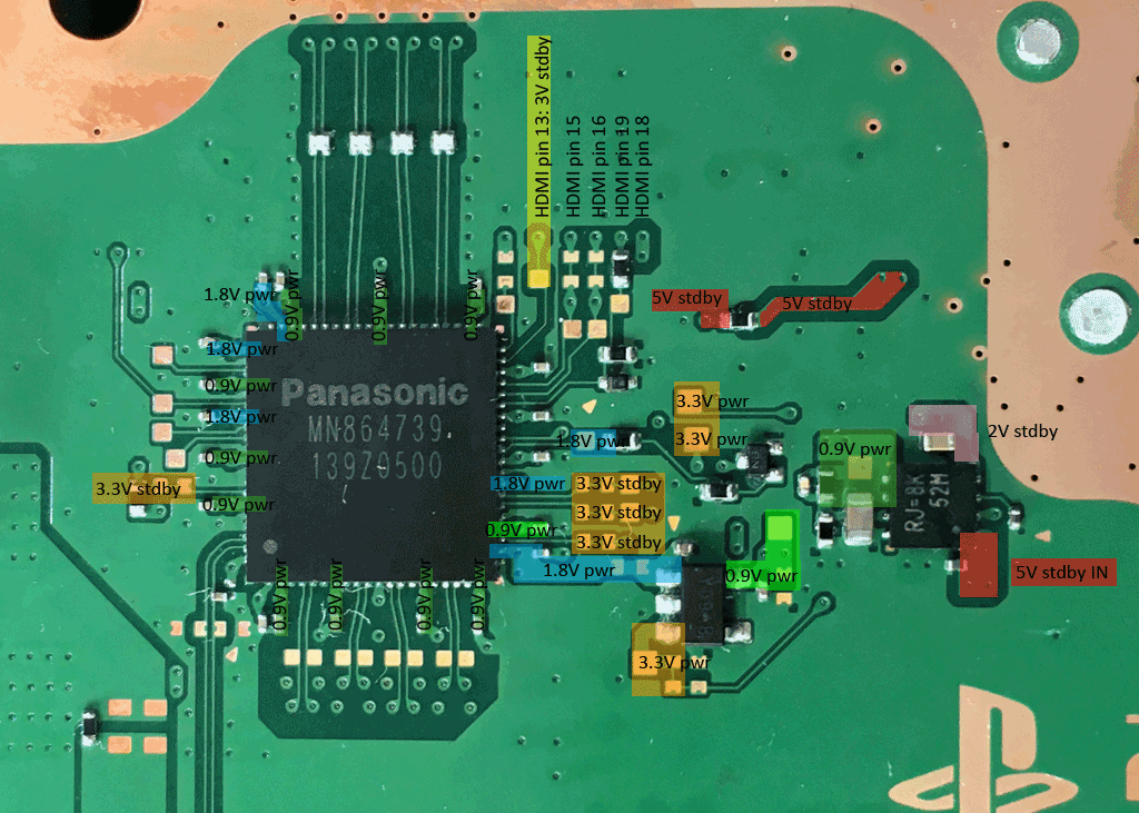

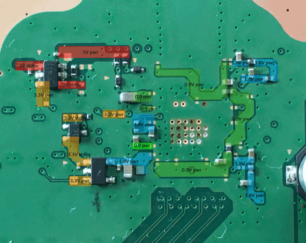

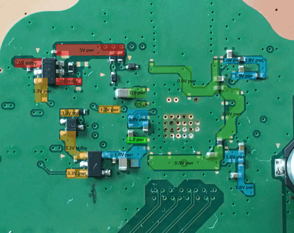

This are images for another board but should help.
The 1.3V at your HDMI pin 13 are too low. The question is, does the cap or one of the both diods are pulling the line down or is the HDMI chip itself bad.

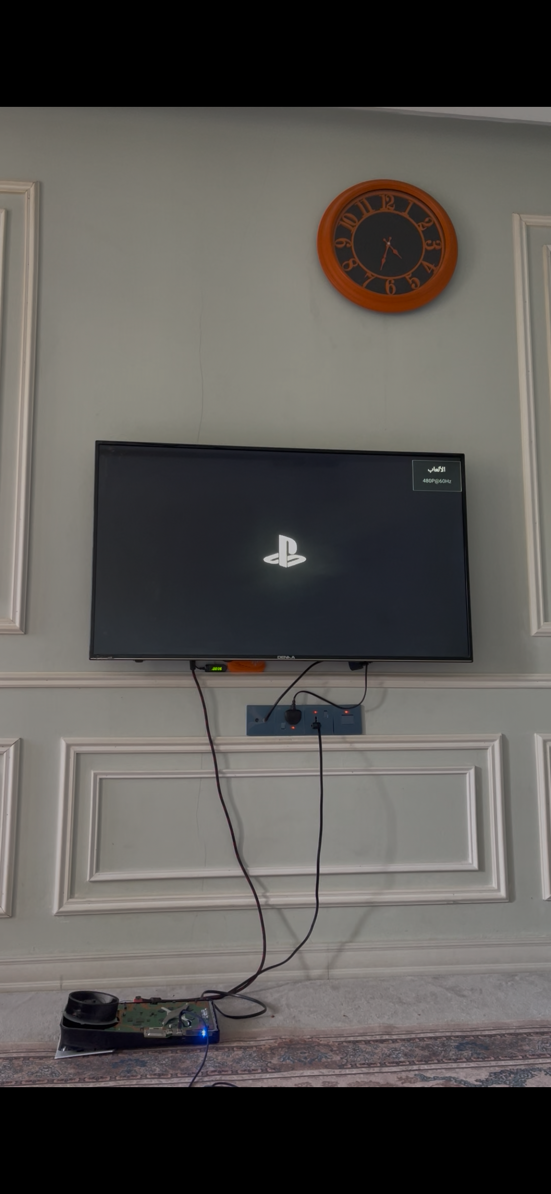

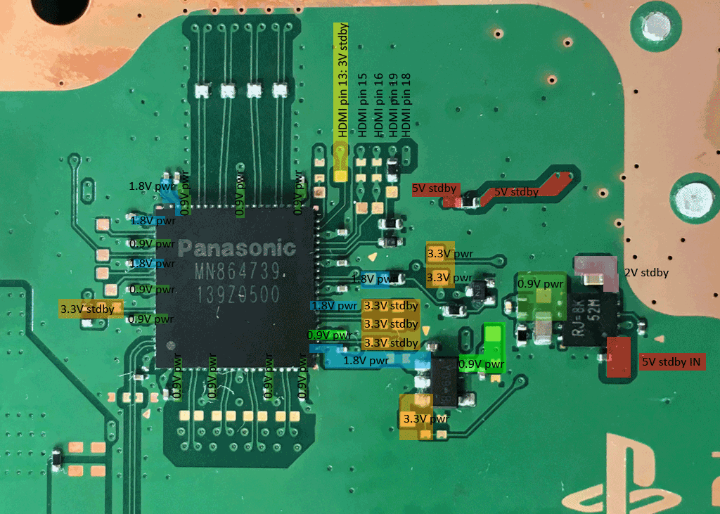

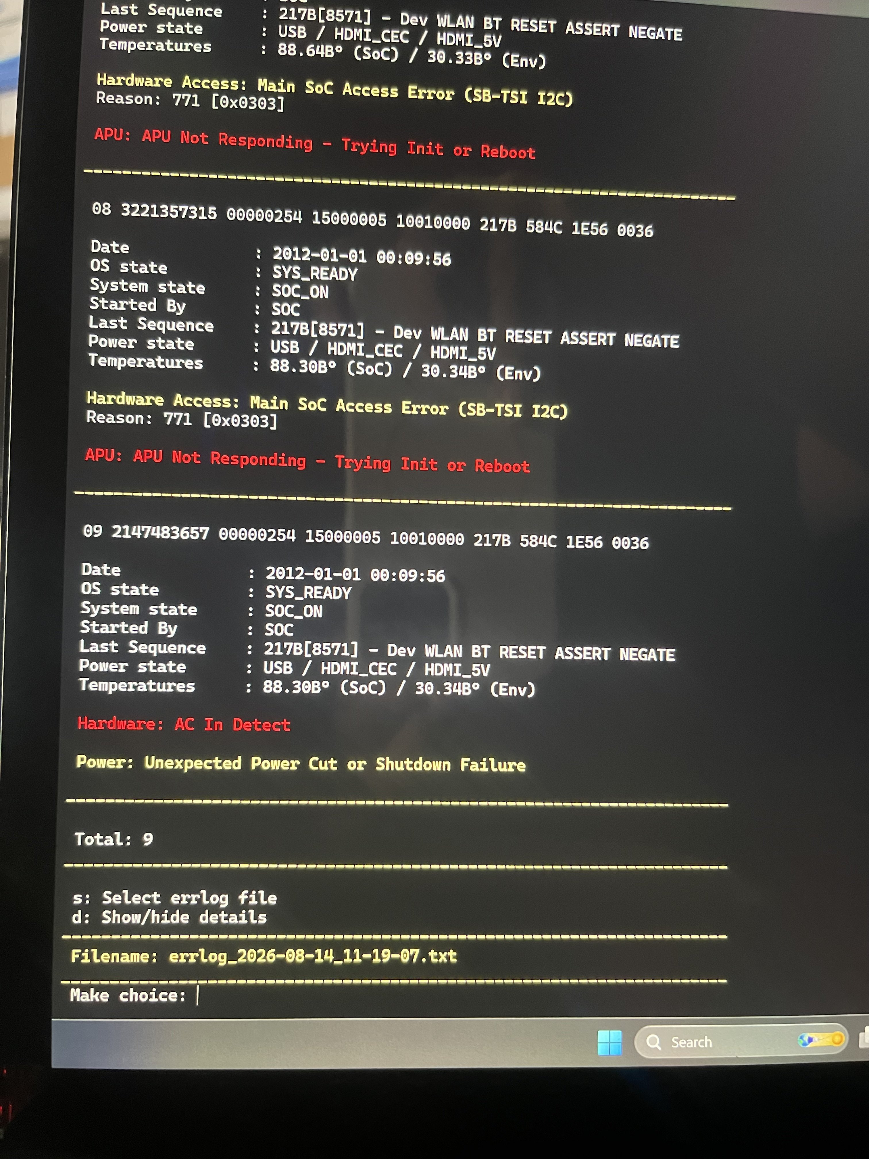

I checked all the resistances around the HDMI IC, and they are all correct and match exactly the reference image I will attach.
After that, I thoroughly cleaned the surrounding area. The console then powered on, and the PlayStation logo appeared at 480p resolution, but shortly after that the screen goes black and the blue light starts blinking.

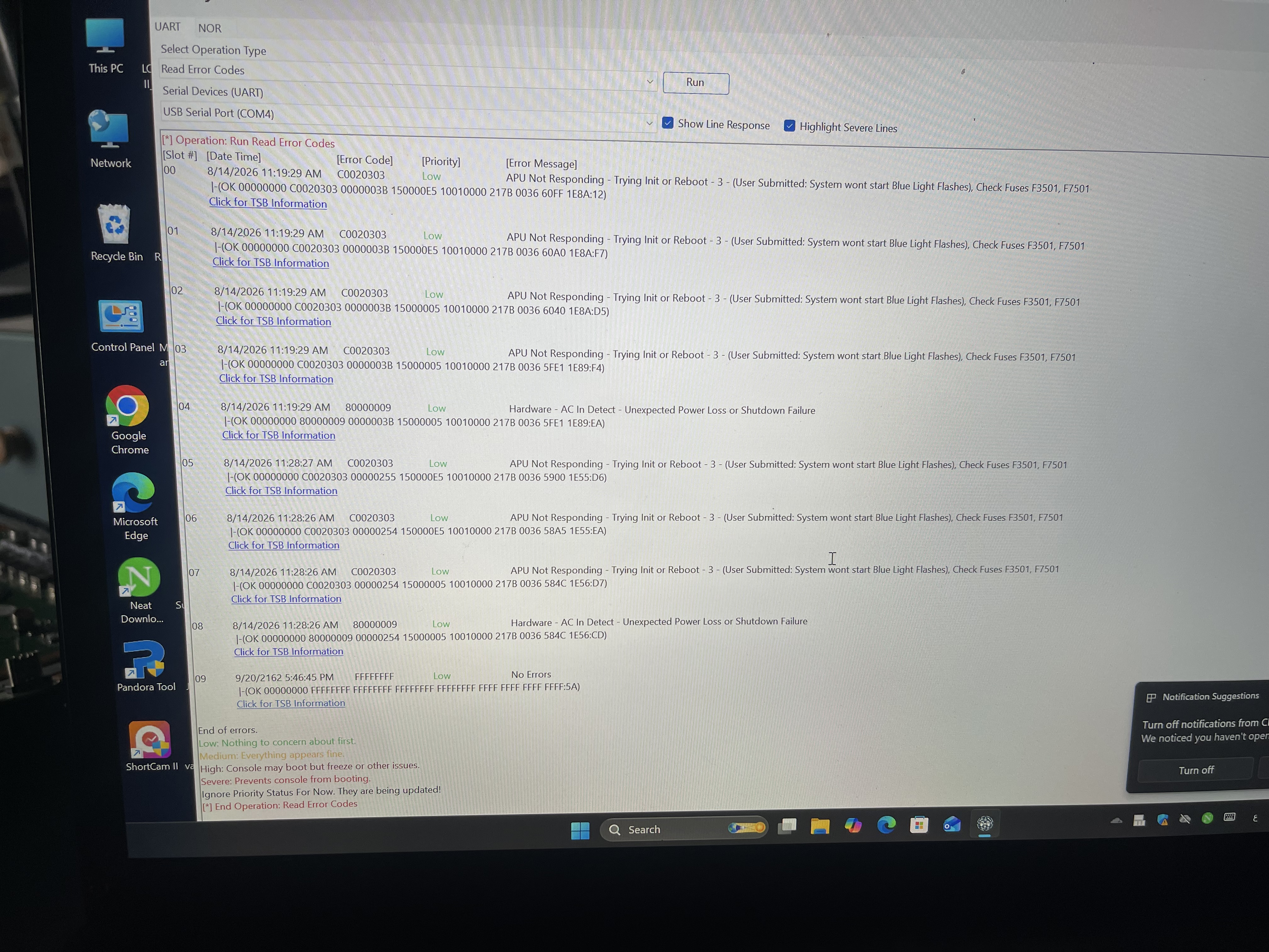

I’ve also attached the error log.

## Code Rtc PowState UpCause SeqN DvPm TSoC TEnv
01 3221357315 00000DEC 150000E5 10010000 217B 3F5B 1DBF 0016
Date : 2012-01-01 00:59:24
OS state : SYS_READY
System state : -
Started By : SOC
Last Sequence : 217B[8571] - Dev WLAN BT RESET ASSERT NEGATE
Power state : USB / HDMI_CEC / HDMI_5V
Temperatures : 63.36В° (SoC) / 29.75В° (Env)
Hardware Access: Main SoC Access Error (SB-TSI I2C)
Reason: 771 [0x0303]
APU: APU Not Responding - Trying Init or Reboot
02 3221357315 00000DEC 150000E5 10010000 217B 3F5A 1DBB 0016
System state : -
Started By : SOC
Temperatures : 63.35В° (SoC) / 29.73В° (Env)
03 3221357315 00000DEC 15000005 10010000 217B 3F5C 1DB7 0016
System state : SOC_ON
Started By : SOC
Temperatures : 63.36В° (SoC) / 29.71В° (Env)
04 2147483657 00000DEC 15000005 10010000 217B 3F5C 1DB7 0016
Started By : SOC
Hardware: AC In Detect
Power: Unexpected Power Cut or Shutdown Failure
Total: 4
______________________________________________________________________
s: Select errlog file
d: Show/hide details
Filename: errlog_2026-05-05_17-00-02.txt
Make choice:

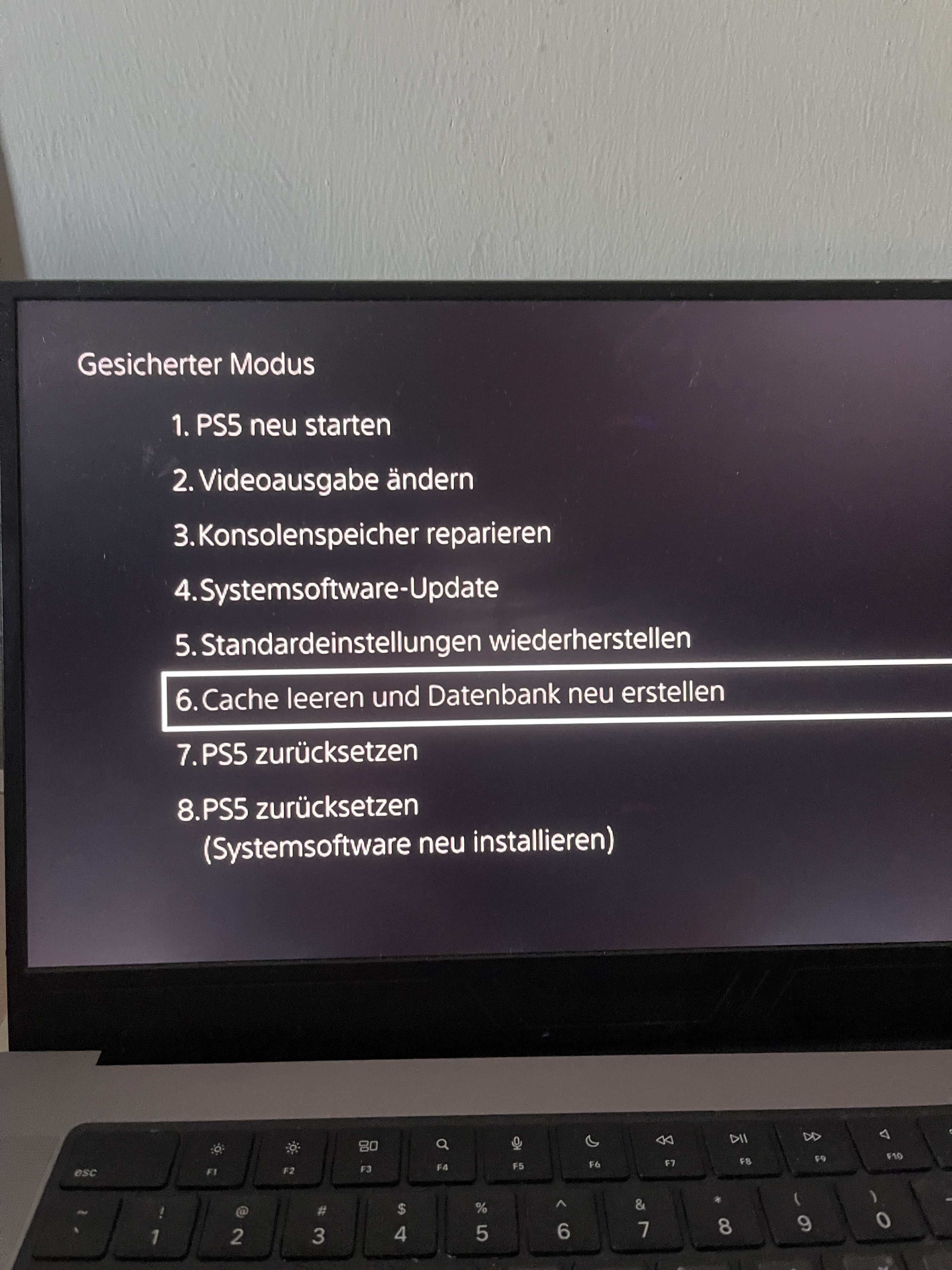

If the PS5 is stuck at 480p and a change to other resolutions (Option 2 in SafeMode) is not possibel, I would replace the HDMI chip.

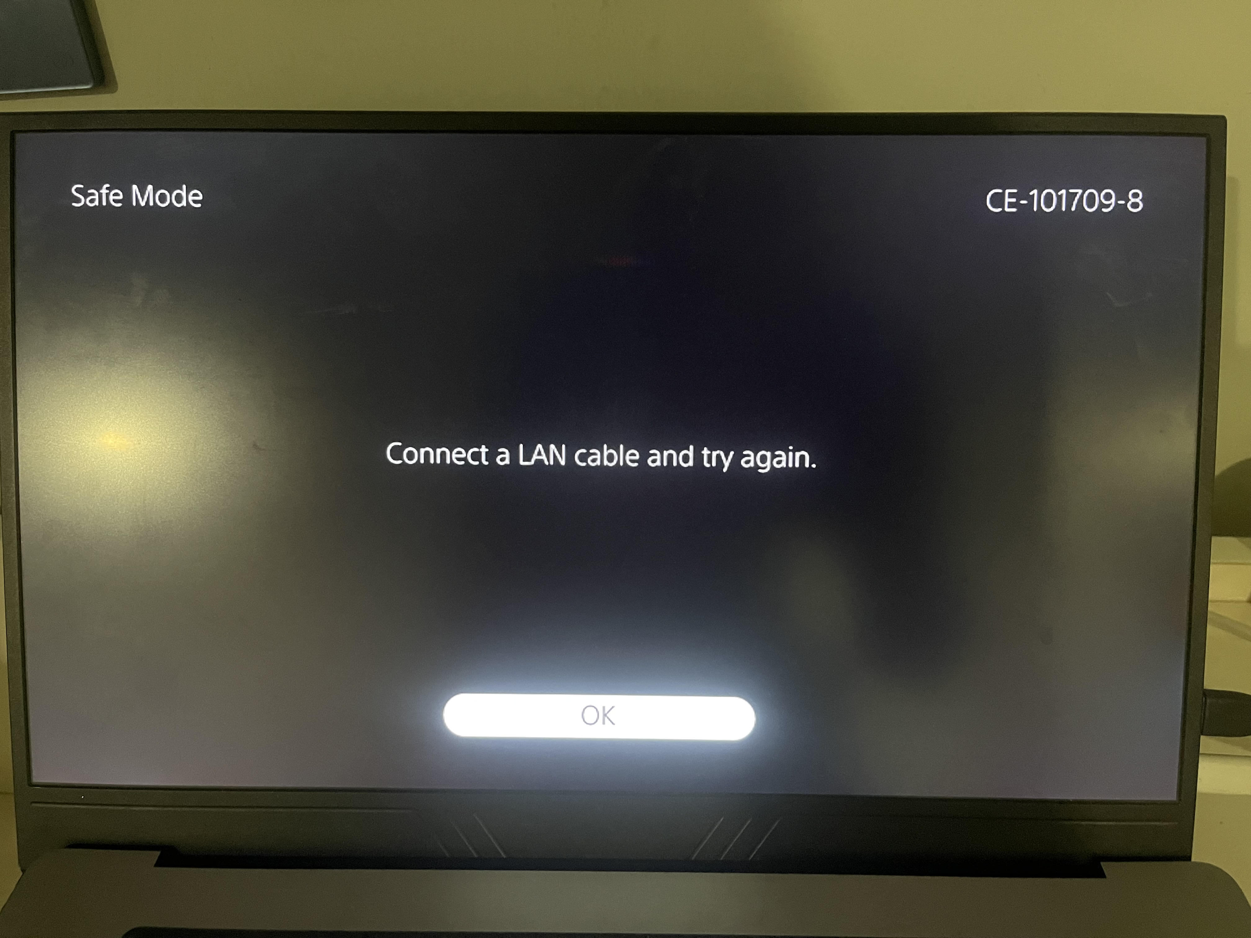

After replacing the WiFi/BT module, the console now displays an image, but it is unstable and flickering.
Also, only one of the front USB ports is working — the other front port is not working, and the rear USB port is also not functioning.
Additionally, in recovery mode, no WiFi networks are detected, although they should normally appear.

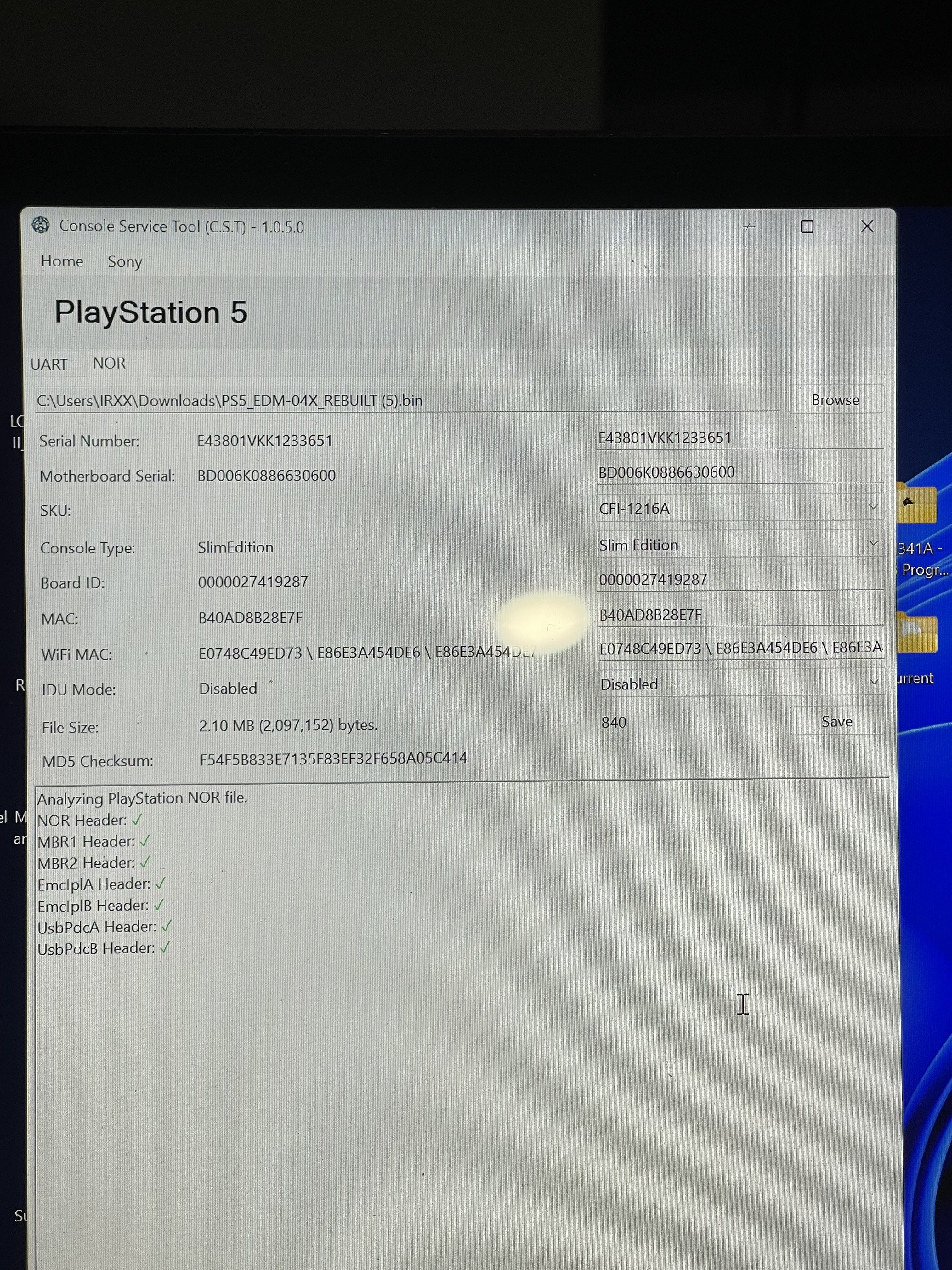

I did the BISO file

Attached is your dump. I corrected the position and the CFI number and the other WiFi related MACs.
But I don't think it will change something. I would try the second dump without modifying it and see if the behavior of the WiFi is different.
The black screen after logo could be realted to the CEC pin 13 at HDMI port. I still think the voltage is to low.
If the handshake for CEC/HDCP fails, the screen stays black.

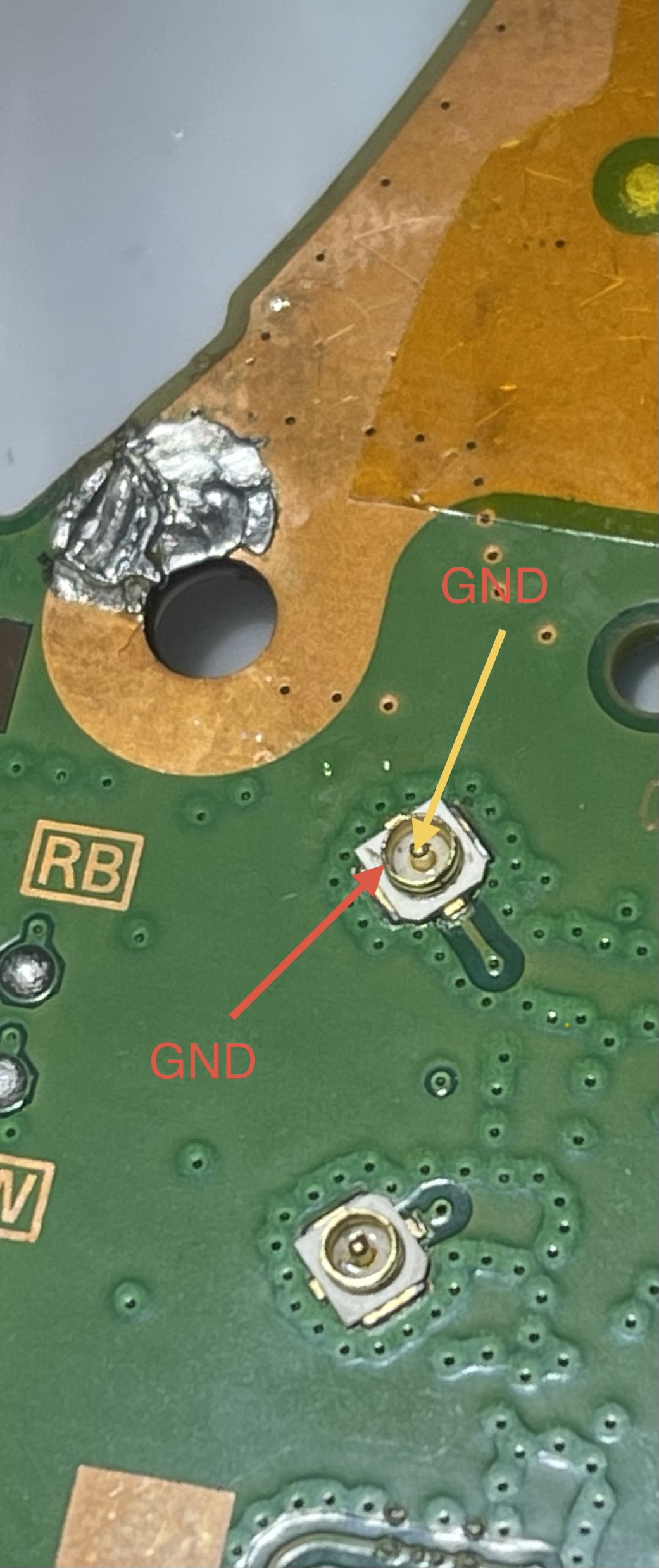

Is it normal for both sides of this connector to be ground?
I checked continuity and both the inner center pin and the outer shield ring are connected to GND.

The last BIOS I posted is from a edm-04x with J20H100 WiFi chip. So the BIOS should match your board.
