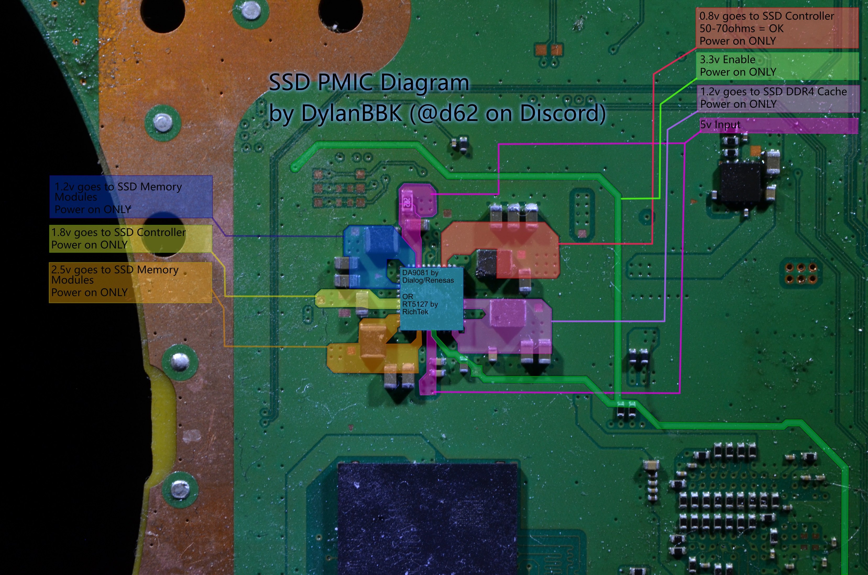

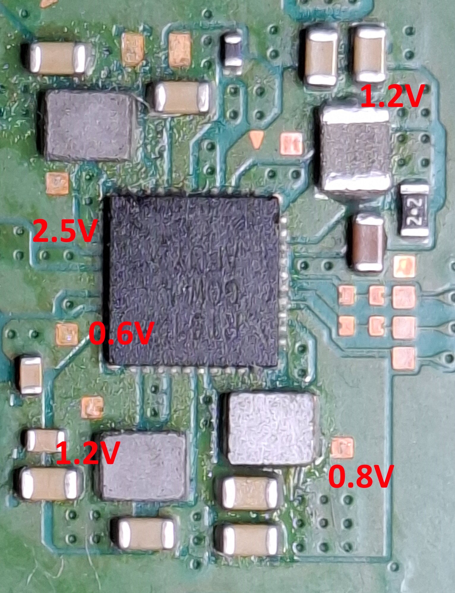

The power on voltages in the chip RT5127 are in the picture.
The second pic, are voltages from a fat version
Somebody know, how can i determine, if cxd90070gg are bad

80871001 usually means the DDR4 chip itself or its power lines are bad. Compare the voltages to a known-good board like you did-if they match but it still beeps, the CXD90070GG is likely faulty and would need replacement or reballing again.
Thx for answer Mike!
I´ve do reballing, without luck, i´ve need to wait the new cxd to arrive
