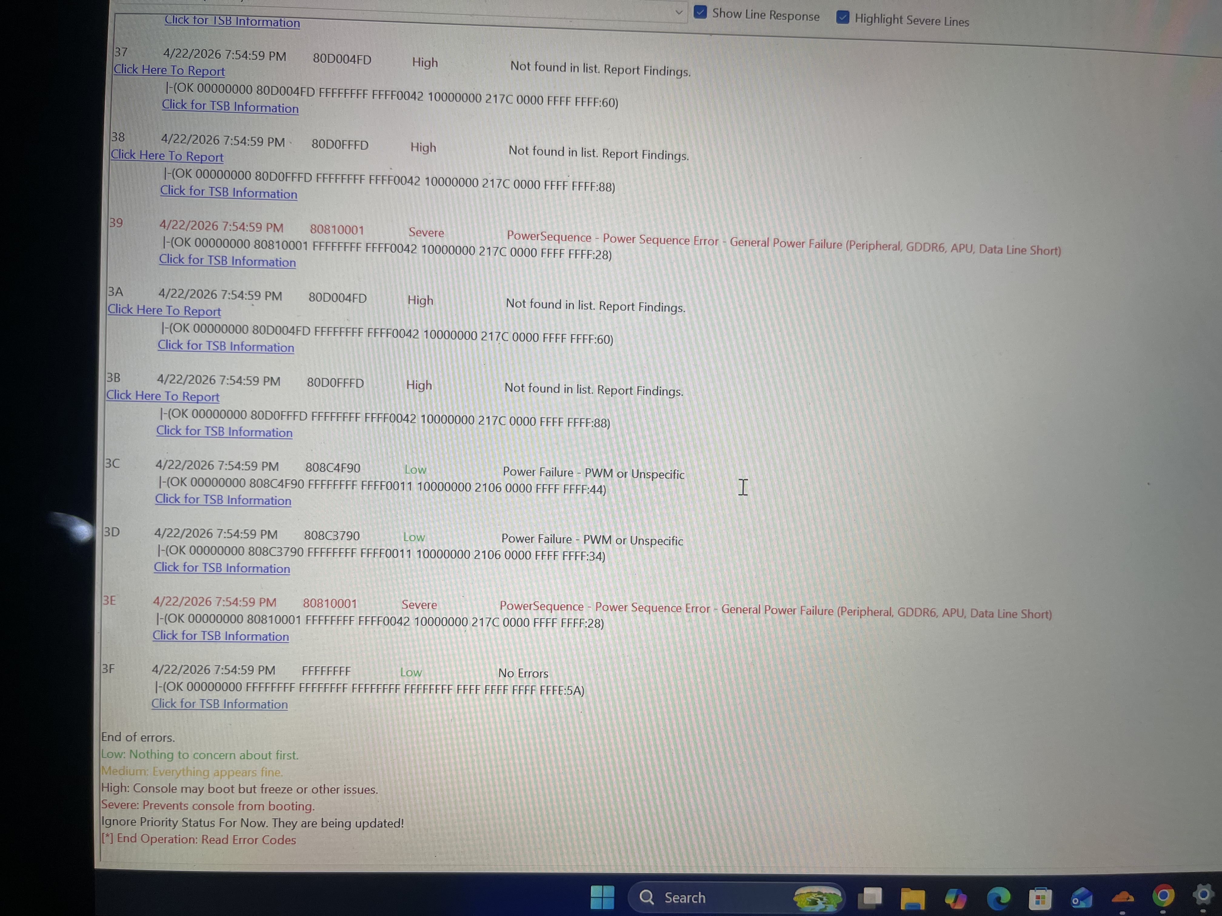

Hi everyone,
I'm working on a PS5 Slim EDM-040 and getting the following UART error codes:
- 80810001 (Severe) — PowerSequence: General Power Failure (Peripheral, GDDR6, APU, Data Line Short) — appears twice
- 808C4F90 (Low) — Power Failure PWM or Unspecific
- 808C3790 (Low) — Power Failure PWM or Unspecific
- 80D004FD (High) — — appears twice
- 80D0FFFD (High) — Error — appears twice

I would clear the errors and check which appear again.
80810001 = Power Sequence Error (Southbridge has detected an issue in power sequence. )
808Cxxxx = USB C error (I would check USB C controller and muxer ic)
80D004FD, 80D0FFFD = WiFi/BT error (case: WiFi ripped pad. After trace repair fine.)

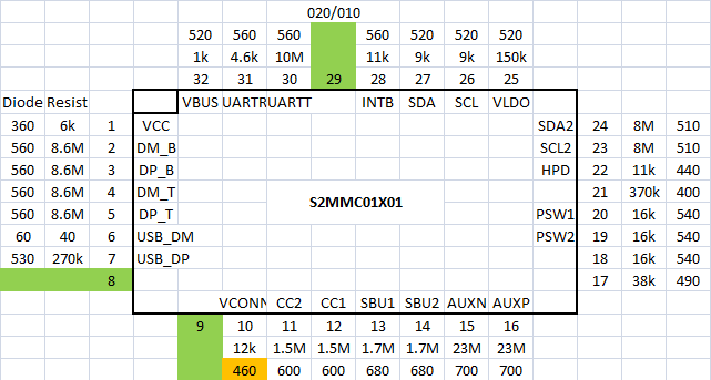

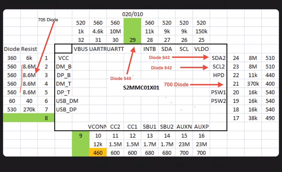

Thanks for the photos. I compared the measurements:
The VL181-G79D3-0B237 IC matches the reference image exactly — all readings are correct, so this chip looks fine.
However, the F2 = AH MY2 IC shows some differences in diode mode readings compared to your reference. This is not normal
Change Southbridge could help or not , maybe they have a problem or not ?

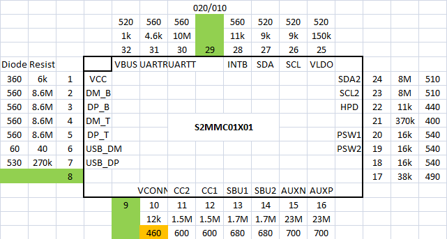

Pin 29 at the USB C controller is only at the edm-010/020 boards ground. At later versions its reading should be like 4M Ohms/520 mV. The difference in diode mode readings could be in different multimeter to my multimeter.
I have no edm-04x boards with TLV62090 onboard, only boards wih the version with TPS62821 rails.
In compare to the datasheet of TLV62090 your pin names seems to be a bit off.
https://www.ti.com/lit/ds/symlink/t...%2F%2Fwww.ti.com%2Fproduct%2Fde-de%2FTLV62090

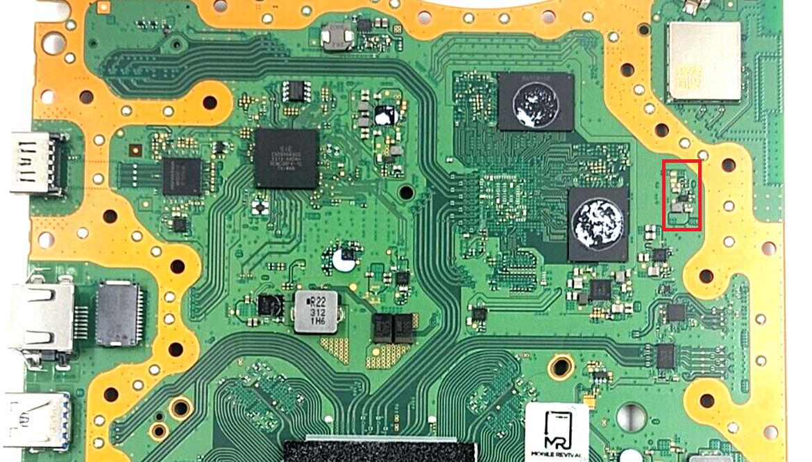

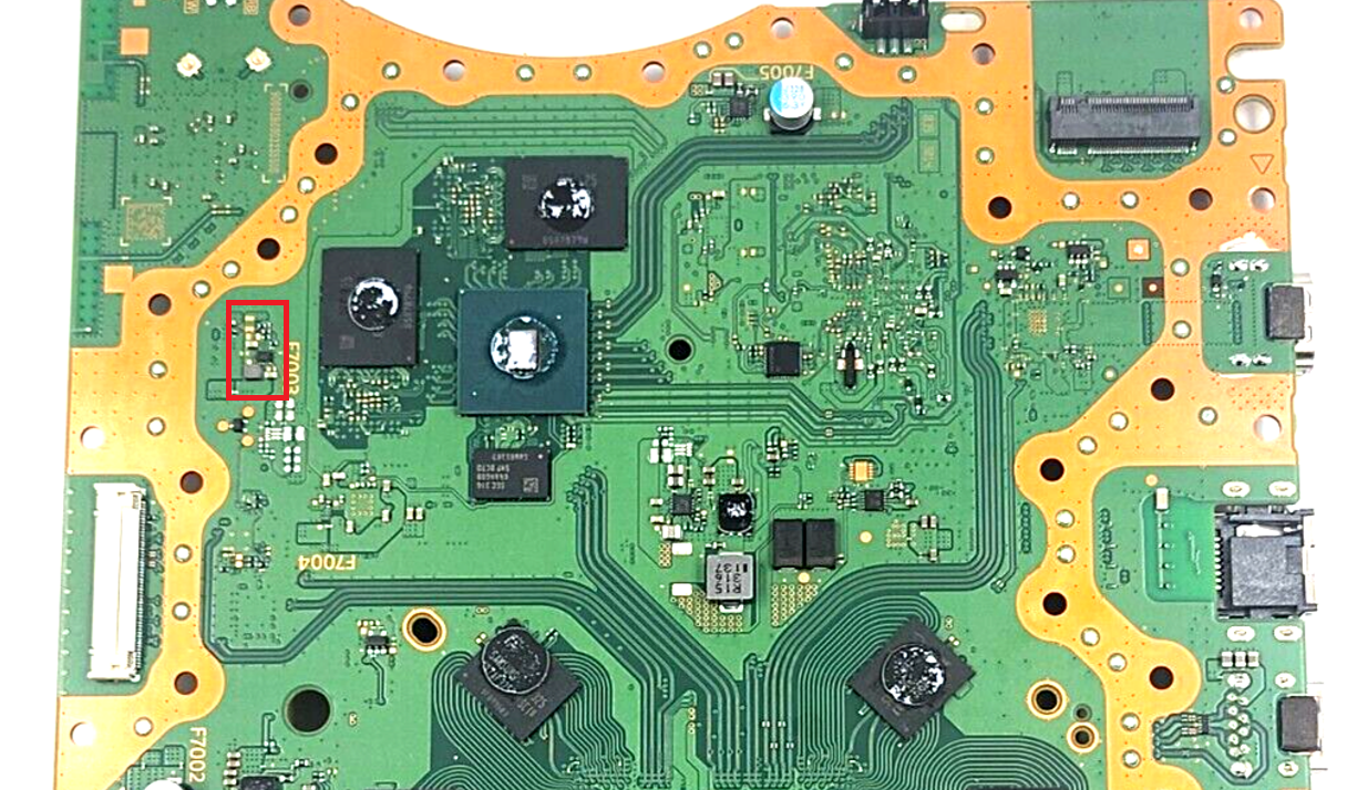

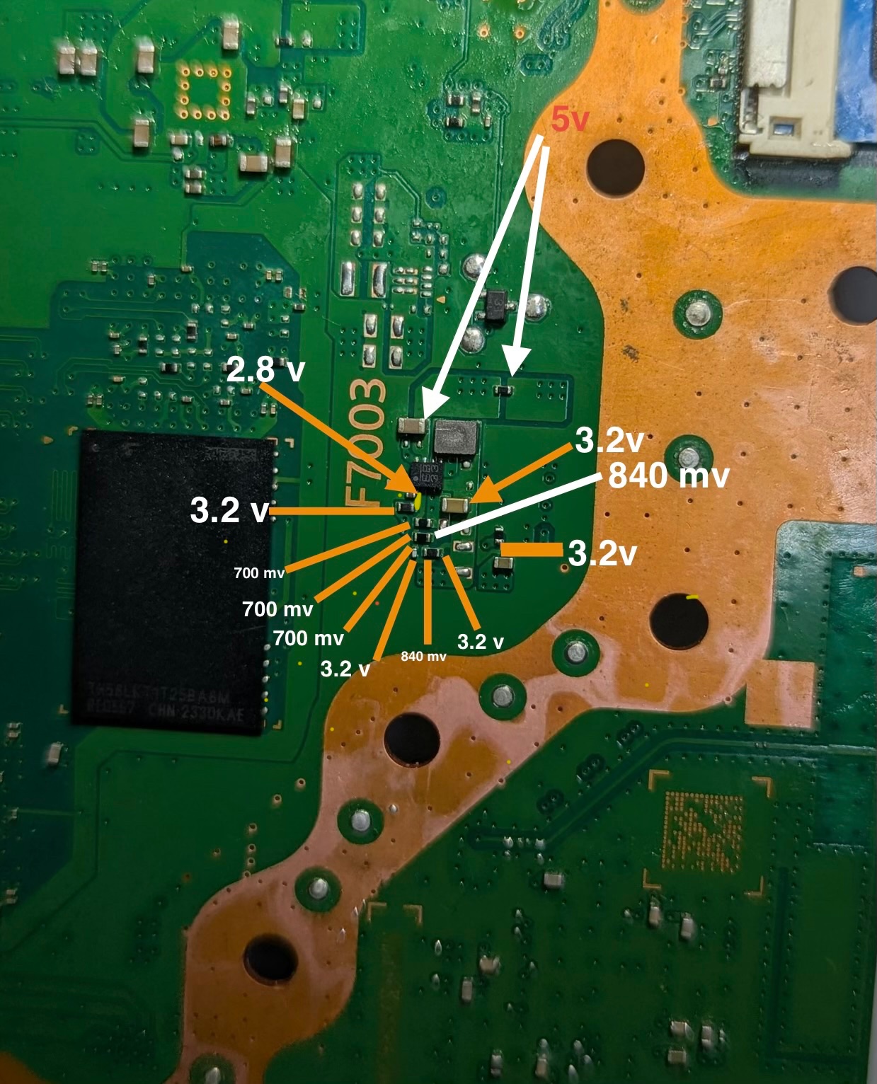

The data lines of the WiFi chip are going direct to the southbridge. If you changed the WiFi module and the issue is still present, the southbridge would be my next candidate.
There are two dcdc bug converter ciruits. One at the fuse F7003 and one on the backside of the mainboard at the same spot.
Depending on the WiFi module both (J20H100/AW-XM501) or only one (J20H104/AW-XM546) is equipped.
Reactions: SafarGet
The WiFi module I have is J20H104, not J20H100.
Also, I don’t have the original BIOS — I believe the current one may be from another donor board.
Could you please share a picture or highlight the exact components I should check to confirm whether the issue is from that area or not?
For example, the DC-DC converter circuits you mentioned.

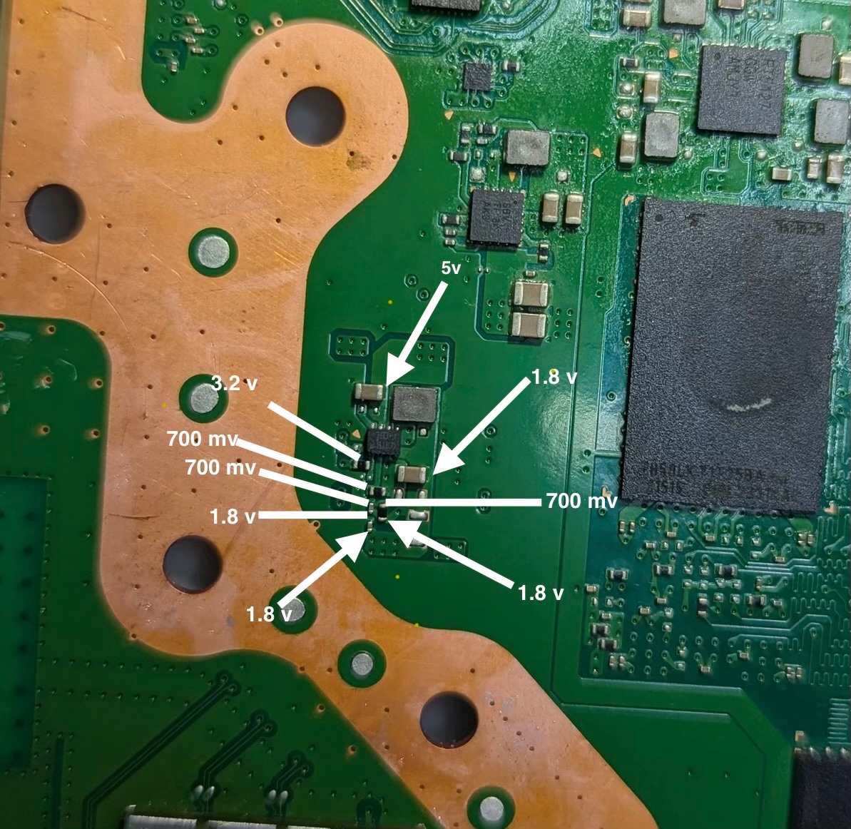

You need a J20H100/AW-XM501 WiFi chip.
If both dcdc bug ciruits are equipped, the board is set up for J20H100/AW-XM501 NOT for J20H104/AW-XM546
Reactions: SafarGet
Under the J20H104 area, I measure 3.3V on the capacitors, which indicates that the WiFi rail is 3.3V. So it seems the board is actually using a single 3.3V supply for the WiFi section. Please confirm if J20H104 is still the correct chip for this board.
My board is EDM-040.
On your board are two active WiFi rails: 3.3V and 1.8V as shown in your both attached images. --> This is for a J20H100/AW-MX501.
Please change the soldered WiFi module to a matching one.
Reactions: SafarGet
[You are right. I found that there are two versions of the EDM-040 board. Most of them use the newer setup with J20H104 and a single 3.3V rail. But there is a rare version that uses the older setup with J20H100.
The board number only represent the mainboard version. What is soldered to the mainboard depends, I guess, on the chips which are available at the time of production. There are some more alternative ciruits for other subsystems which could be equipped different.
I had some edm-04x mainboards with J20H100 in for repair and because the two WiFi power ciruits are still on the newer board versions, I don't think, the newer J20H105/AW-XM546 are successors for the older modules. I guess, it is more about to obtain the required quantities for production. Inside a J20H100 is a NXP WiFi chip and inside a J20H104 is a Mediatek WiFi chip.
Would be interesting to know if a J20H100 will solve your issue.
Reactions: SafarGet

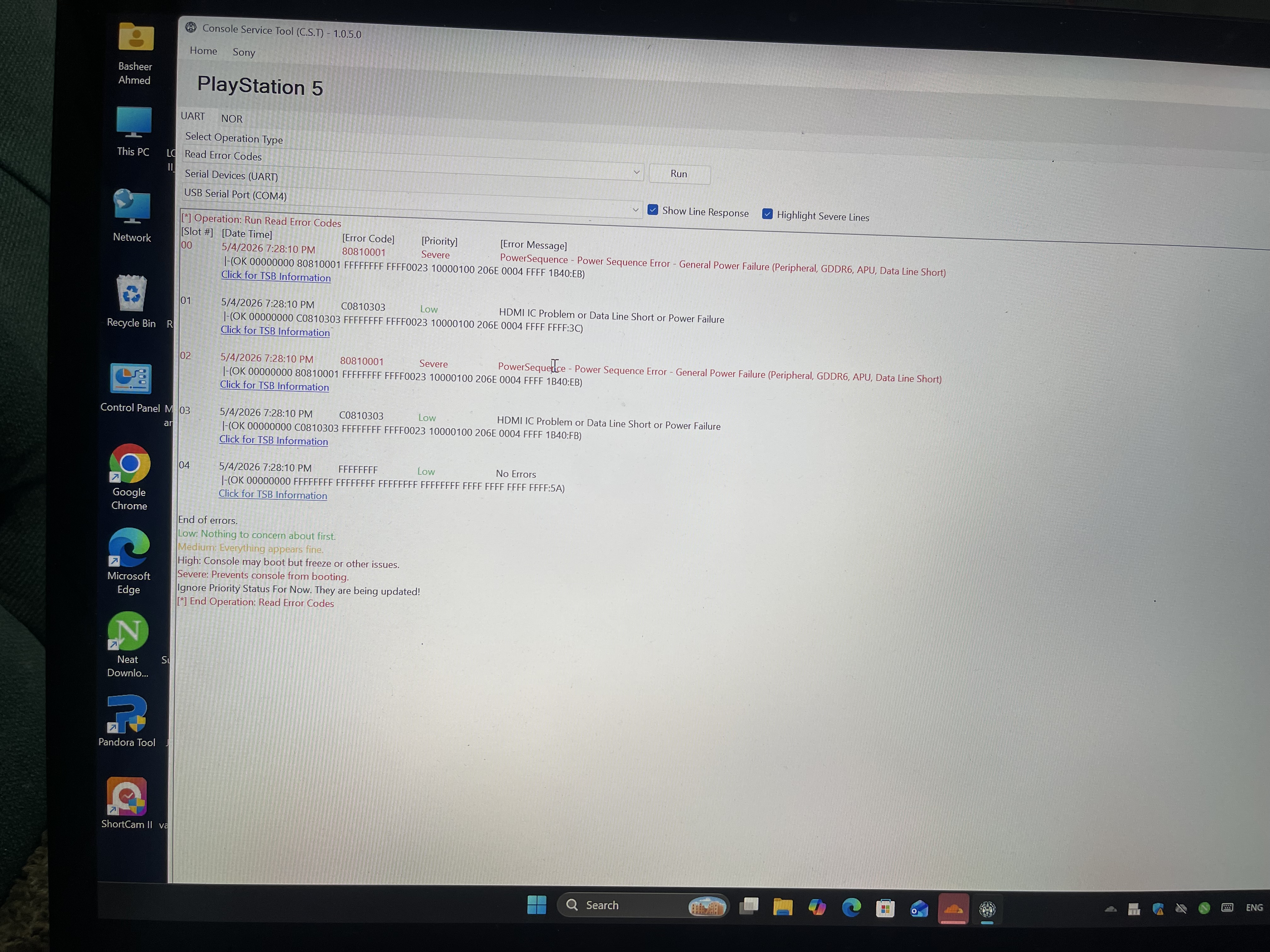

I replaced the WiFi chip with J20H100, and now I’m getting a new error. The tool reports an HDMI IC problem or data line short / power failure. I checked the HDMI IC and there is no short on it.
On the power supply, the board initially draws around 450 mA 6 second, then it starts fluctuating quickly between random values (around 7 mA up to 90 mA).
What do you think this indicates? Could this still be related to Southbridge or power sequencing rather than the HDMI IC itself?
