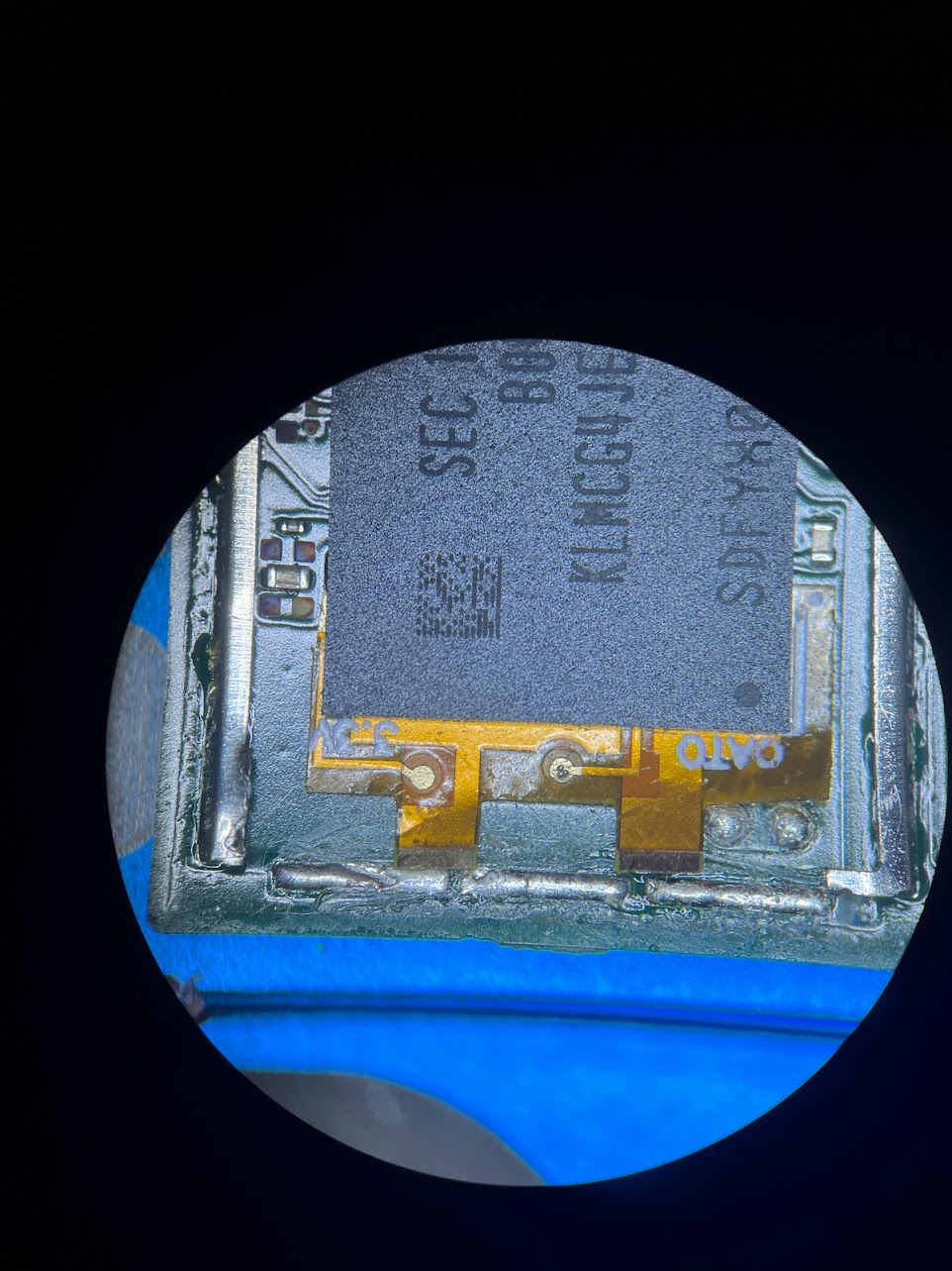

I'm struggling getting the DAT0 adaptor to seat where it should. It seems to only get a 0.7V diode reading when shifted slightly right, but that seems to be a ball width, so the reading I'm getting is probably from a neighbouring ball under the EMMC. Is this normal? I tried with two adaptors, and both can only slide under when in this position.
I'm struggling getting the DAT0 adaptor to seat where it should. It seems to only get a 0.7V diode reading when shifted slightly right, but that seems to be a ball width, so the reading I'm getting is probably from a neighbouring ball under the EMMC. Is this normal? I tried with two adaptors, and both can only slide under when in this position. View attachment 385835
That's the worst kind of adapter. Probably doesn't feel like it fits nicely because the contact is too big on that one.
Any adaptor that has 3.3v on it is a no-go.
