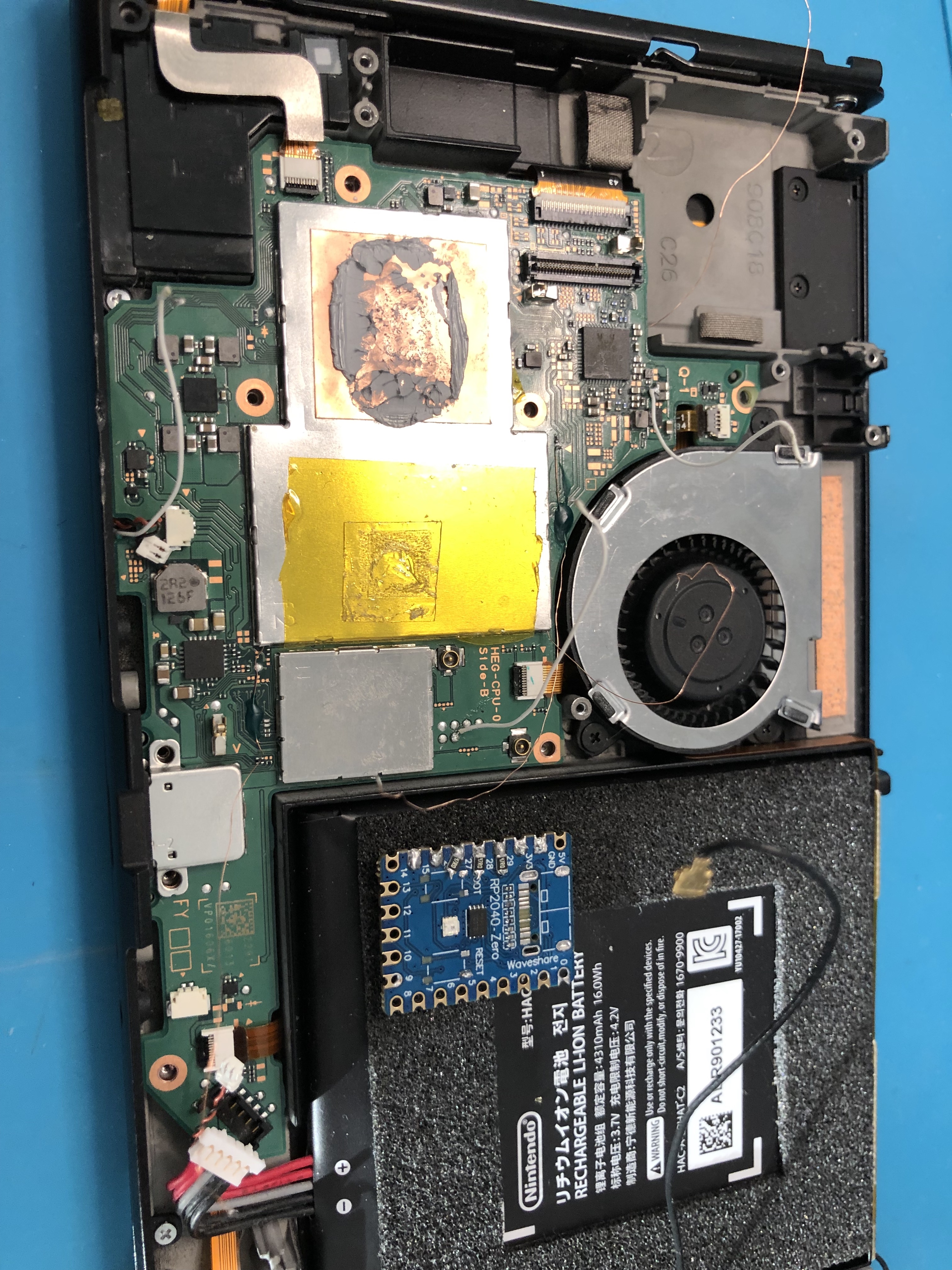

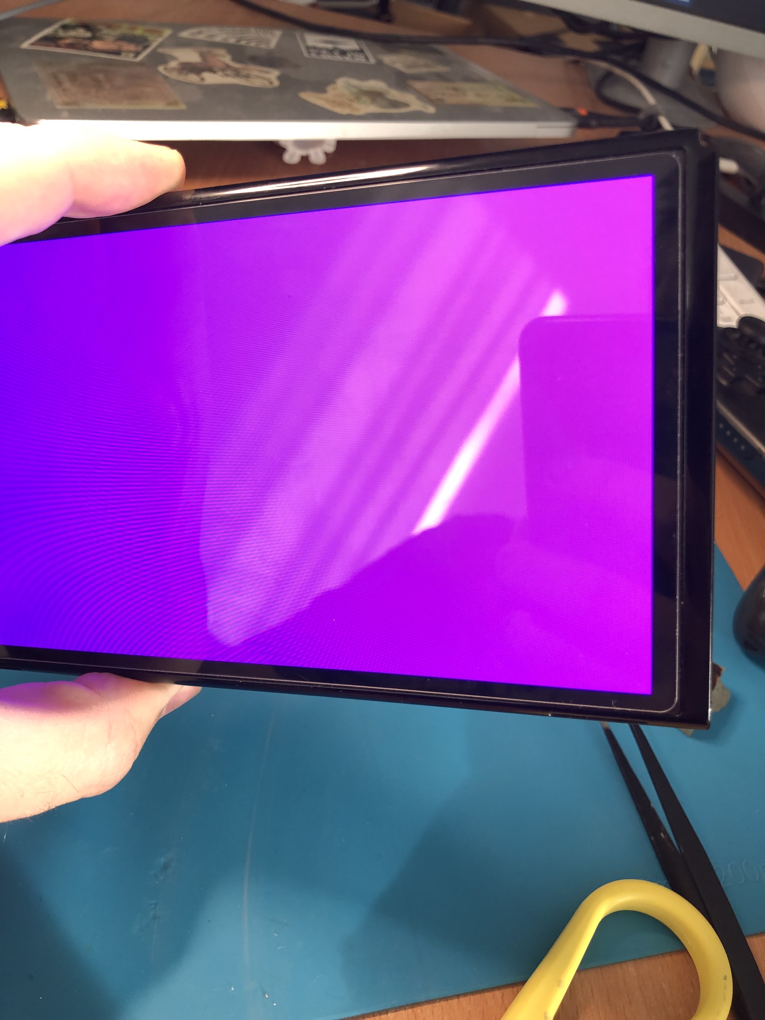

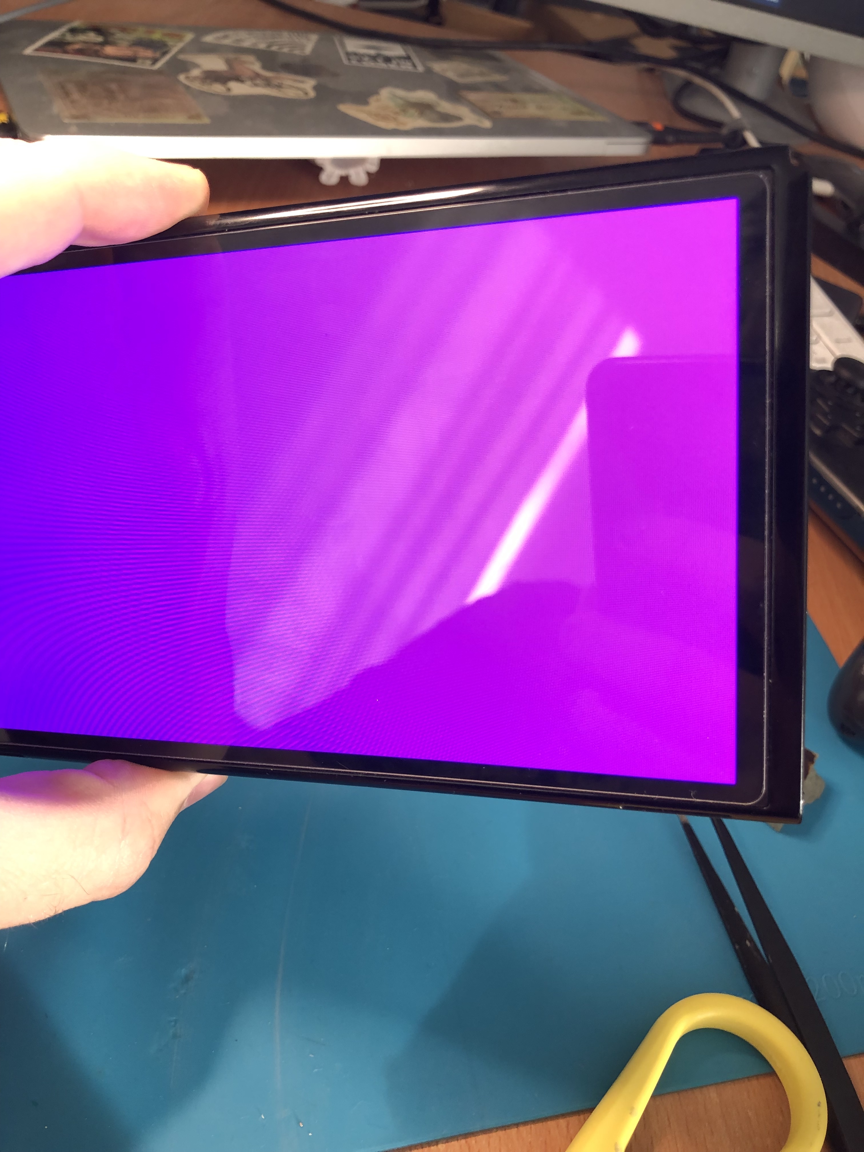

Here. Well, for about a month everything worked fine. Now I have disconnected all contacts from the rp2040 altogether, but I still get this screen.
Not of the screen.
The motherboard with the pico.
And did you check for @Dee87 advice on checking the resistor values?
Edit - hmmm everythings disconnected now but still pink. Let me do some research on this pink/purple screen.

I completely disabled the board and still get this screen
Its your cmd resistor i bet eather its not connected properly or it doesnt have the correct calue anymore
Yep, my research pointed to the same conclusion. 'CMD resistor - 4.7k 0201'
Check in resistance mode for that value but more than likely its blown so get that replaced (most likely).
Oh no... I don't see a flex, and I doubt you put a pull-down resistor across mosfets before removing the pico...
Good point, @Makc16384 did you use single or double mosfet and did you have a pull down resistor on your mosfet build!? Because you could potentially replace the resistor and fix the issue but a month down the line, the pink screen could return. Can you show us a picture of what your APU looks like under the hood (metal shield) and your mosfet build.
Another point, did you kapton tape/solder mask your solder joints your pico when you finished the install. I mean all around the points of the pico that were not used because they could cause shorts with the metal shielding above and below too.

I checked the resistor. This resistance in one direction is 8.3k, in the other 77k. Apparently it’s really him, I’ll buy it as you said and put it. And what resistor is recommended between the G and S points of the MOSFET?
Looks clean but I do not see the presence of a resistor between gate and source. First is too replace the resistor.
3 optional options after that:
- Add a resistor to the mosfet
- Or add another mosfet so its a dual setup
- Or add another mosfet with a resistor in dual setup.
Hope that helps.
Let me do some research on the actual resistor location because those values seem way to high and you don't want to be removing the wrong component.
anywhere between 1k - 1mhz. I used 10k, others have used 3k others have used 1k. Main point is, put a pull down resistor there because if not, that leave the current floating, which can cause the mosfet to be partly on for a while. If it's a high-current load, the mosfet can be destroyed.
Check if the mosfet still works and if it does, i would add a 1k to it, if it doesn't I would go ahead and add another mosfet with a resistor on the new build.

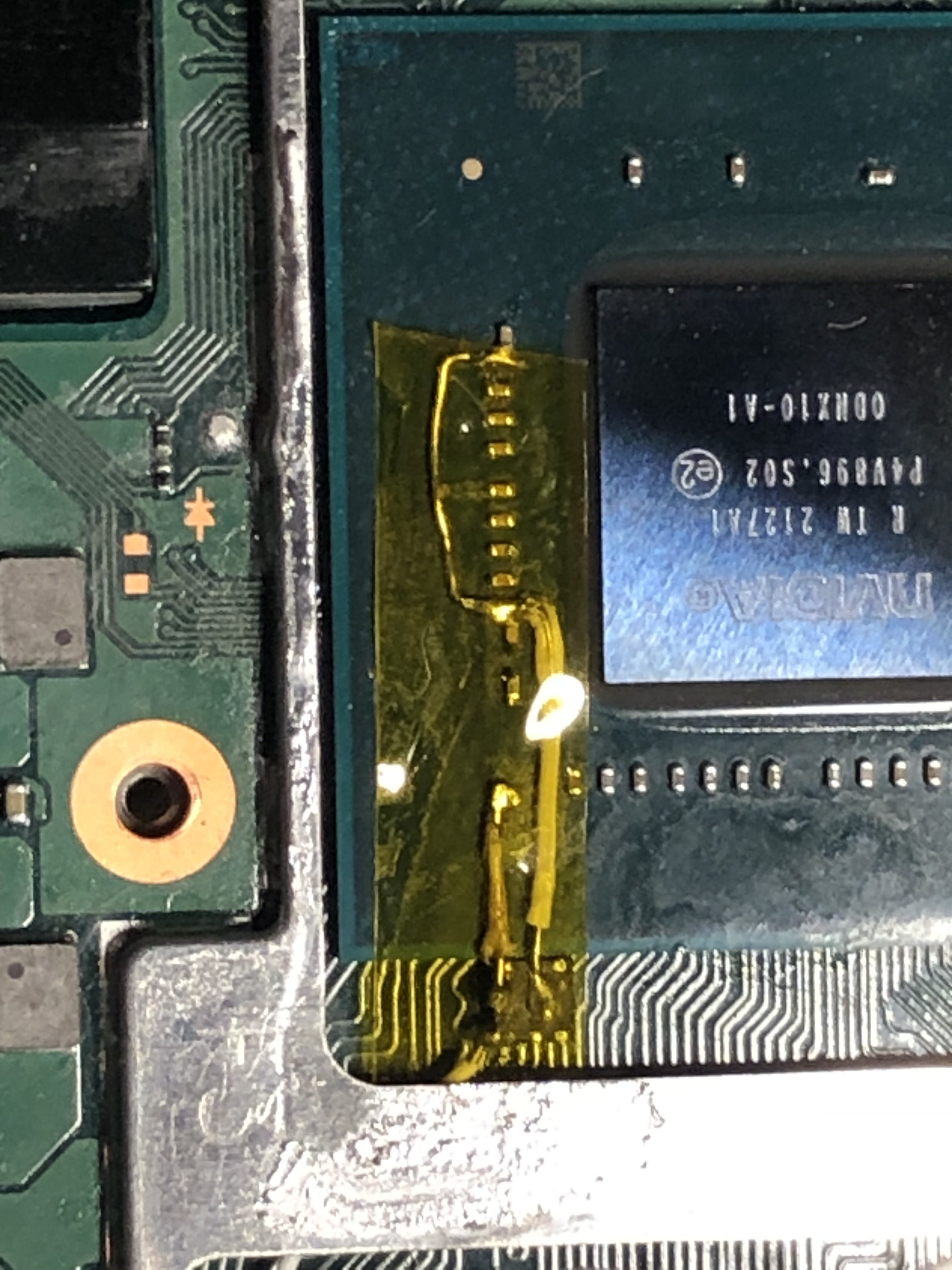

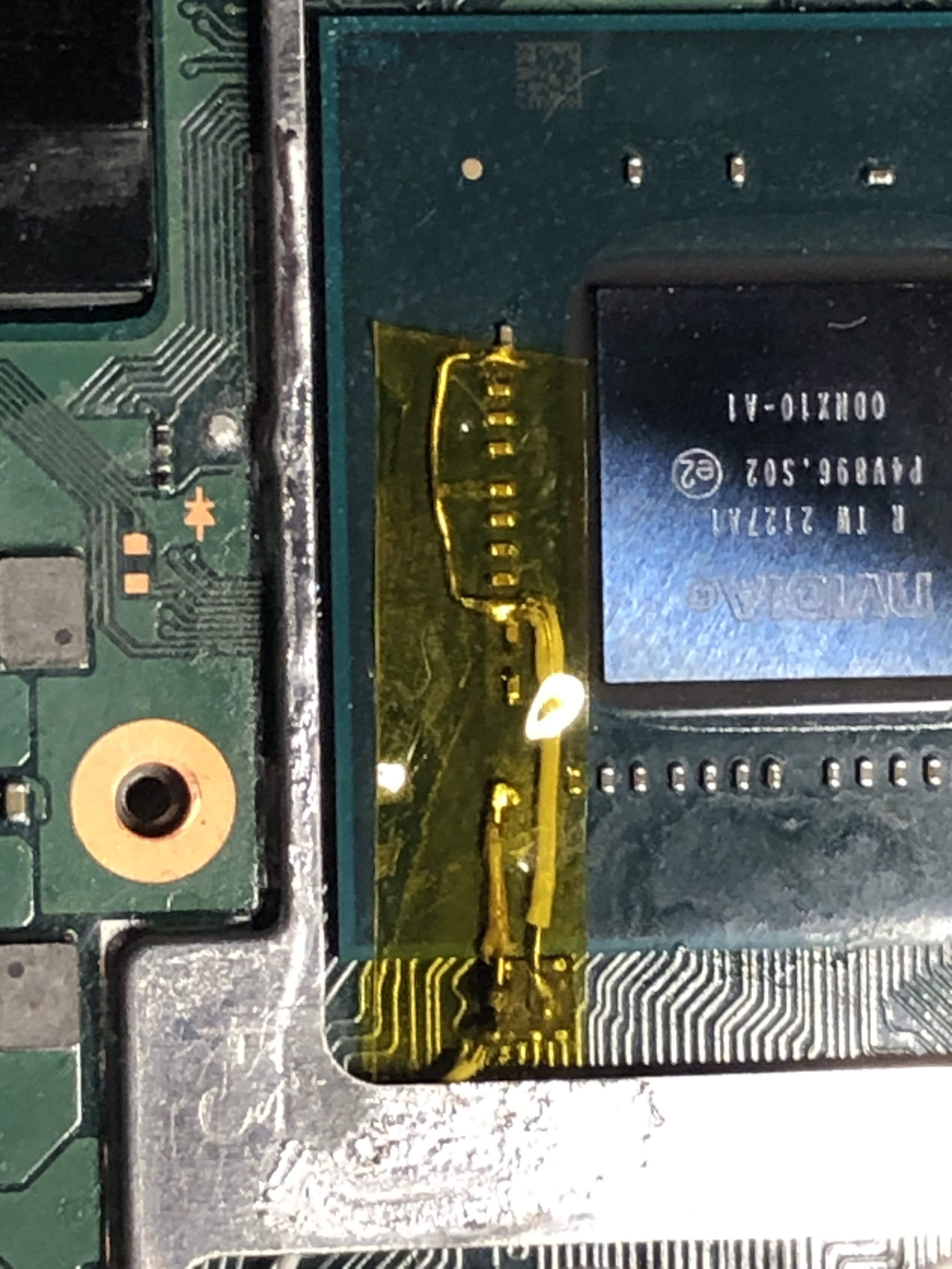

Edit - im sure this is the 'cmd resistor' (attached)

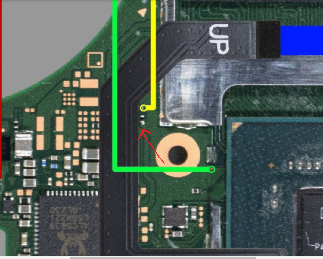

ARE you still making cpu line to rp2040 pin26 and RST to pin15?
Wake up! CPU to pin15 and RST on the PIN26
Reactions: Dee87
You are absolutely right, I just put the cpu at 15 and the RST at 26 and everything works, forgive me for making a whole post looking like a drama queen, NOW IT WORKS, THANKS AND SORRY FOR THE INCONVENIENCE
