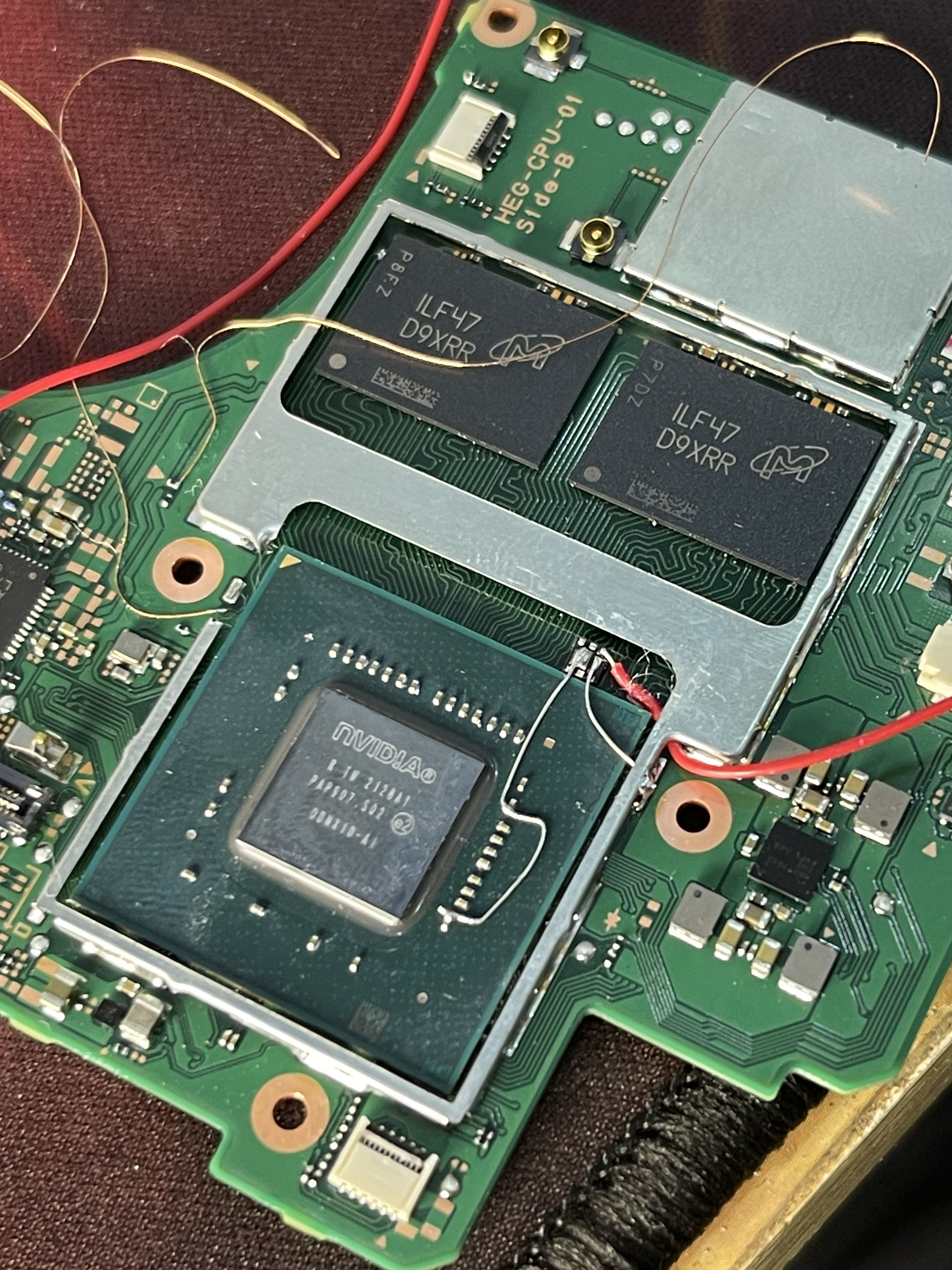

Hi guys,
Installing the picofly I burned the CMD resistor in my OLED switch.
I read in other post that the resistor that is sitting on the CMD point is 4k7 ohm and the one beside that is 47k ohm, both 0201 size.
Can you confirm the value and the size?
I want to confirm before order them.
Thanks and regards
I thought they were 47 thx. But did you add a “second” resistor to fix slow emmc error?
These resistors usually have a 10% margin of error plus some resistance over the wire itself that changes with length, so 45 and 47 are close enough to make no difference.

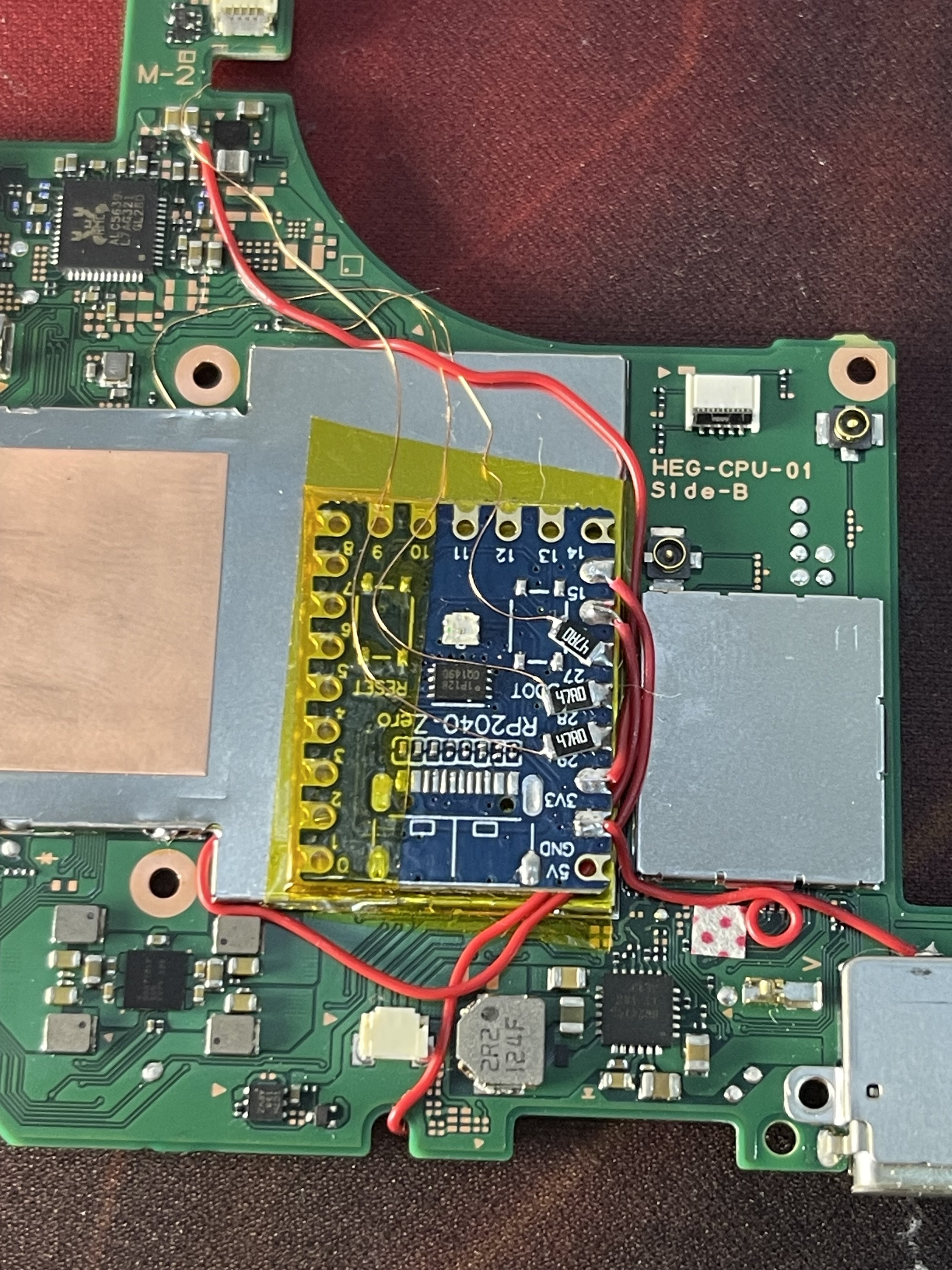

I have slow glitching Pico too. The resistors are not shorted and the diode readings for those points are in range but the CPU point 15 on the Pico measures 1.119 v which I think is too high as I've heard it should be around 0.500. Do you have any idea what could cause the high reading on CPU point on the Picofly?
Picture of install please
Im sorry it is first install. And any thing wrong plz told me what I do wrong. Thanks. Im still not soldring Flex legs i was thinking on my console it is new.

Im sorry it is frist install. And any thing wrong plz told me what I do wrong. Thanks. Im still not soldring Flex legs i was thinking on my console it is new.
Those resistors are holding on for dear life. Check diode readings on all points and report back with values
