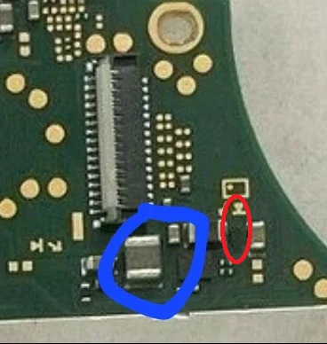

Another questiin guys....i removed emmc and before reball it was testing some points of the board... i found this component with both sides geting 0 on diode mode...i guess its shorted right?
It's an inductor, it is supposed to be shorted so you are OK
@Flaviocarvalho Could you please do me a favor (if your switch is still open) and take a close up picture of the diode circled in red.
We could use the information (whats written on it)
Reactions: Takezo-San
I tryed with smartphone but dont work....will try with microscope later...
