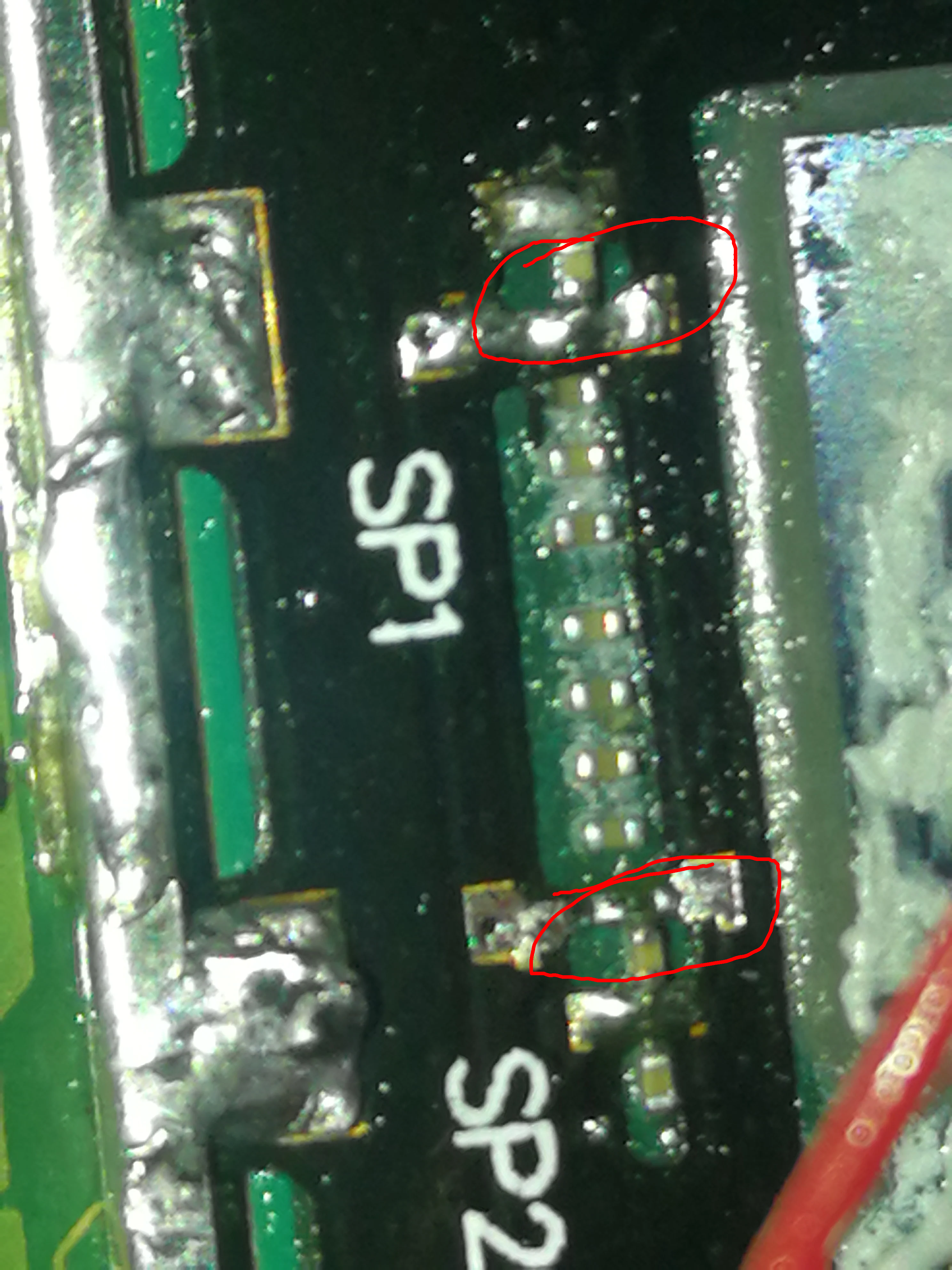

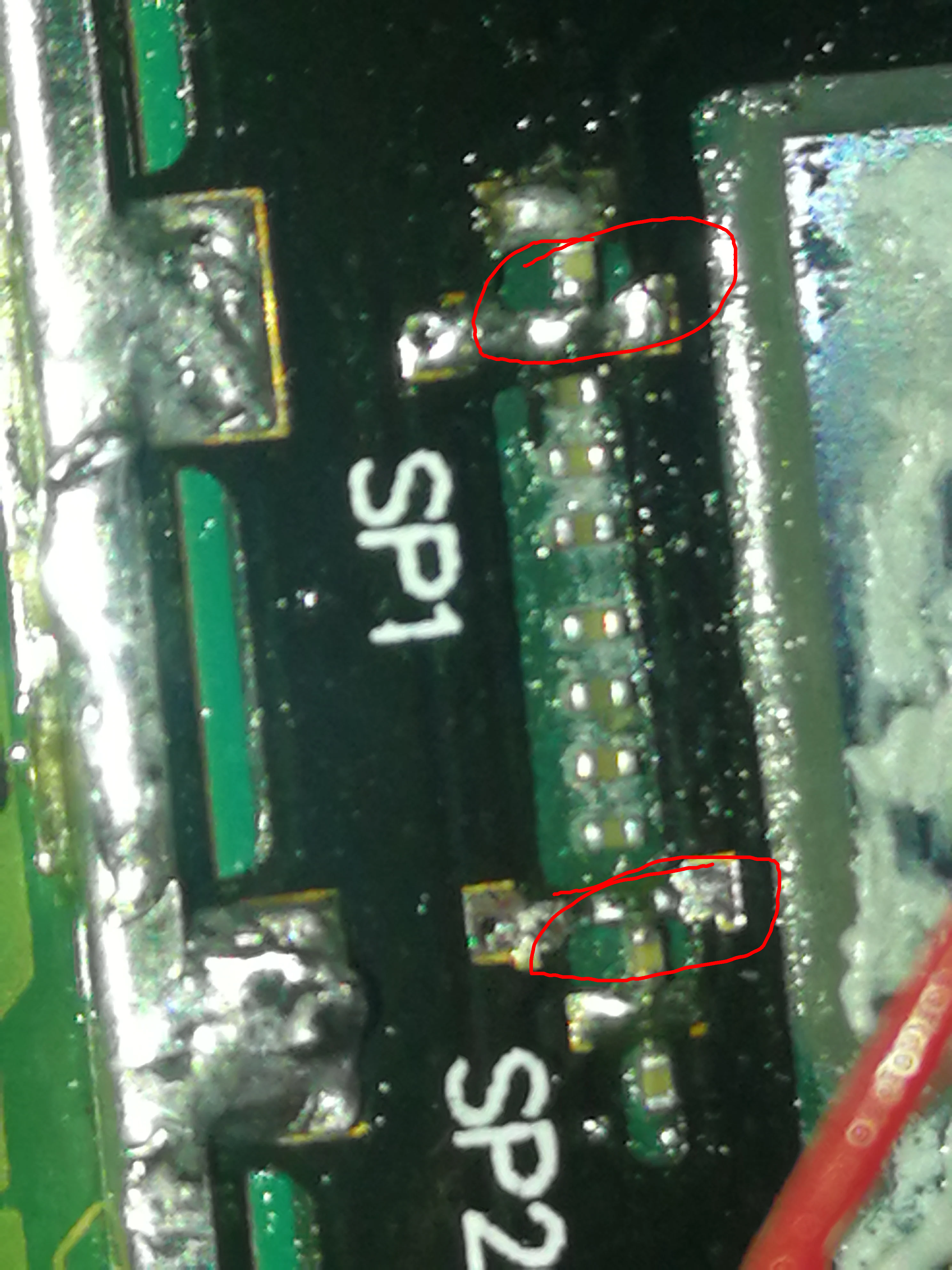

Make sure the SP1&SP2 are still connected

- shorten wires.
- cannot see your sp1-sp2 solder joints!
- good idea to clean off thermal paste completely while installing the mod
If you expect people to help you with partial pictures of your mod then expect partial advice. Though in conclusion, slow timings probably length of wire and/or flex cable. If you are skilled enough, mosfets will make glitch faster (most likely) however, if you haven't done mosfet build before....practise.
