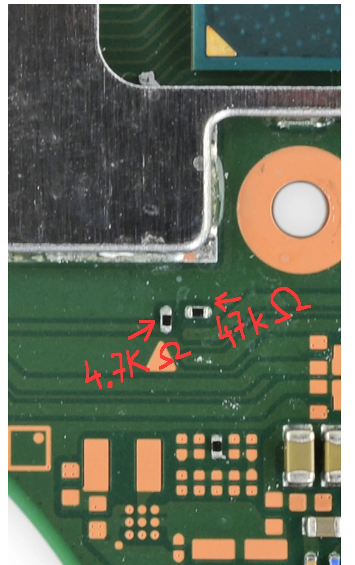

Whre is this resistor?

And did you check for @Dee87 advice on checking the resistor values?

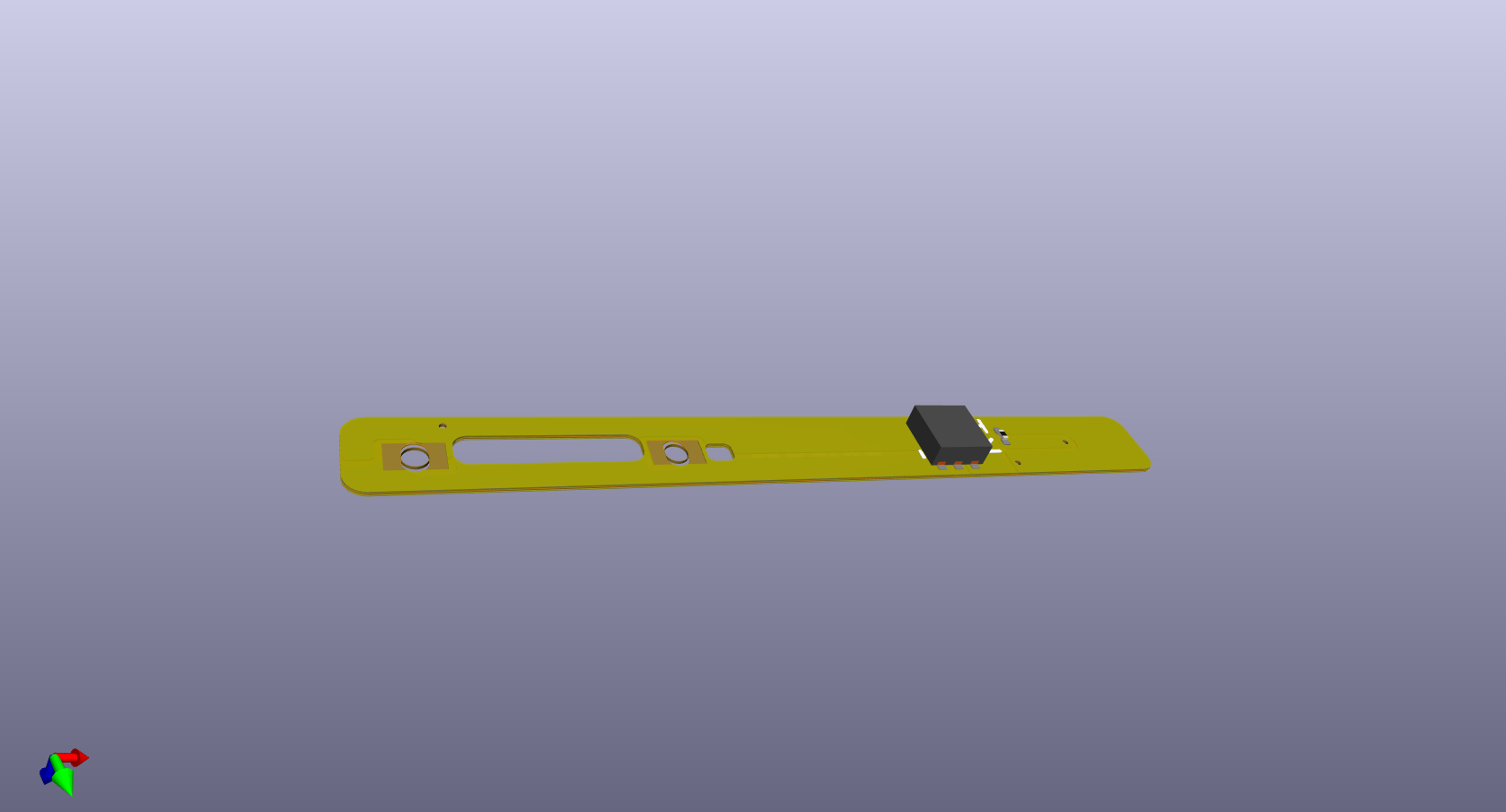

Here is a CPU flex for Mariko devices, with Dual Independent MOSFETs. I put small pads for sp1 and sp2 if you just want to run wires instead of placing the flex over the capacitors.
also ignore the small circles in the cutouts, that's just the 3d viewer not cutting out the copper from plated through holes.
Kicad project and gerbers:
https://drive.google.com/drive/folders/1YPrlNqbp0VJ8IM3nWb1fSZJKgaQMFjxY

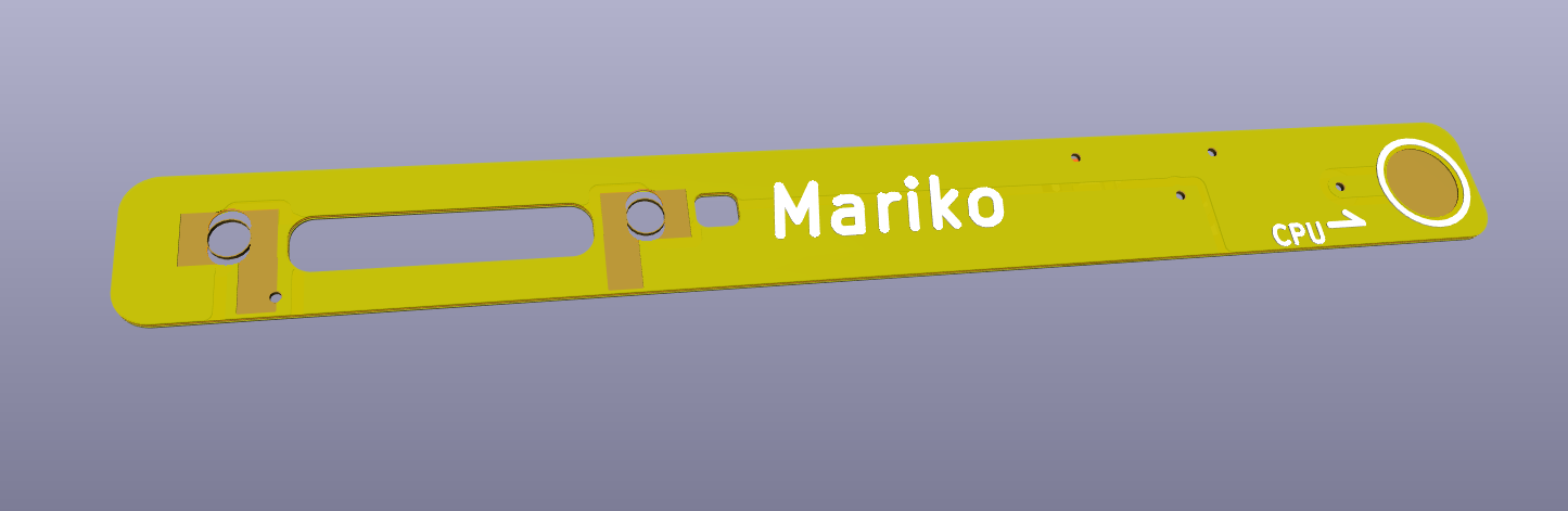

I like the Idea that put the CPU point at the Right.
I think I will try it at next Revision.
