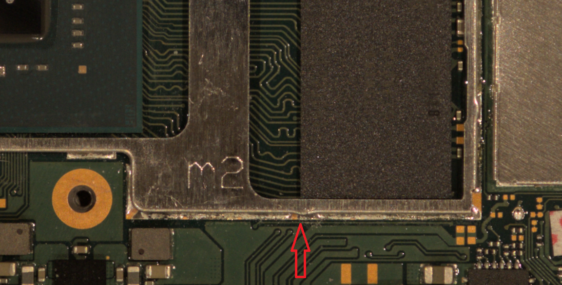

I like the Idea that put the CPU point at the Right.
I think I will try it at next Revision.
Yeah, the point comes out just next to the ram, makes it ideal to run an insulated wire through the opening in the metal enclosure. Just makes sure if you use enamel wire not to let it expose the wire on the sharp edges of the enclosure from movement, I use a thin silicon insulated wire from Adafruit.

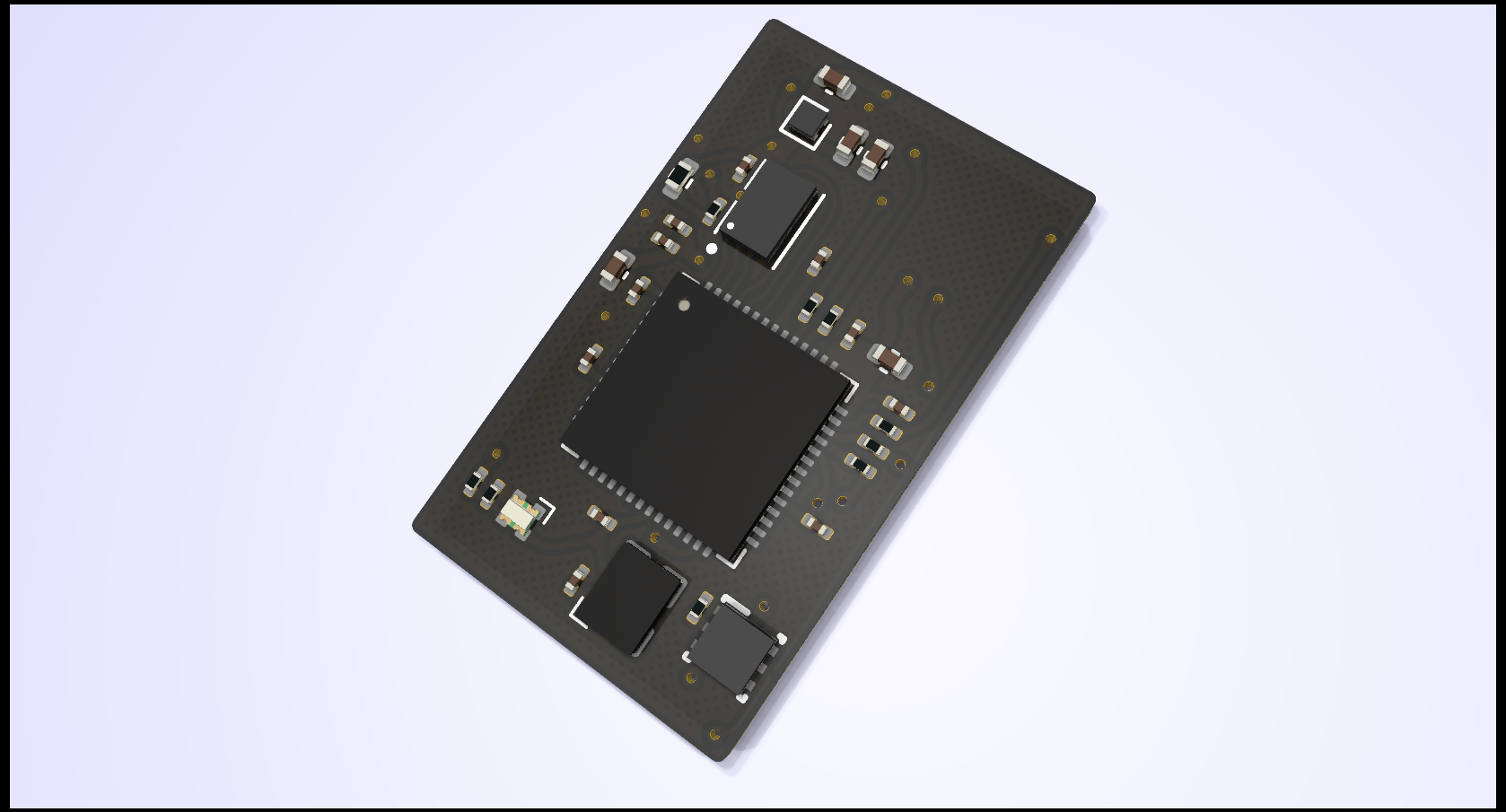

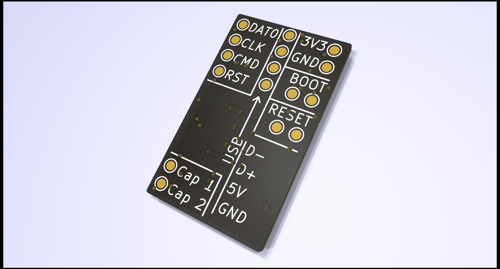

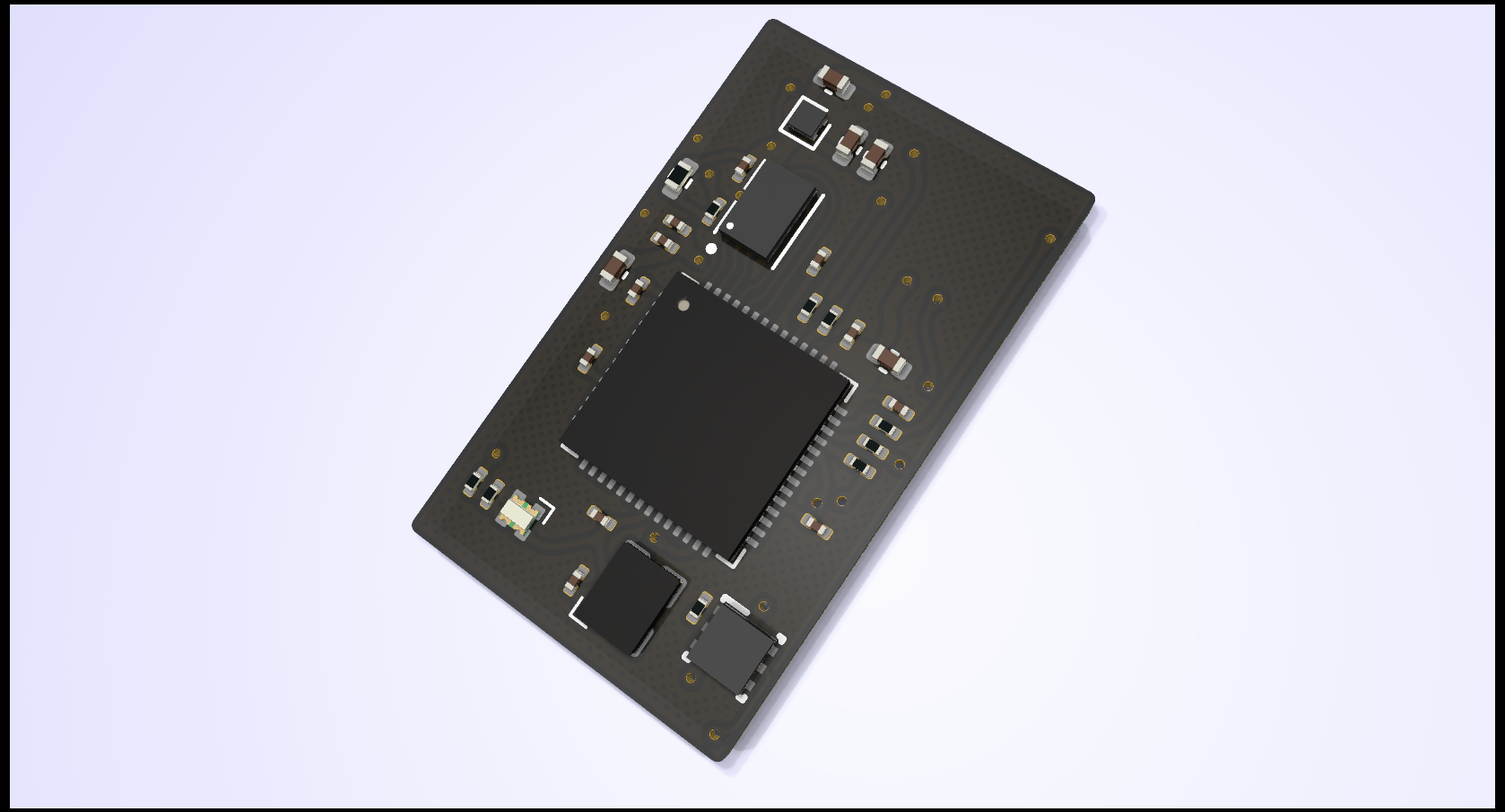

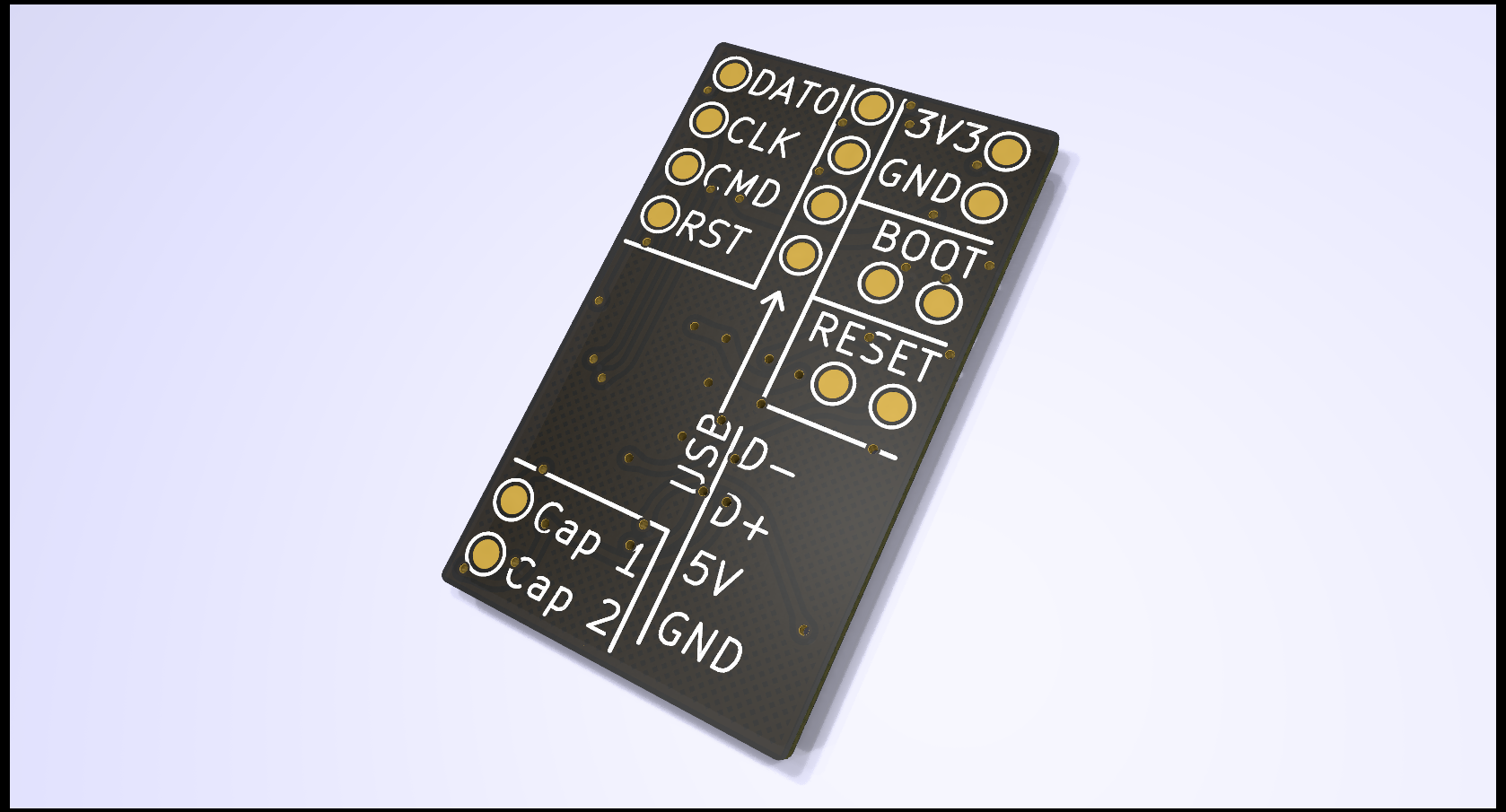

Here is a rp2040 + dual mosfet board, it's untested at the moment, I'll get back to to the thread once my boards have arrived.
It measures about 14mmx 25mm from memory. If you order the board with 0.8mm fr4(economical) the total height is around 1.7mm, otherwise with 0.1mm flexible polymide the total is about 1mm.
https://drive.google.com/drive/folders/1lldumDr7aOpNCwfE2Vw_DBWkPrt6qRWx?usp=drive_linkView attachment 374811View attachment 374812
Just curious, looking at the layout, where does the "dual MOSFET" come in? I only see one component in the renders that appears to be a MOSFET.
Reactions: Takezo-San
Have you tested it ? seems the RdsOn value is too high, or maybe it can only work with SDA SCL point.
I haven't tested it. The rdson value is well within scope. It is only 3mΩ higher with a of VGS = 4.5V. I = (assuming 1.8v across cap, just a guess) / 0.00002 ohms = 90,000amps vs i = 1.8 / 0.000023 = 78,261amps, negligible for an application that is tdp using 2 amps at max ever.
