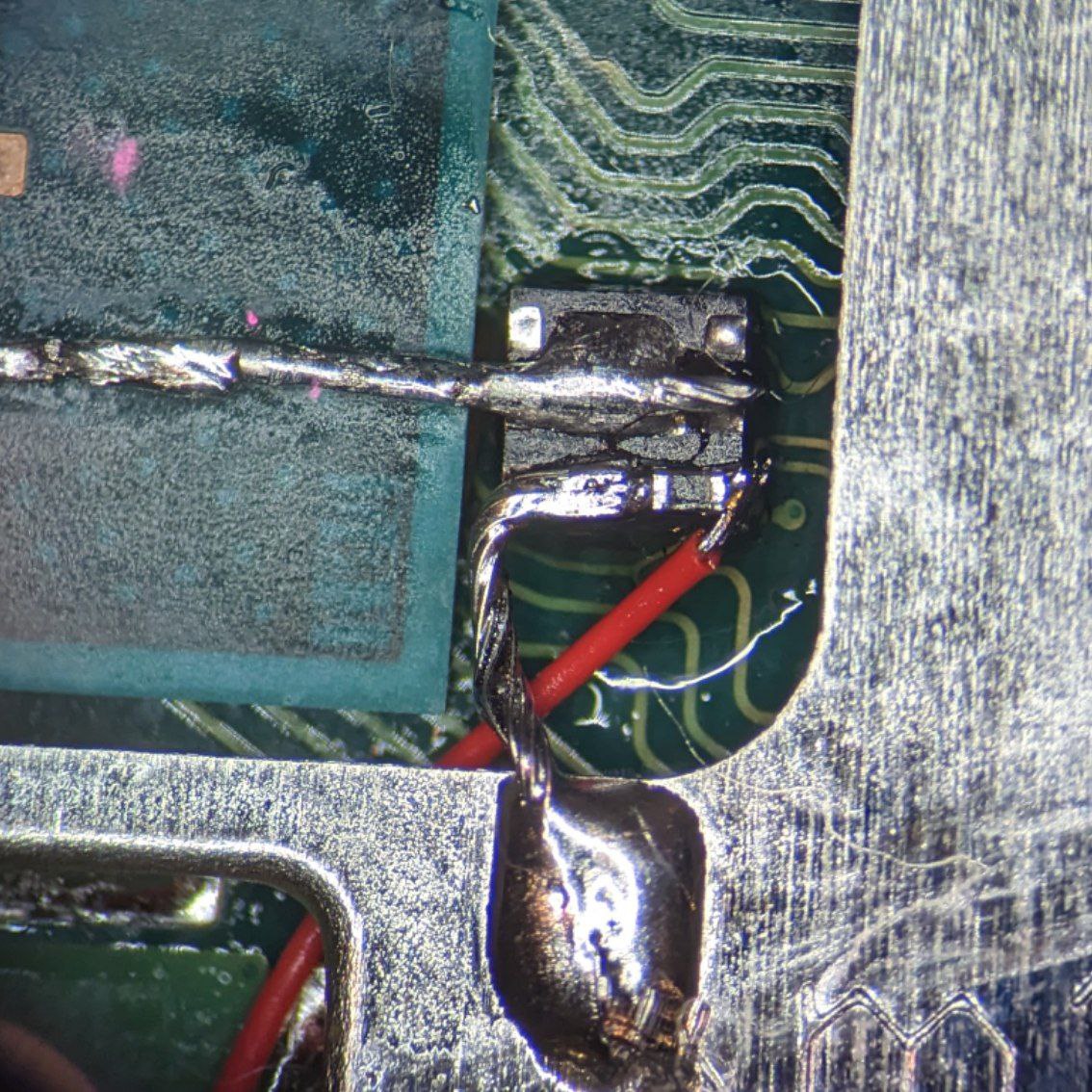

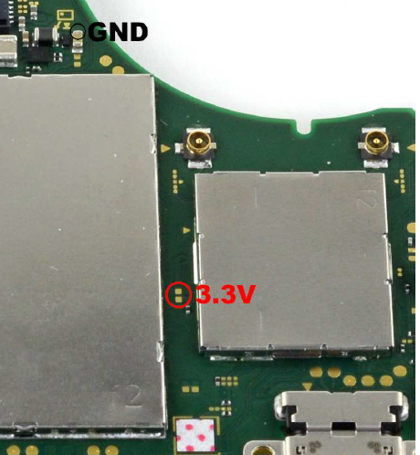

I'm trying to install my picofly but I have 2 questions, is there an alternative 3.3v point? And now I shorted these 2 caps, but I'm struggling to desolder them, any tips to fix this?

I have to press reset button after joycon logo. Btw I'm using 2 mosfet and 0.25mm wire. I thought using 2 mosfet should eleminate this reset button issue. Or should I go for SDA and SCL wire?
it is below the emmc chip.

I had the same problem.
Clean everything then add some more low melt solder to the same spot (or at least some 63/37).
Then add some flux and use a copper wick/braid between the two caps to suck out the excess solder.
Do it in relatively short burst to avoid damaging the caps or desoldering them altogether

Probably this won't solve the BSOD, but a note for the future: use the +3.3V from the AIO guide
If you brave enough just remove that bellow cap.. and then clean the trace, it should be easier.
After that if you cannot solder it back then just leave it and see what happens, the switch itself will still turned on without that cap.
And for 3.3v point you can switch/use the one on the back of emmc module.

I missed the top side of the emmc, here
Sigh, read the thread and you'll understand why some of us seem jaded \snarky\sarcastic. You're asking for free help and also start it with an oxymoron. It is LITERALLY impossible to make a "flawless install" and have something go wrong after. Yet people keep saying something to that effect, repeatedly.
Doublecheck that your emmc connector and socket aren't damaged. Taking the emmc off can break the solder connections on its, uh, connector XD, and since you had it off, maybe there's something in the motherboards socket.
Let's see pics of the whole APU.
A lot of your wires look to have too long of a tinned end, use flush cutters to cut to a better length AFTER tinning the ends. Helps to be sure you're not shorting to something else.
I don't solder to the emmc, so I'm not sure but your 5th pic looks like the most-right-wire looks maybe shorted.
In a later pic you show a MOSFET and it looked like maybe Gate is shorted to Drain.
