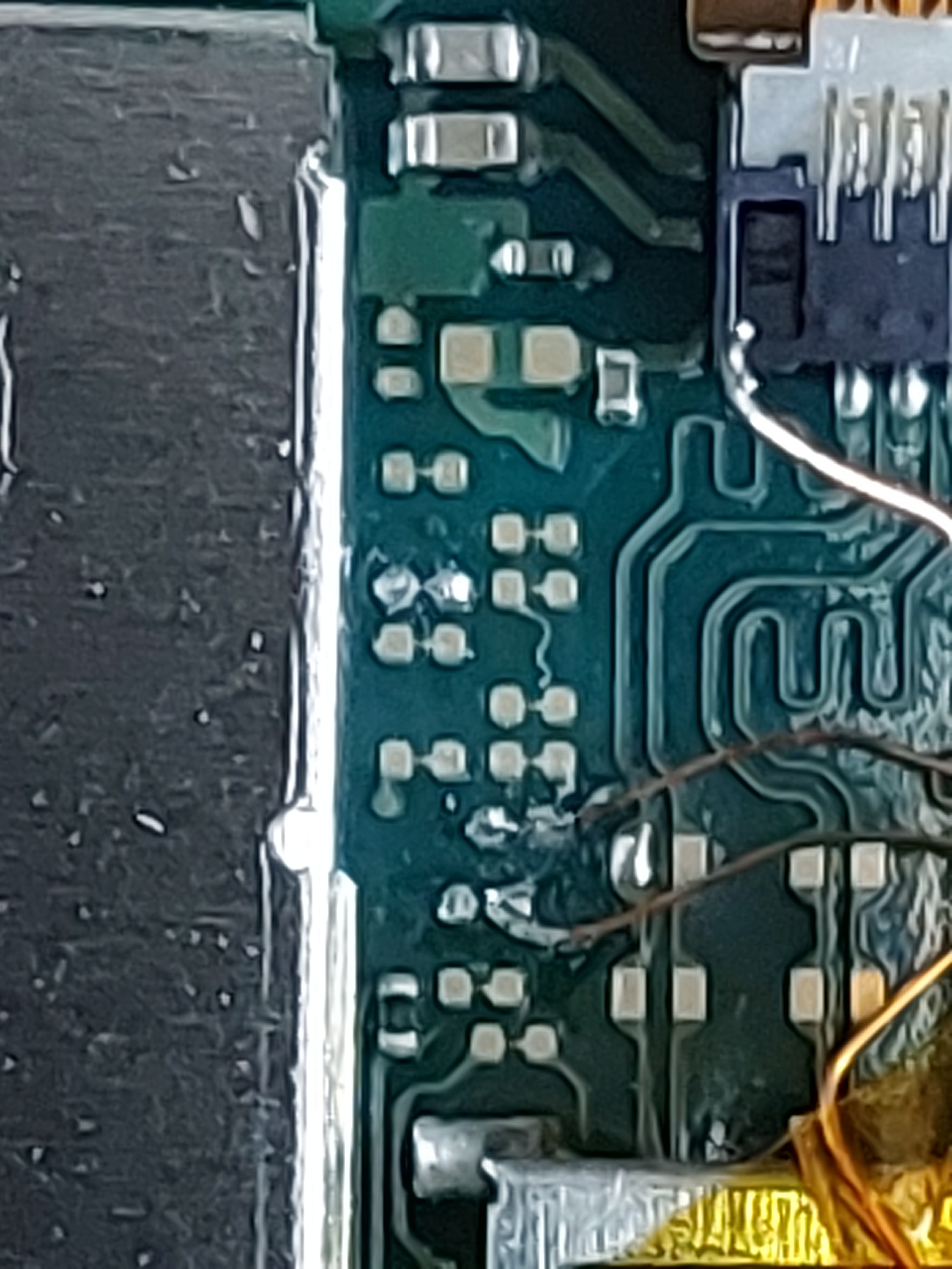

I Have the same problem. I found shorted around Enxx Ic after I Installed picofly.
Can you provide the picture of the resistor on pi zero?
maybe the resistor was touch with the point on the board.

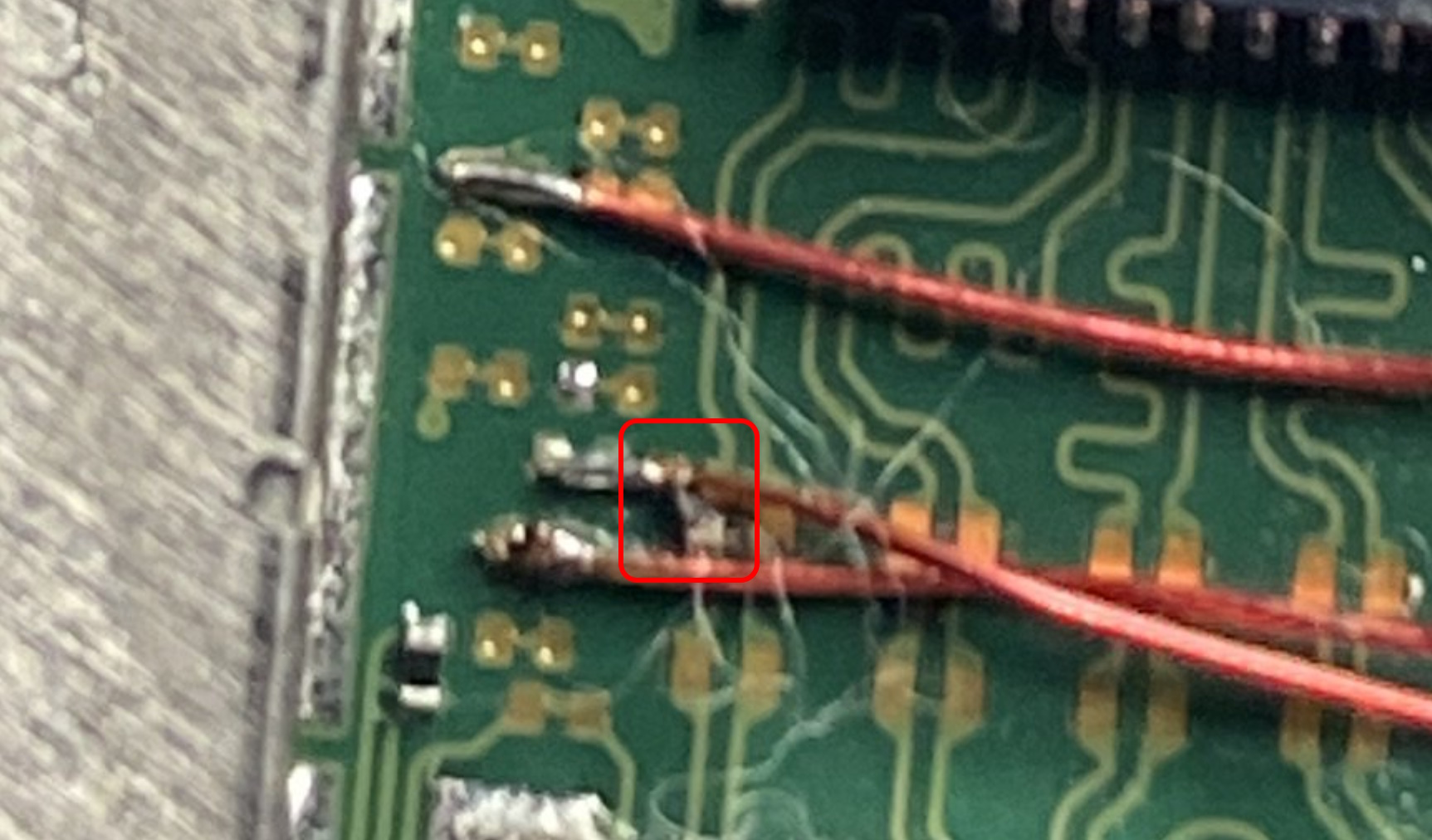

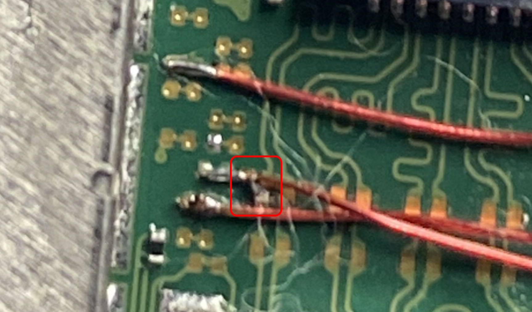

I see accidental joint. Try removing all the wires, check OFW boot after that
Reactions: MegaDeKay
Thank you. I removed all wires and it just boots on blue screen. Could this accident allow the lite to show the no sd card but then goes dead?
could be, this wire looks like differential pair, which is usually below 1.0v voltage, thus 1.8v from the CMD line could be too much for that component. However I am not sure where that line goes

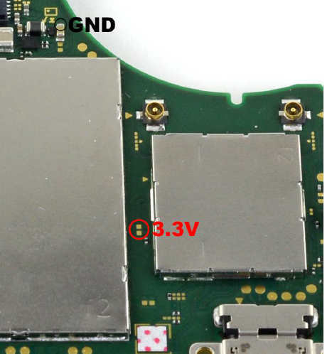

Probably this won't solve the BSOD, but a note for the future: use the +3.3V from the AIO guide

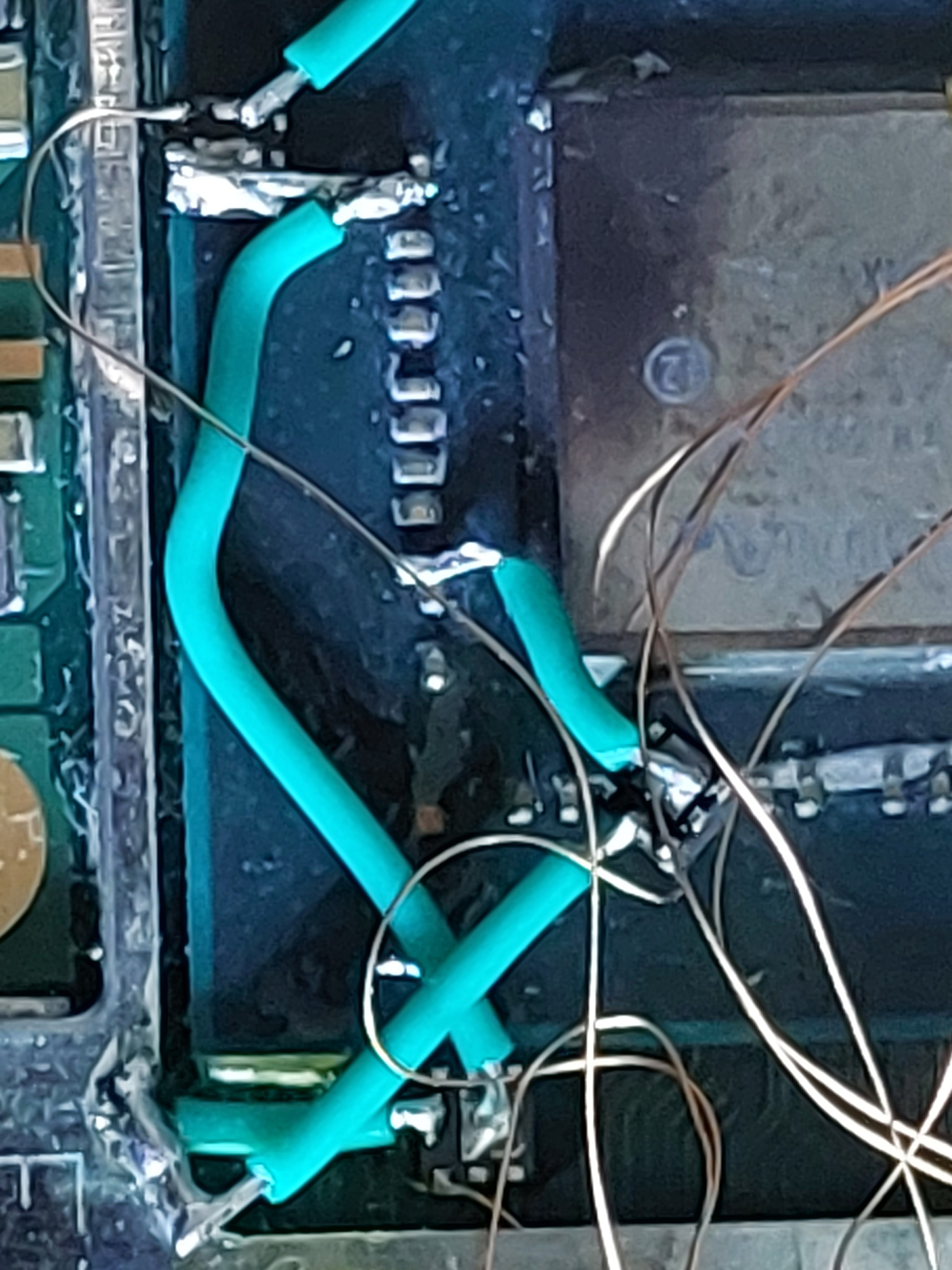

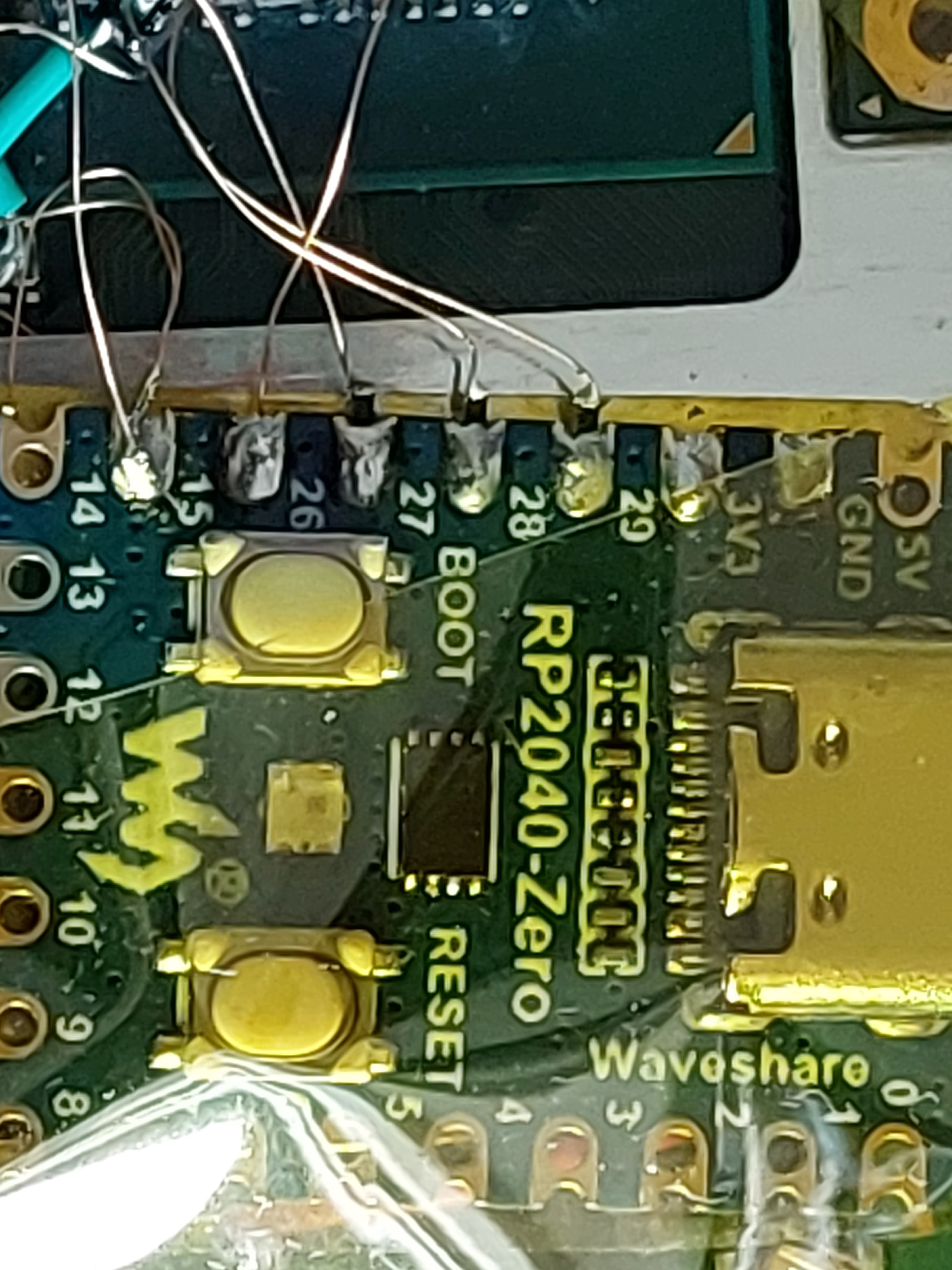

Then you need to post detailed photos of your install, because plenty of people have been claiming "perfect install, but still have problem!" and then when photos surface of their install... we'll just say it isn't always so "perfect".
Here are some pictures. But this one was a test if its working, thats why its a mess but conections are good. no shorting or anything. also one cable is ripped of...happend while making the photos...:D
Also this is with 3 mosfets now, cause i had forget to set the pico to rgb mode and got before red at the end all the time.
After setting rgb mode colours of the glitching were fine. but all the time black screen with backlight on. Sound, touch and buttons are working, all of them.
I guess i damaged the flex cable to the daughterboard somehow, ordered a new one. See the last picture, there are 2 little dents, happend while taking off the battery connector.
If you see anything on the pictures tell me. Thanks.
Pictures are made with my phone, to lazy to get the microscope out :D
And yes, these are 0402 47 omh resistors at the pico connections. Had them laying around already.

why are u using those thick wires on apu ?
there is no need for 3 mosfet max 2 one per cap
remove all mosfets cables and install them like the pics of the diagramm in the aio thread and try to install then that way will 0.2 mm as short as possible.
ur issue with the flex cable could be like u said the flex cable.
i would try to install everything clean and see how that works.
if u install it like its supposed to be it will defintly work.
