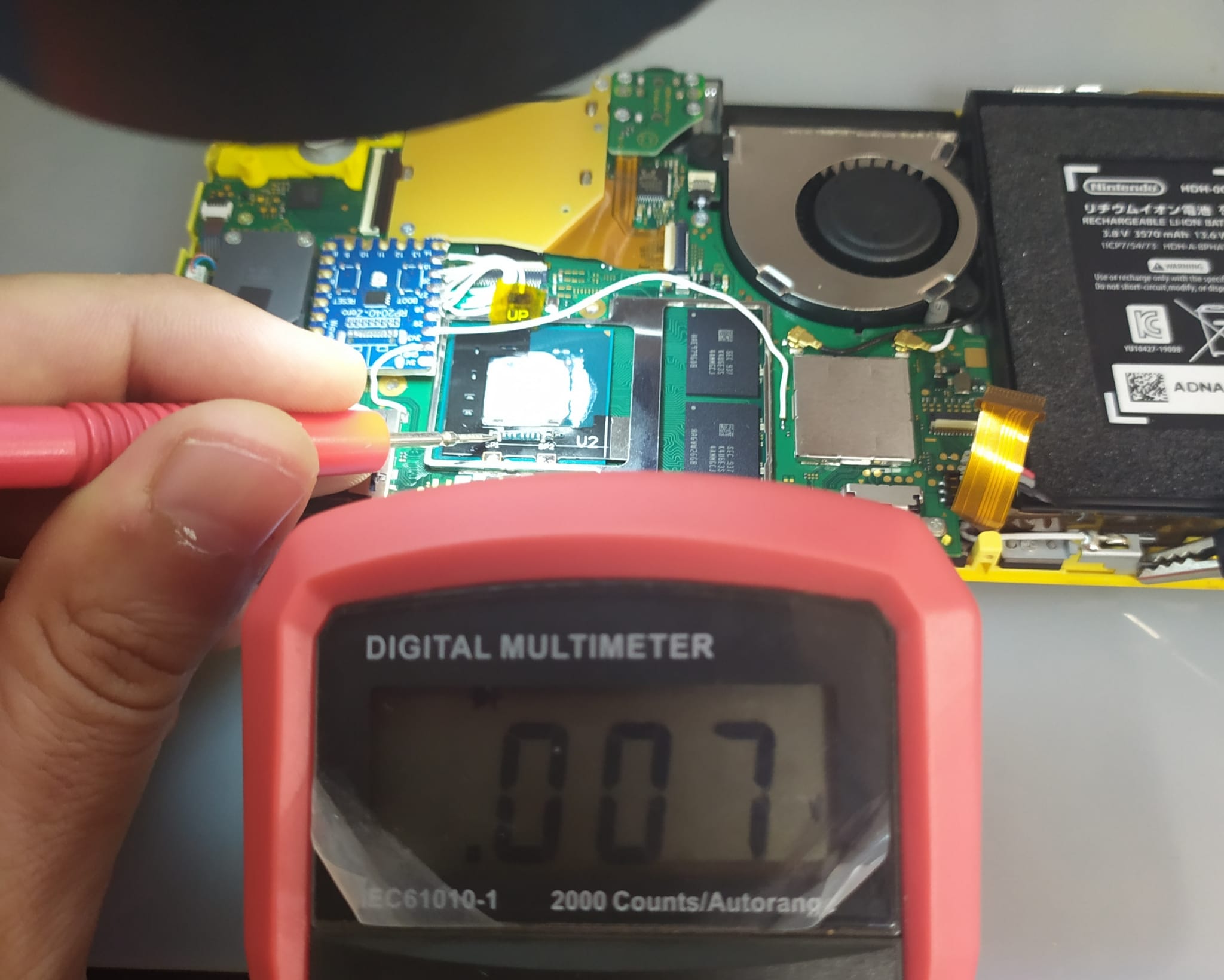

All the points are covered with UV mask, so I do not show these points. the diode values are correct for all points, especially dat0. where can i find Firmware 2.70? I want to try another picofly.

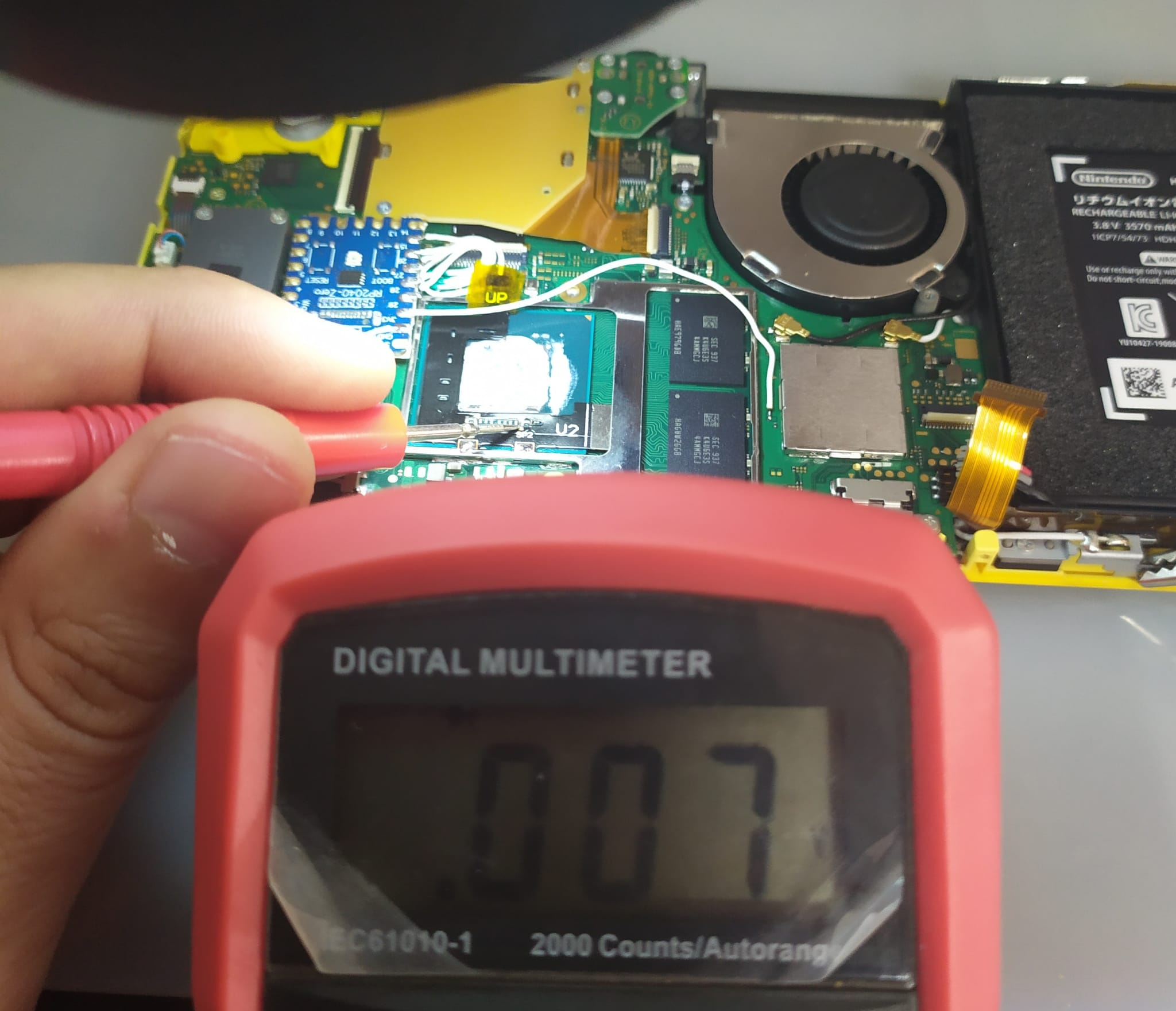

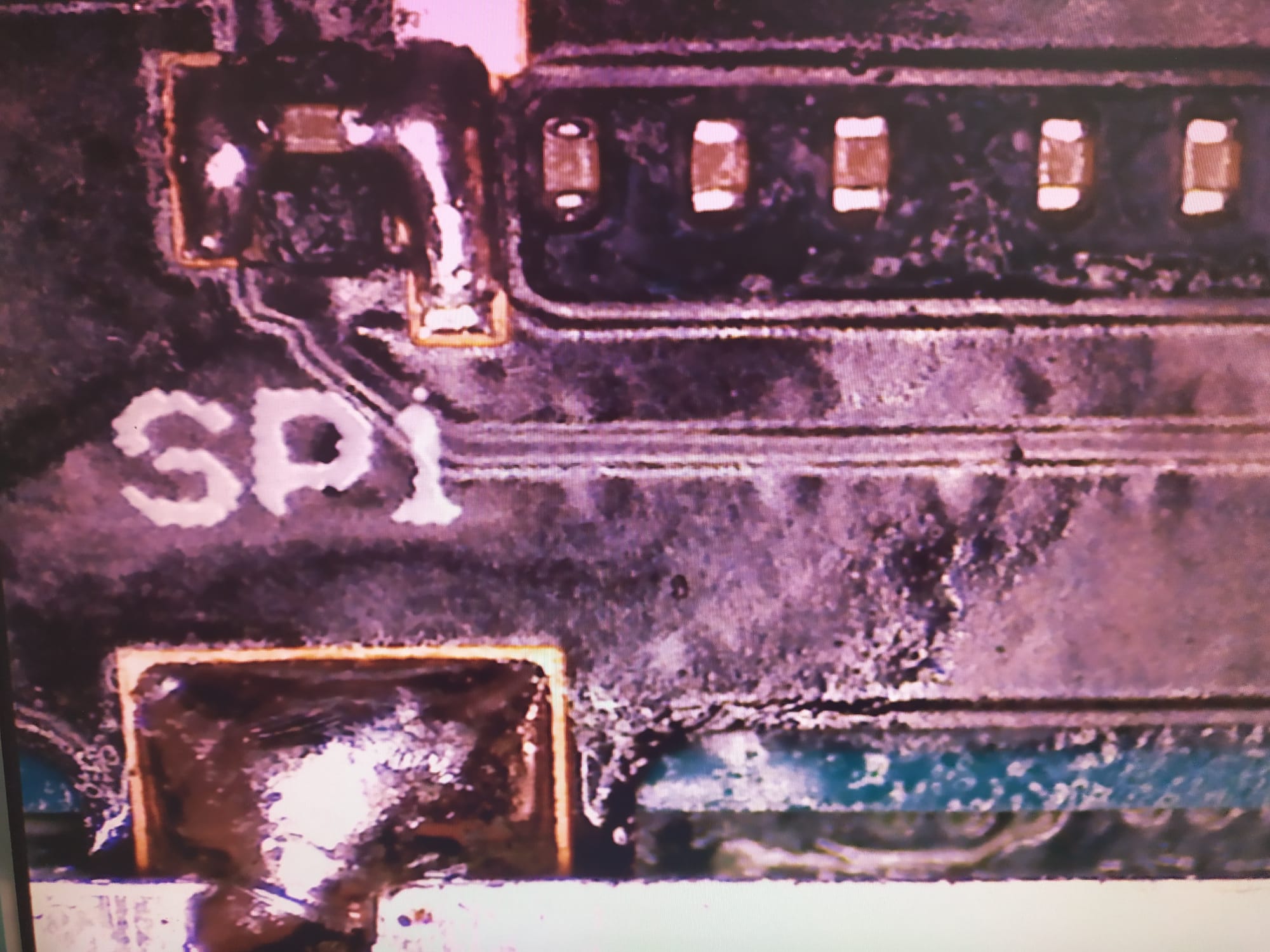

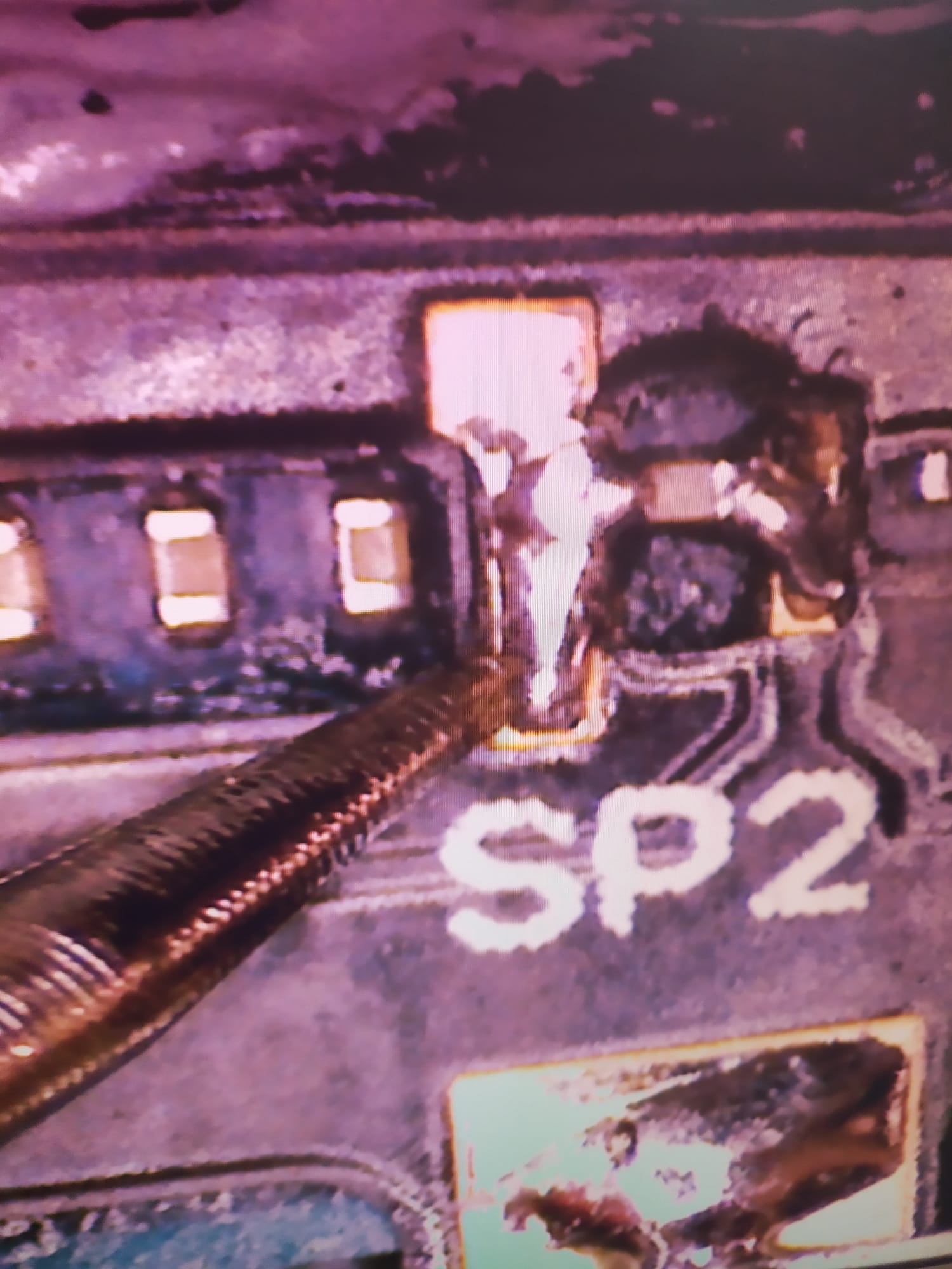

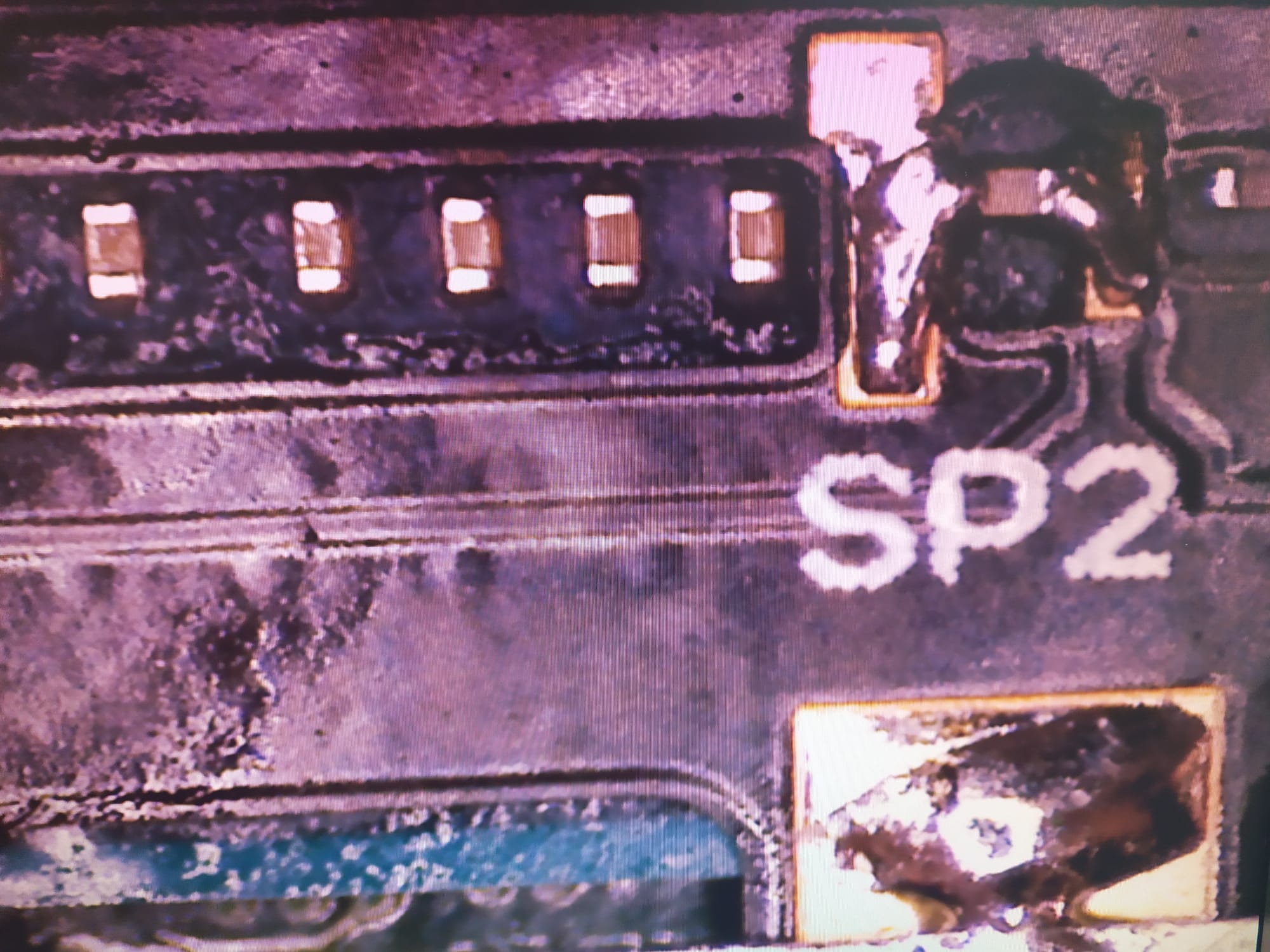

What are your values for the sp1 and sp2 points? Usually cpu flex not installed correctly
Sent from my iPhone using Tapatalk
I have used flex V1 and now V2 with the same problem. I think the diode values were 7 positive, I'm not sure about the latter.

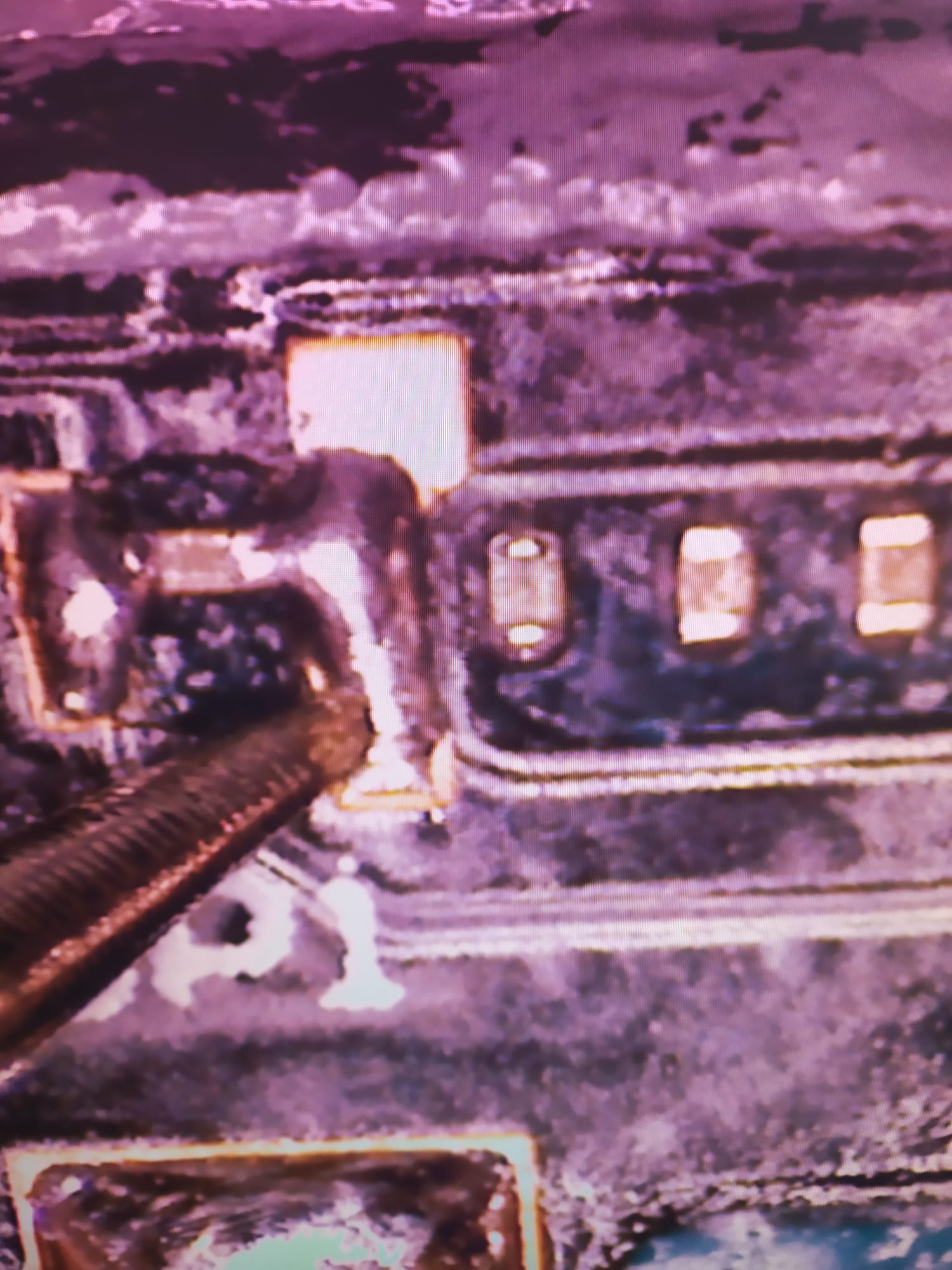

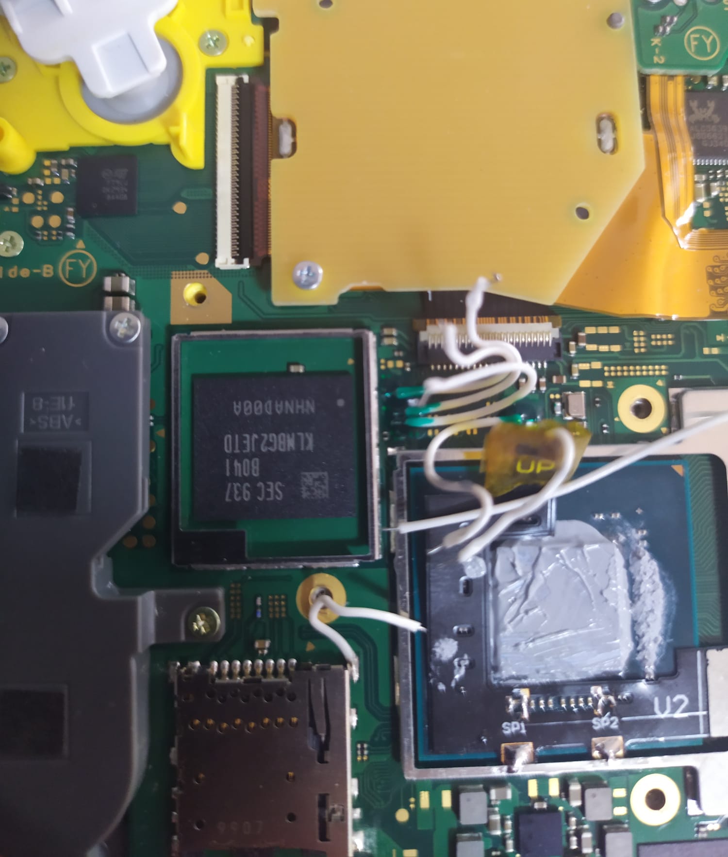

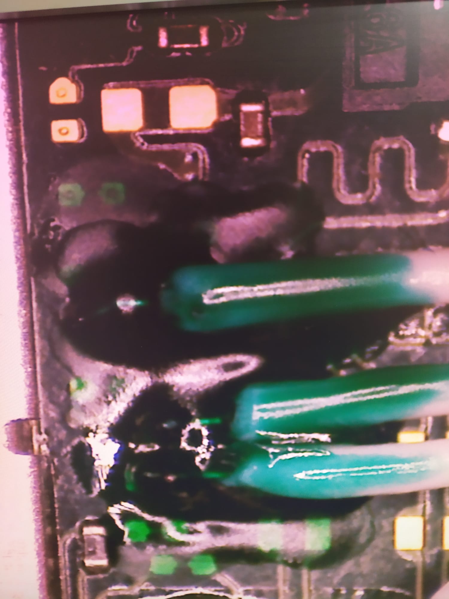

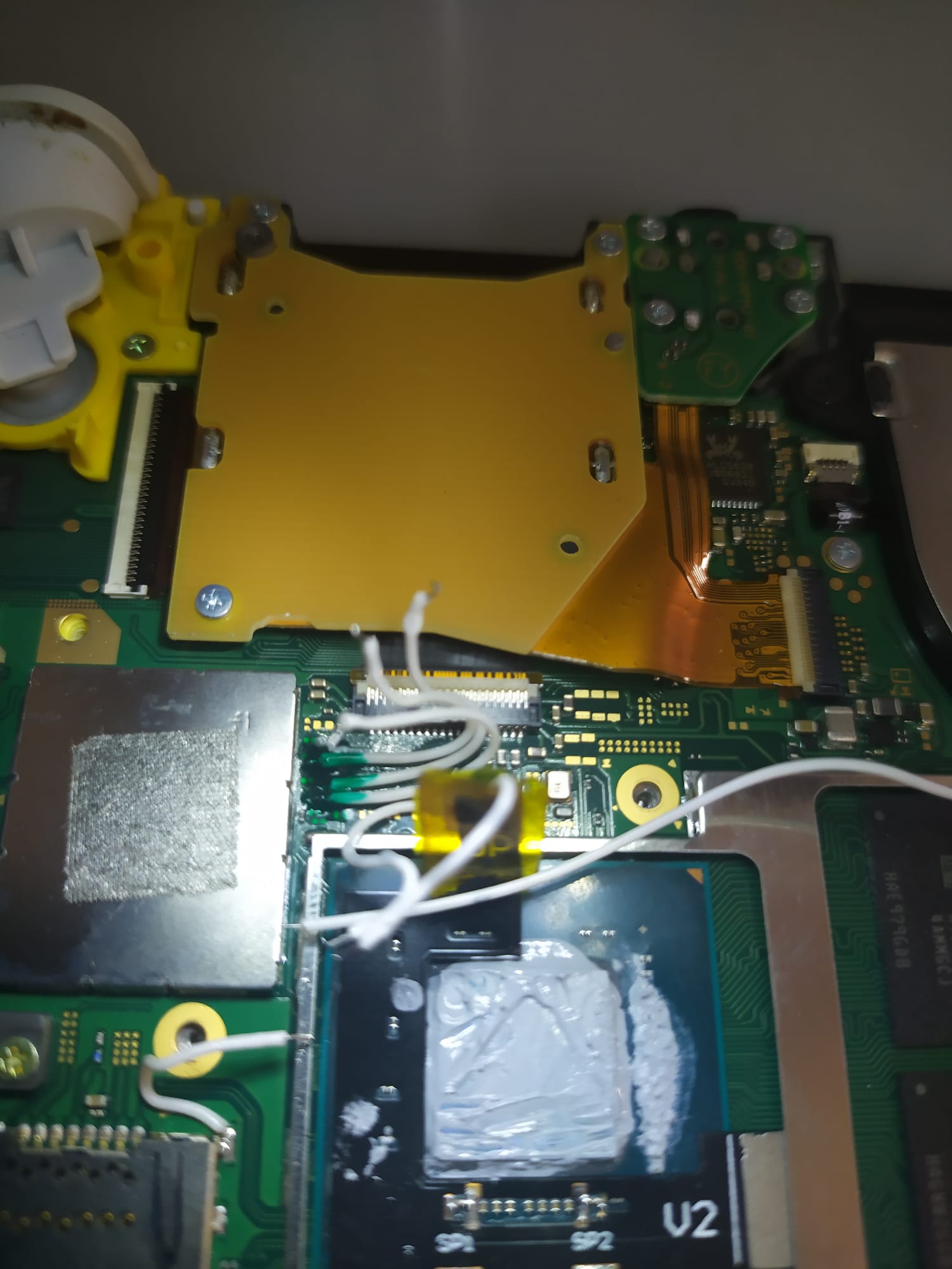

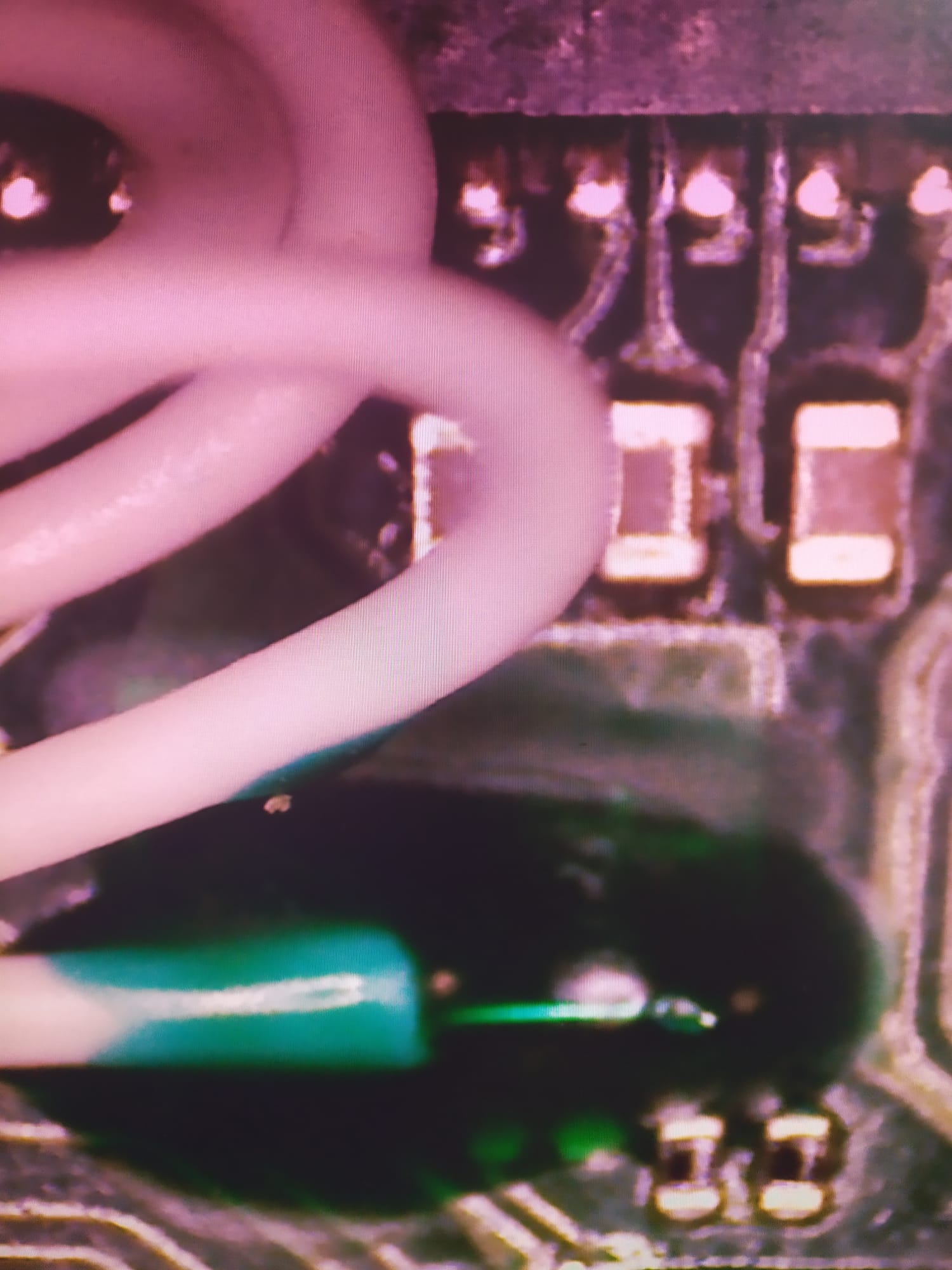

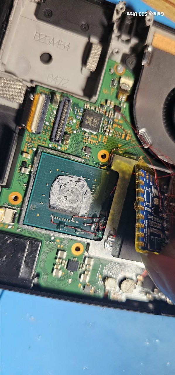

new images. any ideas?
edit: The only thing that is not clear to me is the values of the cpu. but I have tried several cablex flex with the same result

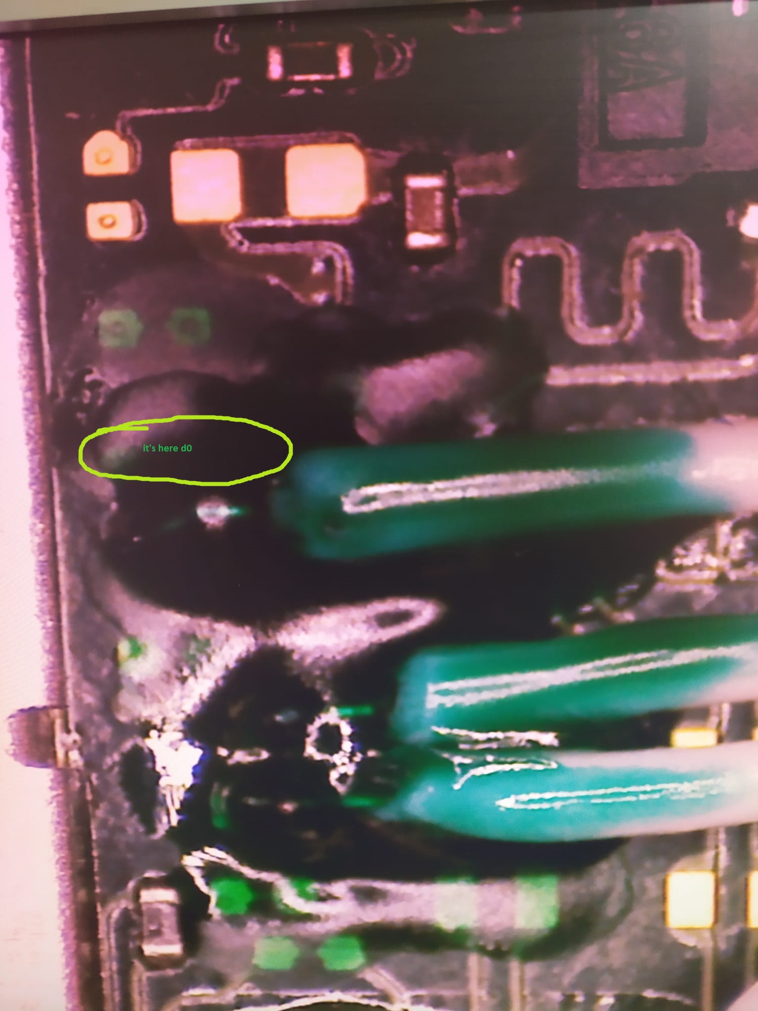

It seems to me that looking at my own images I think I made the mistake of soldering the d0 one position below its correct position. Can you see it in this photo? or it seems that they are my imagination hehe
Reactions: QuiTim
Just checking them now and yes wrong point
Reactions: MAI87
Me too but this issue is resolved because I used the new 2.7 to see what error it give and it is =* which is d0 point not connected properly.
Reactions: MAI87
Well, there you have it, Yellow=Bad dat0
Chances are that this is it.
Reactions: MAI87

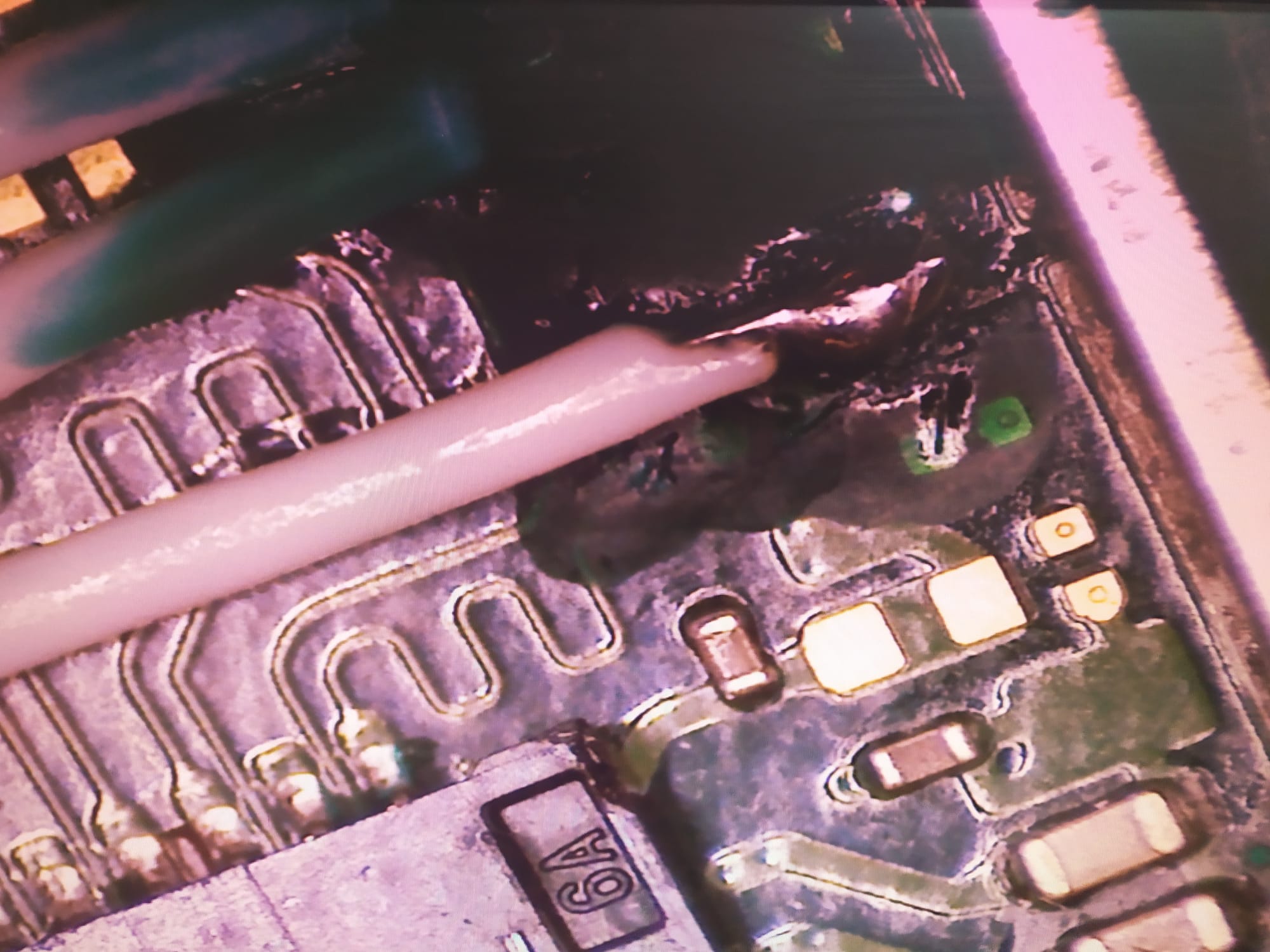

Thanks my man. I think I should have shared that when I first booted the device after installing the MOSFET, smoke came out of the APU, when I removed the shield I found the G point's wire stuck on the metal and was burnt. Since then I've been getting blue screen on and off and now just blue screen. I checked the caps behind the APU and the red ones were shorted.

effectively the point d0 had it in an incorrect position. I seem to be dumb sometimes oh my god. It is already changed and tested. picofly has trained and now works perfectly. Thank you all very much for your support. In the next installation I will use the new Firmware from our teacher. All this would not be possible without all of you. may god bless you all. We keep talking friends.

Then you need to post detailed photos of your install, because plenty of people have been claiming "perfect install, but still have problem!" and then when photos surface of their install... we'll just say it isn't always so "perfect".
