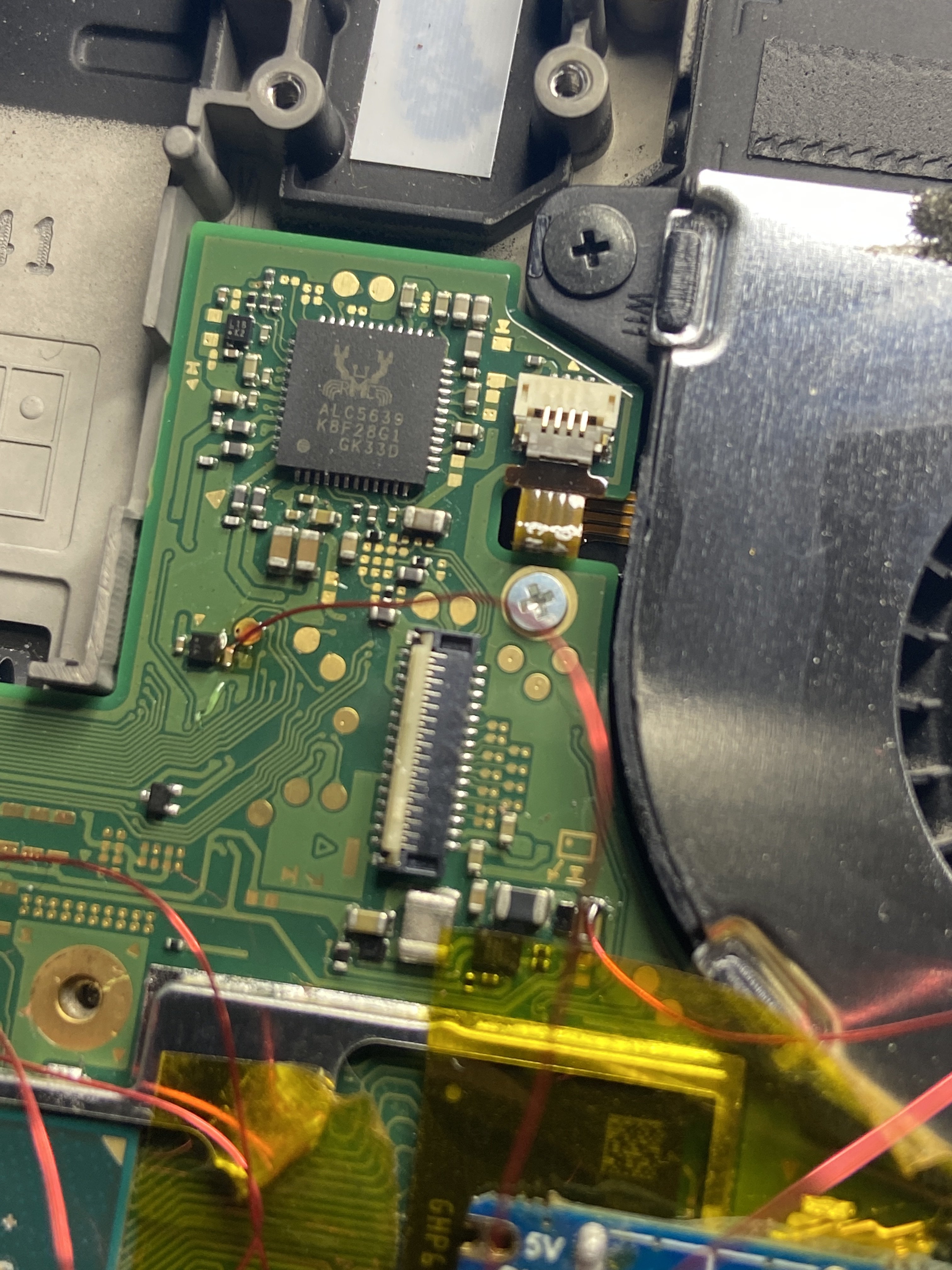

Thanks all, but this is really frustrating. I got another lite and I ended up with the same issue. After installing it it did give green light and no sd card logo. When I installed an SD card with hekate, black screen. I turned it off removed SD card and booted again. Blue screen. I removed all wires and it still on blue screen.
Very frustrating. I followed the diagram by the inch and made sure all readings are fine. Why am I getting the no SD card logo but everything went sideways when I install an SD card. The same exact issue on two Lites.
