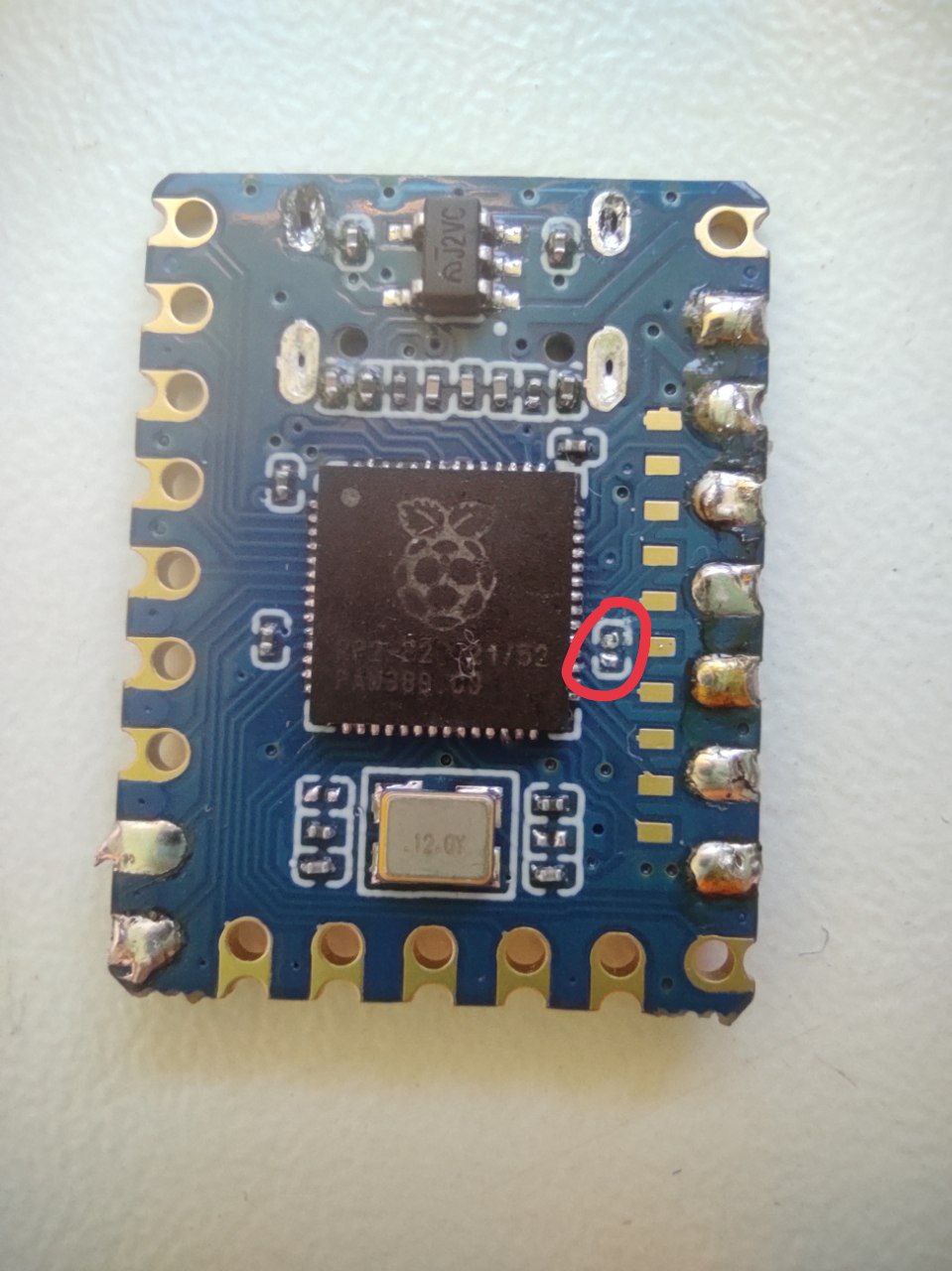

Well, I found it on my desk, check it. Again, I'm extra careful with these installations but the only different thing I did this time is only using a single mosfet, bit I've successfully done it in Te past. Hopefully now you see why I'm so confused
And another thing worth mentioning is that I've already performed a reflow on my APU and no luck so far. I'm super frustrated since this is the first install in over a week that dies like this
Btw sorry for insisting, but I'm quite baffled by this dead switch. I killed 2 prior to this one and those were 100% a bad installation due to the RST point having a transistor next to it and I think I fried the transistor both times but that should've been avoided with the eMMC solder points.
It has worked multiple times in the past but this time it simply... died, no reason to point at and that scares me :s
