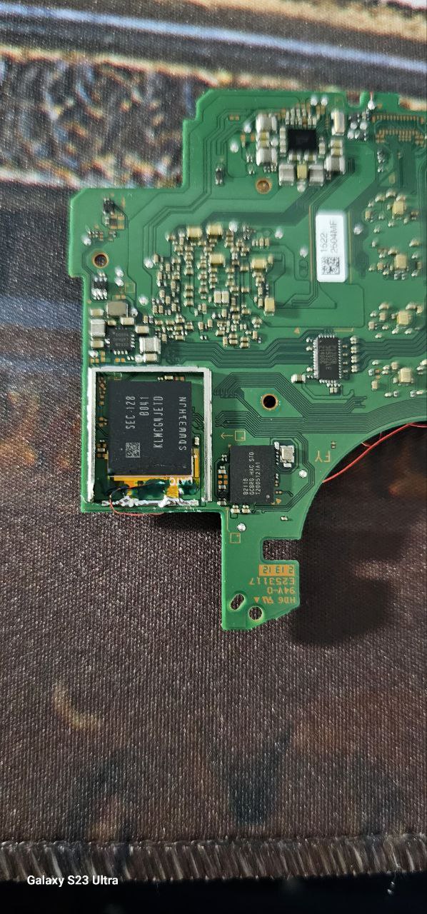

hi guys, i made a mistake scraping the clk point on an oled, and it continuously touches the ground around it, is there any way to fix it or is the board missing?

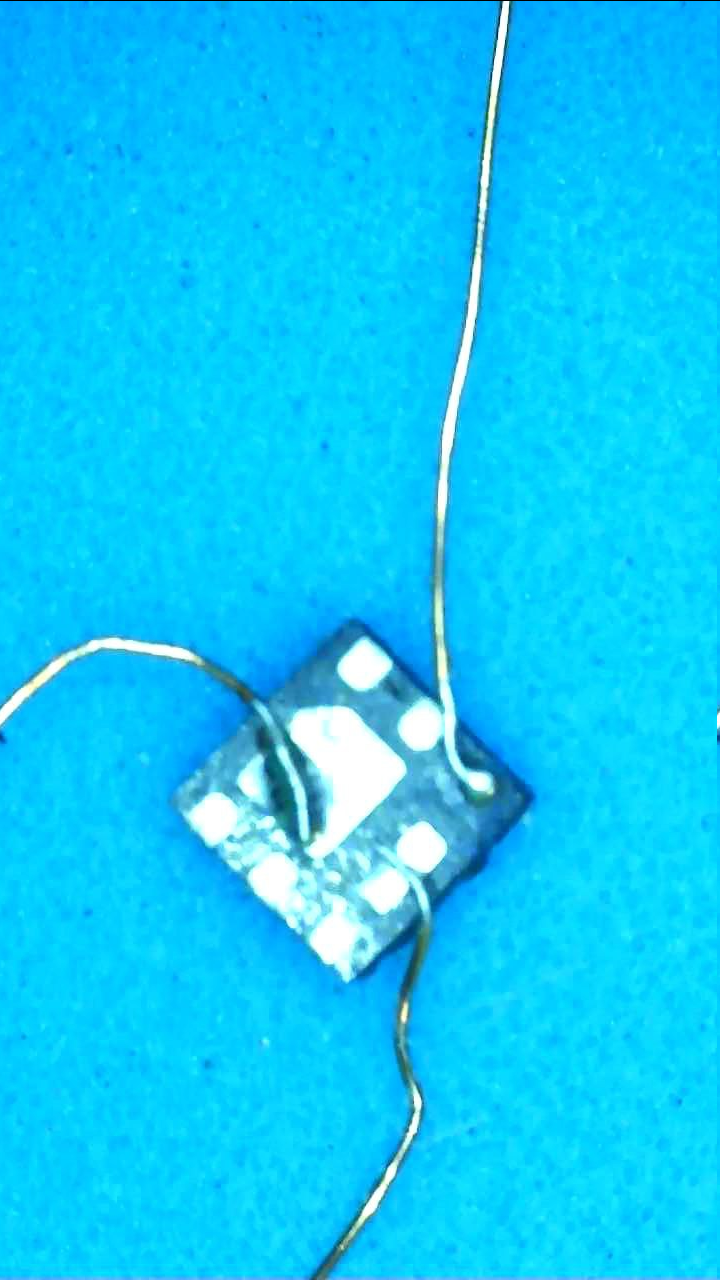

Let's see pics of the whole APU.
A lot of your wires look to have too long of a tinned end, use flush cutters to cut to a better length AFTER tinning the ends. Helps to be sure you're not shorting to something else.
I don't solder to the emmc, so I'm not sure but your 5th pic looks like the most-right-wire looks maybe shorted.
In a later pic you show a MOSFET and it looked like maybe Gate is shorted to Drain.

In regards to the mosfet I think that's due to the angle I took the photo. They're actually not touching, let me post another picture rq.

In regards to the mosfet I think that's due to the angle I took the photo. They're actually not touching, let me post another picture rq.View attachment 372279
You should aim to solder those wires in a straight line so they have better contact and minimize the risk of them getting loose or shorting something.
Also the gate wire is very exposed and may have at some point touched the drain line.
Now considering that Pico injects voltage through this line to open the mosfet if there was a short some of that current may have found it's way to APU or maybe on the opposite, some of the voltage from drain might have gone to gate and kept it open and god knows what happens then.
Anyway, it's just a theory since you are trying to figure out what happened anyway.

Seems to me like two separate =*, so it's probably a bad dat0 connection.
Cut the dat0 cable and measure the diode value (red on dat0 wire, black on ground/shield)

=*= CPU never reach BCT check, should not happen
It happens that I cut the clk track, and I turned it on and it gave the error =*=, now I rebuilt the track and the chip does not give an error, but when it stops glitching, the console does not give an image, maybe it died
This is just an idea since i'm not 100% sure but I think that with clk line gone, there was no syncronisation between APU and Emmc so it might have lead to emmc corruption when trying to write to it.
Even if this is the case, I have no idea on how to proceed but maybe @rehius could give us some input on the inner workings when he is available.
*Edit
In the meantime, i'm dying to see a photo of the work on that damaged point/trace :D

Indeed, I see no other variable that might make sense but I'll definitely make sure to improve my tin lenght or at least insulate before firing the switch up, but all signs point to a short in the mosfet to be the most likely culprit.
I installed a PicoFly on a Lite today and it worked first try so yeah, it could've been it.
