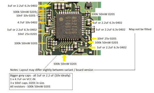

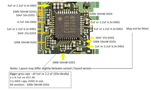

Does anyone know the cap value for the 3.3v point on the V2? The upper connecting terminal on the positive side of the cap melted off and now no solder will stick on to it properly. Checked the multimeter and it still has continuity and the switch still works and everything but want to replace it for my second crack at it. Meanwhile will practise some more. (Also learning that hwfly installs are nothing compared to this.) Any help would be appreciated.

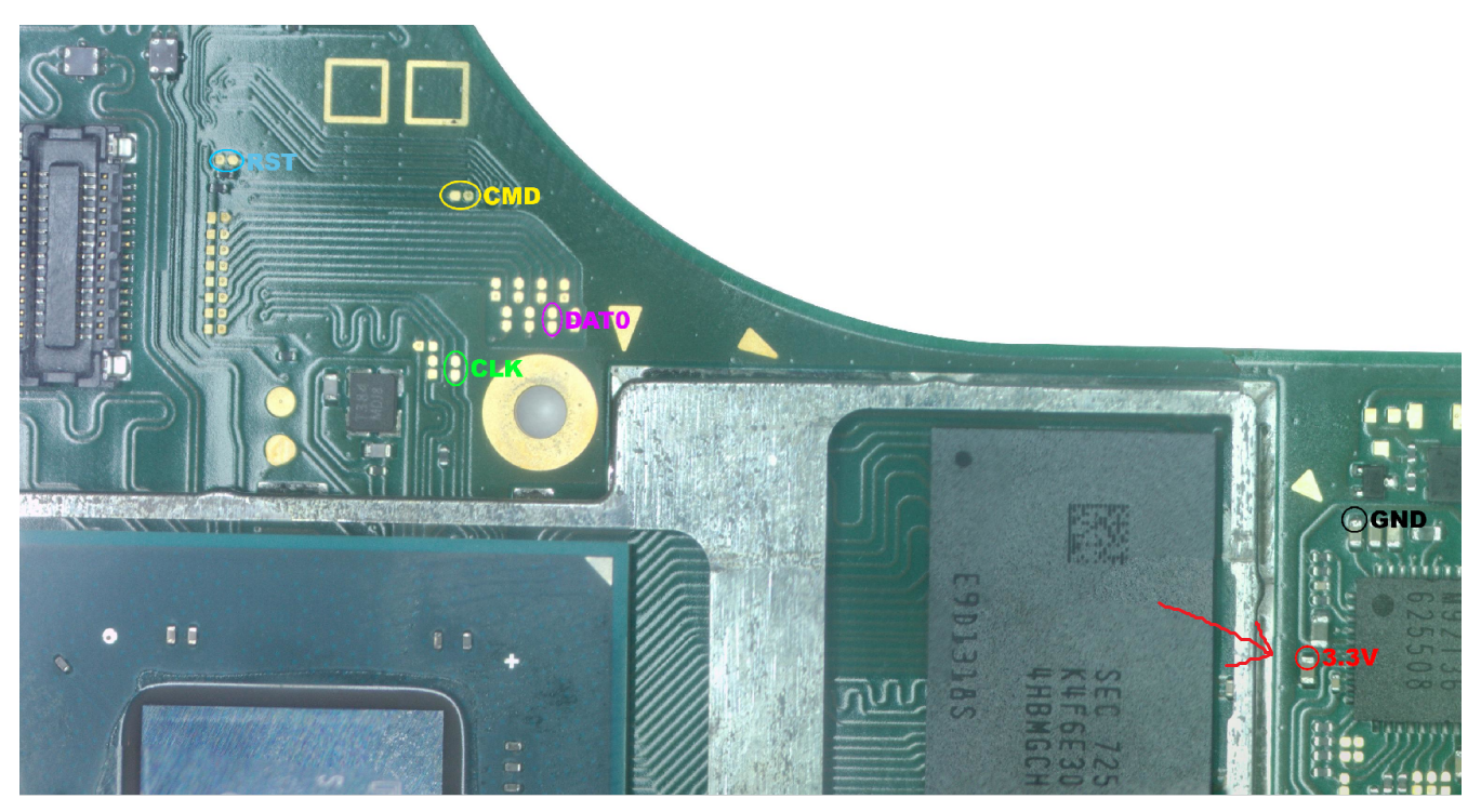

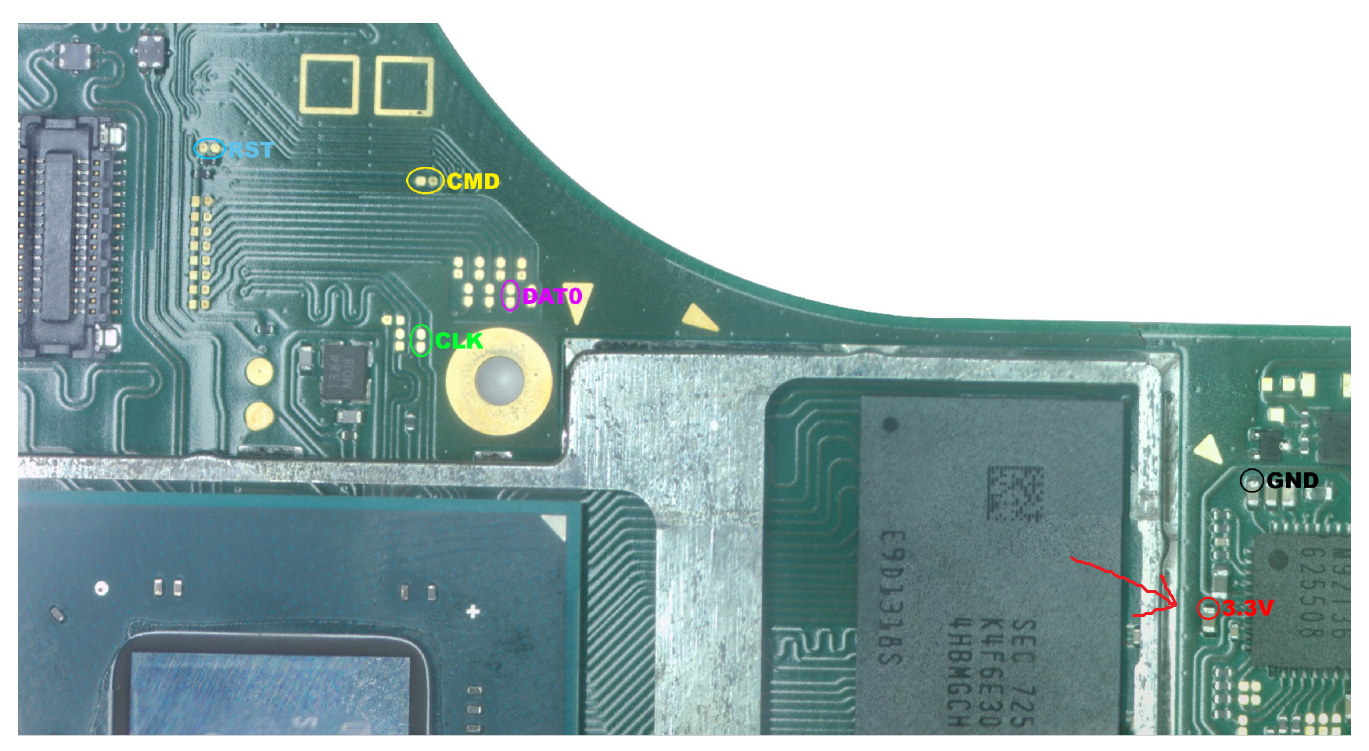

Can someone tell me how I can solder a V2 flex cable for a v1 switch? Where exactly I need to solder it?
Since it worked once I couldn't solve the Led purple problem. I know it's because CMD / V2 flex but couldn't find a solution. Maybe it was luck I don't know.

Green lines are wire that you need to solder to capacitor (illustrated with red and black)
Yellow are not wires, they are just to point out where is each terminal.
You can also cut it like in the second picture and use the upper part of the remaing copper pad to solder to capacitors in APU.
That helps a lot man, thank you so much. Need to try it out tomorrow. What exactly do you describe on the yellow lines? The "S" is still the GND right?
