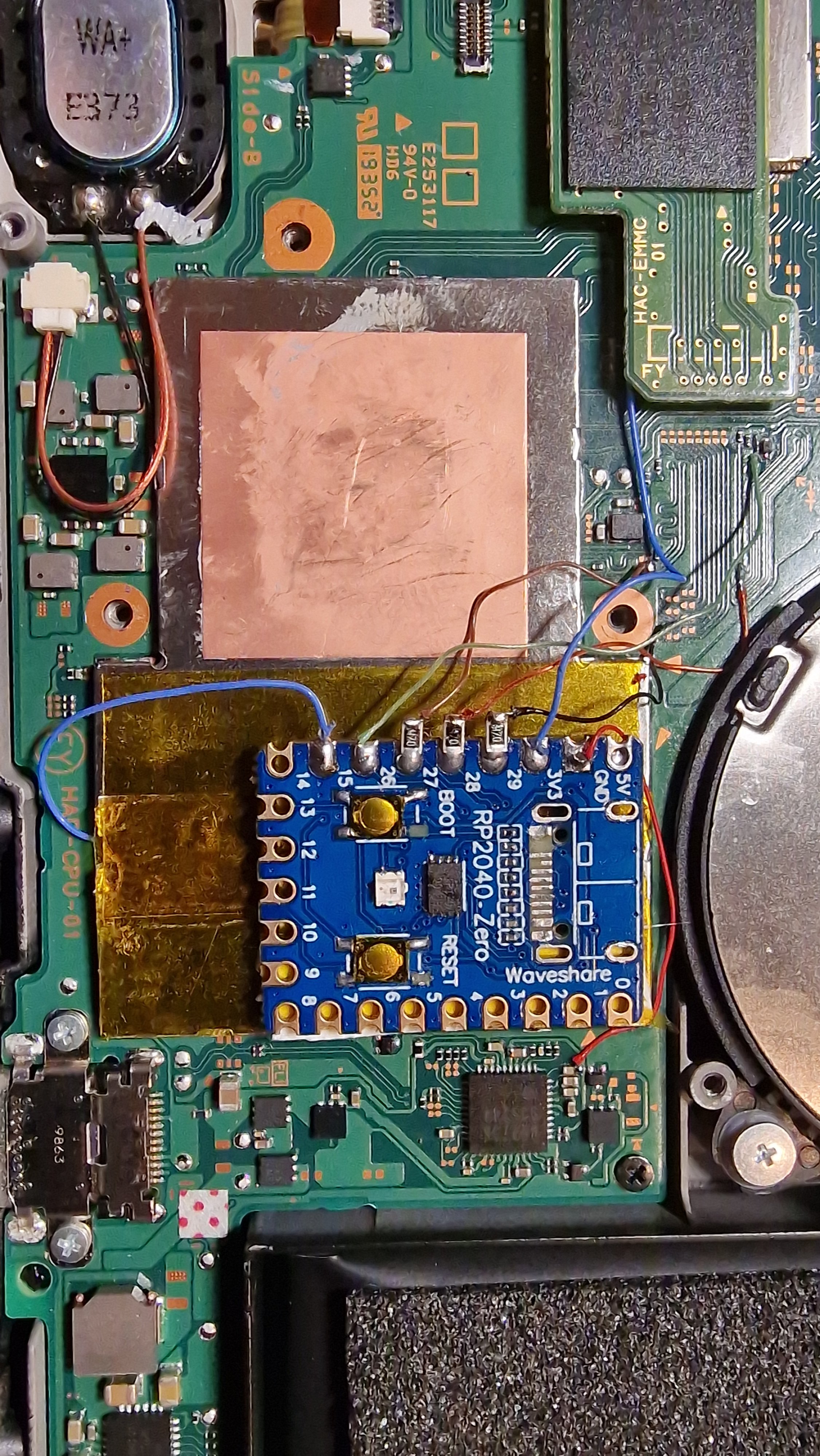

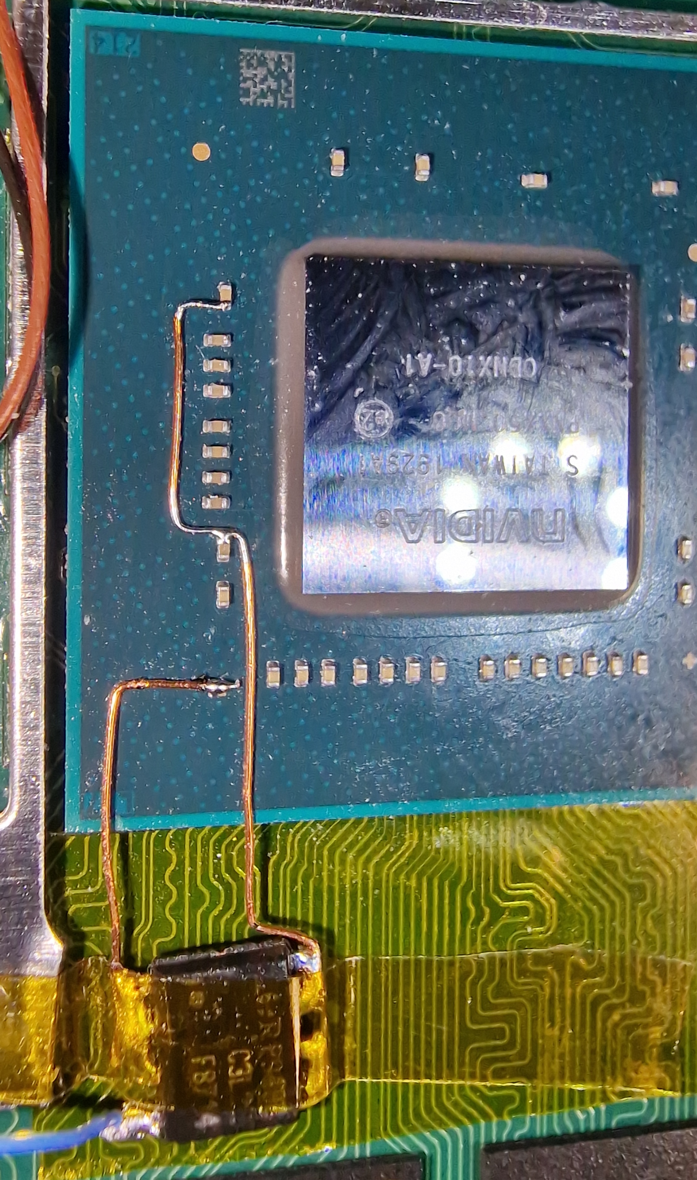

Here is a composite image I just took of a double mosfet install I am doing on a switch lite. The circles are the general points of interest and where they need to be hooked up. I jumpered between the gate pins on the mosfets and ran a single wire to the rp2040 to keep wire clutter down, as has been suggested previously.
are you using UV Resin to hold the mosfets down?
Yes, I use a toothpick and place a small dot of resin (smaller than the mosfet) just above/below where I want to place the mosfet, then gently place the mosfet on the edge of the droplet of resin so that it wicks to the side of the mosfet. Once it has wicked into place, I cure it with a UV laser pointer I have for quick hardening.
Kudos on the work with that Gate wire. Very impressive.

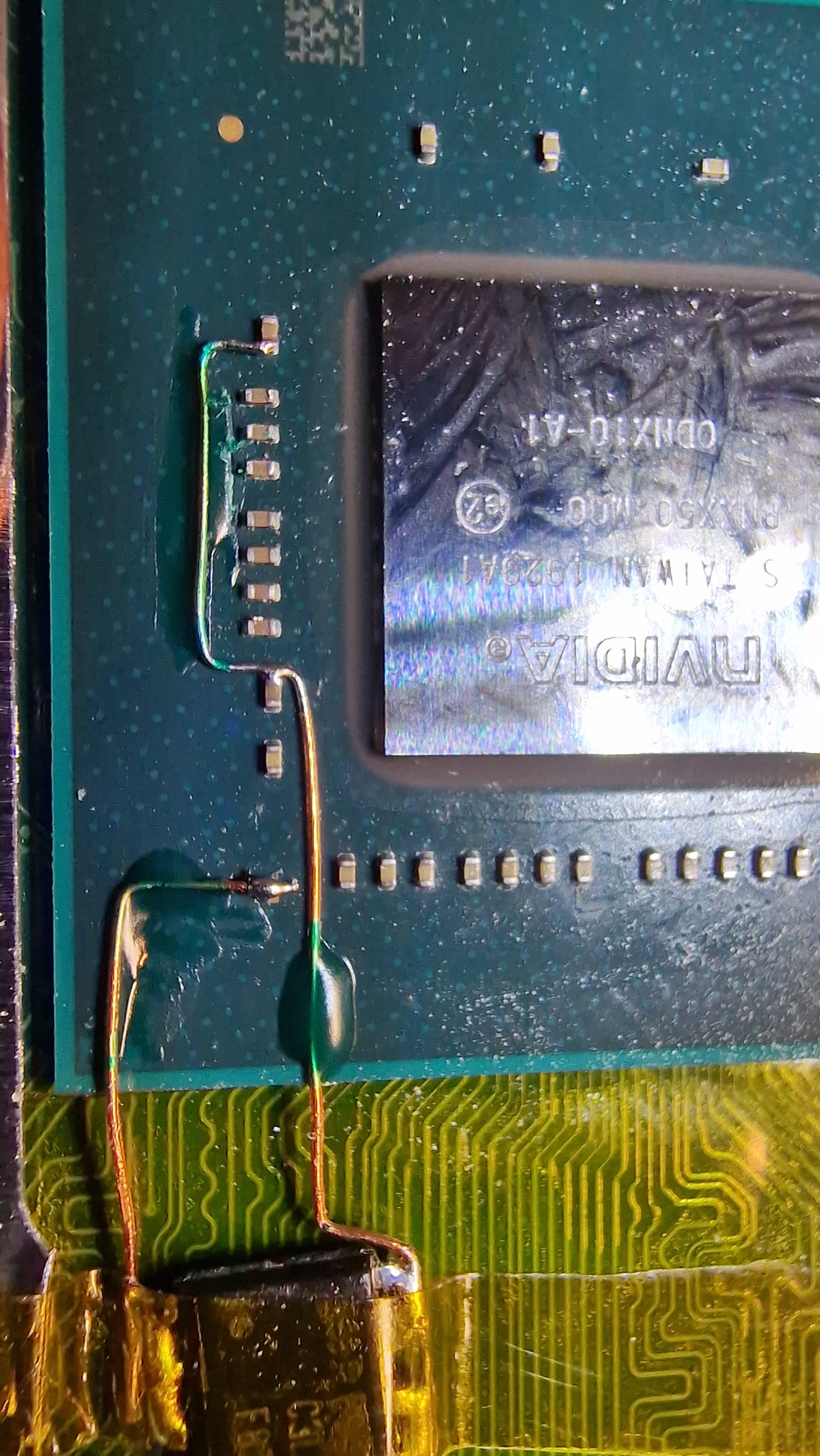

The wait finally came to an end. I installed the first one last night but it did take me longer then I expected (thanks to 3v3 point)

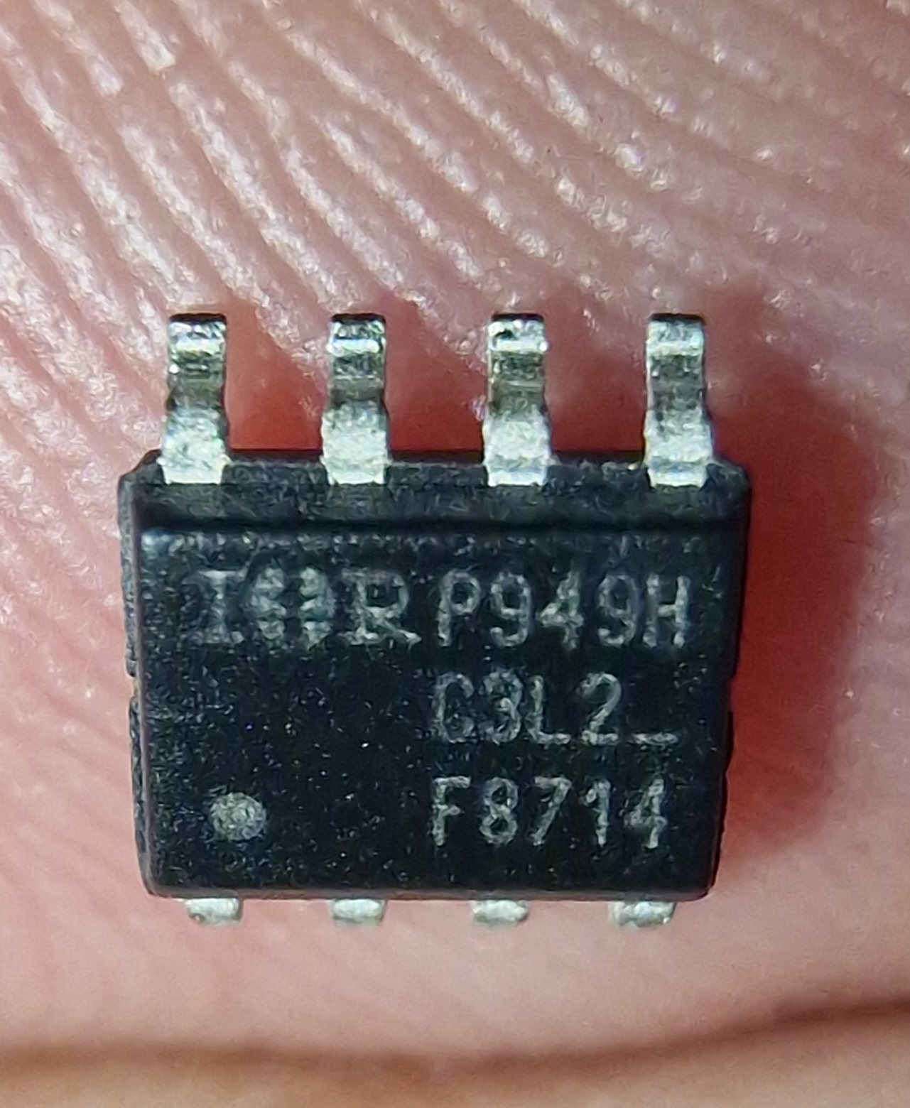

On my search to find some 47R resistors locally, I stumbled upon IRF8714 (SO-8) Mosfet and I thought why not, lets give it a shot (the alternative was to use V1 flex on Mariko since I’m still waiting on the order from Ali with mosfets, resistors, wires and everything)
I only used one IRF8714 (connected to both caps) and everything works ok (Inspired by @dave22 layout, thank you)

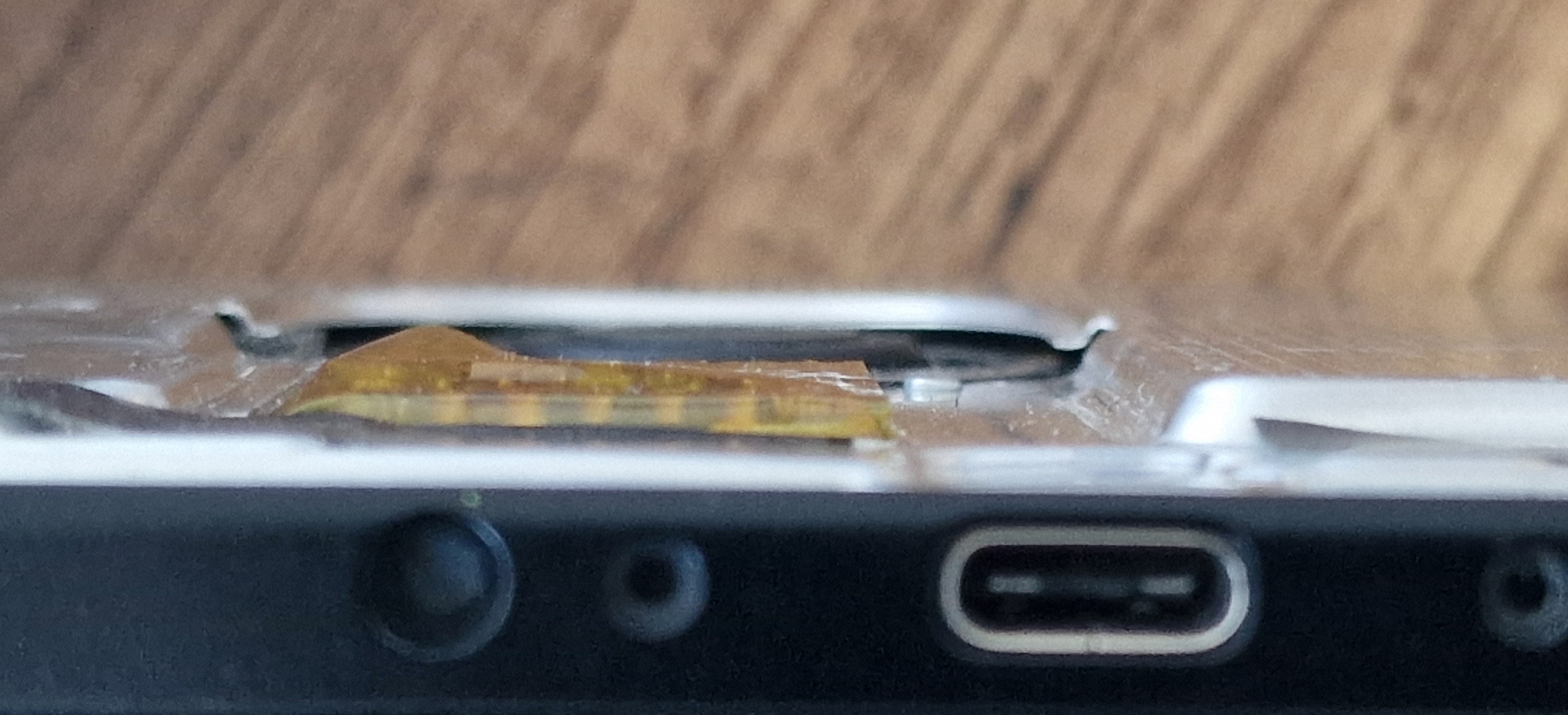

Being an SO-8, the mosfet is a bit large so I cut the shield between the APU and memory just to be sure, but the upside is that it’s really easy to solder (because of the size and terminal layout)
I also cut the outer shield just for the fun of it and I think it looks nice this way.
The only issue that I had was the original 3v3 point on the cap. I guess after couple of tries I lost my cool a ripped the upper pad of cap (as it can be seen in the photo), and then I went for the alternative point in emmc which I soldered in 5sec.
Used 2.65 firmware and there was no problem whatsoever, everything works as intended.
I would like to thank @rehius for the amazing work and all the time he put in this project, and also @lightninjay for compiling the information on the pdf, @Adran_Marit for AIO and all the tips.
I think the real win here was finding this community of amazing people who share a passion of doing incredible things and their willingness to help others and bring them along in this journey.
