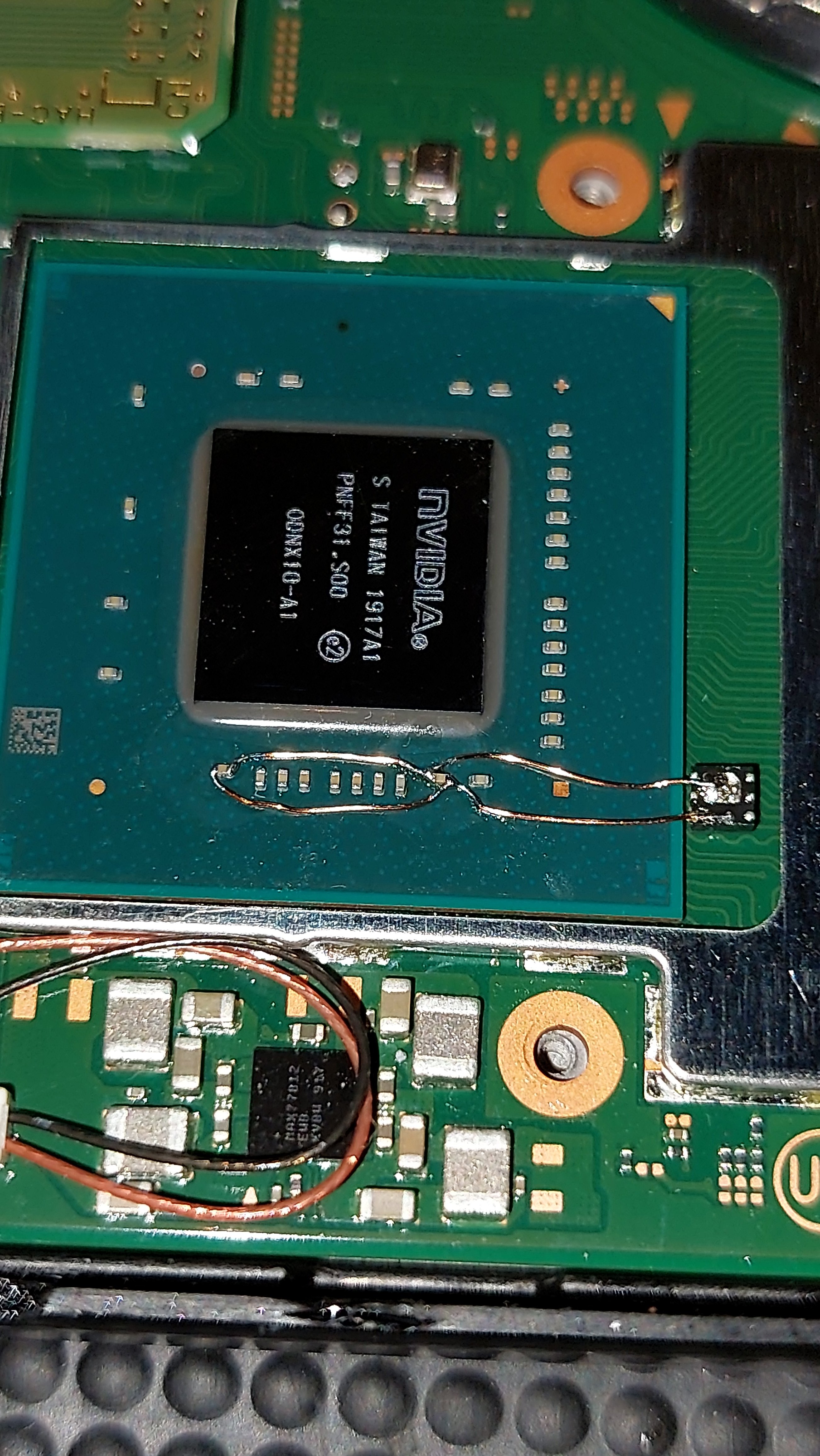

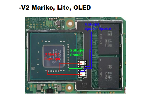

It's start, tnx. But few minutes overheated and fell off mosfet with smoke. How fix it? Need new mosfet?
show your cpu cap soldering, you might have killed the cap and shorted it. remove the overheating cap and focus on the other cap.

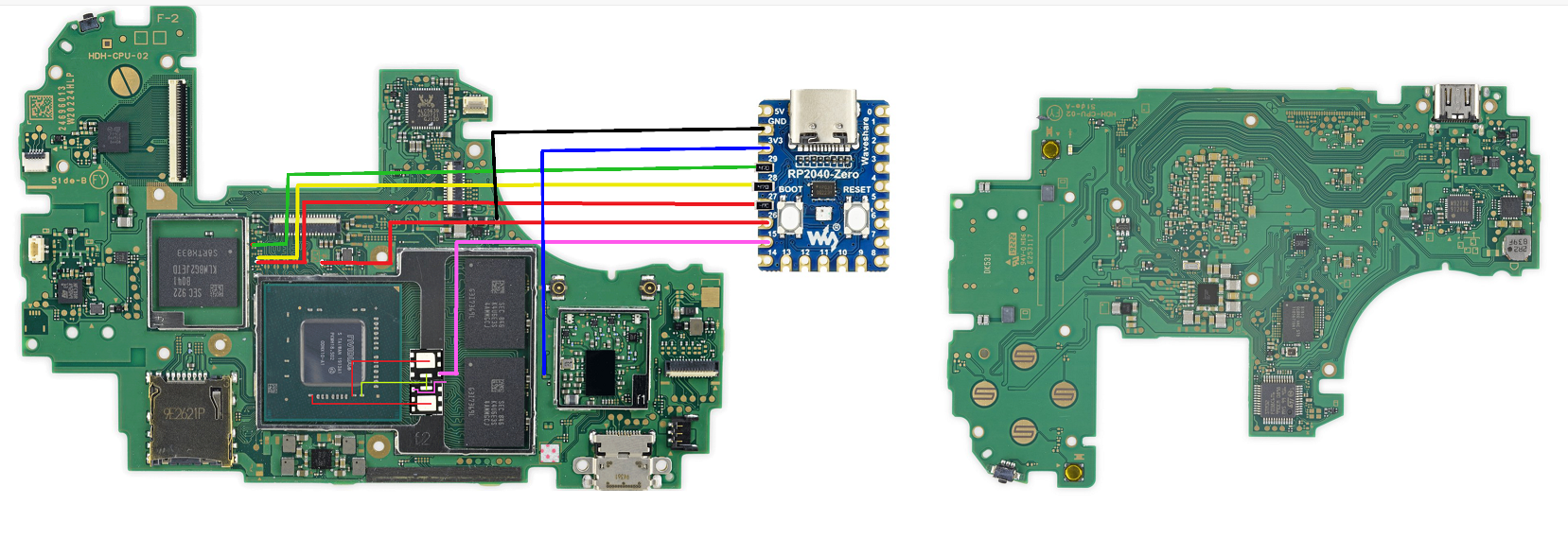

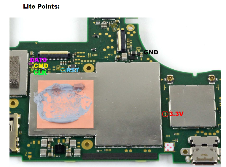

Hey nothing against your guide it's very well, but I think most others including me would rather a complete picture, showing the full board and the wires
They are not really complete images - would be better the way mine are so people can see the exact location and where to go from and to
Example - This is half an image
This doesn't really explain
images are pretty self explanatory, if you cant understand them then you should have someone else do it for you
Nice. What AWG/MM Did you use?
I haven't measured it exactly. I took some enameled wire off of a coil from a relay
I also had to cut metal shielding of my Switch V2, then it closed all right. When soldering a mosfet to the caps i haven't used a microscope - I don't have one, everything was done by sight (I have at least 10 years with soldering experience) but still, it was difficult

Looks like around 0.4 or 0.5ish.
😅 I use wire from a phone speaker for low current connects. Looks to be about 0.1mm.

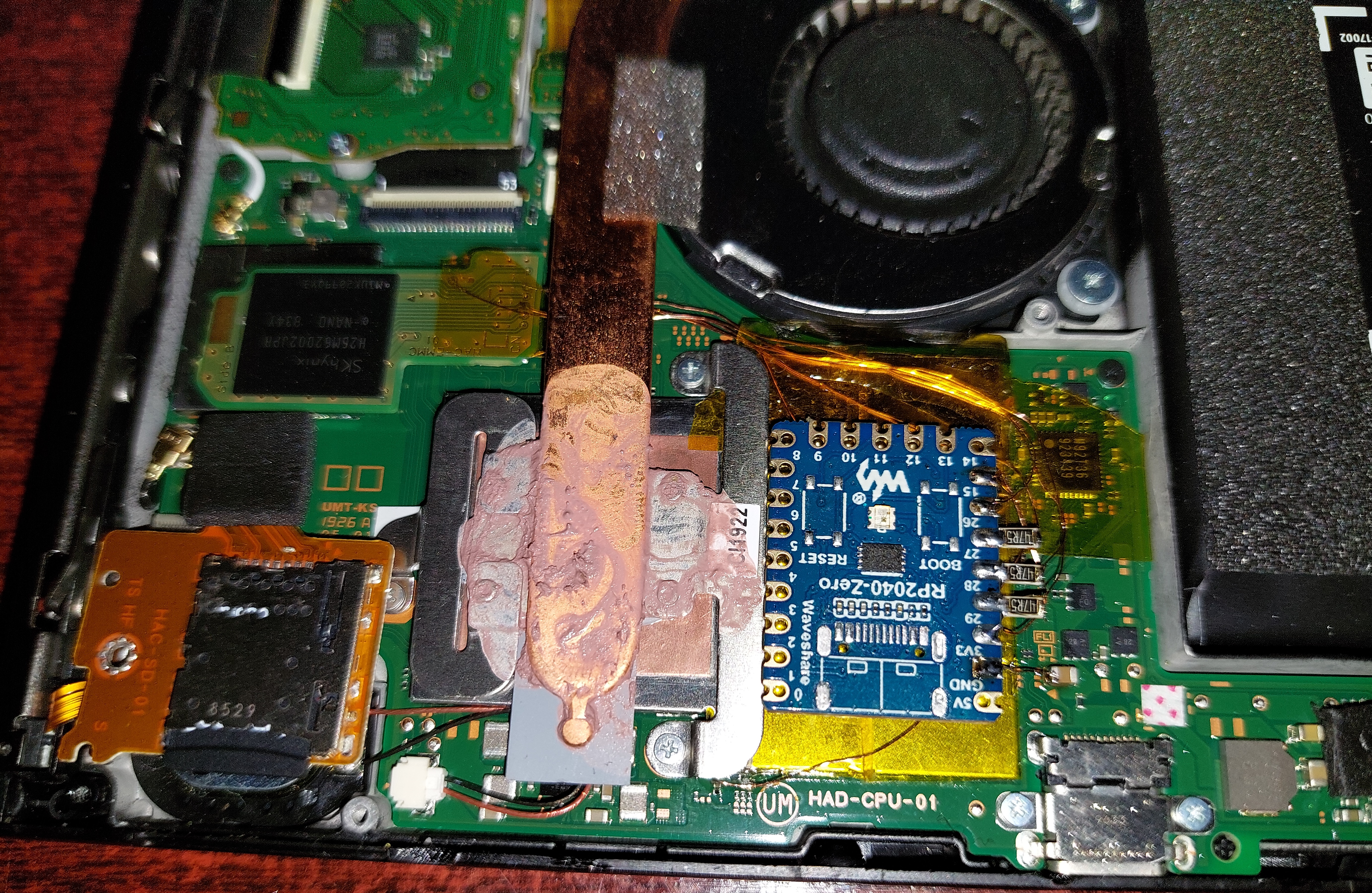

Switch Lite, FW2.67. Cyan color.
OFW starts to load, I press reset and I get a green color with the correct loading of Picofly.
Will rolling back the firmware to 2.64 with a double reset help me?
To roll back, I just need to rename the firmware uf2 file to update.bin?
