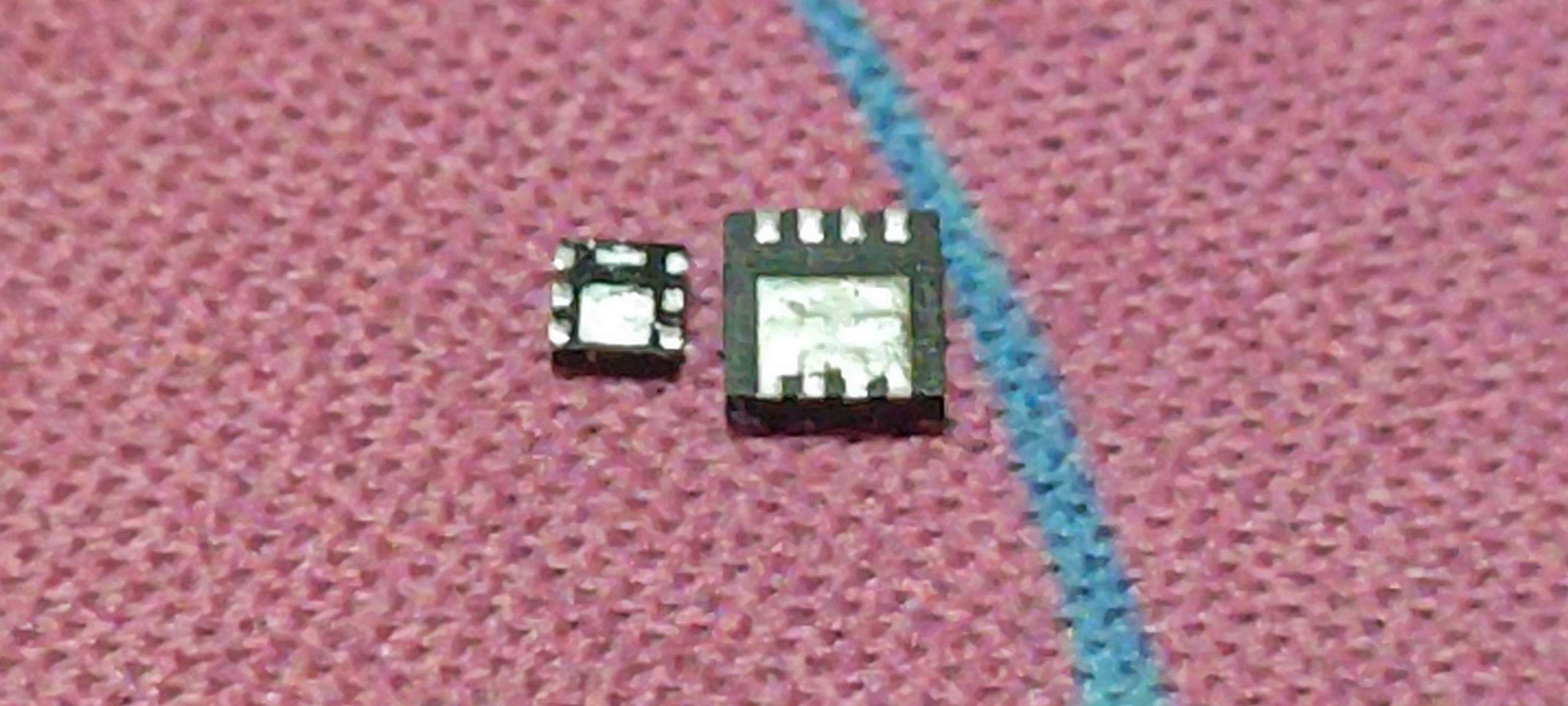

I have a question about mosfet
No type is sold in my country no equivalent
I have a lot motherboard
For example i have this work or no

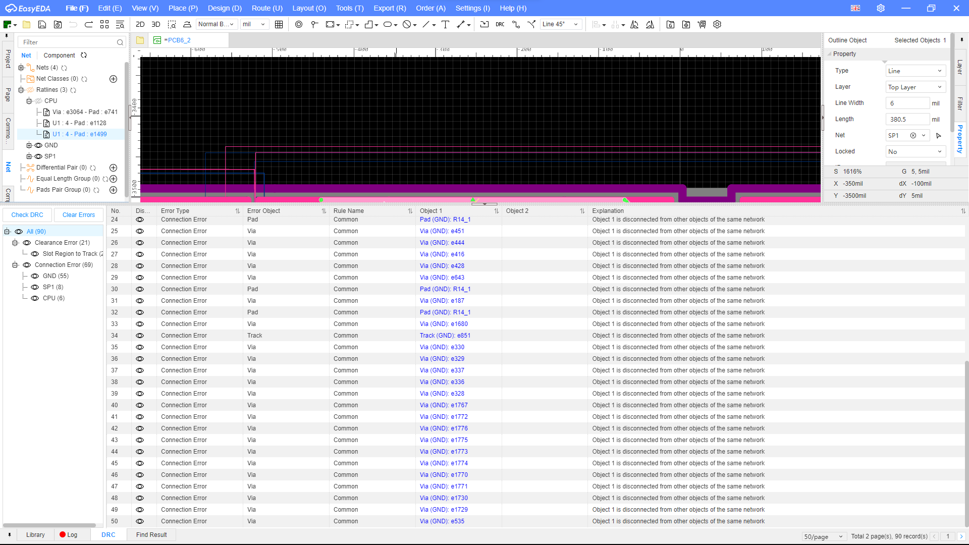

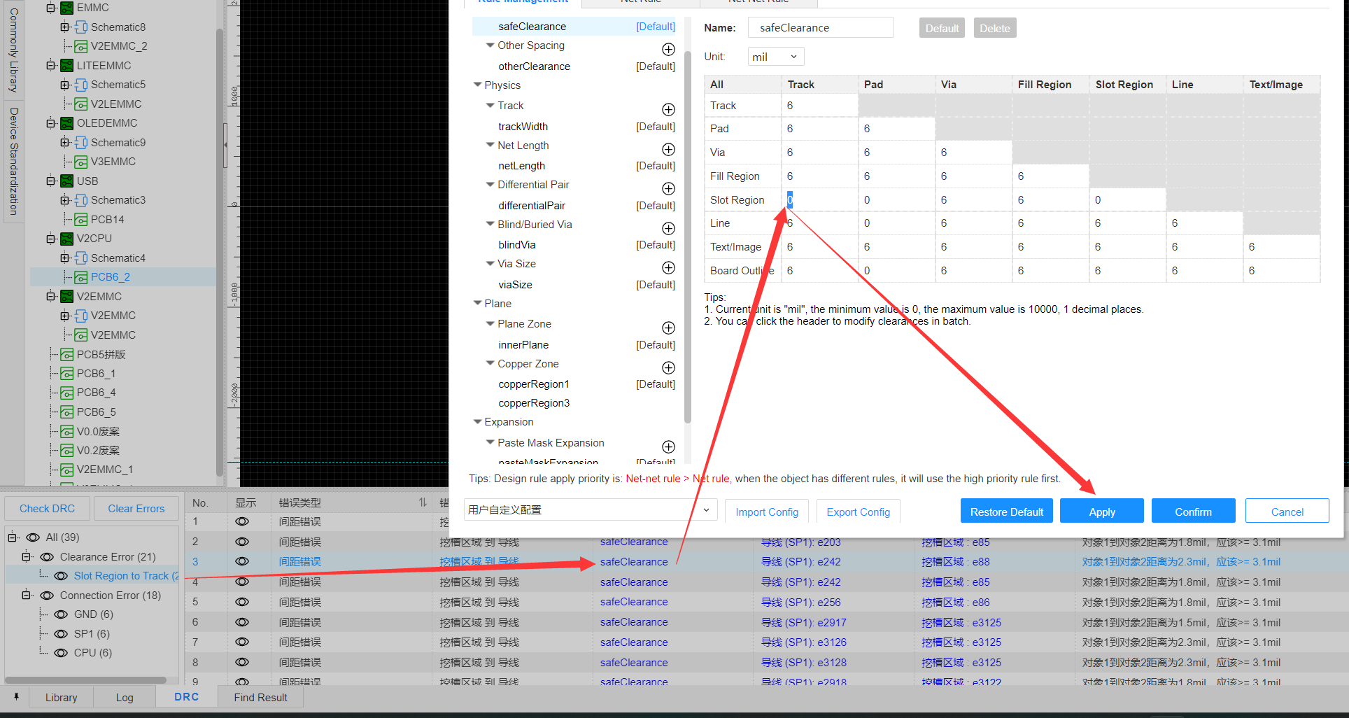

Your flex cable design has errors when exporting gebber file?
Have put it into jlspcb will see what they come back with after the review. Seems like it's a short across pads and then tracks
This is because I forgot to set the DRC rule, change the rule to 0 and that's it

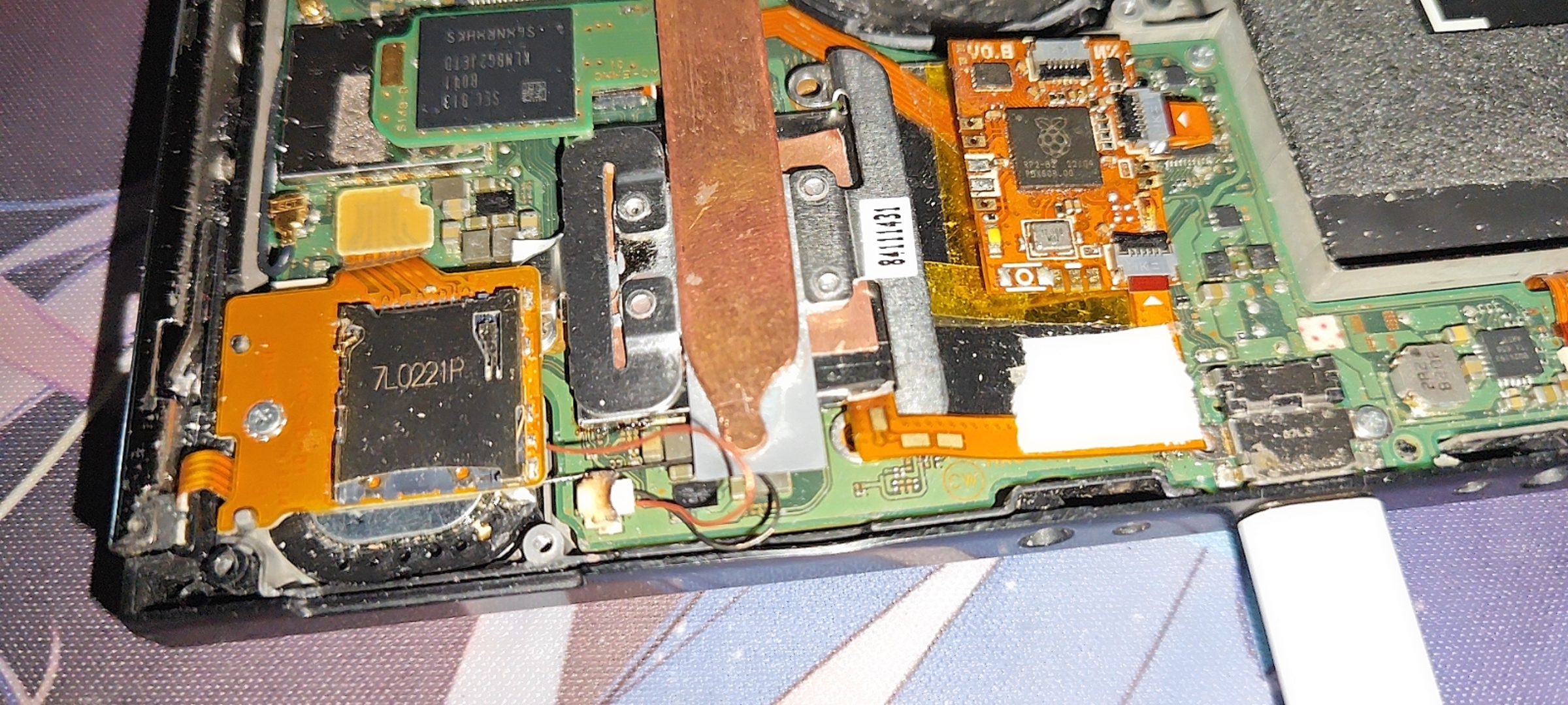

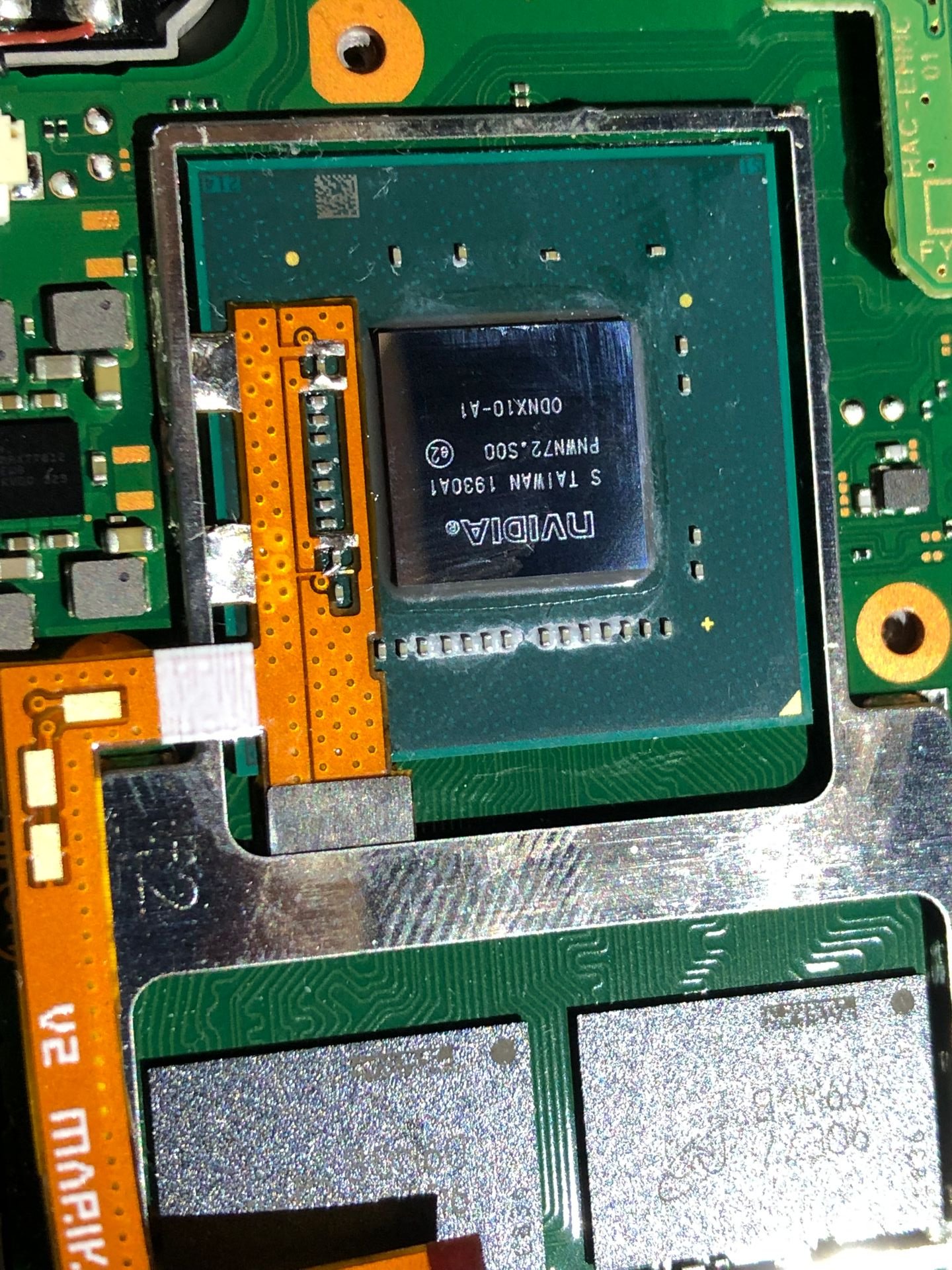

2nd successful attempt at two MOSFETs. Fixed my flashes green but boots OFW issue. I don't think it was the MOSFETs failing, it was the source ground connection, it didn't have a good connection with the pad on the SoC. I cannot get solder to stick to that pad so I just grounded it on the shielding and it works well now.
