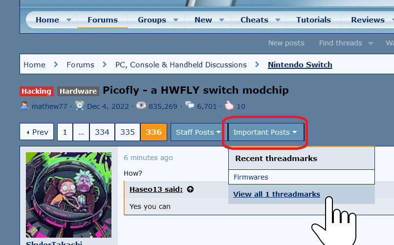

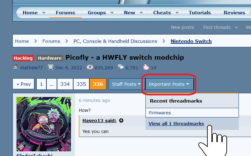

https://gbatemp.net/threads/picofly-a-hwfly-switch-modchip.622701/threadmarks

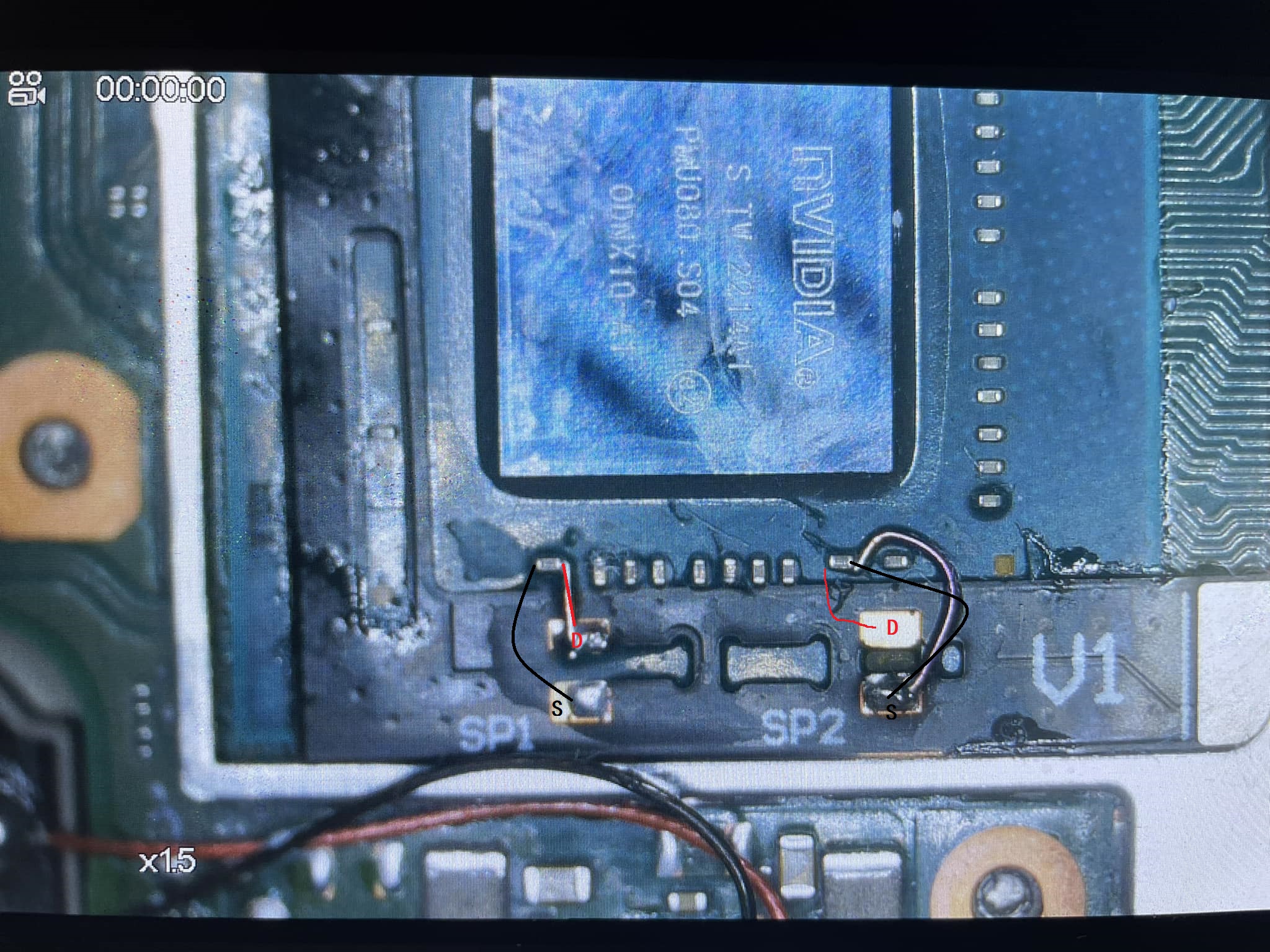

Sorry guys but can someone please help me flashing my rp2040 for switch oled?
I flashed 2.61 Firmware but switch keeps booting in ofw. When I turn on the switch the RP2040 has solid blue light then flashes green and it boots in ofw
