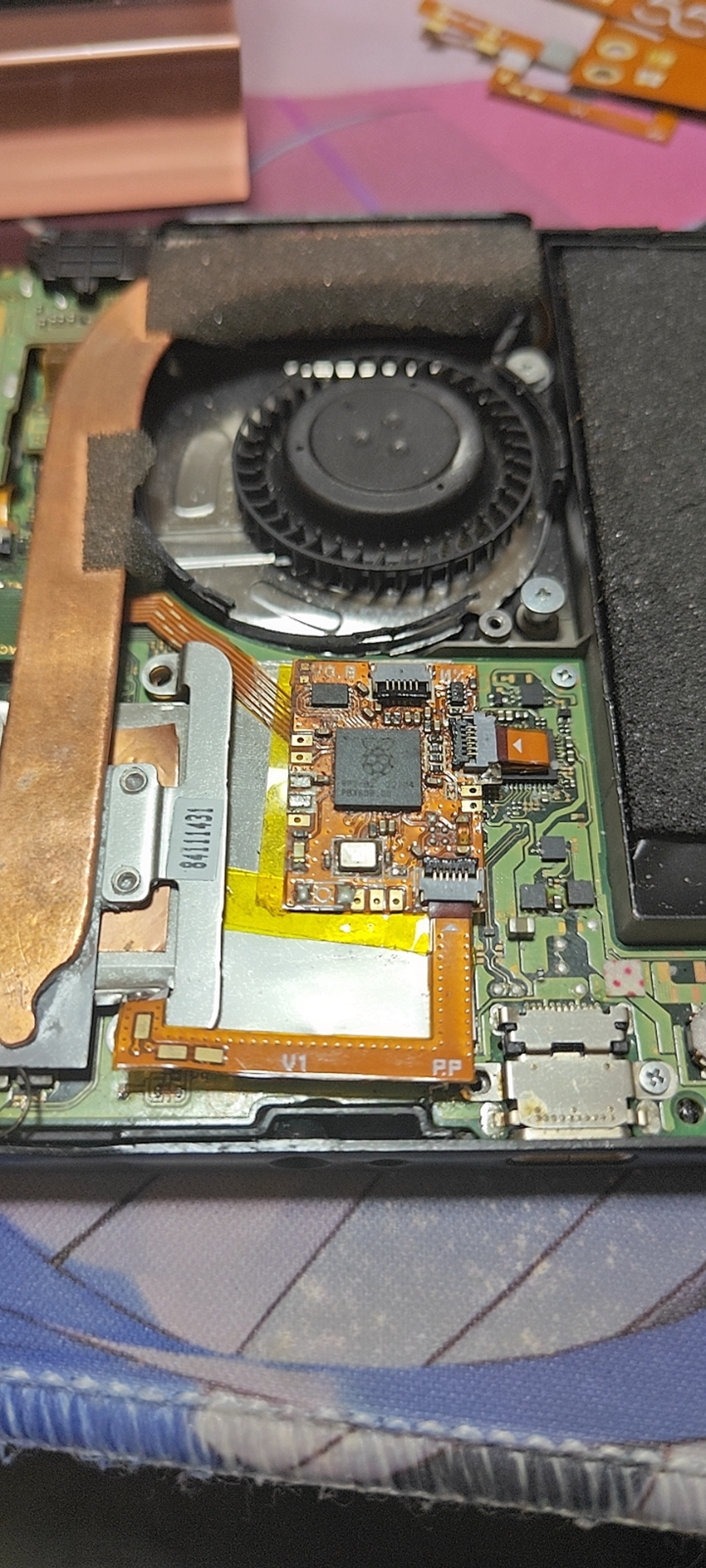

About at my limit of patience, I get the blue light then a yellowish orange light which should be Dat0 but everything seems to check out. Unsolder everything and it boots fine still.

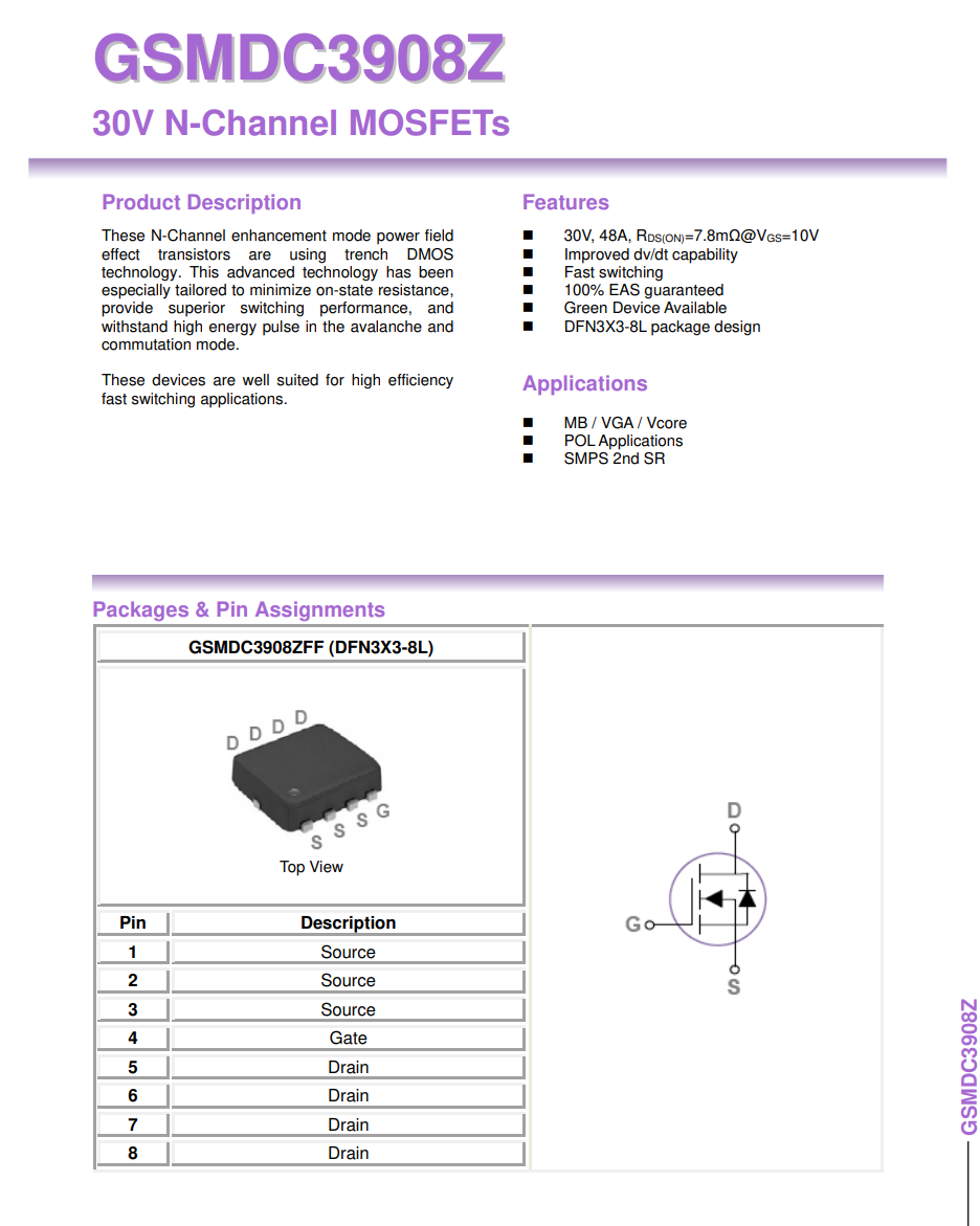

Great work. Can I ask, are you using P mosfets on these?
Is there any reason/benefit in doing so?
Thanks

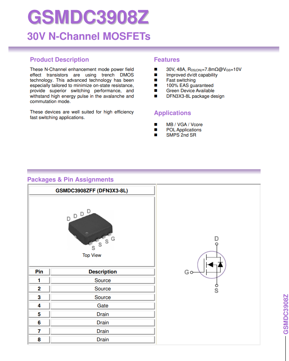

no no no, the mosfet is n mosfet,model is GSMDC3908Z
No problem.
To be honest I don't know. It seems that sometimes (for reasons unknown to me) one mosfet does not work.
I've only done 2 switches (both V2) with pico, and both of them worked with one mosfet (1st one with irf8714 the other one with irfsh8342).
Use good wire, keep the length of the wire to minimum and solder good joints and I'm 99% sure it will work with one.
There is not enough current, and the MOSFET needs to handle a large current,

Yes, but its more difficult to solder 2smd series, rather than just use one smd.

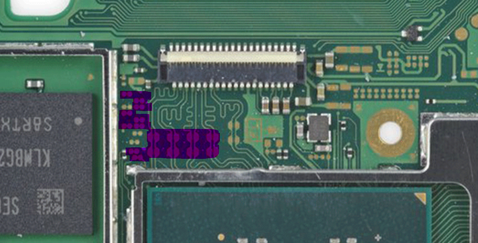

for example
i want to resolder the point, i need clean old lead.
is it safe to use solder wick
im afraid it will broke the pad point
Just mix it new solder and flux :)
cuz i wanted to close other point with uv mask
so i can solder easily the important point
i bought uv lamp
ill close those point
*for example
im planning to clean older solder lead(excess solder*i google it lol)
any tips to grab/ remove the older lead ?
the only thing i know is solder wick.
but im afraid killing those point
tried a different pi yet?

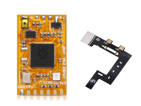

I found this chip on aliexpress, do I also need to buy resistor with it or is it already soldered with the board ?
