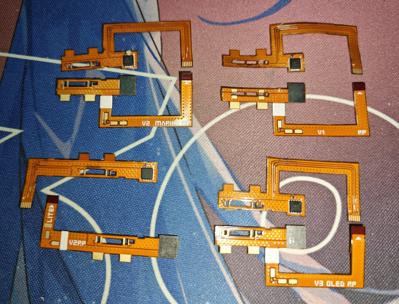

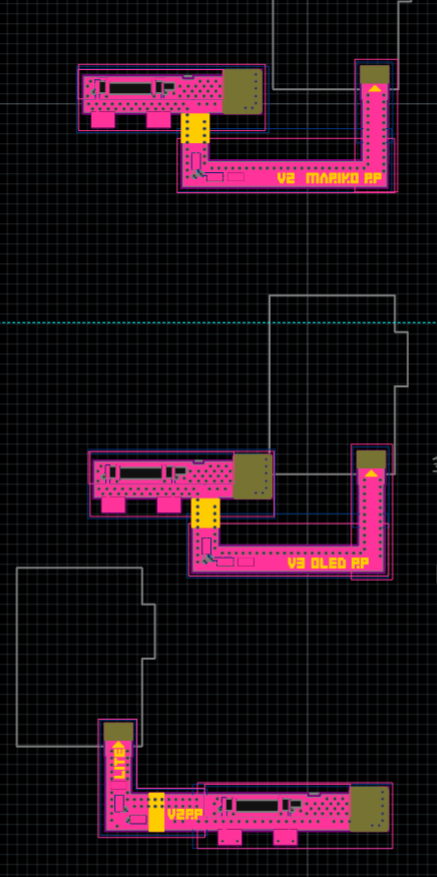

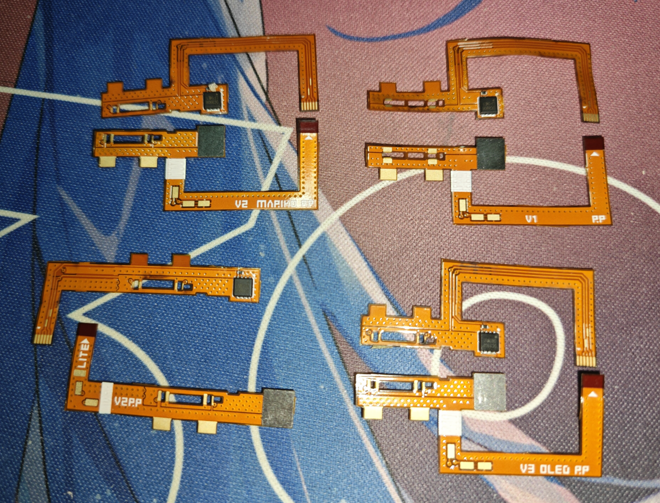

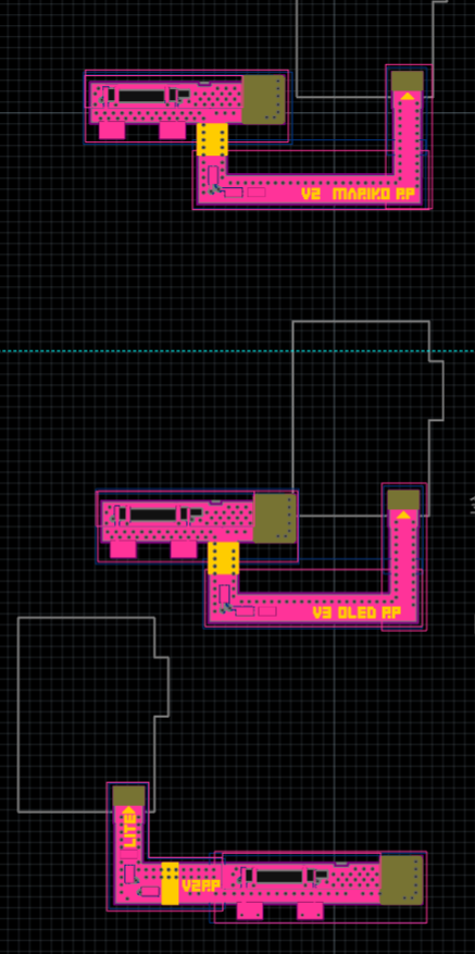

I now see the flaw(s) in my original questioning. Are these needed to run the glitch?
