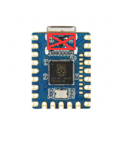

First, whats going on here (picture 1) ?
Second, add some tape (continuos from one side to another so the edge does not touch the shield ) picture 2
