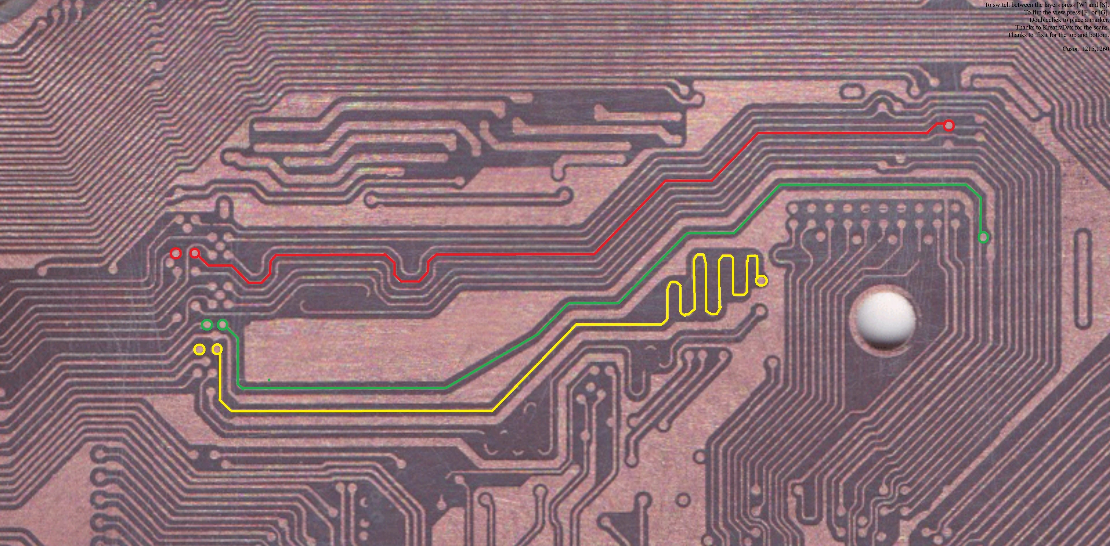

Put the ball into the ripped pad whole with little flux and slowly melt onto that remaining copper dot/trace. Do both pads then jumper them together

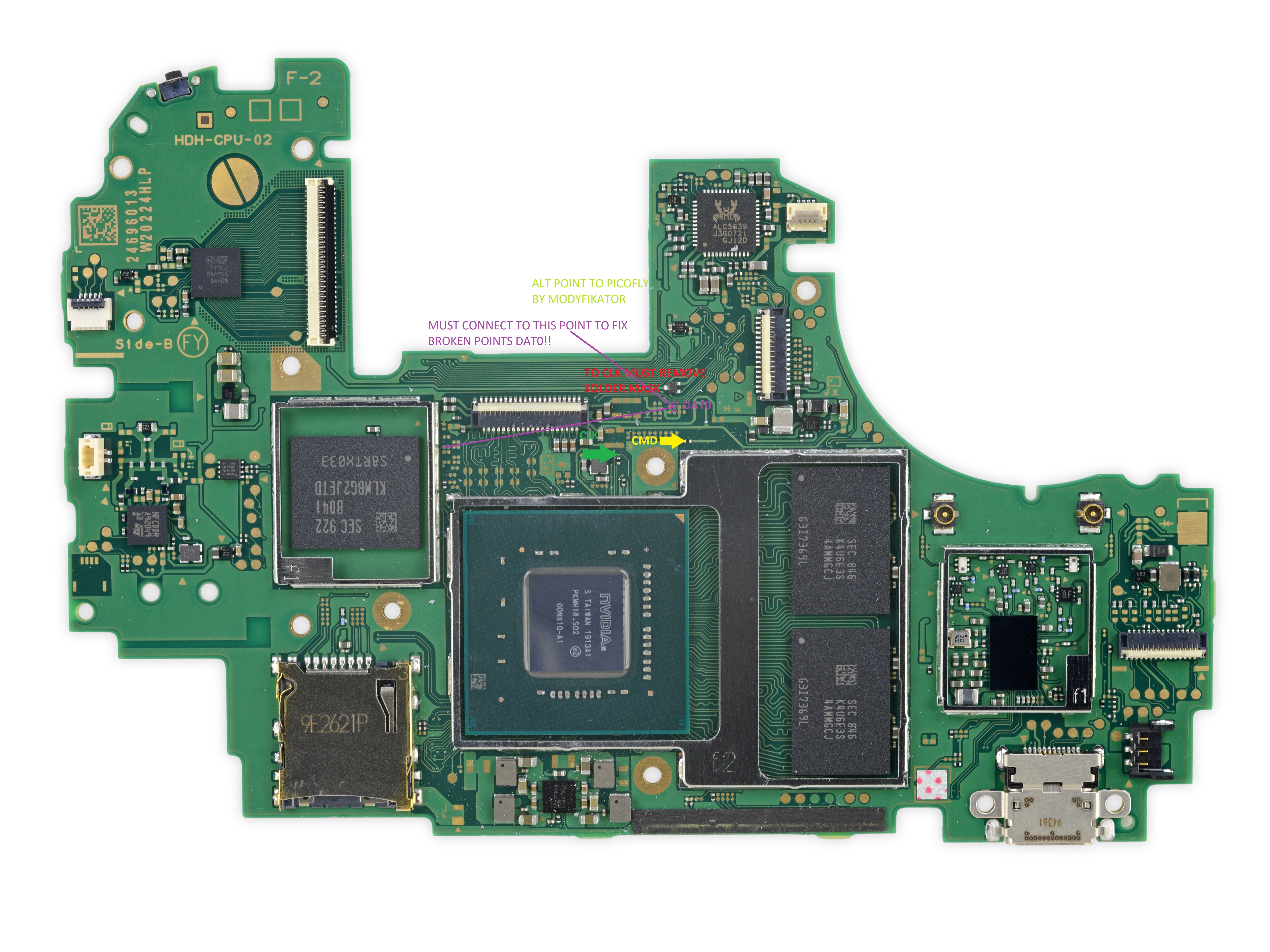

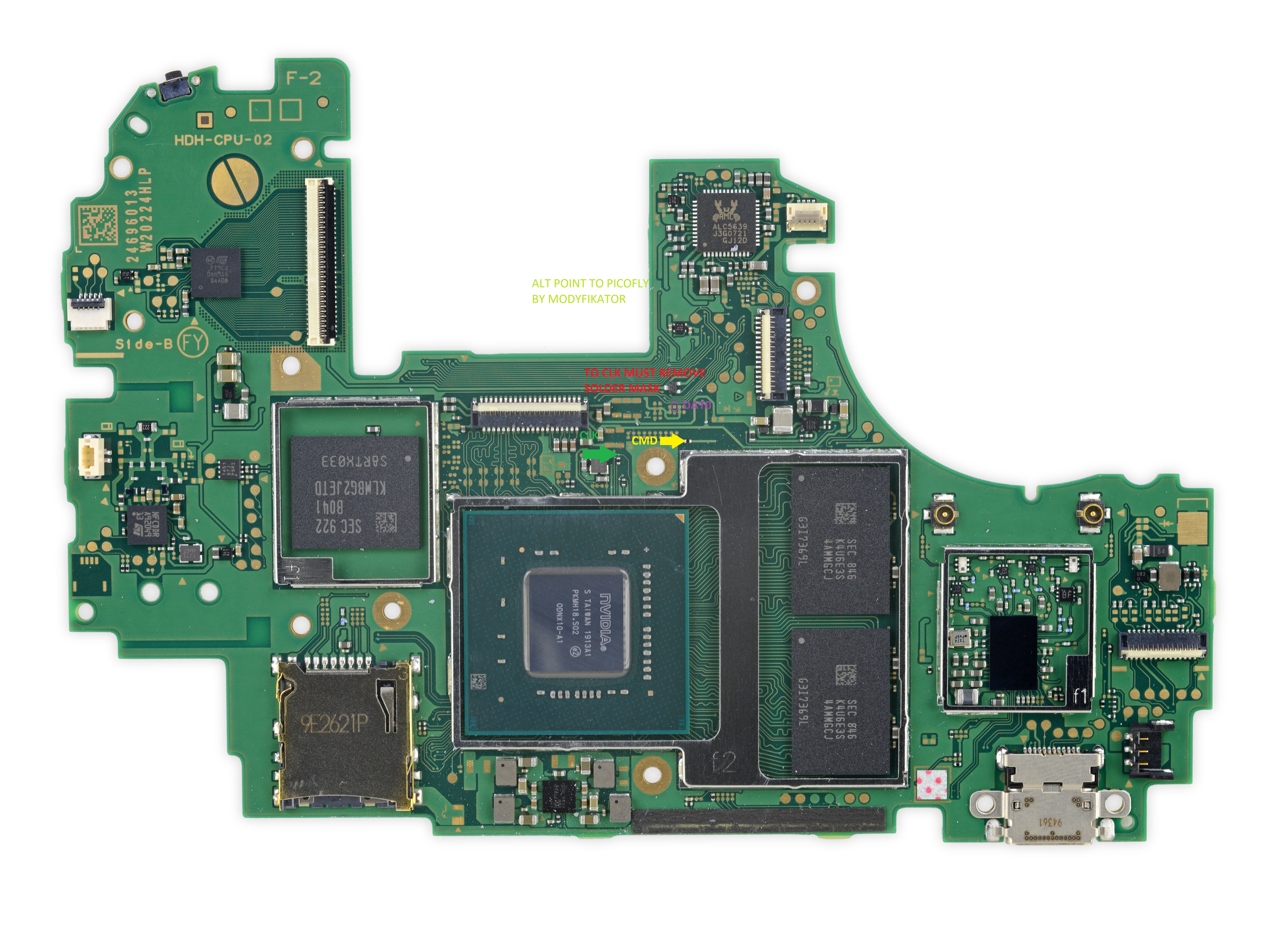

Alternate PICOFLY Points DAT0 , CMD . CLK by Modyfikator​
Hello....i installed picofly and got no sd but the cables. When i was positioning the wires a solder point broken...and now my switch is dead...simple dont shiw any sign of life...is there any tip you can give me ...or if i have some way to fix it
Try connect this point to fix DAT0

FIX WITH DAT0 ADAPTER
