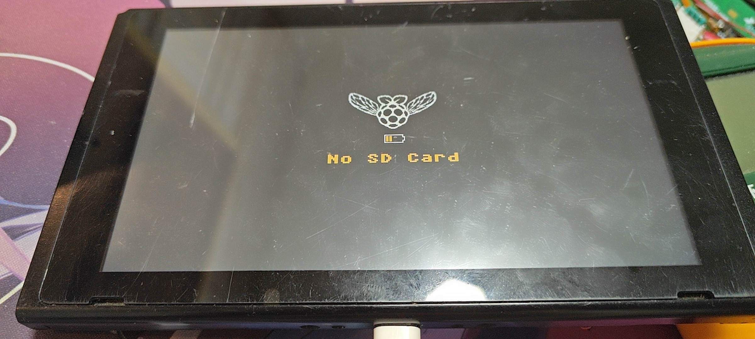

The screen finally lights up :D
Finally it worked! I just soldered different solder points following this tutorial and this was my solution for my v1 switch
I also kinda user the flex V2 and worked too.

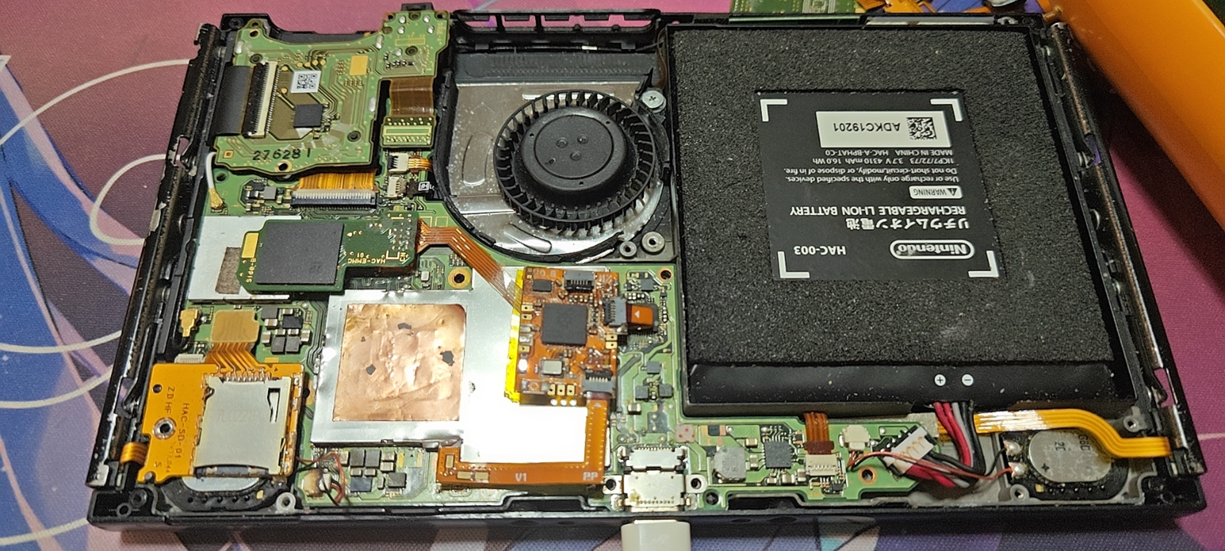

Strictly cosmetically speaking, Out of 10, how much would you give this install? I welcome any ideas to make it prettier.
0.1mm to CLK, CMD. All other are 0.2mm.
Your heatsink is going to cause issues with the wires\resistors
Thanks! Good point. How would you position the rp2040? I'm not very concerned with flex cable because I'll use MOSFETs from now onwards, and will get the wire out from the same mini lock I use to get the C-point wire out.
Funny you should ask, I'm actually still experimenting with how I want to finalize my PFly installs. See my 'cut' posts/question ;)
Generic answer: Align the RP2040, on top of the shielding, as far to the right and top/up as you can without exceeding the shield (so as to not cover M9 (right) and not interfere with removal/installation of the motherboard (top/up)).
Bonus tip: Before you remove the heatsink, gently draw a line across the shield so you know exactly where the heatsink sits later on. (@lightninjay Definitive Guide worthy?)
