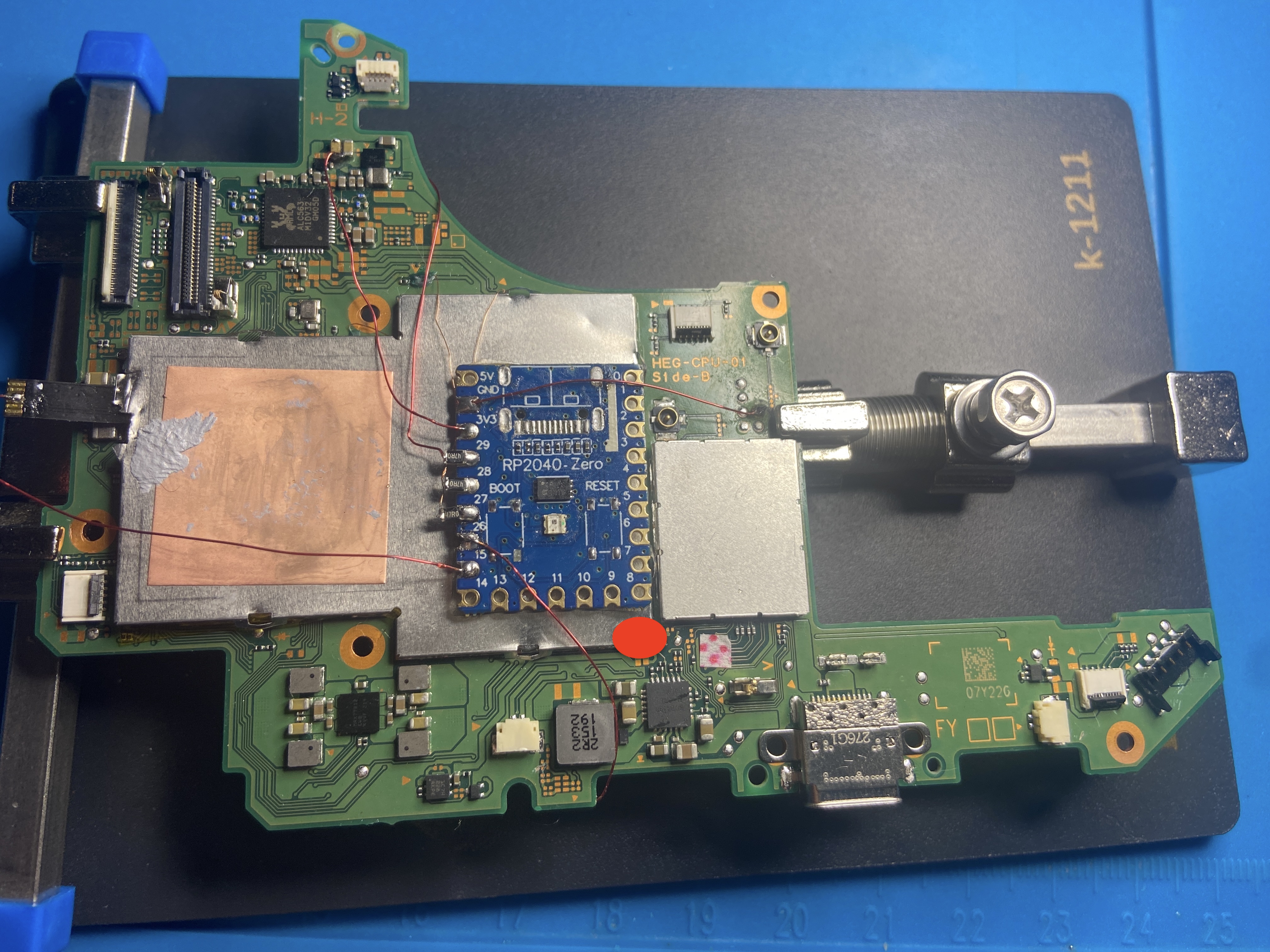

Funny you should ask, I'm actually still experimenting with how I want to finalize my PFly installs. See my 'cut' posts/question ;)
Generic answer: Align the RP2040, on top of the shielding, as far to the right and top/up as you can without exceeding the shield (so as to not cover M9 (right) and not interfere with removal/installation of the motherboard (top/up)).
Bonus tip: Before you remove the heatsink, gently draw a line across the shield so you know exactly where the heatsink sits later on. (@lightninjay Definitive Guide worthy?)
Wow. You really stripped down the bad boy. Personally, I'd like to try and remove thegame cartridge and place the rp2040 there. I think it'd be a great fit in place a no-longer-needed piece.
Just so we're in the same orientation. Is the red dot where you are advising I should place it?
That should be fine, I do mean upper-right though. Now be sure the wires\resistors are routed in a way that allows the heatsink to be installed\reinstalled.
