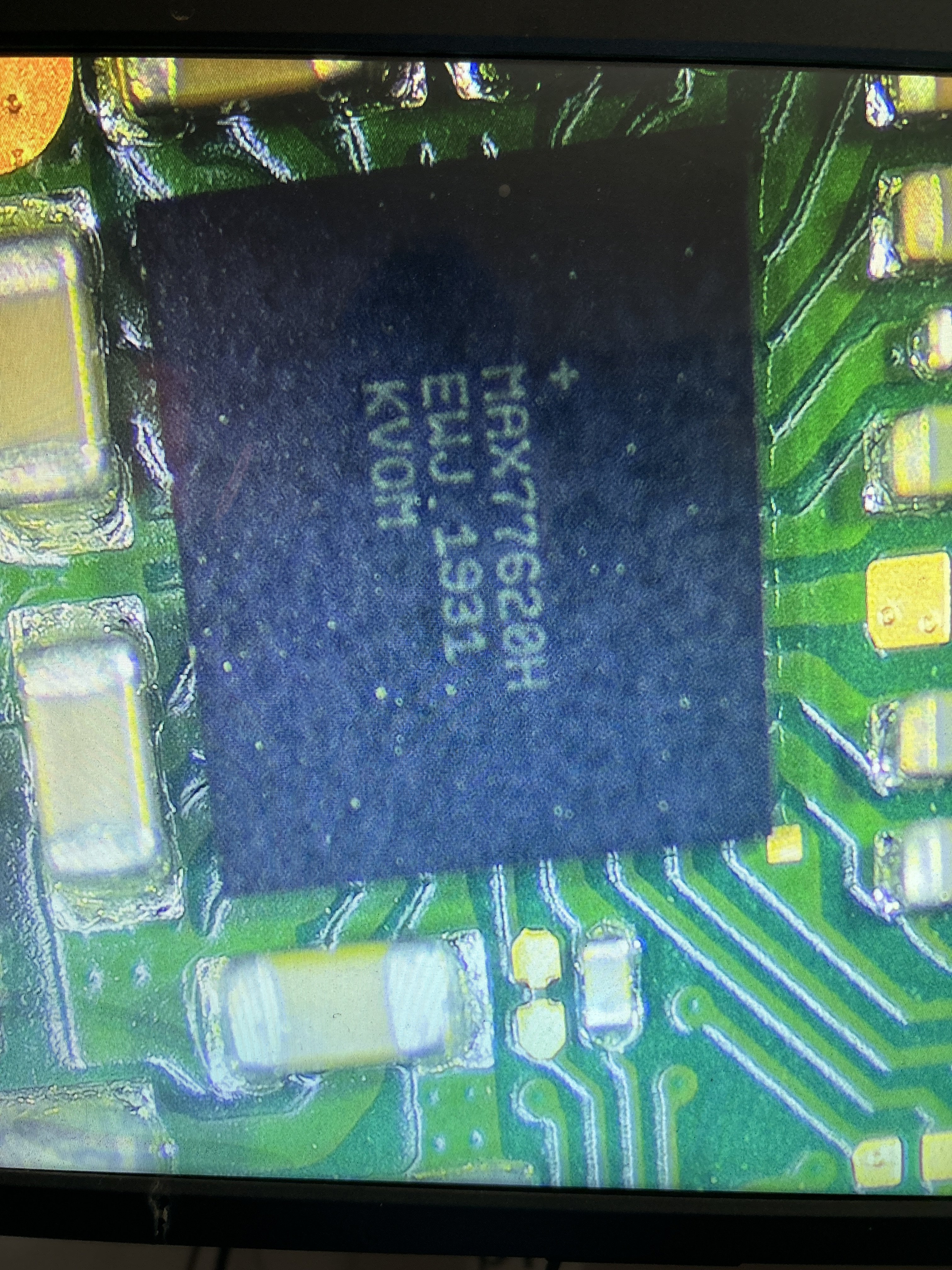

I got a weird issued,
1 nintendo switch v2 mariko with 1 mosfet installed after use it for 1 night, next day when it boot it says failed to init micro sd, check 3v3 rail and found a short ic at enxx ic.
Next is nintendo switch lite with 1 mosfet
When I first boot it says failed to init microsd
Same as mariko one. And I found short at enxx ic too.

The last one shows "failed to init micro sd" every time with a 1tb card. And sometimes with a 512GB Card. I don't know why. Where exactly did you find the short?
I found shorted at MAX77620H
I don’t know if firmware 2.67 did this or not.
But before this I use 2.55 and no device give me any problem.

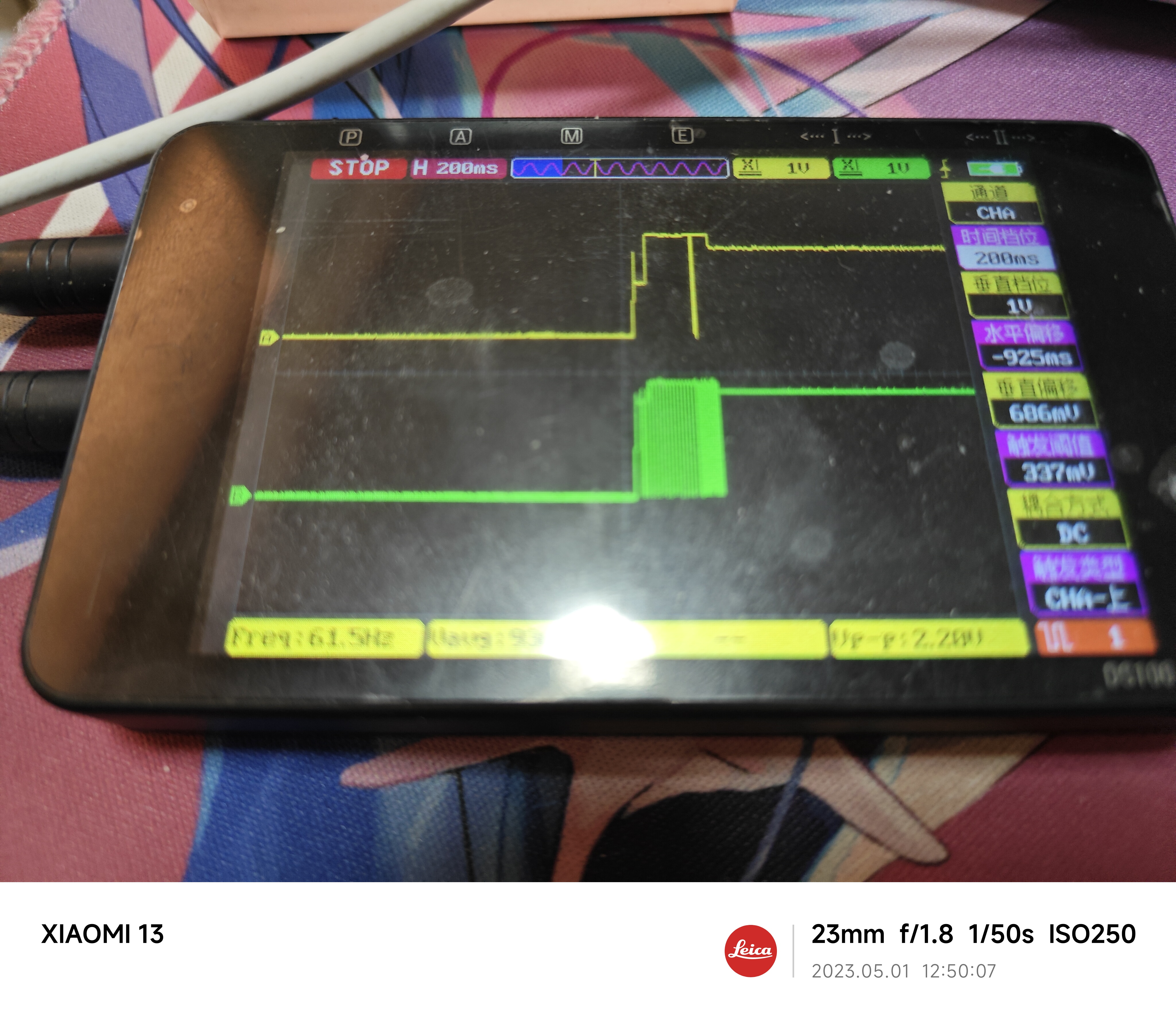

used fw_2.61,The led light turns yellow, what should I do on D0
The oscilloscope waveform is shown in the figure, yellow is D0, green is CMD

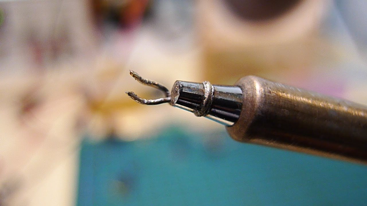

Hello. I'm in the process of perfecting my Picofy installation craft. One thing I want to master and find very challenging is fixing the purple screen and replacing the point A 0102 resistor. Removing it with an iron is easy enough, resoldering it is where I'm having issues.
I'd solder one pad, but when I do the other it flies away. I've seen people on YT use the two iron methods, but I don't like it.
What are your recommendations, fine people? I tried my heat gun but it blows components away.
You can invest in some tweezers or you can get creative with DIY :)
