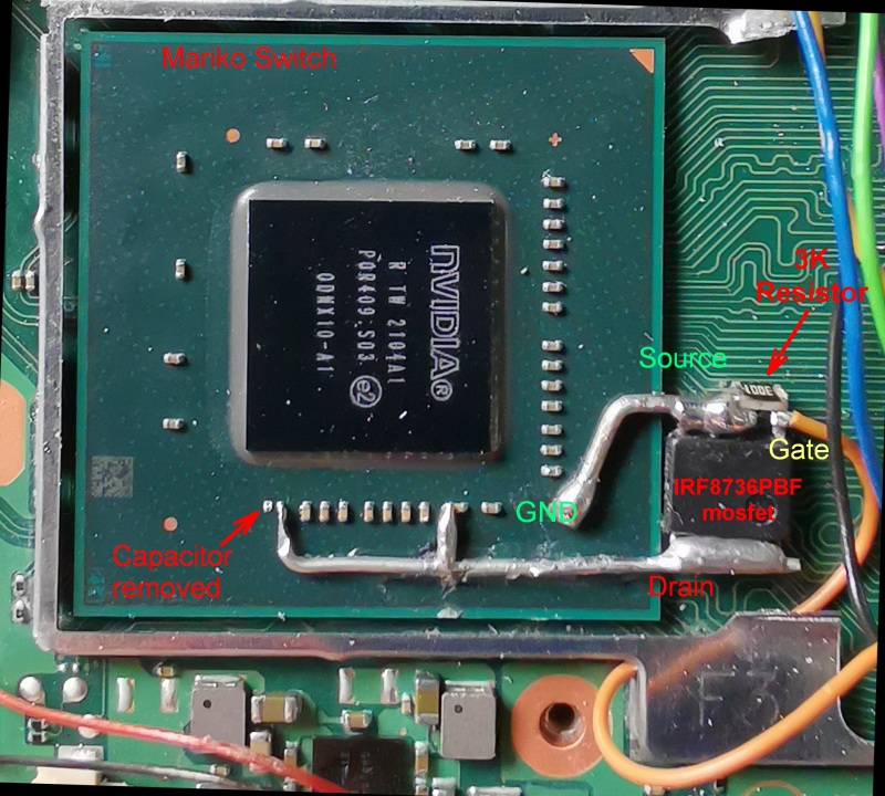

Success, my Mariko has married Picofly :)

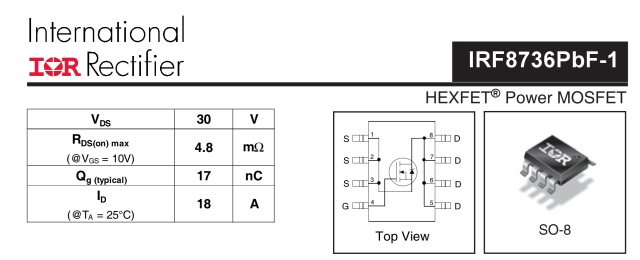

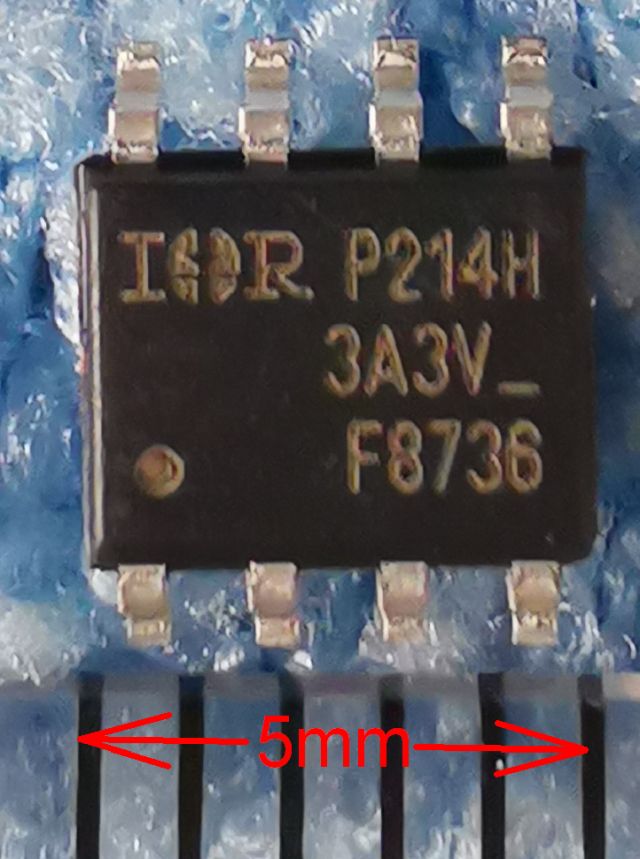

I have chosen a different mosfet: IRF8736PBF because it has legs so soldering is much easier.
it looks like this:
and in my Mariko switch it looks like this:

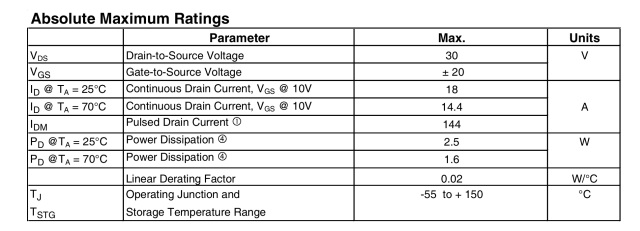

Datasheet:
Green LED is coming on the "rp2040 one" in 1 second.
THANK YOU ALL (I've read the whole thread) it is a very hard mod but it is much fun.
