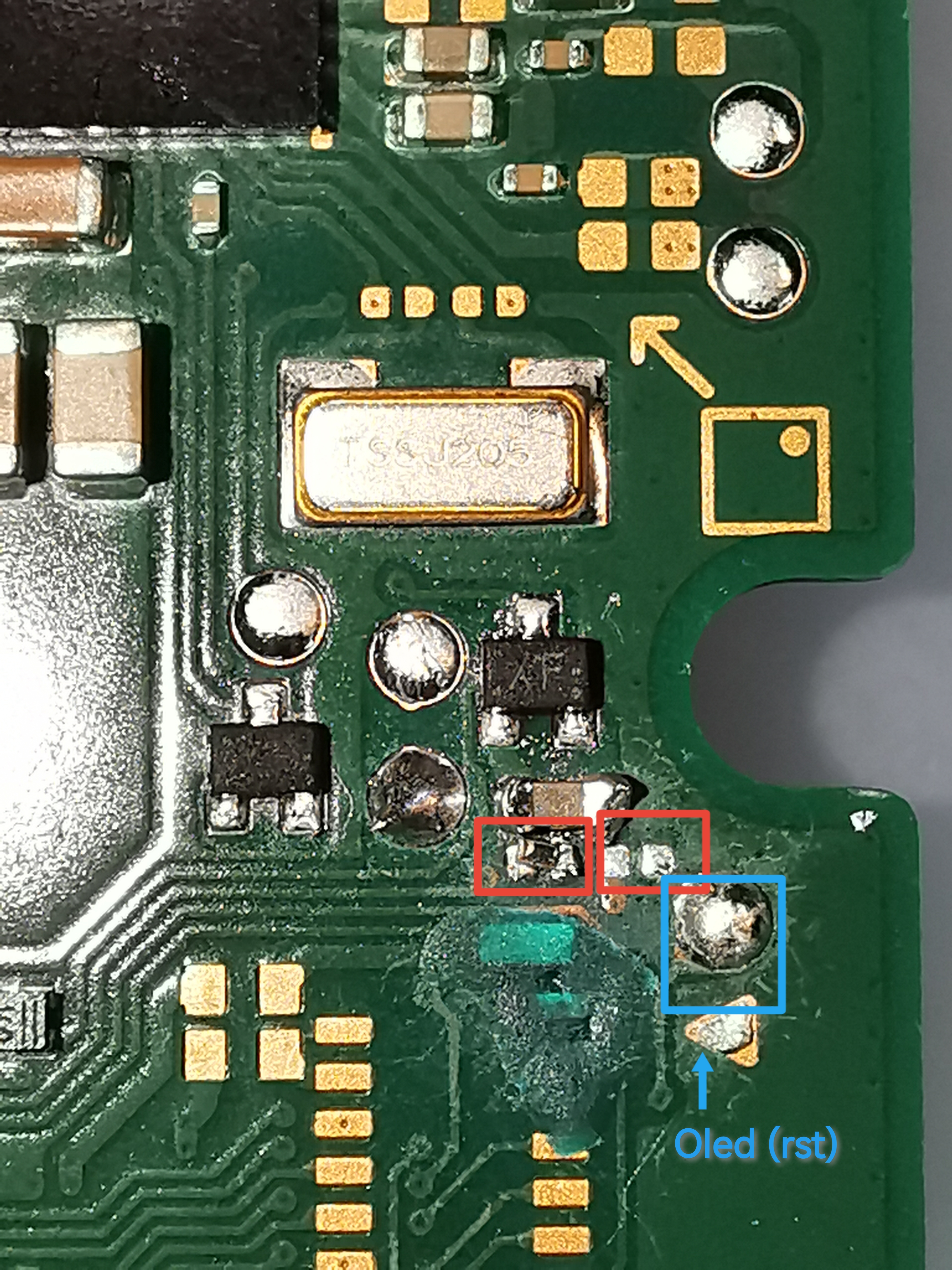

Hey guys I need your help.
I got these two little things lost of my OLED switch near the rst point.
...sad...
The photo was taken before I lost both of them...
Could you please tell me what they are ?(50k resistors? or something else?)
Thanks.View attachment 367780
Oled.
Nearby the rst point
I'll be back in I couple hours if nobody has gave u the value I'll measure them for u

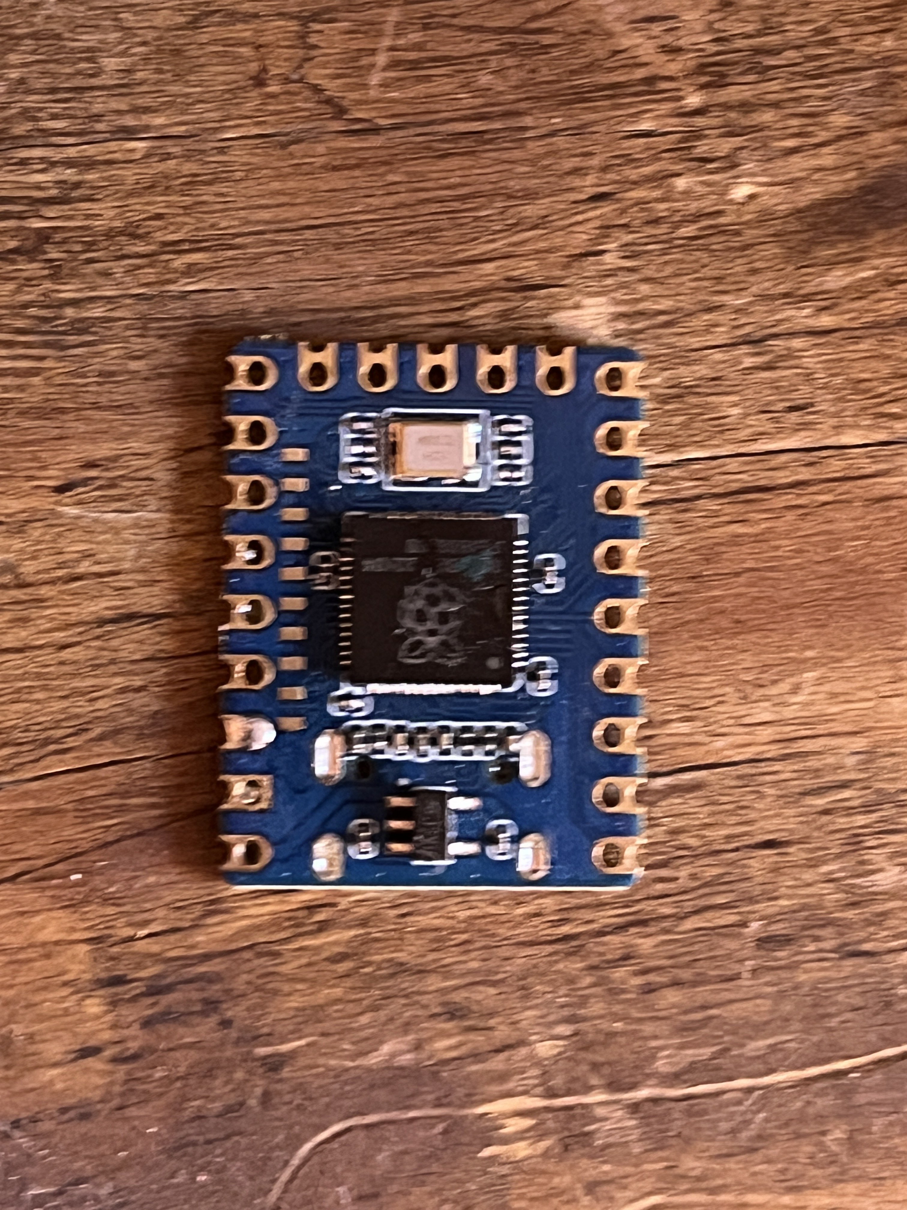

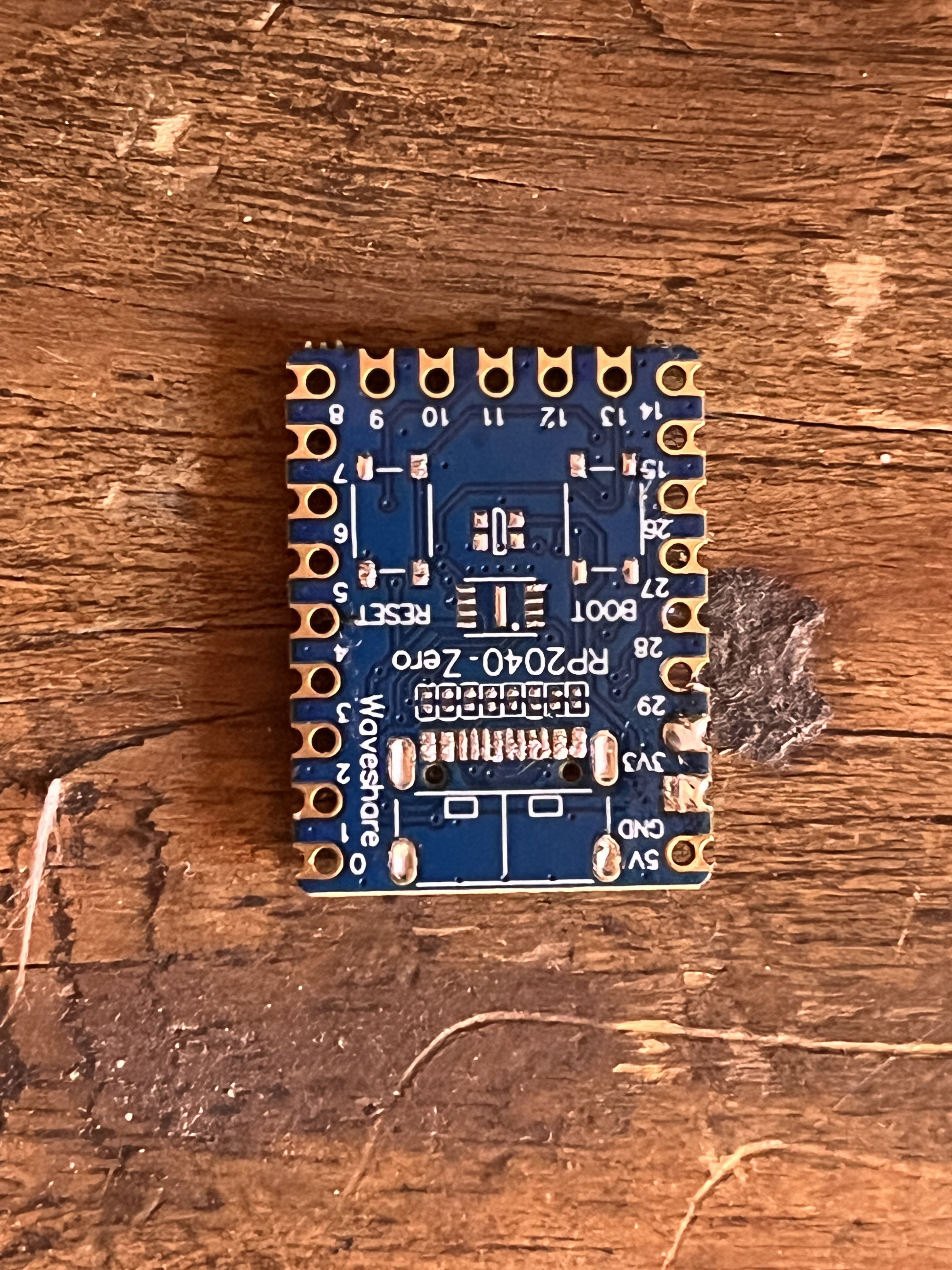

I screwed up, accidentally i remove every component of the front face of the Rp2040, this still work? It’s already programmed.. the back it’s normal every component it’s there.
led indicator and capacitors may be not required but the small chip in center of the board is flash chip (where the code store) is very important, Idk resistor is required or not
