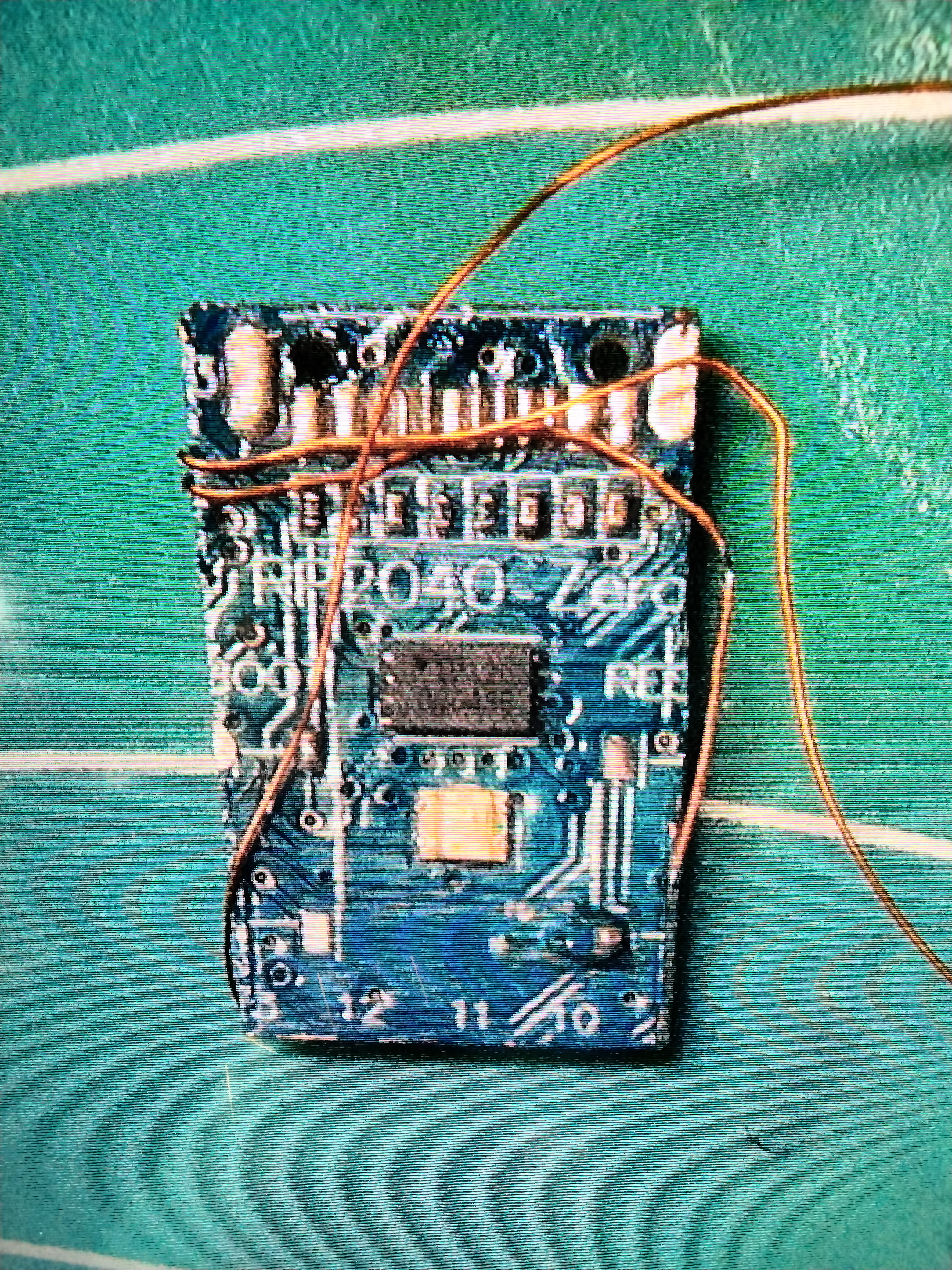

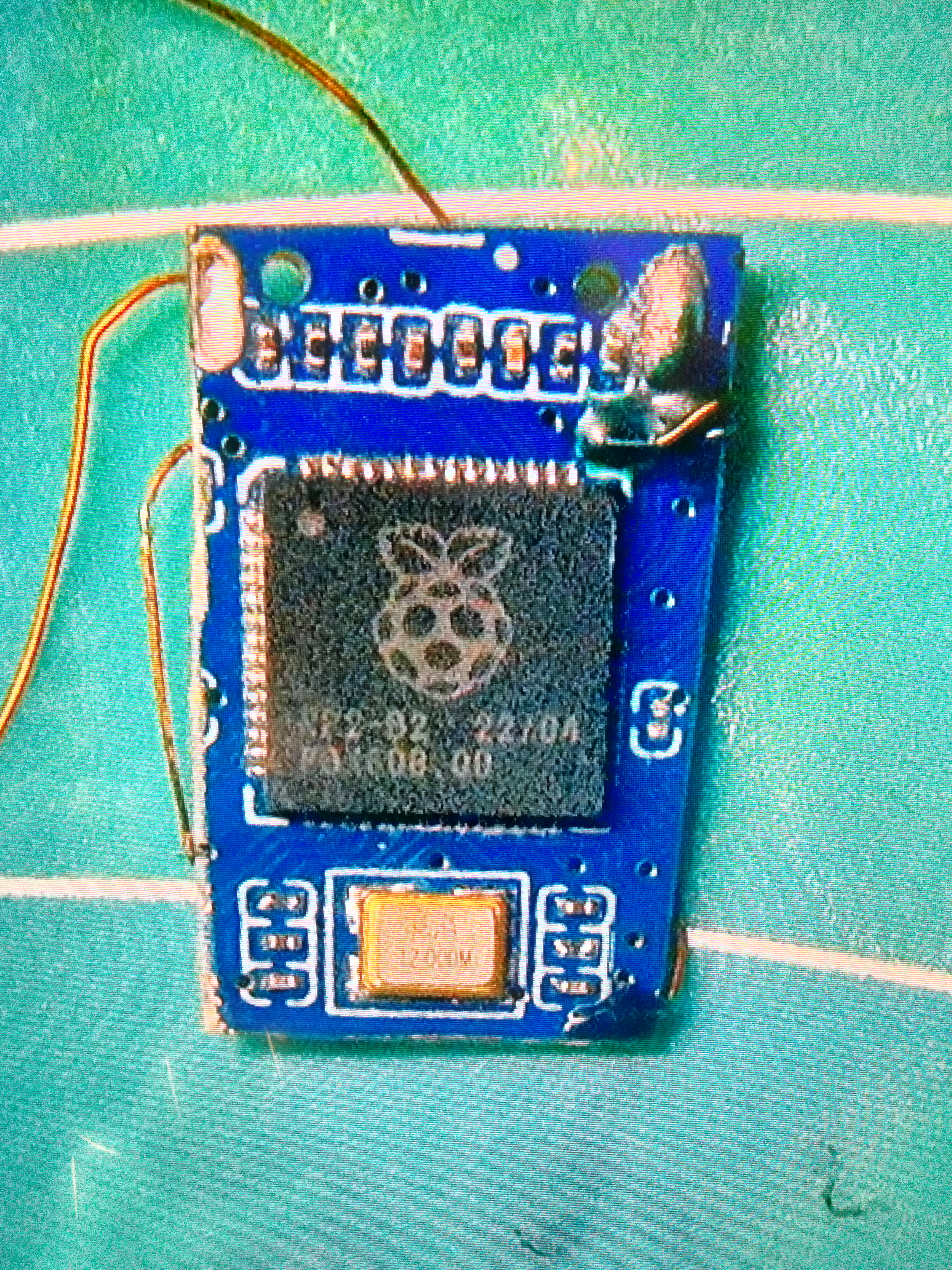

@rehius (or if anyone else knows), what components NEED to be left on the PZero for glitching? I know we can remove the port and regulator to make it thinner, but what about cutting the chip and\or moving components around, to make the whole package smaller? I have successfully cut it down before but now I'm wondering just how far I can take it.View attachment 367792View attachment 367793

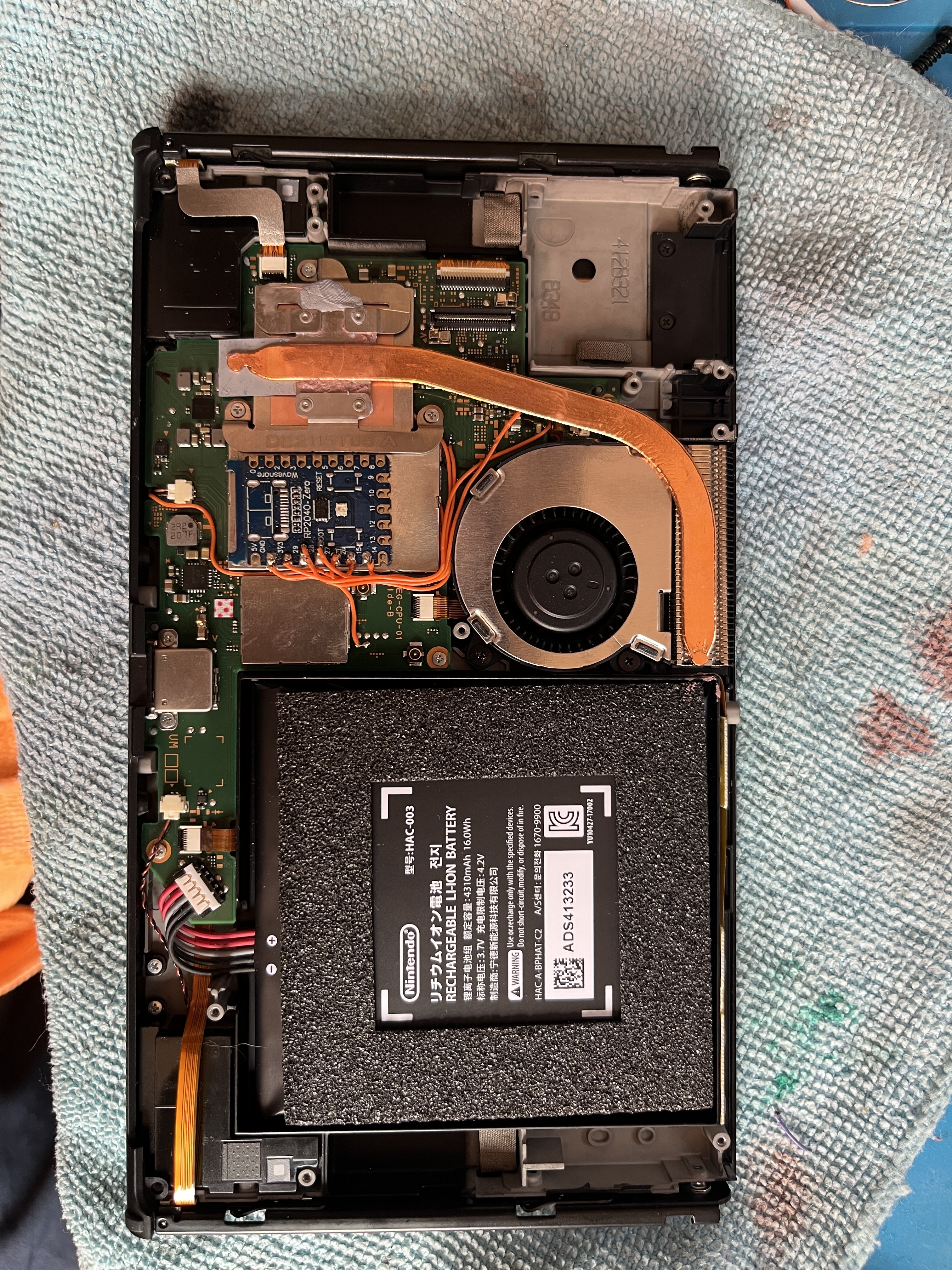

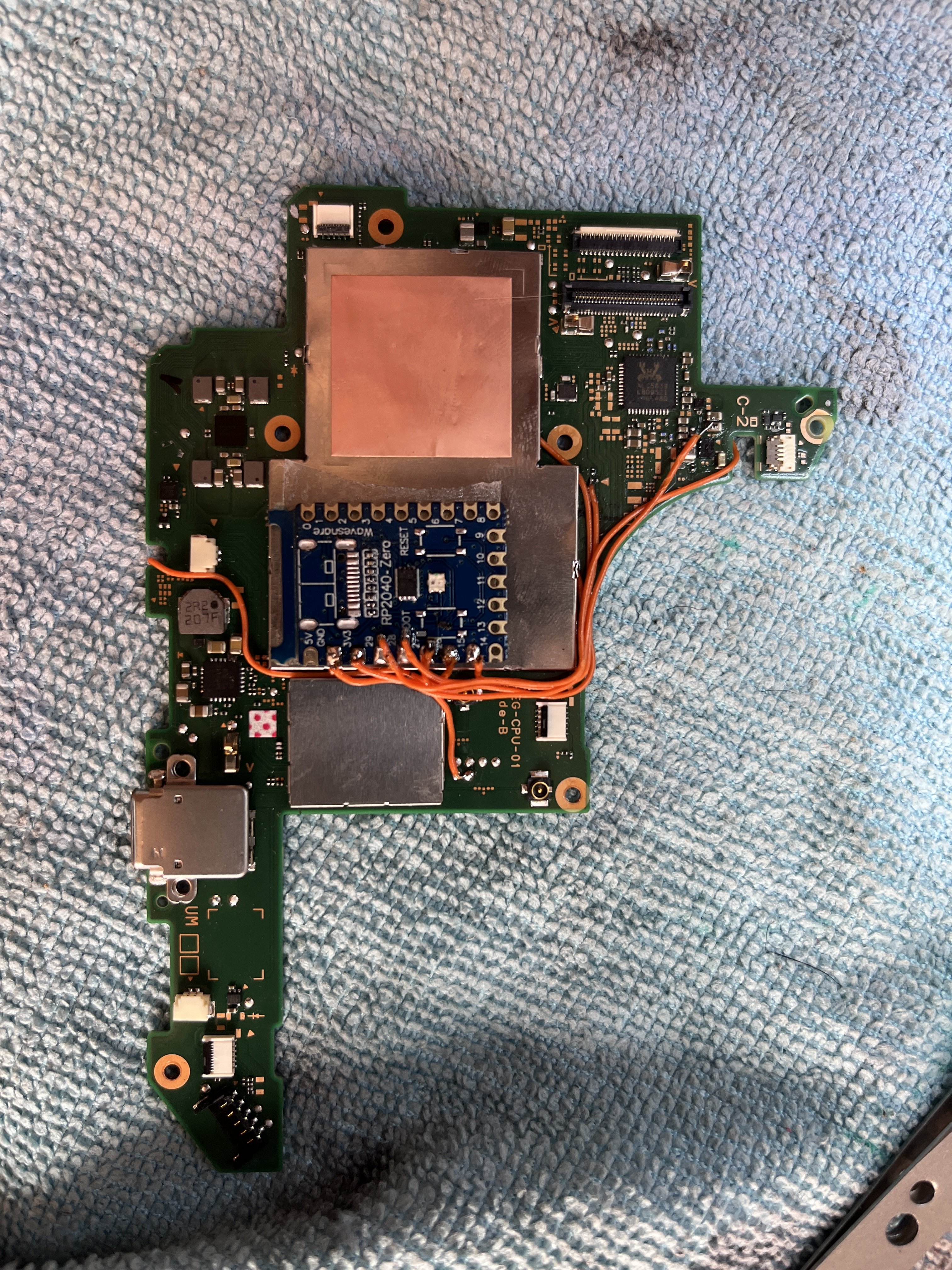

So yess i have another problem. I soldered everything wirh two mosfets and pico still blinks cyan after startning. I missed something?

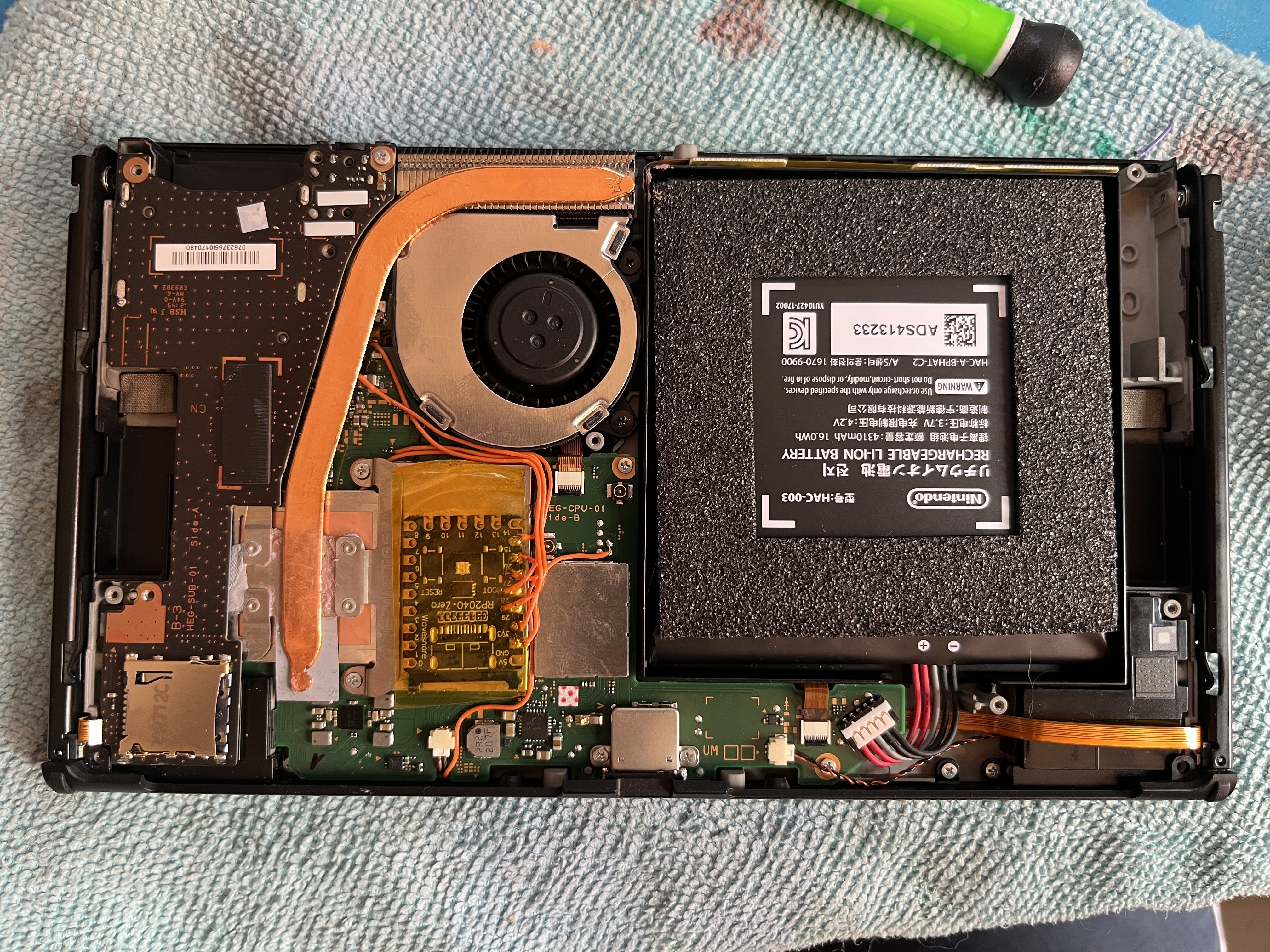

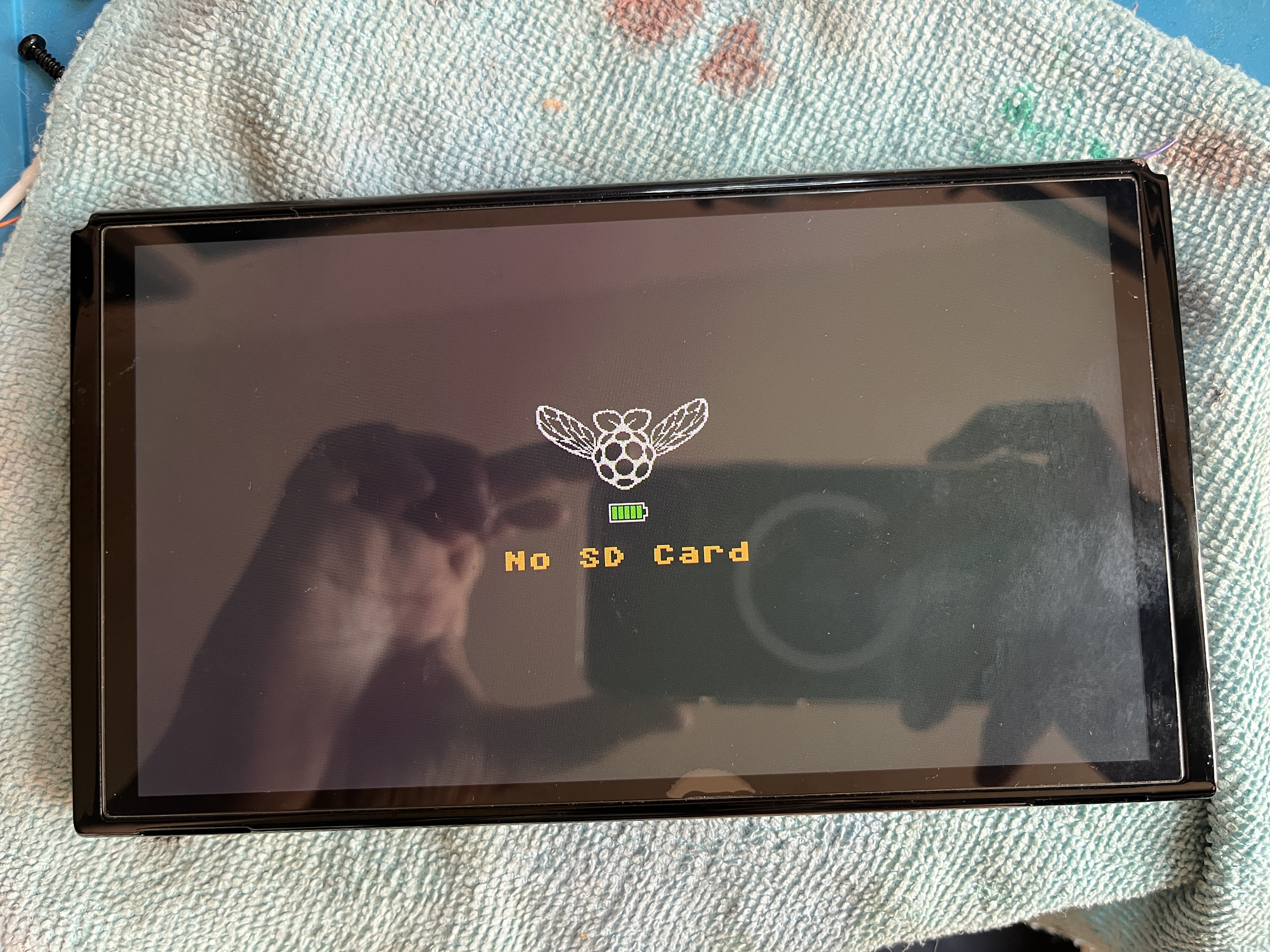

So I left the console overnight after getting it working reliably yesterday. Today I turned it on and the 2040 still does blue, then a green flash and then off, but now the console only boots into OFW, seems like the glitch is failing and the 2040 doesn't know. Any steps before I'm forced to open it up again and see if anything physical went wrong?
Check the soldering on 1st cap.
Shorten all the cables that go to mosfet
Solder the S point from mosfet to the shield (only use capacitors for Drain, so only the inner side)

I went back over and checked all of the connections with a multimeter and it looked good. I've attached a video of it booting. The only thing I can think of now is to replace the 2040 with another running 2.67. The one that's currently in the switch is 2.65 but can't update it now because it won't boot the payload.
