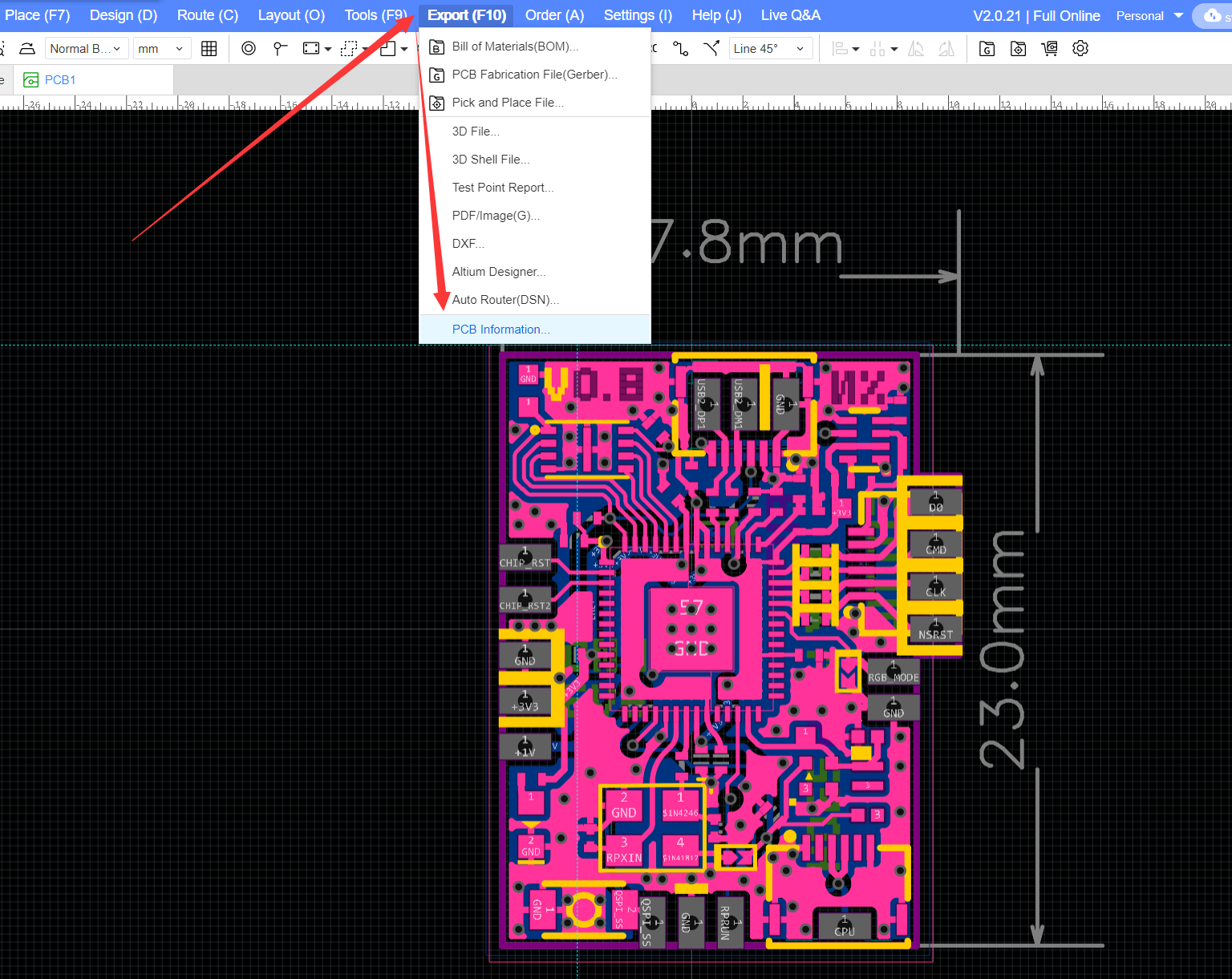

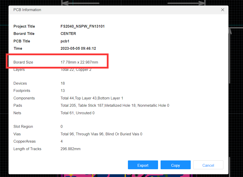

Can we get the sizes for these so when using PCBWAY we can input correct size, re: xmm - xmm
