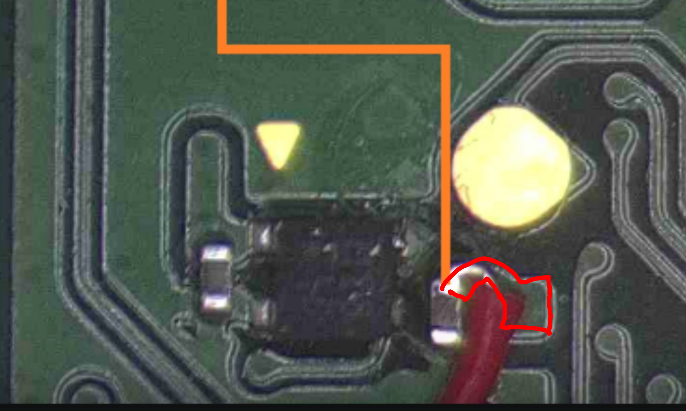

As a side note, 30AWG isn't small enough for this 0201 cap. Need like 36 or 40AWG from the looks of it. I broke the cap, but it isn't vital anyway. I took the cap off and then scratched off the solder resist on large power trace going to it, outlined below in red. This is much more secure than just using the cap, though also obviously more destructive. Certified "Works For Me" though.
Just did this myself and can confirm scraping this pad and soldering to it is a million times easier than soldering to the cap.
The solder mask is very thin so be patient when scraping it off.

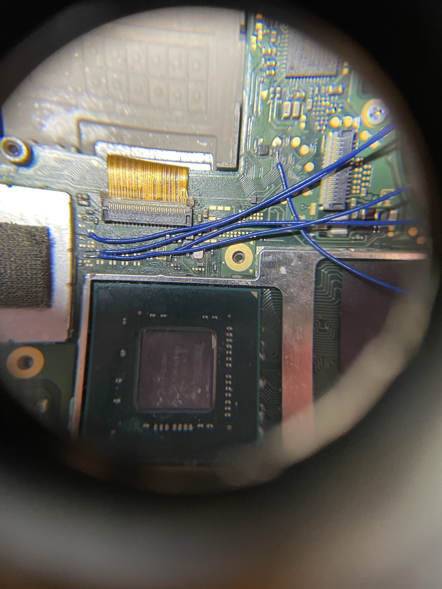

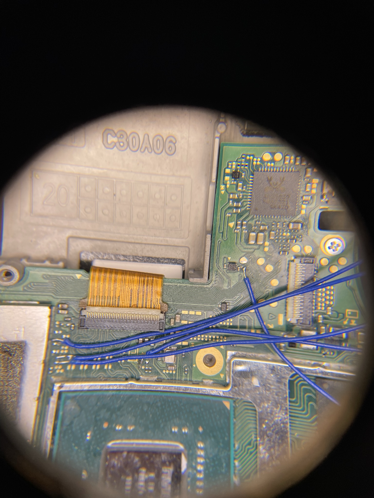

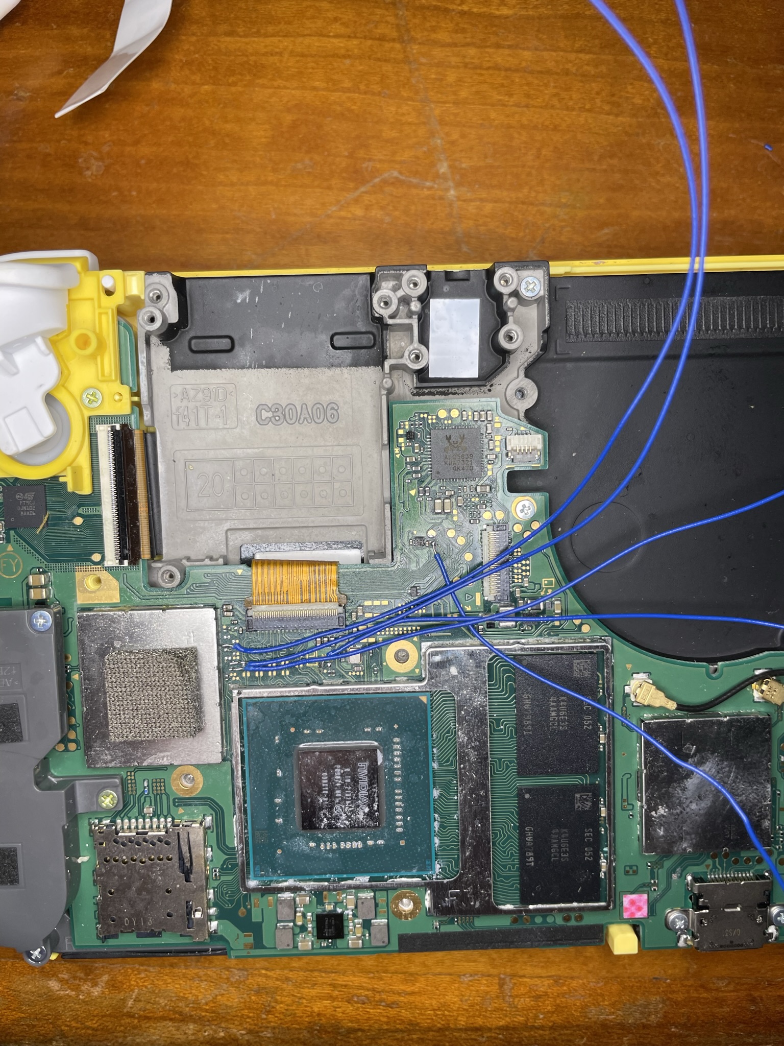

Here are pics with 30awg. (still waiting on my 36awg).
