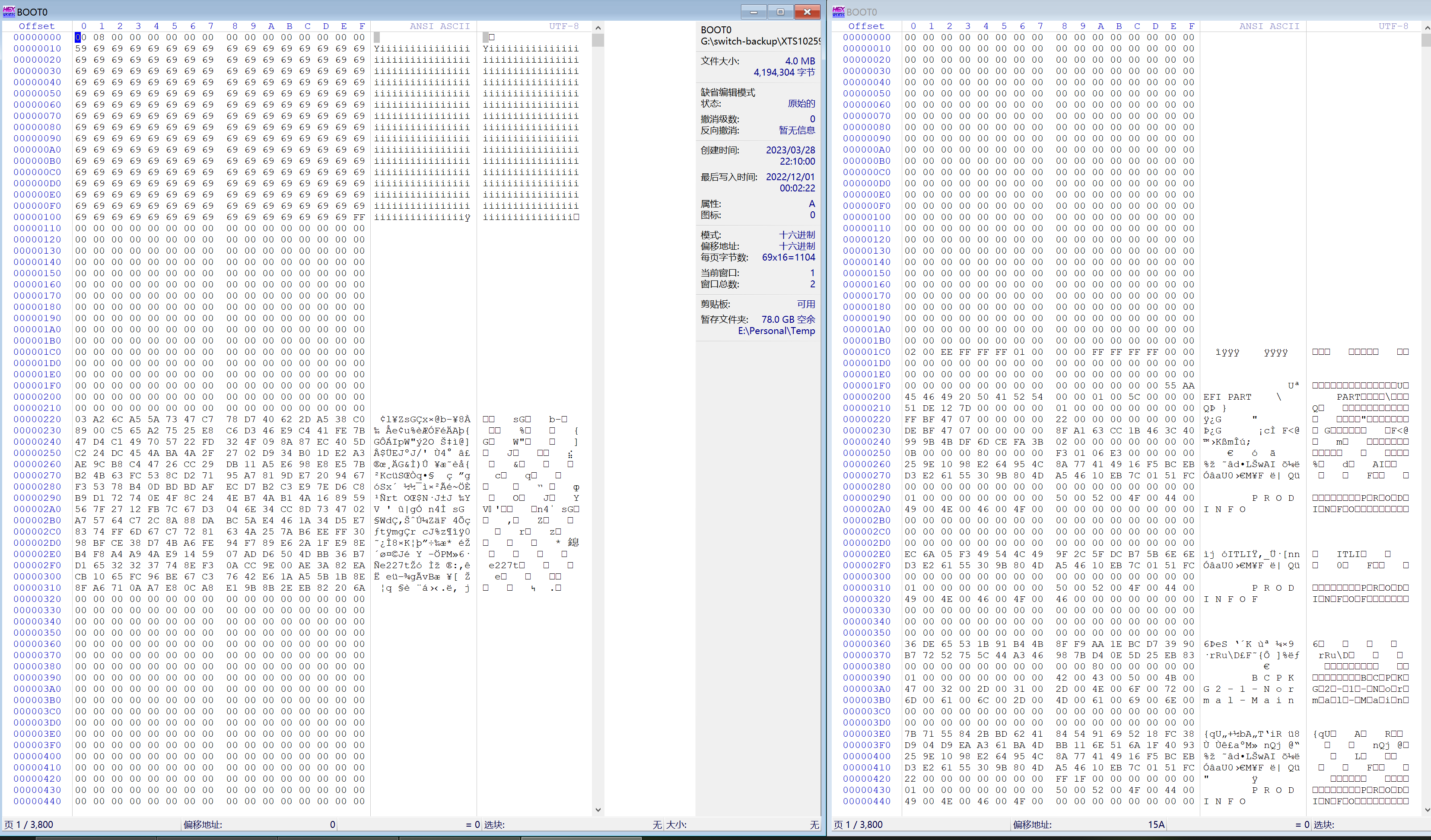

View attachment 362358View attachment 362359View attachment 362360I think firmware 2.5 is not compatible with my nand(KLMCG4JETD).The hekate always say "emmc is in slower mode"(eMMC info).And once you laod stock HOS,end with failure and the boot0 is broken .Luckily I had backuped my nand.

The left is original boot0, right is changed boot0.The right one is backuped after boot failure.

"Currently, I only have a backup of the incorrect boot0. How can I restore the correct boot0?"

I am in the same situation as you. Is it because of the Chinese system
Did you use unlock. bin
boot0 is the same for switches with same firmware version, so you can get kown your firmware version form fuse,and restore a same version boot0 .
