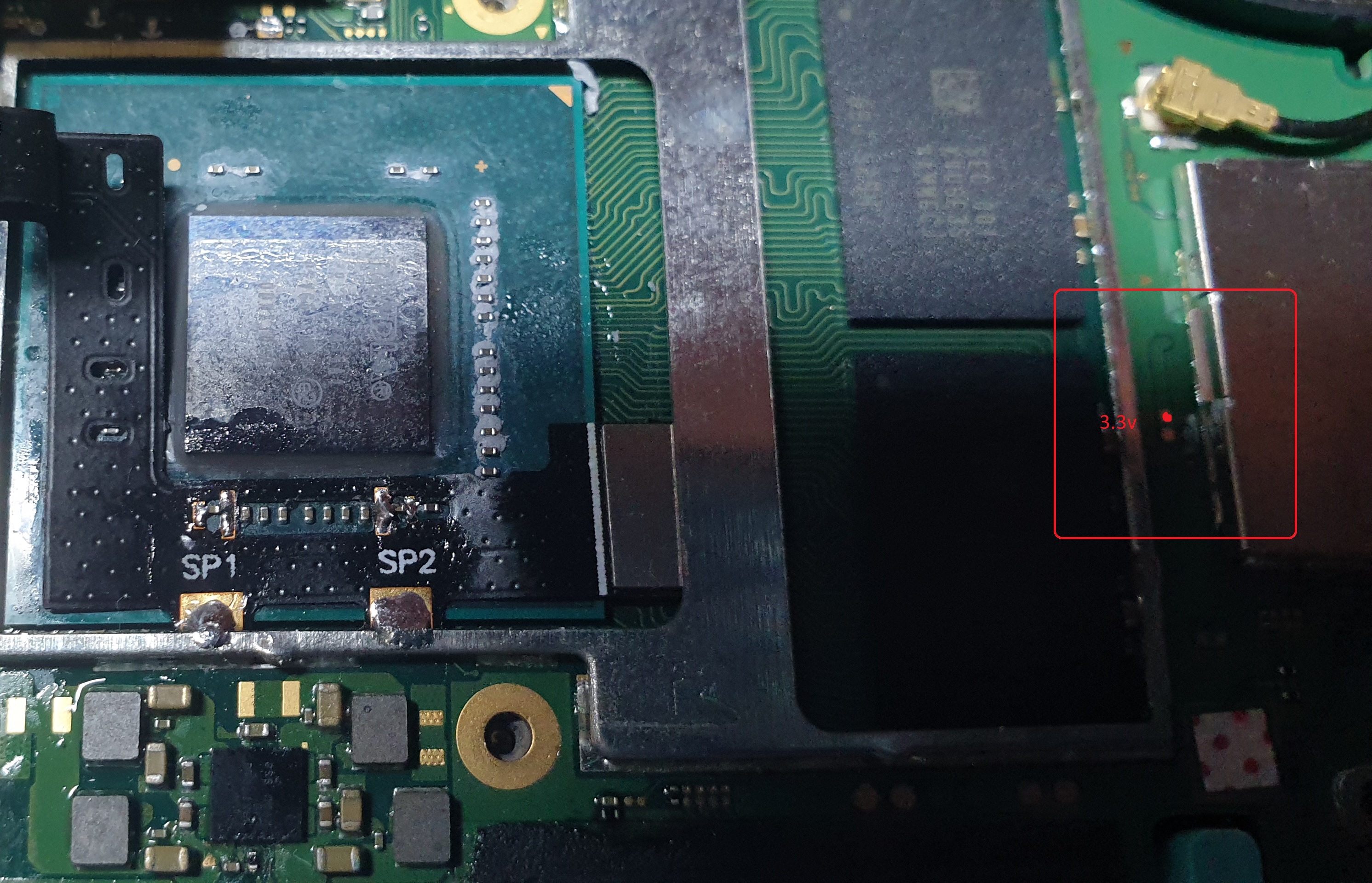

That was literally it. VCC must have been switching at that point, or maybe it was interrupting the 3.3V input to the SD card. That cap is way too damn small to be using as a permanent point though, going to have to find another option.
Thanks a bunch!
As a side note, 30AWG isn't small enough for this 0201 cap. Need like 36 or 40AWG from the looks of it. I broke the cap, but it isn't vital anyway. I took the cap off and then scratched off the solder resist on large power trace going to it, outlined below in red. This is much more secure than just using the cap, though also obviously more destructive. Certified "Works For Me" though.
